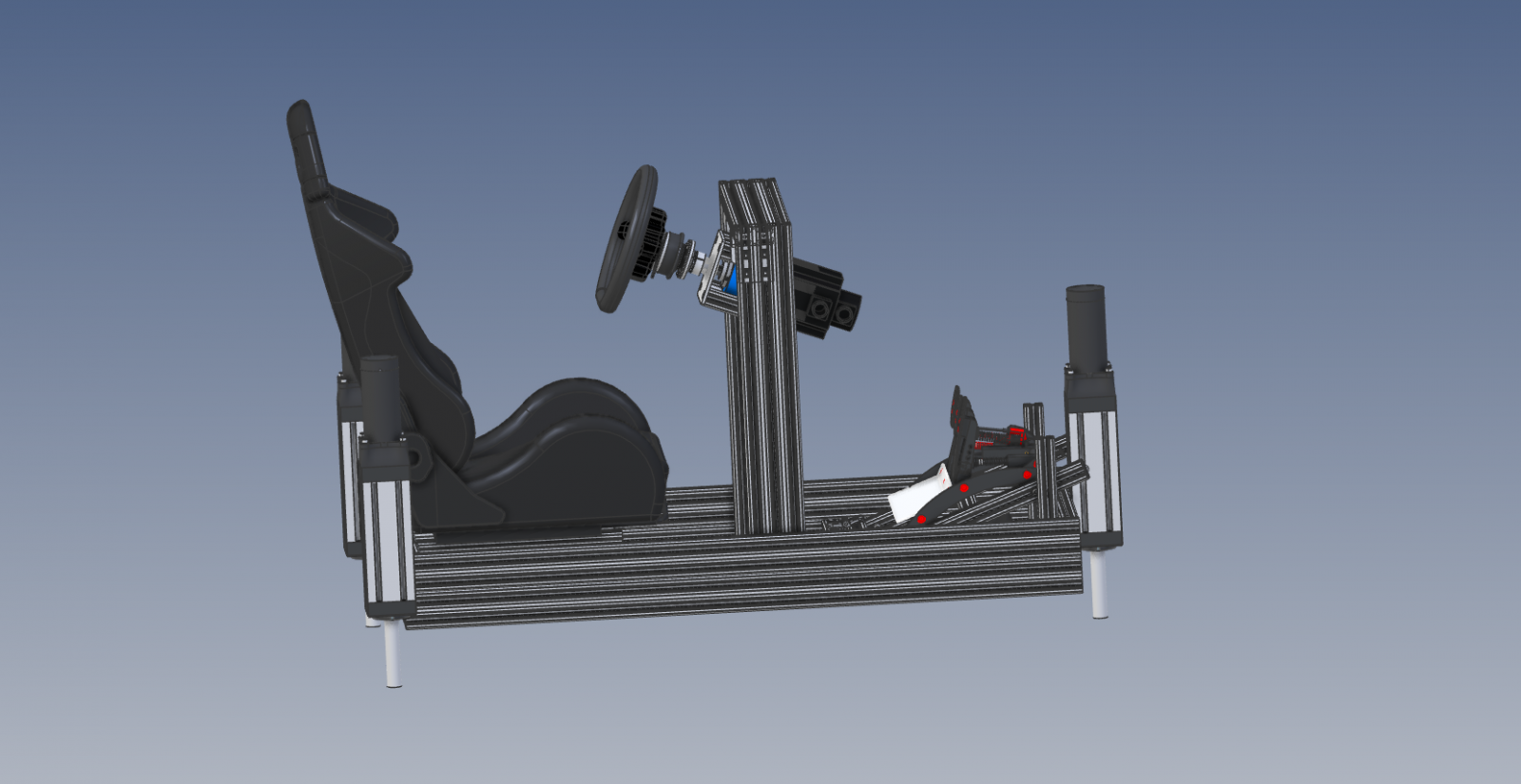

    I got a little further on the rig design. Digging through my extrusion I am able to double up the side rails and front and rear cross section which should significantly increase the rigidity of the frame. I have done this before with end connectors and t-nuts and lots of access holes. It is a pain, but it can be done and creates a very solid single connection.
    I'm still debating on 3 vs 4 actuators. I'm pretty much sold on 3, but I don't like the front actuator so far out. The pitch pivot point will essentially be the steering wheel. A single actuator in the rear will prevent the seat from sliding unless I extend the frame a good amount (6" plus). with a single rear actuator I could move the front side actuators to about where the steering column is. I have the actuators mounted as high as physically possible right now and honestly I still don't think its high enough. I have a couple of ideas I am rolling around right now.
    1. Build a sub-frame that will elevate the whole chassis and allow the actuators to be mounted even higher without the frame bottoming out. This would also give me a large space to house all of my electronics.
    2. Flip the actuators upside down and make pivot points similar to a typical 6dof build. This would be a lot more challenging, but I could get an effect similar to this.
    My current frame design is very similar to the sim lab P1, both in extrusion size and footprint. I will proceed with my mock up chassis for now, I have it in my head that I will be getting a new seat and I don't want to cut any aluminum just in case the new seat requires more or less frame space. The seat I am looking at is the NRG Prisma, its less than $300 shipped and SRG gave it high marks.

    For what it's worth I built a 4 corner all metal sfx style rig and I want to change it to a 3 inverted actuator setup like the last pic you posted. My two top reasons are actuator weight off the rig(20 lbs a piece, thats 80 lbs moving around right now) and center of rotation closer to my center of gravity. The frame will not be as simple though and there will have to be a moving frame and a floor frame.
    I don't think I will do the change though until motion cancellation works (or maybe better to say until I can get it to work). The center of rotation only matters for larger movements. Larger movements in vr are crap without cancellation.

    @cfischer which Vr headset are you using. I’m still rocking the oculus rift which I understand has no motion canceling. I would like to get the index, assuming it actually works with motion rigs.
    I’m thinking I could just flip my actuators upside down and set them right on the encoder cover. I would just need some framing to hold them in place. I’m wondering if I’m over thinking it though and venturing back to the more traditional linear actuator requirements.

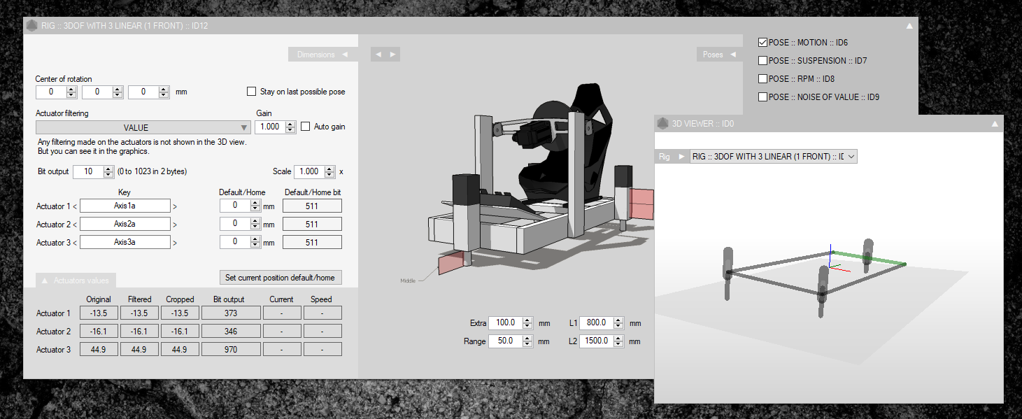

    @Hoddem ,
    Great work!
    So it's you who's going to test Mover with 3 actuators? :)

    I
    I had no idea that it had 3 actuator support. Heck ya I’m going to test it.
  13. pmvcda
    pmvcda aka FlyPT
    Nov 3, 2010
    2,280
    Portugal
    15,950Coins
    +2,733 / 18 / -0
    It's still WIP with a new build to come out in the next two days
    But I would love to have some feedback on this type of rigs.
    When you want to try, say something so I can help on the setup.
