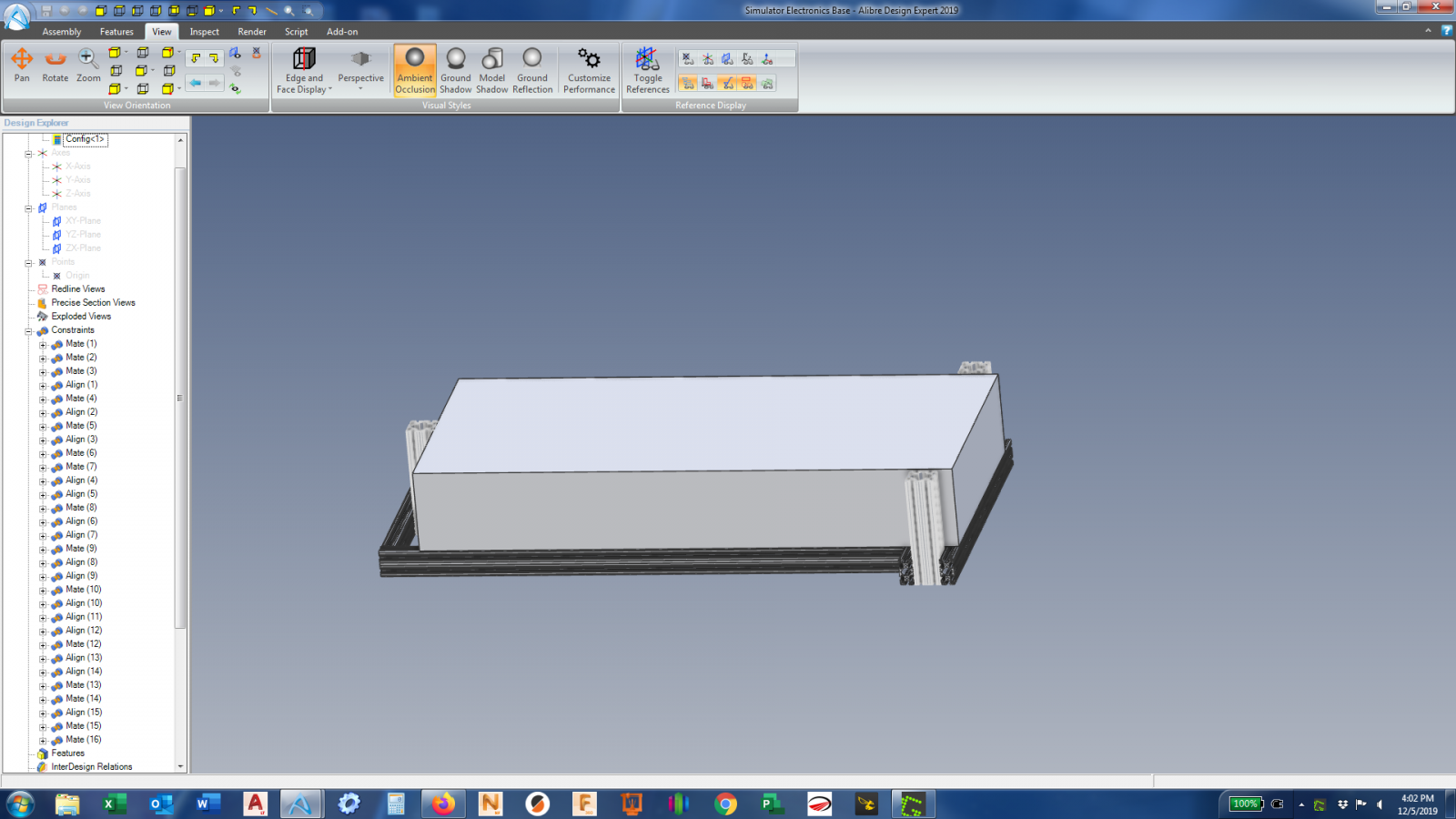

    Hi Hoddem, I was curious if you ended up going with a normal or inverted 3dof actuator build. I'm hoping you are going inverted so I can copy some of your work =D

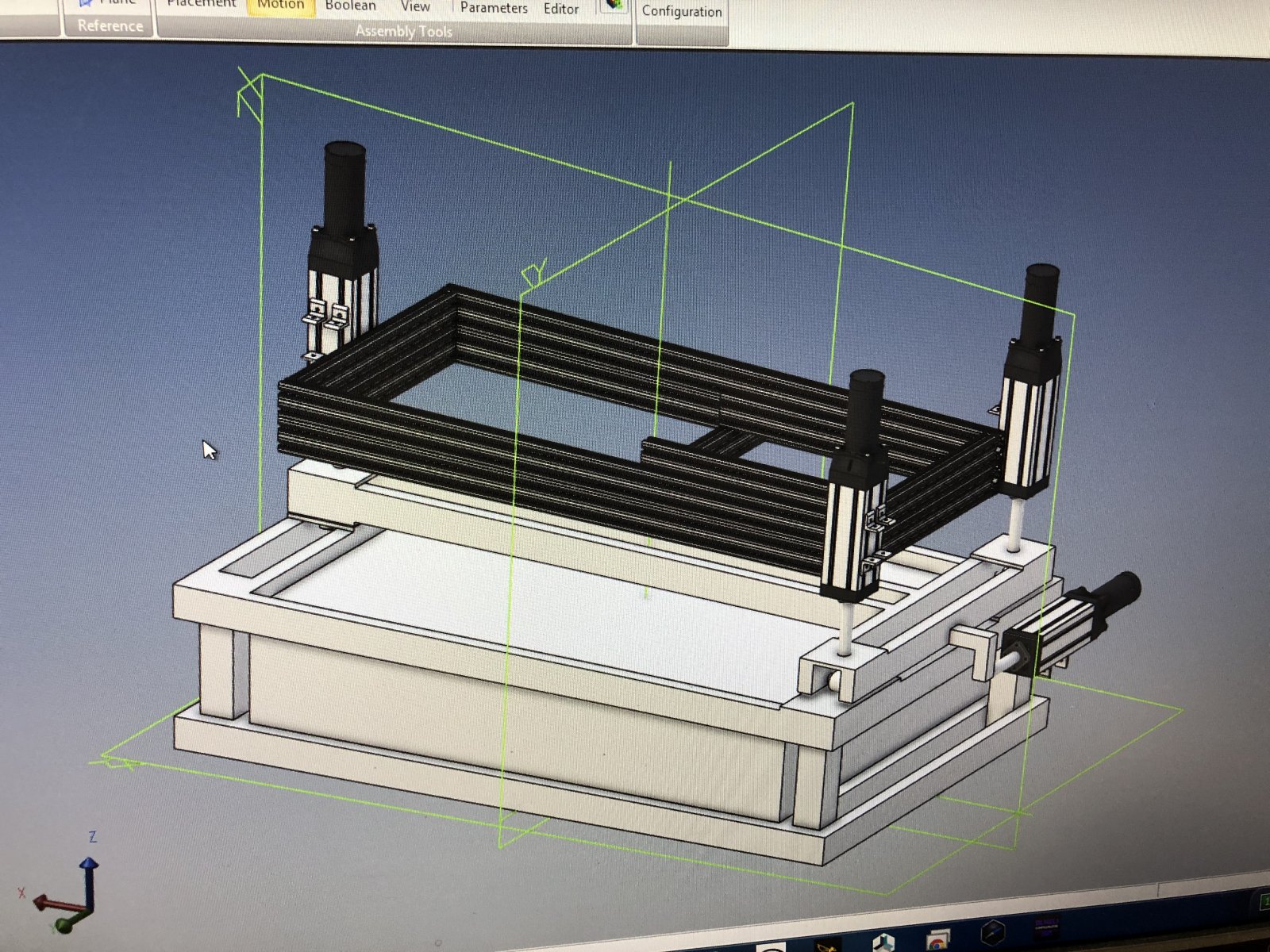

    As of right now I am still trying to decide. On one hand I can do a 3 or 4 actuator system (3dof) and lift it off the ground to allow all of the electronics to be housed underneath.
    This is kind of what I was thinking for the base. This would not be inverted actuators, however it would be easy to do the inversion with this design.
    However if I did 3 actuators that would leave a 4th for traction loss which I think would be a nice addition. That does add a lot of complexity though, especially if I keep it elevated.
    I still need to get my servos setup and tested, I do seem to be affected by the high frequency noise that the servo drives emit though so servos may not work for me in the end.

    Thanks for the update Hoddem. Yeah I'm also not sure if I want go 3DOF or 4DOF adding traction loss. I would ideally like to do something like this, but the added complexity might be too much to do on my own: . Bummer on the high frequency noise, that is concerning.
