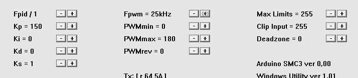

    Hi guys,
    I have question about the settings in SMC3. I was doing some testing with load and I found out that the left motor stopped working while it was tilted to the left o_O. What setting should I adjust in SMC3 to prevent them from shutting down when they almost reach there max limits. Should I use PWMMin and PWMRev ?

    I've read that PWMrev should have similar a value as PWMmax. What would be a safe value in my case?

    Shutting down can have a number of causes, but start by refining the SMC3 settings, which should be refined for your specific hardware.
    I would expect Clip Input and Max Limits to first be refined, followed by other settings.
    See the SMC3 instructions here re settings functionality: https://www.xsimulator.net/communit...driver-and-windows-utilities.4957/#post-48121
    While written with JRKs in mind see this simple introduction to PID, which links to more hardcore information, depending on how far down the rabbit hole you want to go: https://www.xsimulator.net/community/faq/a-laymans-analogy-guide-to-pids-pid-tuning.219/

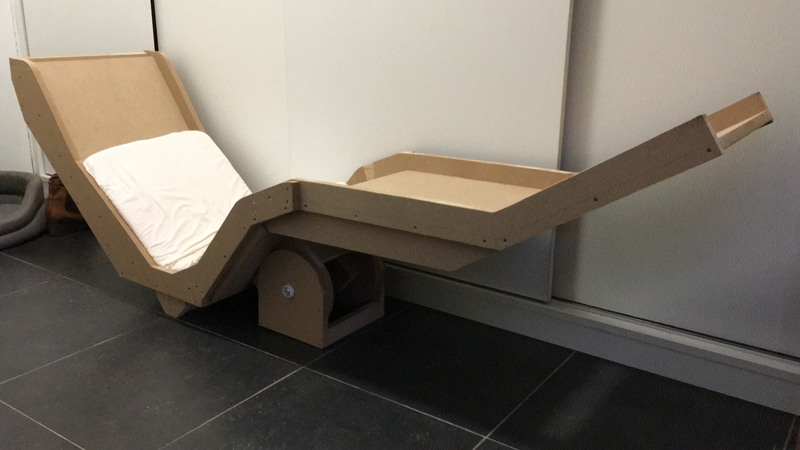

  11. sulfail
    sulfail Member
    Aug 31, 2018
    55
    Mason
