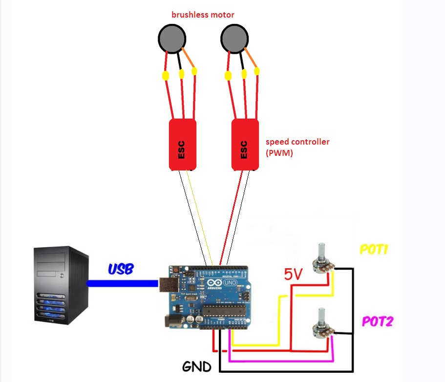

    I'm confused.... The rc servo and rc speed controller uses the same signal type, PWM (single cable for direction).
    This is similar to what I need.... Isn't the MM driver uses PWM ? 1 wire signal for both direction?

    RacingMat is correct! RC servo pwm is completely different than h-bridge pwm. I should have thought of that before that an RC motor controller would obviously expect servo pwm since an RC receiver is normally driving it. I would try to explain the difference myself but I’ll just quote Wikipedia this time to make it easy on me.
    "The angle (of mechanical rotation of a servo) is determined by the width of an electrical pulse that is applied to the control wire. This is a form of pulse-width modulation, however servo position is not defined by the PWM duty cycle (i.e., ON vs OFF time used to drive an h-bridge) but only by the width of the pulse. The servo expects to see a pulse every 20 ms, however this can vary within a wide range that differs from servo to servo. The width of the pulse will determine how far the motor turns. For example, a 1.5 ms pulse will make the motor turn to the 90 degree position (neutral position).
    The "RC PWM" used in RC servo control acts very differently from the PWM used in any other system. (In particular, the confusingly similar-sounding direct PWM DC motor speed control works entirely differently). Most RC servos move to exactly the same position when they receive a 1.5 ms pulse every 6 ms (a duty cycle of 25%) as when they receive a 1.5 ms pulse every 25 ms (a duty cycle of 6%) -- in both cases, they turn to the center position (neutral position). The low time (and the total period) can vary over a wide range, and vary from one pulse to the next, without any effect on the position of the servo motor. With many RC servos, as long as the refresh rate (how many times per second the pulse is sent, aka the pulse repetition rate) is in a range of 40 Hz to 200 Hz, the exact value of the refresh rate is irrelevant."

    I know most of your guys are skeptical, but simple doesn't mean perfect and complicated doesn't mean expensive.
    I never said I was going to use RC servo to drive the simulator. I am not engineering, but I know this can work with some simple coding to make the Ardruino understand what it need to do. Unfortunately I am no coder either so this will make it very hard to archive. The basic is simple, Ardruino should output a signal to control the (RC speed controller both direction via 1 signal wire). Potentiometer get hook to Adruino for feedback so it can know the position of motor shaft.
    Why no one have done this before? I don't know. Why I think this will work out better? Here's why.
    * During the past 10 years the biggest change in the RC industry and BRUSHLESS motor and LITHIUM POLYMER. Everything RC is now brushless and there's a lot of reasons why.
    - The most obvious, there's no BRUSH in Brushless.
    - A lot more torque
    - Half the size and also lighter
    - The cost of brushless motor has DROPPED significantly do to increase in production.
    Just a couple of sample.
    600watts
    http://hobbyking.com/hobbyking/stor..._Brushless_Multirotor_Motor_Built_by_DYS.html
    2300watts
    http://hobbyking.com/hobbyking/stor...SK3_6354_260kv_Brushless_Outrunner_Motor.html
    * Brushless esc are cheap as well, 40amps esc 12-26volts are 20bucks
    * Most DC brushed motor are stuck on 12volts, making it required expensive and big power supply. Brushless motor you now can run much higher voltage, even at 50volts. Higher voltage mean more effeiciency and lower amps power supply.
    It may be hard for you guys to vision the changes, but I have been doing RC for 18years and I have seen so many thing people say not possible, not going to happen and look at where we are now. I fly RC Helicopter mostly and 10 years ago, people think I was crazy that I set up my helicopter to fly on 50volts DC.... but now, 50volts is STANDARD. So my goal is someday you guys will look back at this thread and laugh because you will all be using RC motor and esc for your racing sim.
    thank you for reading all my bs. :)

    Okay, I’ve been a little slow on the uptake but now I’m finally getting my head wrapped around this. The code need to accomplish this shouldn’t be very hard to accomplish.
    Why has no one done this before? Probably because it was not necessary for them to do so! There are obvious reasons why brushless motors have advantages in the RC world, but we don’t need those when we are not powering small-scale models where power to weight is a big consideration. The only advantage that I see atm is, as you stated, there are no brushes, and so they can’t wear out. But there are also disadvantages with using brushless motors, and for motions sims, I personally think they outweigh the advantages, at least when using larger brushless motors.
    Brushed motors are stuck at 12v? That’s a new one for me! 12, 24, 36, 48, 90volts are common although controllers are harder to find for higher voltages. Also higher voltage motors are not more efficient, they simply trade voltage for amperage. But when multiplied together to get power (v * a = p) the end result is the same.
    Anyway, here is a sketch you can experiment with that should control your motor controller with a pot if it will keep you from whining for a while. :grin If this works it wouldn’t be too difficult to apply this to the XPID_Simtools1_23 sketch.

    Oh snap... got it to work. Motor run well, both direction ... yay! Now waiting for the Bodine motor to come and I will test some motor and give you guys some result.

    @BlazingH So I am testing it with a linear 10K pot and I notice this and probably need to change the range.
    There's about 1/8 of a turn deadband (center between two direction)
    Each direction only use about half the range of the pot to reach full throttle. Though I have no idea how to code Ardruino, but I will try to change some of this number and see what going to happen. :)
    val = analogRead(potpin); // reads the value of the potentiometer (value between 0 and 1023)
    val = map(val, 0, 1023, 1000, 2000); // scale it to use it with the servo
    myservo.writeMicroseconds(val); // sets the servo position according to the scaled value
