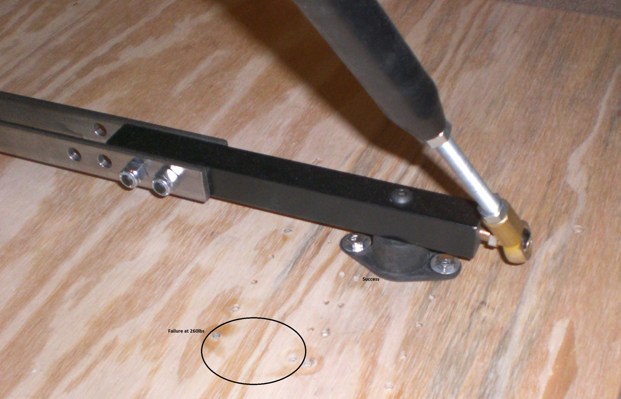

    Hi Barnard,
    Once again thanks for the helpful information. Does the 260lbs also include the weight of the seat?
    And what is the type or brand of adjustable dampers are you using?
    Robert

    Hi Robert,
    Glad I can help. The 260lbs is occupant weight only and is suggested only when using the limiters. However, I am 230lbs and I have driven some exteme profiles with a 25lb weight in my lap and have had no issues even with the limiters off.
    My inline dampeners are custom manufactured. The rear bar dampeners are standard vibration mounts. I dont recall what hardness we wound up choosing. Give vibrationmounts.com a look, I think early on, I got some from them without having to buy in bulk.

    Thanks for your quick response Bernard;
    I spoke with sales support at vibration mounts, and they suggested that the only product they can recommend to achieve the a good x, y, and z pitch and roll at 210lbs plus 19lbs Sparco Fighter seat was the V-100 M style mount from their section 2. “V10Z46MKD055”
    http://www.vibrationmounts.com/Store.as ... ducts3.htm
    I am not sure how this will affect the angles of the push and pull of the 150mm actuators? Please advise

    This link to vibrationmount above doesn't show the correct type of mounts. I know they have these somewhere, or at least they once did.

    I am sorry I pasted the wrong link. I do see the same one that you and Mike are refering to on this page;
    http://www.vibrationmounts.com/Store.as ... ducts2.htm
    Do you fore see a disadvantage of using the M-Style Mounts on the same page for a pivote option?

    Mike thanks for the info, What is the reason or advantage accrued from using to two different dampener profiles; A-3 and A-4?
    Robert

    The M-Style mounts are optimized for low speeds and are lacking vertical give. They sure look alot nicer though.

    I started off using just 2 A-4 that are rated at about 115lbs each and I felt that I had too much movement so I added another pair of A-3's which are rated at 70lbs each.
