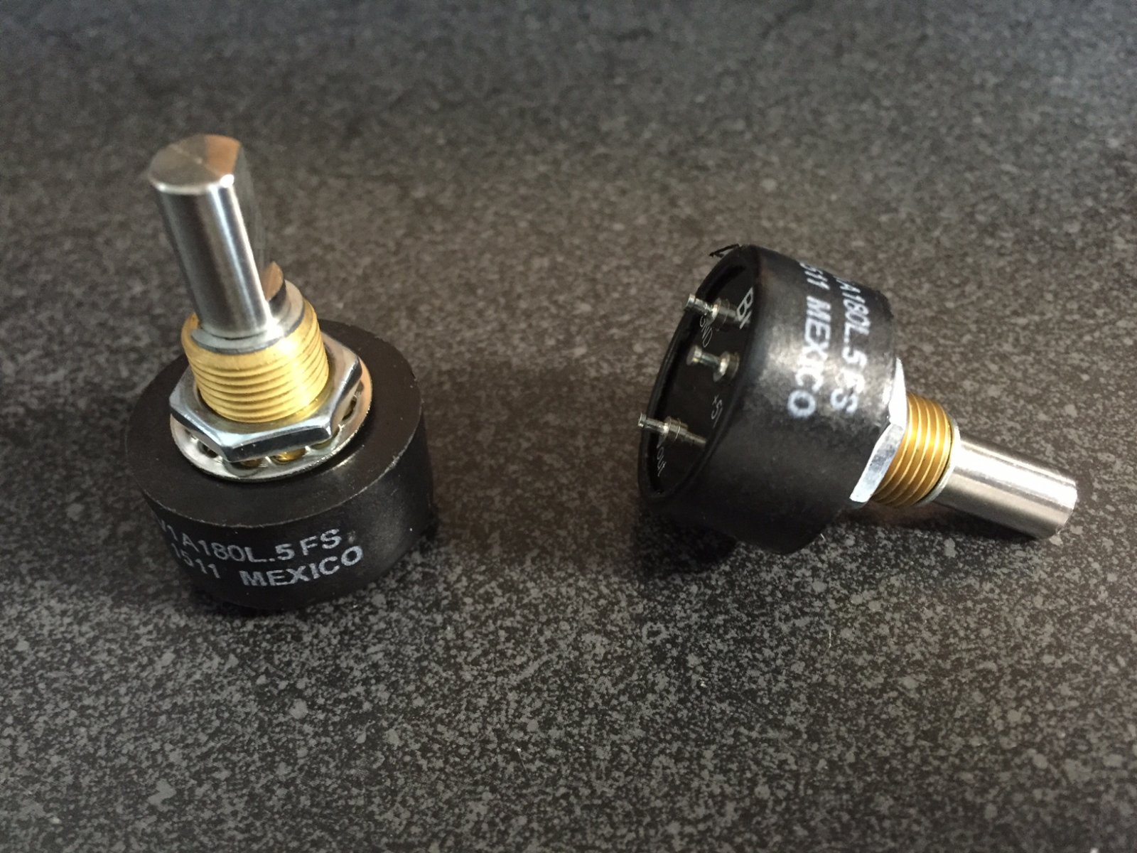

    You can use Hall sensors as a drop in replacement of pots and mounting them is simple as you don't need to gear them.
    I have used these 180 Hall sensors, Element 14 has worldwide distribution: au.element14.com/bi-technologies-tt-electronics/6127v1a180l-5fs/sensor-hall-0-2v-20v-to-10v-pin/dp/2319662

    Thanks for the information, but one more question I have
    Need hall sensors a magnet on the shaft, or can i built them nearly to the shaft and it works?

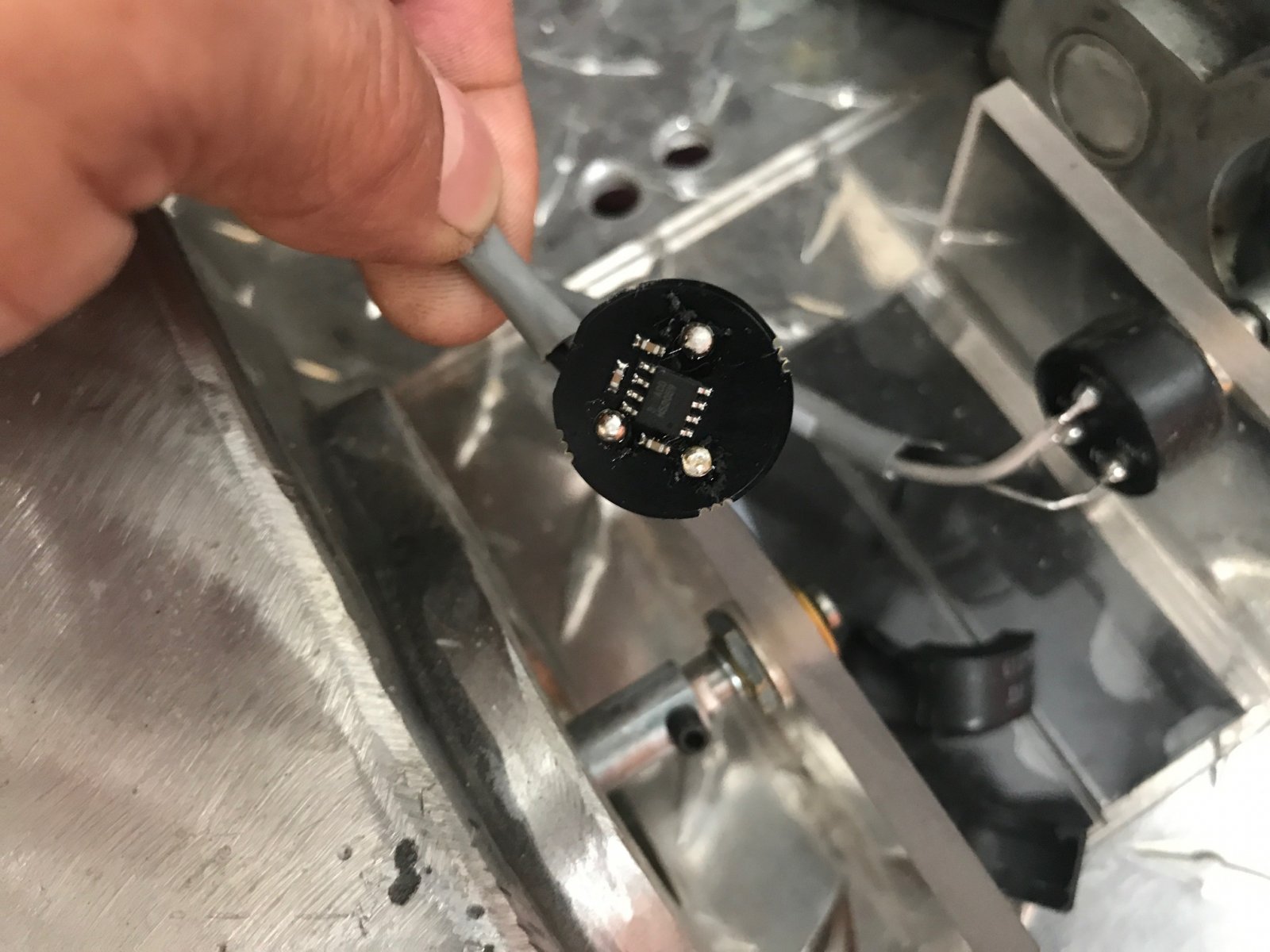

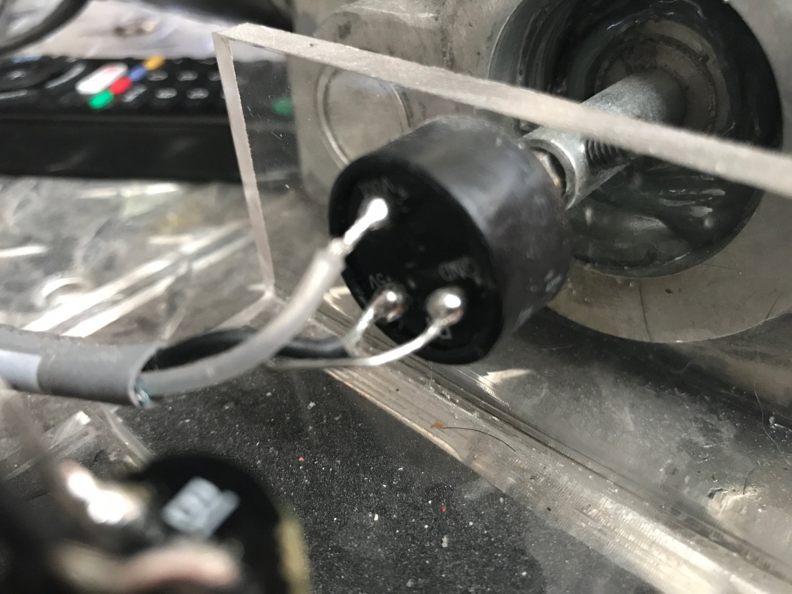

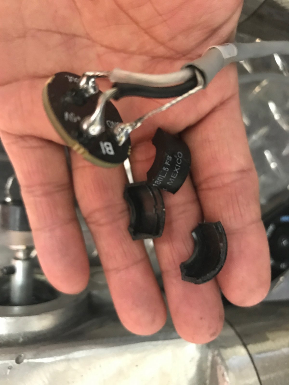

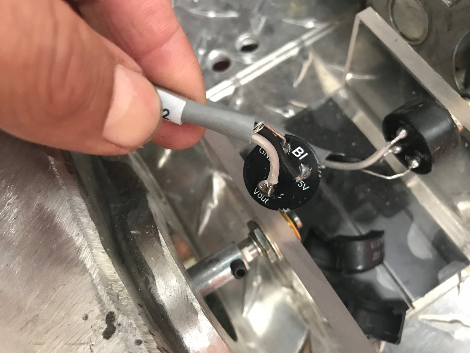

    FYI: I bought that Hall effect potentiometer 3 years ago and today I had one disintegrate on my hands while cleaning! i guess the housing is plastic and with time they come apart easy

    Im still on my Original set in which were LOCKED up twice (due to too Rigid of Pot mount) and required BIG BIG pliers to free up.
    They are FAR from Fragile if you ask me.

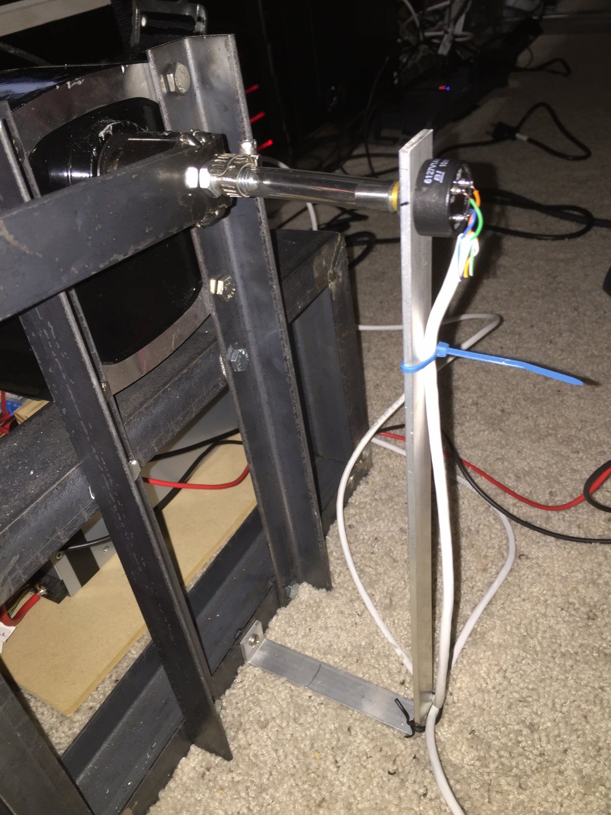

    Hi, i buyed 360 deg hall sensors pot but i want connect it directly to the motor shaft without any gear, so this is my question . do i need make some adjustment in the smc3 ino file in the arduino to get the right feedback from the pots????? Or it can be adjusted with the clip limit??? Thanks in advance

    Use a correctly sized flexible connector to directly link the Hall Sensor and motor: https://www.xsimulator.net/community/faq/how-to-connect-protect-a-potentiometer.13/
    You can use the SMC3 utility to make the settings adjustment, you don't need to mess with the ino file.
