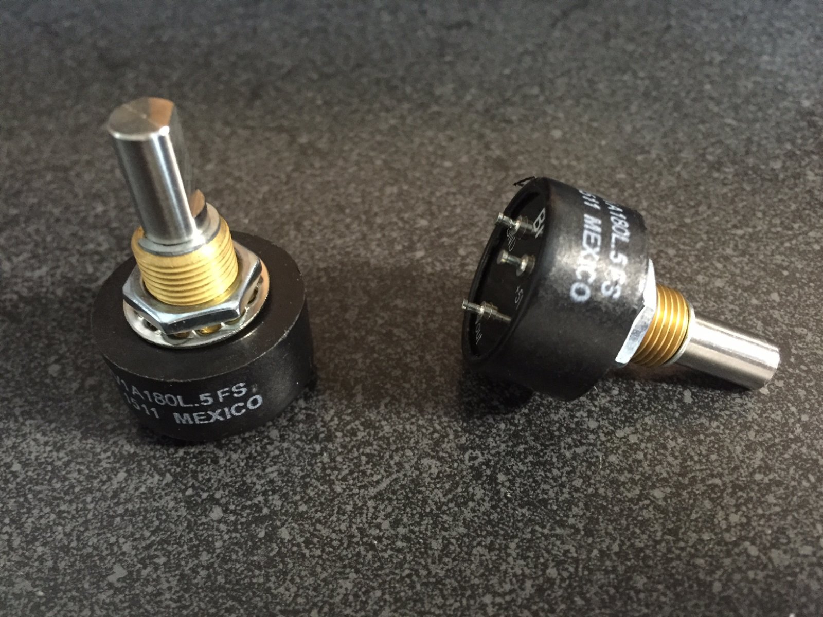

    These pots are listed at 1000megOhms minimum, I keep reading 10k ohm min/max. Looks like neither of you had issues... but..?
    Also, is there any advantage to going with the 180* vs the 360* for the same price? If the resolution is the same (12bit), then the 360 should give you a little more leeway in mounting errors, yea?
    180*: 6127V1A180L.5FS TT Electronics/BI | Sensors, Transducers | DigiKey
    360*: 6127V1A360L.5FS TT Electronics/BI | Sensors, Transducers | DigiKey
    Spending more on 3 pots than I did on all my motor controllers is giving me anxiety. Thanks!

    You could technically get away with 90*, if you don't use more that 40 degrees up and down, which would be the ideal, but personally I use 180 for an extra bit of headroom, see here: https://www.xsimulator.net/community/threads/hall-effect-potentiometer.4948/#post-48019
    With high accuracy, long life and unable to be damaged by over rotation, Hall sensors may have a higher upfront cost, but are good value over time.

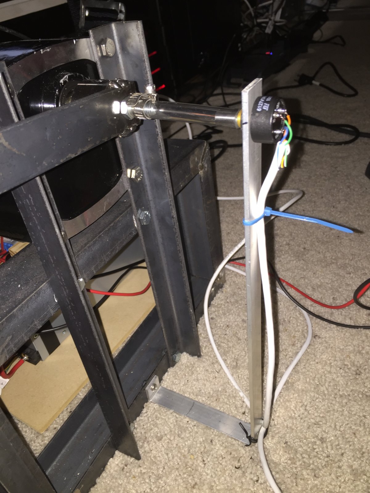

    I went ahead and ordered the 180* versions. If I go beyond 90* in any direction I'm in trouble anyway. Thanks noorbeast!

    Thank you so much for this recommendation. I was having a terrible time 3d printing gears and designing a system with a hall effect sensors. they were not cheap in Canada (28$CAD) each, but well worth it.

    6127V1A180L.5FS potentiometers seem to be out of stock everywhere, has anyone found a suitable replacement hall effect potentiometer?
    22,227
    154,831Coins
    +11,227 / 57 / -2
    Any Hall sensor with these specs should do the trick: Hall Effect Sensor, Position, 180°, Flatted 4.5 V to 5.5 V, Pin, Cylinder Rotatable, 200 mV
    Technically you could get away with a 90 degree hall sensor (45 degrees up and down), but personally I think a bit of headroom is worth the compromise in resolution.

    Thanks @noorbeast i spent a couple hours poking around and I found 90s and 360s in the above potentiometer but as you say 180 is really the ideal for my sim. Trouble is I haven’t been able to find many other manufacturers who make a 180 hall pot. Most are 360s and the only others I have found in 180 are one by CALT that is $42 and one by P3 that is $67 which is really more than most would be willing to pay for a POT. Mouser claims to be getting more in stock in a month or so, so I may just place an order with them and wait it out unless I can find something comparable. This one seems to be a bit of a unicorn!

    I as well use these (TT Electronics 6127V1A180L.5FS), can’t believe how durable and hard core these have been. While setting up PID in SCM3, actually had one lock up tight because of the direct connection i used to motor, started with a squeaking sound, then locked up tight after only 5 mins of use.
    Had to use good ole WD-40 and some vice grips to get it to move, after a min of trying to unfreeze, the whole brass thing started to rotate inside the outer casing, at which point I assumed was clearly trash now. Had to place mounting nut on it just so i could hold with wrench and attempt to free with vice grips. Ended up actually using a Drill on end of sensor to spin free at high rate of speed!..And amazed that it unfroze and Still Works!!
