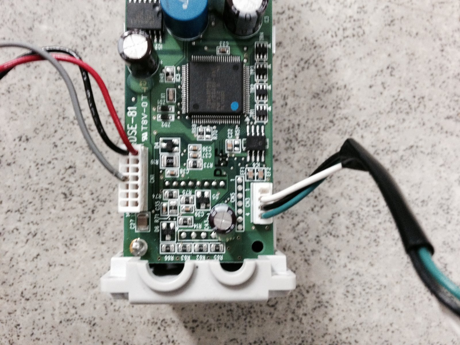

    I did but no clear info for what I may try to do
    How many wires, colors , purpose of the wires in the simxperience plug are unknown to me .
    If someone could summaraise what are those wires going to that plug that would help greatly
    I guess I would have to remove the plsatc cap and compare to the snc5 I already have in my rig . It would be possibly easier that way ...
    however I may not buy that actuator and not take a chance as I am not really in my confort zone

    Hello Gelatin are thes the wire I should see inside the plastic cap of any snc5 ? These are the one we use for motion ?
    thanks

    I'm having issues trying to make this work related to the assigned axis's are now 1a-6a and 1b-6b . Do I want a 1a and a 2a or a 1a and a 1b ? Thanks!

    Hello Jacob , it could be that the older model sx3000 is not compatible with sim tools? Anyhow, for one thing you could use a devantech rs485-USB or similar interface and rewire the controls. I believe you d need only one interface per snc5. I ll edit this reply later with info about rs485
    http://www.ebay.ca/itm/FTDI-USB-to-...642426?hash=item3ad715f07a:g:RikAAOxyeZNTR99F
    or http://www.robotshop.com/en/devantech-usb-rs-485-interface.html
    your can rewire quite easily . there is doc available in here
    edit : noorbeast understood you question. sorry I did not. ibelieve you ll be ok...

    In most cases the Axis Assignment grouping will be 1a, 2a and so on.

    Thanks guys! It was 1a and 2a that I needed to make it work. Elite Dangerous is a go :)

    I need some help please. Reading thru the posts it is still unclear to me does Simxp use the grey wire to +24V or 0V
    Talking to shige from Frex he says they use the grey wire to 0V not +24V
