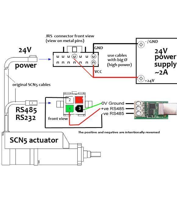

    Newbie here, trying to convert my old Frex SimConBase. Thanks for this tutorial, this seems like a great community!
    I have ordered the Devantech USB->RS485 serial adapters. I plan to cut and use the existing SimConMotion wires and connect them to the adapters. My question is, can I connect them according to this diagram I found posted by Brian Clancy on racedpartment:
    Thanks in advance for any advice.

    Hi, u can use your existing power connections, just connect the serial cable wires to the RS485 adapters as in the figure above.

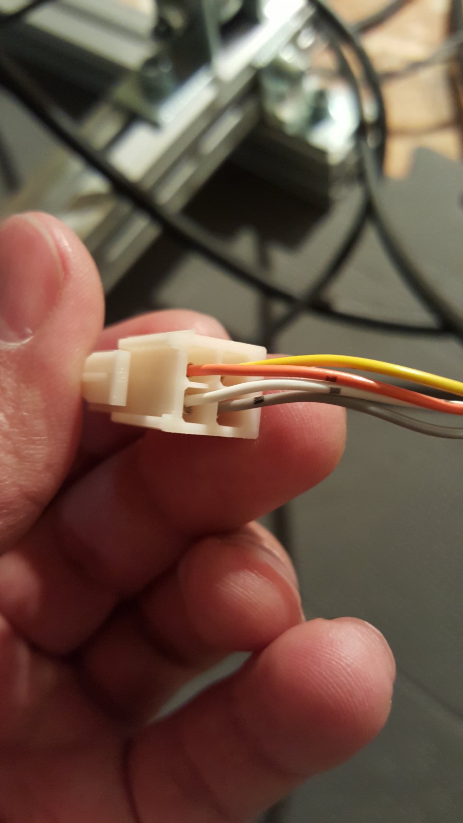

    I think I need a little help. :(
    I have hooked up the old Frex actuators using the diagram I posted above. Devantech USB->RS485 adapters and re-used the Frex cables being careful to make sure the wires line up as above.
    I have configured GameEngine exactly as MasterYoda has in his screenshots. However, the Output test results in no movement at all. When I start the GameEngine application, all I see is a very quick flash of the red & green lights on the Devantech adapters.
    I have tried to check for the conflict using TBVST Visual Tool but I cannot get that tool to load up past the "Set up Communication" dialog box. No matter which Port I specify in that dialog (i.e. COM3 or COM4) it tells me "Failed in opening communication port". The red & green lights on the Devantech adapter do flash repeatedly right before this failure message appears.
    I am running Windows 8.1 and when I look at the Devantech adapters in Device Manager, it says all OK with updated driver already installed (they were recognized already, I didn't have to update the drivers manually).
    Any tips? Thank you!

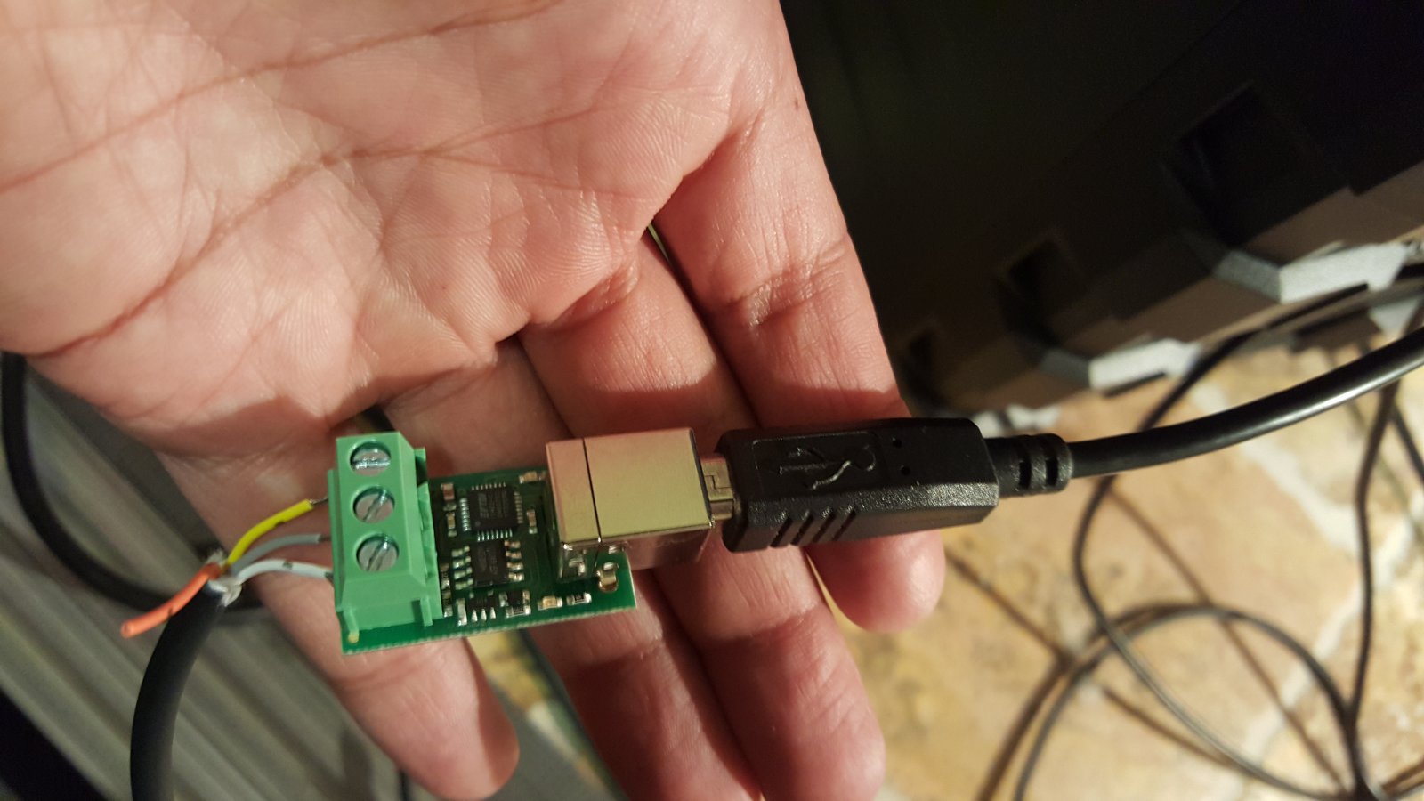

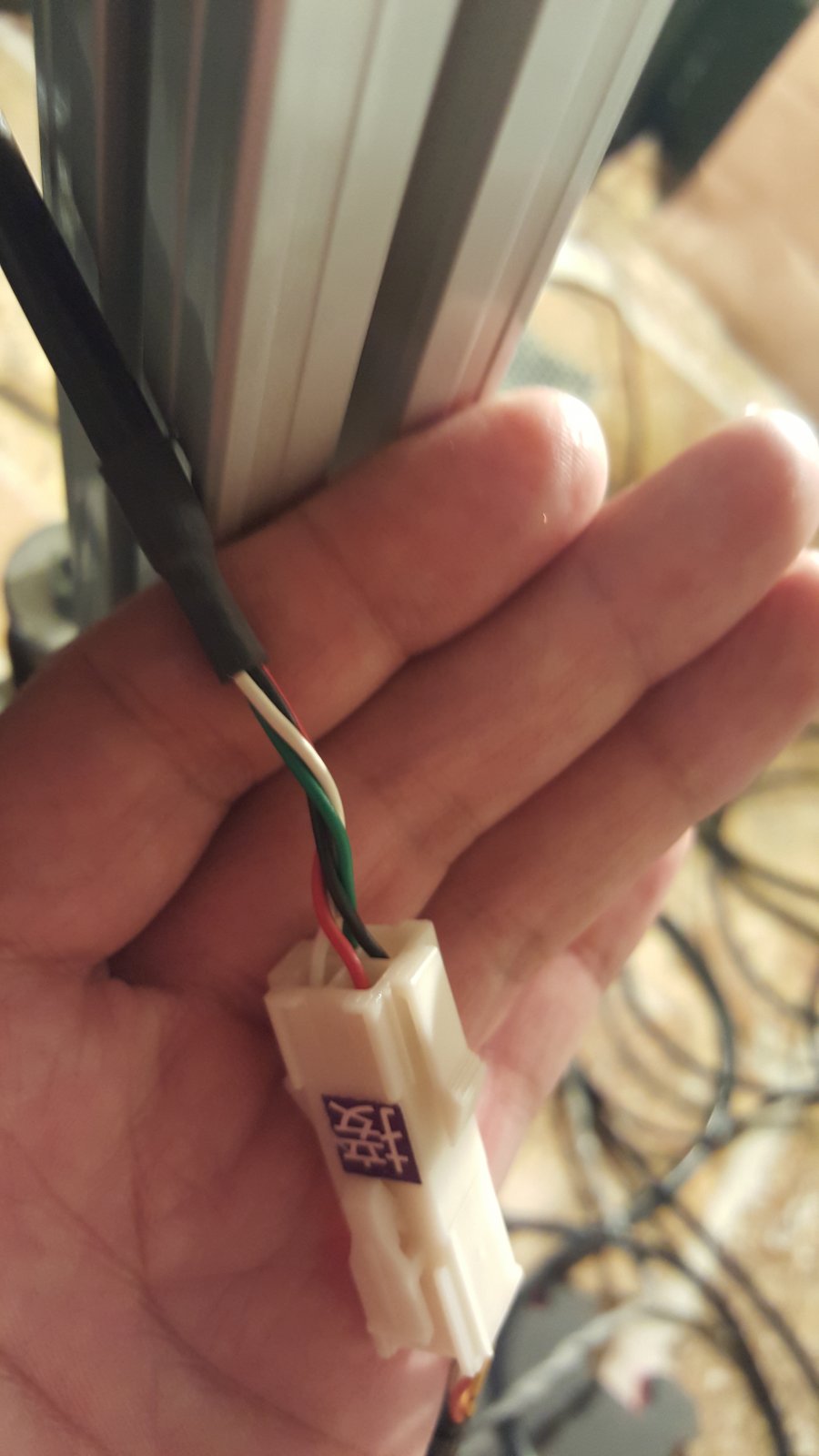

    If the tool is giving you a COM error there may be an issue with how you wired the adapters. If the COM port is properly set in device manager, and the tool cannot communicate with the actuator, then there is probably a wiring issue. Can you show a picture of your actual wiring into the adapters?

    Ok please stand by I will upload pics!

    Good! If only 1 is working, that means you need to change the ID to 0 on both.

    Okay the visual tool now working, I can see COM3 is set to Axis 1, so will attempt to change now...
  20. RayRay
    RayRay Member
    Feb 29, 2016
    33
    Toronto
    559Coins
    +6 / 1 / -0
    SCN5
    Success!! Movement in both actuators. Only that Pitch slider seems reversed.
