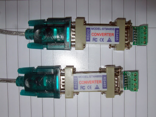

    I have just been looking on ebay the USB to RS485 adapters all come from China, there aren't any in the UK so I would have to wait a while for postage.
    Just wondering if I could do things this way and get all the components quicker because the're all UK sellers.
    USB to RS-232 adapter x 2
    http://cgi.ebay.co.uk/USB-2-0-TO-RS232- ... 240%3A1308
    RS-232 to RS-485 adapter x 2
    http://cgi.ebay.co.uk/RS-232-to-RS-485- ... 240%3A1318
    Do you think this would work, I can't face the thought of waiting another few weeks for my simconbase to be posted back!!!

    Hi, i think this Adapter would be better, but ask the others SCN5-Users before order this Adapter ;). I`m not a SCN5 User

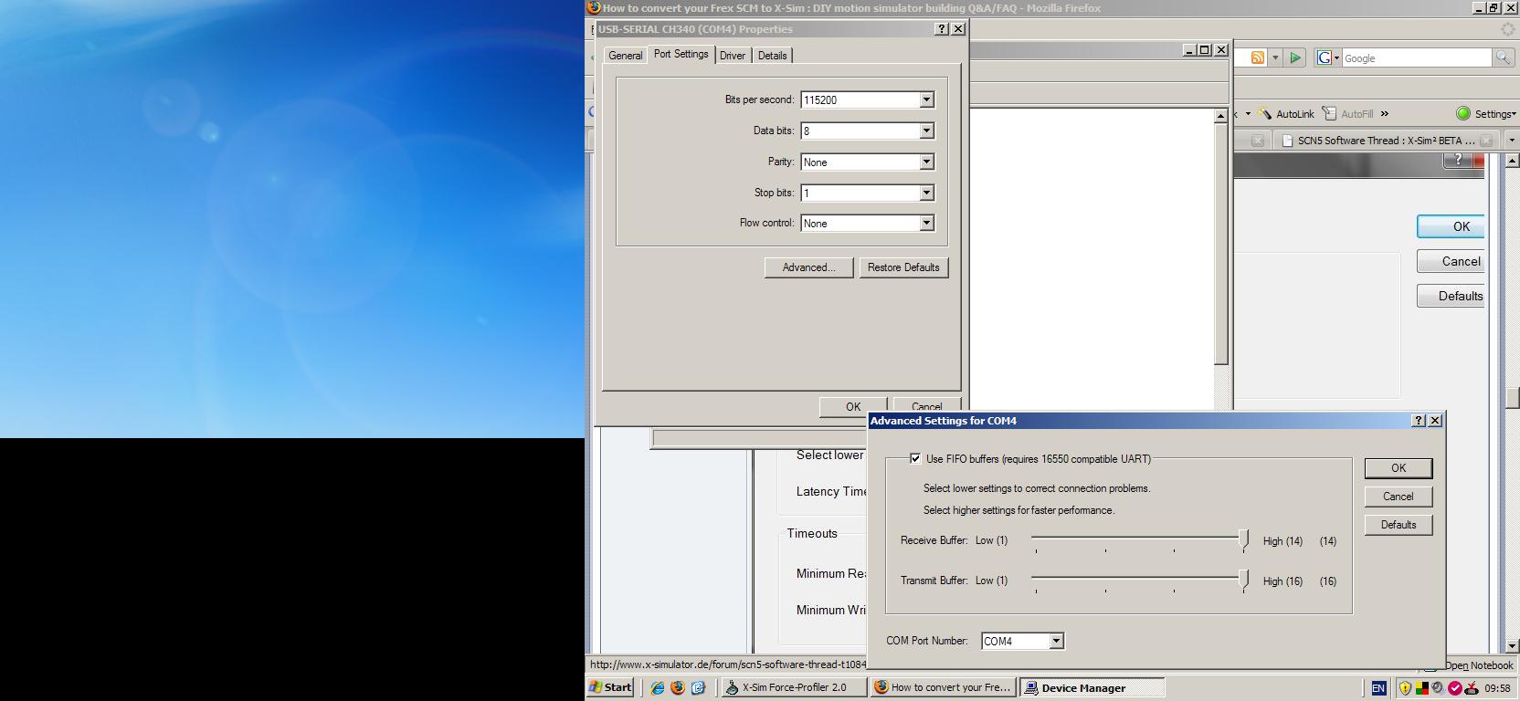

    My UK USB to RS-232 adapters have arrived along with my RS232 to RS485 adapters so all I need now is my cables then I can start my testing.
    I have taken a screenshot of the Serial port settings of one of the adapters to get some input on configuration, given the options available with my converters do you guys think I should be ok?

    There may be a better driver for your adapters. This looks like the generic COM port interface drivers from Microsoft, not hardware specific drivers. Does your adapter use an FTDI chip? I'm not familiar with it.

    The USB to RS232 adapters say HL-340 on the side, I have also uploaded a picture of the adapter so you can see.
    The following is a dump from the driver .inf file I am not sure if this can help you determine if there is a better driver out there.

    Looks like an old Xircom product. Intel took over Xircom some time ago and stopped supporting their products. Try googling Xircom HL-340. You may find a better driver somewhere. You could also look at Intel but I doubt that they support it.

    I just found this review of the adapter...
    Works well, and cheap.
    Posted by adrianjball on 11/22/2007
    Involvement: Expert (understands the inner workings) - Ownership: 1 day to 1 week
    Price:
    Ease of Use:
    Build Quality:
    Usefulness:
    Overall Rating:
    Pros: Cheap, compact, well made.
    Cons: Uses HL-340 chip, so doesn't do unusual baud rates. You need an FTDI chip based converter for that.
    Other Thoughts: The driver on the included CD is an executable, that needs to be run BEFORE plugging the converter in. Windows 'found new hardware' wizard can't find it if you have not run the executable first! For WinXP it is: \USB-232\HL-340\HL-340.exe
    Bottomline: Great if you just need a simple serial port. If you need to connect to unusual hardware you may need a converter based on an FTDI chip instead.

    So will this not work with Profiler2 will the SCN5 not be picked up in the plugin.
    How about the serial port built into HP & Dell laptops. I have a few spare laptop's lying around they typically only have one Serial connection each so I would have to use two laptops, but would that work with Profiler2 and the RS232 to RS485 adapters I have above?

    Your adapter will probably work. I can't say for certain because it hasn't been tested with X-Sim yet. I doubt that it will have as good of switching times, etc.. as an FTDI product though. I was only recommending to look for a better driver ( than the windows default) in an effort to improve it's performance.
    Any COM port should work. X-Sim has good flexibility to accomodate a variety of adapters. However, most of us prefer (and some of us are a little more outspoken about it) FTDI chips.
    Don't give up on your adapters yet. They may prove to have acceptable update rates. Xircom did not produce terrible quality products in my experience.
