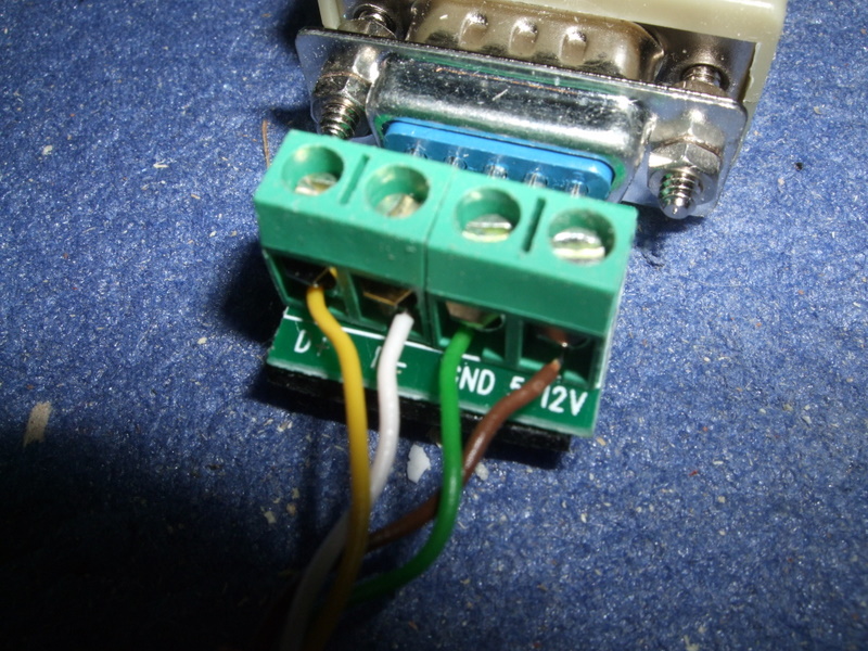

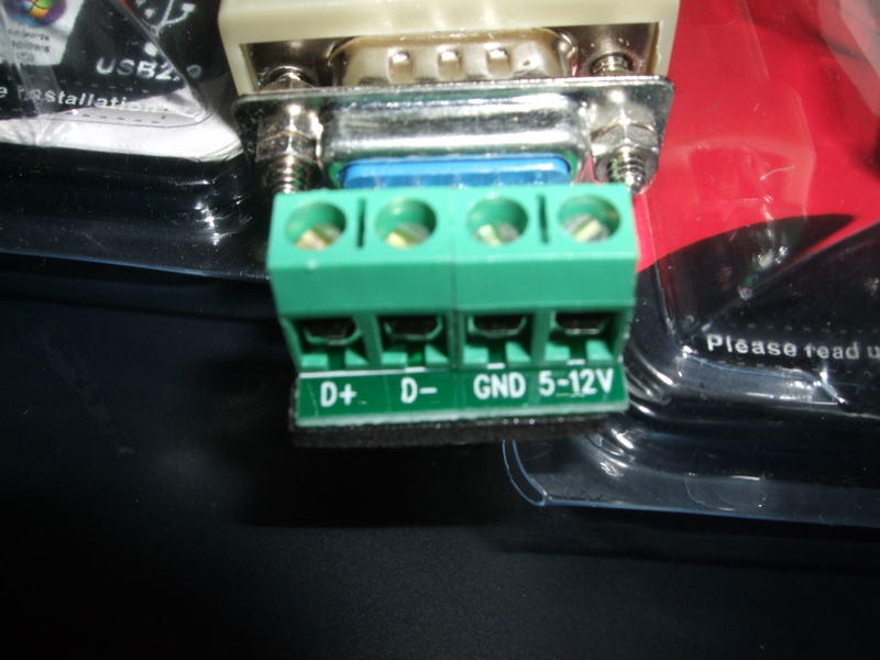

    I received my SCN5 cables today from Christian and I now have my FTDI based USB to RS232 adapters, so I am all set to wire things up once I finish work and get testing. I just wanted to check though can someone confirm the wiring configuration for my RS485 adapter so I am 100% clear, I have attached a photo that shows the RS485 configuration.
    I just want to be 100% clear which wire goes to which terminal.
    My RS485 is marked (D+, D-, GND, 5-12v) I wanted to know what TRx White, 5V Brown, TRx Yellow and GND green correspond to, GND is straight forward :)
  15. egoexpress
    egoexpress Active Member
    Dec 13, 2006
    3,839
    Germany - Frankfurt/M
    421Coins
    +10 / 1 / -0
    Refferring to the cables which I have sent you:
    Brown -> 5V-12V
    Green -> GND
    white -> D-
    yellow ->D+
    or
    Brown -> 5V-12V
    Green -> GND
    white -> D+
    yellow ->D-
    It does not harm anything to switch the data wires D- and D+. Just try it out to find the matching configuration.
    But prevent misplacing 5V and GND, as this could cause some damage.
    Regards

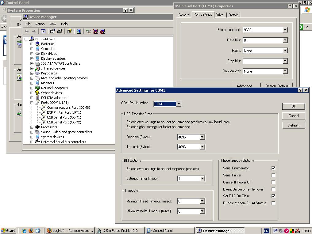

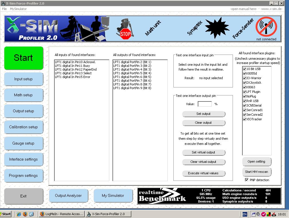

    I hit a snag, I have wired the SCN5 actuators to the RS485 adapter and switched everything on including the 24volt powersupply. When I go into Profiler2 the SCN5 devices are not showing up even though the FTDI RS232 drivers are configured correctly.
    Do you think I need to swap the white and yellow wires around?
    Thanks,
    Paul
  18. mrpio
    mrpio New Member
    Mar 12, 2009
    27
    0Coins
    Swapping them did the trick for me (my signal terminals were named A and B, A was white)
  19. viper221w
    viper221w New Member
    Mar 7, 2009
    28
    Technical Architect for Accenture
    UK
    333Coins
    That did the trick!
