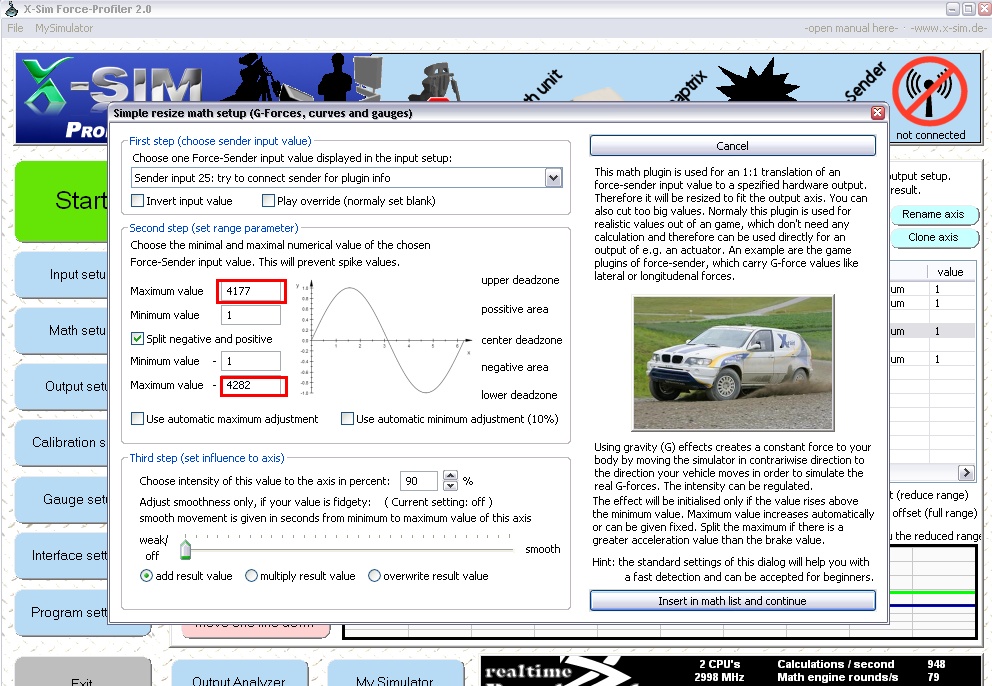

    Assuming effect 25 is longitduninal g-force in rFactor, then use these two values to adjust either throttle or braking seperatly. (split maximum has to be checked)
    Rising one of the max values causes minimizing the actuator action, lowering a max value causes more actuator action.
    AGAIN: Please use the proper forum sections for game profile related issues! This thread concerns the hardware conversion only!

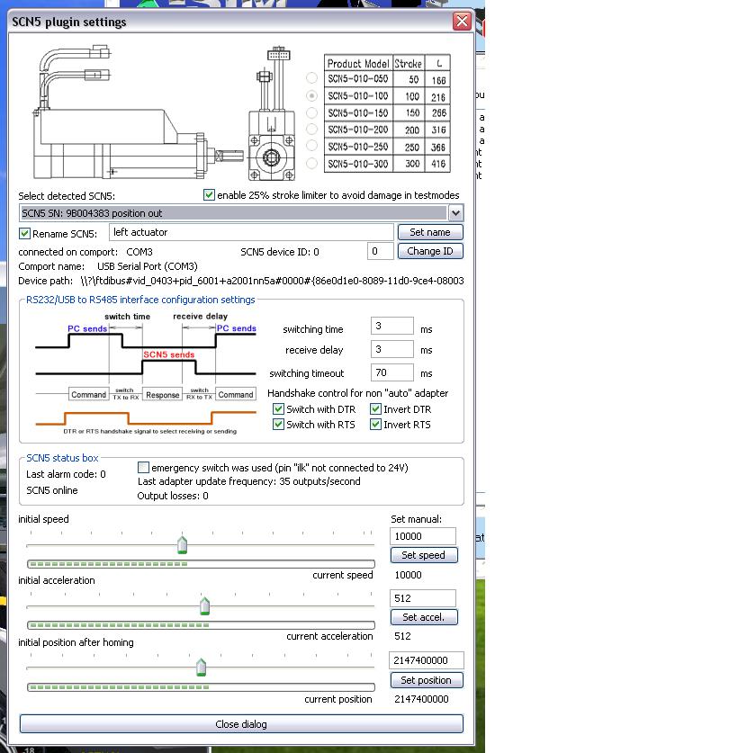

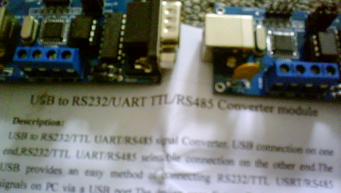

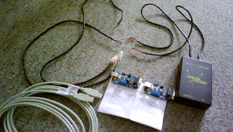

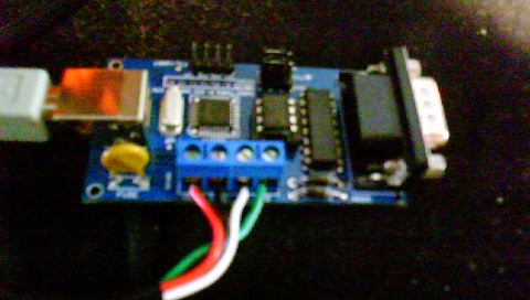

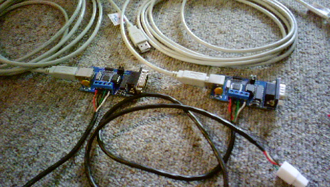

    I have the USB to RS232/UART TTL/RS485 Converter Modul insall
    And Windows Periferie Manager write:
    But the X-Sim 2.0 cant find the SNC5 Actuators.
    Another Pics from Install;
    Actuators connect to RS485;
    -green plugin to B
    -white to A
    -black to GND
    -red to VOD
    Is that correct?
    And Jumpers from PCB Converter Moduls,i have all plug testet and the actuators cant find.

  9. egoexpress
    egoexpress Active Member
    Dec 13, 2006
    3,839
    Germany - Frankfurt/M
    421Coins
    +10 / 1 / -0
    Try to switch green and white
    regards

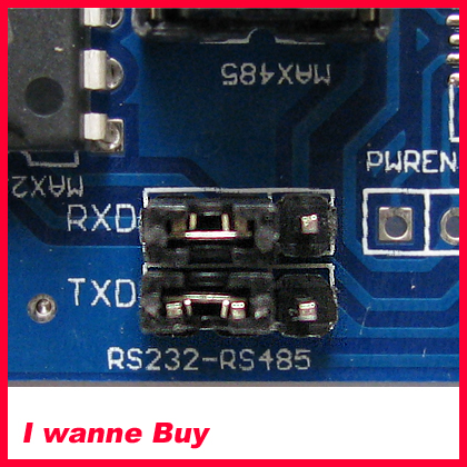

    I am not sure but it looks like your jumpers on the converter are wrong. They should be on rs485 and not rs232.
    The only picture I could find was this one. This is how not to connect them.

    I have the Jumper Postion now for the Converter Modul;USB to RS232/UART TTL/RS485)and Cable connecting
    Made Website:
    http://www.nbglin.com/485.htm
    Green Cable = B
    Withe Cable= A
    Black Cable= GND
    Red Cable= VOD
    Warning, the red Cable(VOD) not mistake with the Cable (GND)
    Jumper connect from Pic works good;
