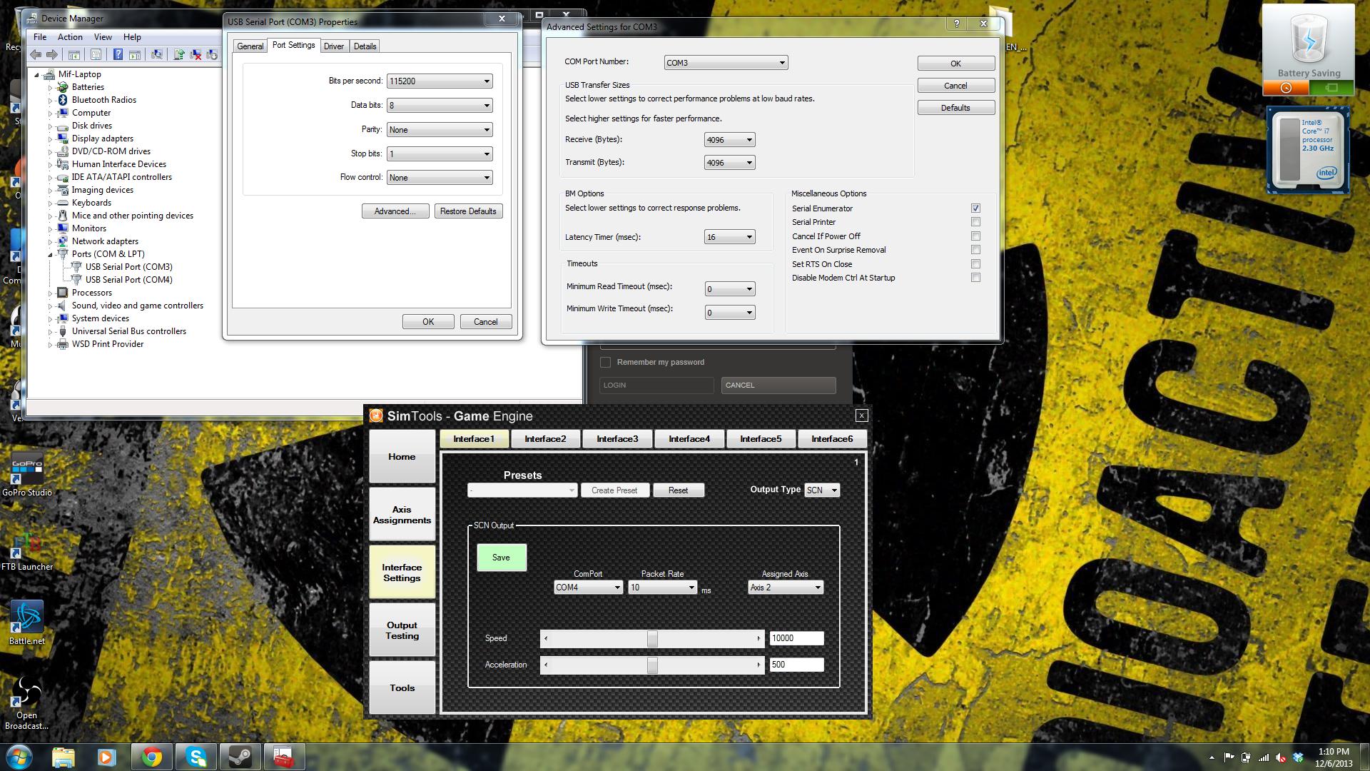

    I can't seem to get any motion out of my SCN5's with this new setup. I got the RS485 adapters and actually got new custom cables directly from FREX for about $65 shipped to the US.
    I did notice with the new cables that the actuators dont move and center when power is applied like they used to, not sure if thats normal or not.
    Any hints I may have missed?

    Could you send us some screen shots of your Com ports configuration as well Axis and DOFs configurations (similar to the ones I posted in the tutorial)?
    Actuators should move when you start the Game Engine, they go all the way up, down and then center fast!

    Oh jeez. I get that "typo" all the time. Here are my port setups. I am using cables that I got from FREX, so the wiring should be the exact same as what comes off the actuators.

    Incorrect settingsthere, its actually set Latency Timer as 1ms and Set RTS on Close is also checked. Still no movement.
