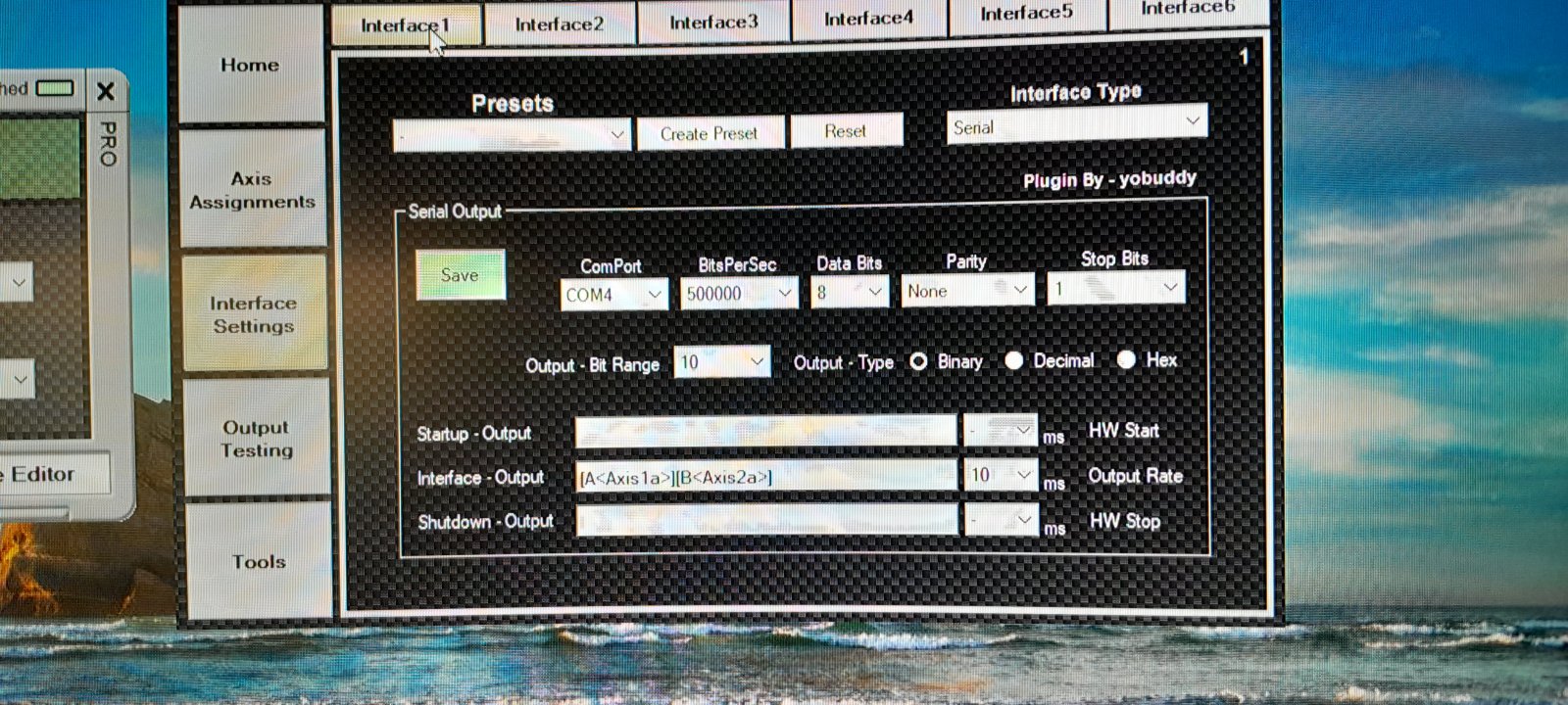

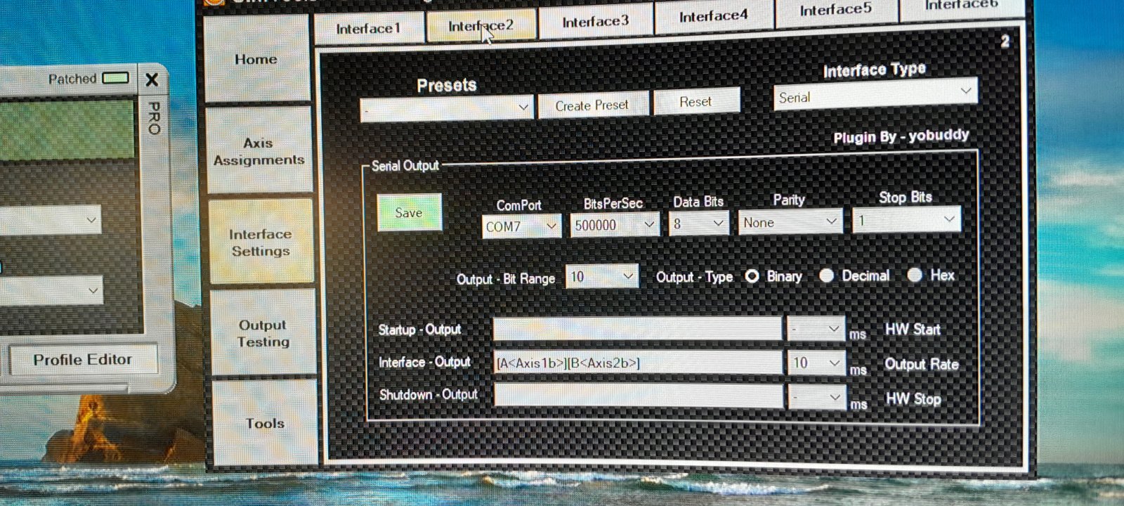

    @noorbeast @Rico Mortis So guys', after much stuffing around today and trying the different interface axis settings recommended by you guys, I couldn't get any of them to work with my two Arduinos and 4 motors in sim tools. All worked in SMC3 as needed. I appreciate this is one of those things where there are so many possible scenarios with so many different sim platforms, versions of sim tools etc. It's one of those "one shoe doesn't fit all" situations.

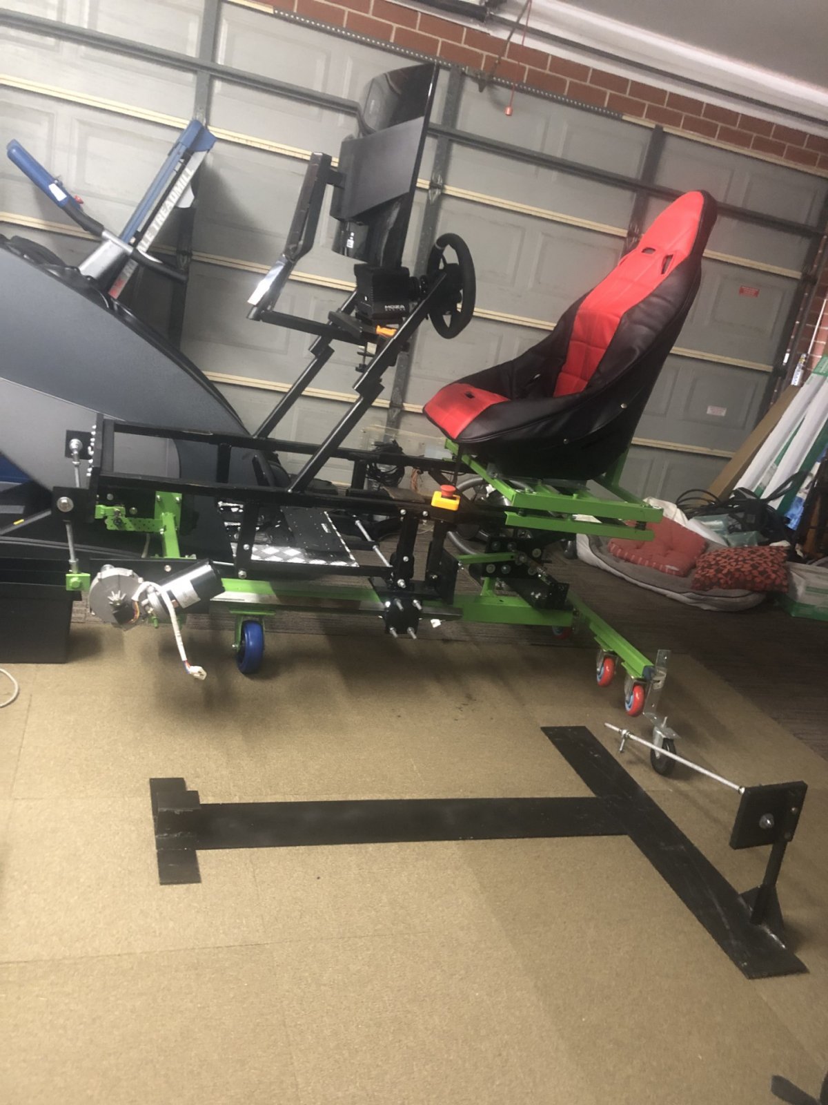

    So I am passing on info that may help others heading down this road, I got my 4DOF platform working with x 2 Arduino Uno R3's, x 4 IBT-2 H bridges, x 4 big worm drive 12vlt DC 180 watt motors powered by x 4 50amp PSU's. 2DOF forces on my rig include:- pitch, roll, sway, heave (with spring assist) ,and surge on the two front vertical motors. The 3rd DOF is a horizontal axis, the surge axis on the 3rd motor. A trolley rail system that carries the entire top frame fore and aft. the 4th DOF is the traction loss axis, also a horizontal axis on the 4th motor arcing the rig left to right at the rear of the platform, simulating yaw if in a flight sim, or traction loss in a vehicle.
    The following interface settings were required to get the platform working in Sim Tools. (also see attached photo's of Sim Tools interface window) For Arduino 1 (the two front vertical motors) the interface input needed to be:- [A<Axis1a>][B<Axis2a>] For Arduino 2 (the two rear horizontal motors) the interface input needed to be:- [A<Axis1b>][B<Axis2b>]. This is using Sim Tools build 2.6. I got on this thing today after a big week tweaking balancing issues, alignment issues, wiring issues and today, sim tools interface issues, but it was all worth every bloody swear word produced.
    Thanks for the input (ha ha get it) guys. The main thing is it's off and running. I'll post a video here of it's maiden run today in Assetto Corsa in a couple of hours. Got a lot of refining to do in sim tools now and will need to run a new tuning centre session with the new axis. You know, the usual bullshit with these type of things.

    Beta testing today in game. A lot of refining to do, but the motion is incredible. A bit scary to be honest. It'll take me a while to adapt to the monitor on the rig now. Was using a static monitor on the 3DOF. I really like it.
