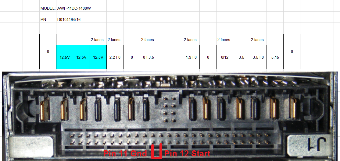

    DC motor
    Thank you RacingMat for a realy good information..I did all good to start with my Awf 11Dc 1400 W ie. Shorted pin no. 11 and 12 and psu started well but I short another 2 pins in amoung that 8 pins and my psu got shut down:( and after that now only one light of psu is getting on and one fan is running and there is no power supply even I shorted pin 11 and 12. Please help me how will I start it again?

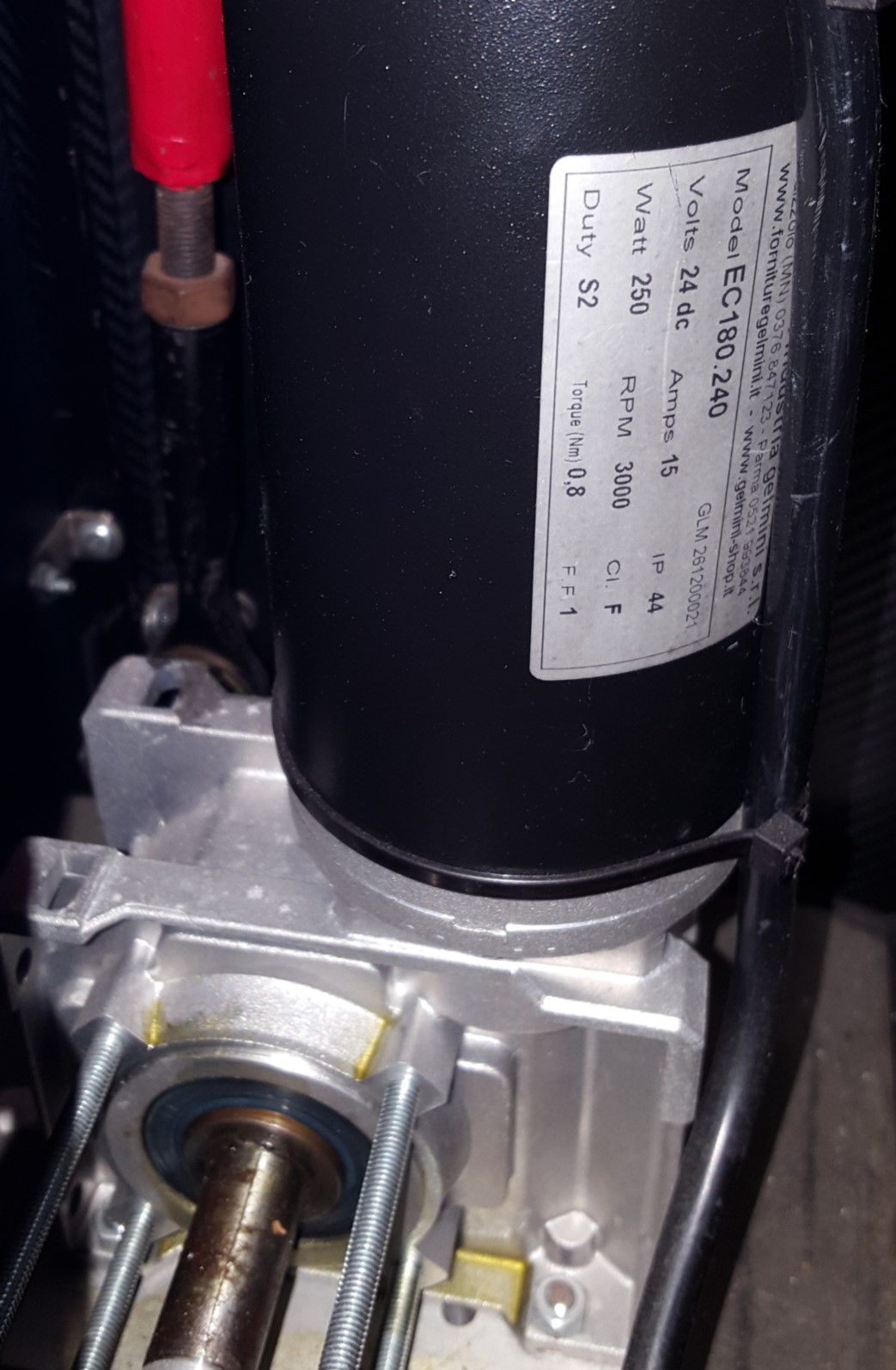

    +40 / 0 / -2
    I tell my experience: I use for my simulator, arduino and sabertooth 2x32, with 2 24v engines, 2 power supplies put in parallel 600pb dps with the modification of one of them of the earth, to make the simulator work quite satisfactorily I modified the pid in the Arduino code making the movements slightly more docile, without taking away the pleasure of the simulation. only in some cases one of the power supplies goes into protection, and I immediately resolve by switching off and on again.
  6. dualclick76
    dualclick76 Active Member
    Mar 23, 2015
    163
    italia
    11Coins
    +40 / 0 / -2
    questo è uno dei miei motori.;)
