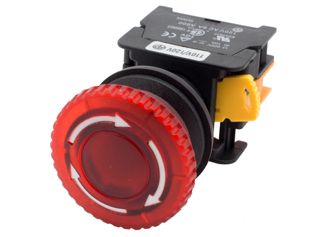

    What Nick said, just add another contact to the switch and keep both power supplies separate.:thumbs
    You could also switch the supply voltage TO the power supplies via a emergency stop switch. That way you would only need one contact. But that obviously requires you to switch the mains voltage which can make things dangerous if not done right.
    So again, the best option would be to add a second contact to the switch.

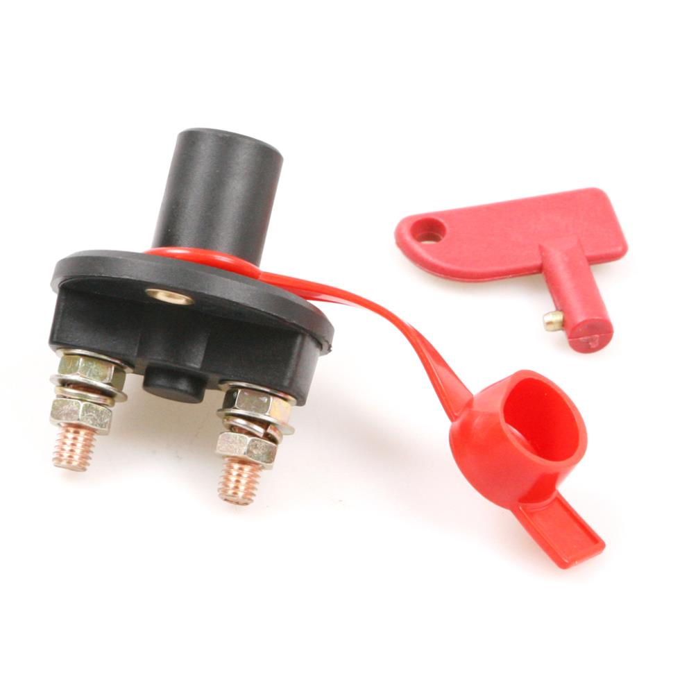

    Thanks for all the help guys!! I really appreciate all the responses! I had one of these...
    laying around so I wanted to use the key sort of set up for both psu but I think I'll just go with 2 switches.

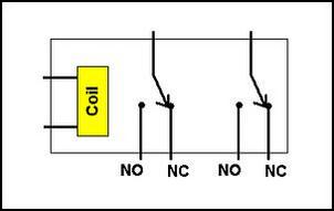

    I did see one of these...
    called a "Double Pole, Double Throw relay"
    "A Double Pole, Double Throw relay allows you to switch two different circuits simultaneously. The 'Double Pole' bit just means that it has two separate inputs that can be switched - and we now know what the 'double throw' stuff means. With this type of relay you can:
    - turn on two completely independent circuits
    - turn one off and one on
    - turn off two completely independent circuits"
    but I think I'll go with just 2 switches for 2 psu. Thanks again!!

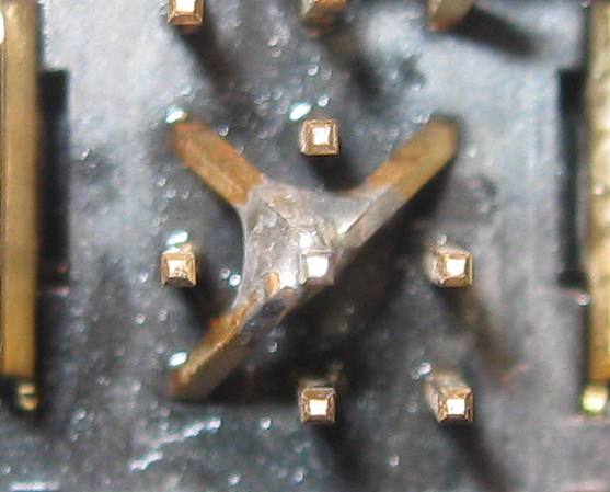

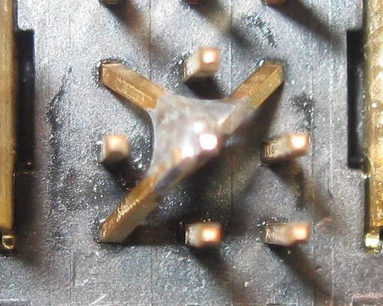

    There's no quicker, simpler, or more reliable means of converting a DPS-600. It takes all of a minute to accomplish.
    As stated above, simply bend the pins together and solder with a fine soldering tip. The non-used pins can be bent out of the way to create more room if desired but I have never found this to be necessary.

    I would be weary suggesting newbies trying that method Madgino. My fear is Worst case scenario......A Pin breaks then the user is left with either diving in Far deeper than they had imagines into the wiring, or buying a new supply and starting again.
    Looks nice tho. :thumbs

    Once you try it that way, you'll never go back ;)
