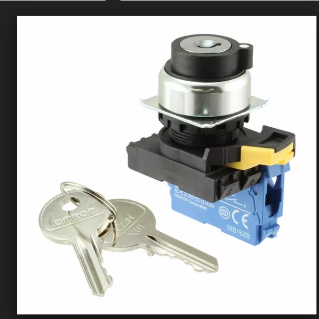

    @mirkobastianini - I think your connections might work but don't know for certain.
    Each power supply looks correct by the tutorial but I don't know about paralleling the control pins. The power supplies may or may not be ok with that. In server use with redundant supplies, if that is how they get connected, you should be ok but I just can't say for sure.
    If you got a double pole switch instead you could keep the control sections separate and not have to worry.
    Maybe someone else will know...

    You would be the first to attempt this to my knowledge, Be sure to let us know if they let out the magic smoke. :p
    Also agreed, if your only firing up 2 supplies, a DPST is what you want. Will eliminate the need or thoughts of potentially messing up the supplies.

    I've decided to solve problem on top: this is my switch:
    I've simply ordered another of this thing, so i can use 2 poles.
    What do you think about it?

    @mirkobastianini - that looks like the solution. Two poles will be fine for two supplies. If you ever add a third axis or more, you can revisit.

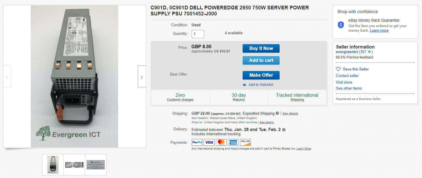

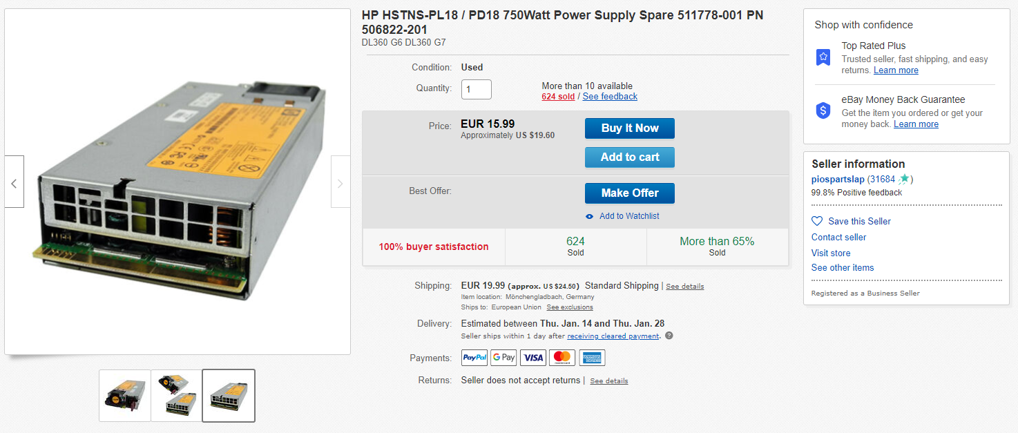

    Hi! I am looking for a good power source for a 2 DOF build I'm planning on making and I was thinking of getting two 750W supplies.
    I can't decide between two server PSUs, one is from HP and the other from Dell.
    I can't add external links yet so I will upload a photo of both eBay listings.
    HP:
    Dell: (only 4 units left)
    Can someone please help me decide between the HP HSTNS-PL18 and the Dell 2950 PSU?
    Also the total price difference is of ~$13 (in favor of Dell), and as I am (of course) going for a cheap build, I already think I'm going with Dell. If there are more cons than pros, then I will choose HP (a brand I trust more).
    Thanks.

    I know the Dell's have been modified and used by members: http://www.xsimulator.net/community/threads/how-to-modify-a-server-power-supply-for-12v.5774/
    Not so sure about the HSTNS-PL18, you would have to research those a bit to be sure.

  16. noorbeast
    22,185
    154,750Coins
    +11,196 / 57 / -2
    Post 8 shows the modified Dell 2950 PSUs: https://www.xsimulator.net/communit...-server-power-supply-for-12v.5774/#post-65089
    With post 14 providing a brief explanation: https://www.xsimulator.net/communit...-server-power-supply-for-12v.5774/#post-68351
