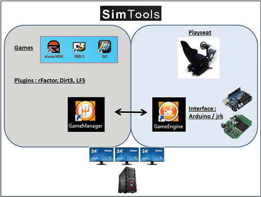

    So my gaming PC is running wireless to my router. I have an old laptop that would work. Question is, on the gaming PC, can I enable the onboard NIC card and crossover to the NIC in the laptop without effecting the gaming PCs wireless internet access? The wireless I would want to keep dynamic IP while the onboard NIC and laptop would be static.
    Thanks,
    DaV
    22,086
    154,124Coins
    +11,170 / 57 / -2
    I think this is something like what you are suggesting: http://www.tomshardware.com/forum/21854-43-connect-wireless-network-crossover-cable

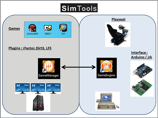

    Sorry to resurrect this, but when you say that both computers need to have the plugin, does that mean that both have to have the game installed? I am trying to run dirt rally. I have the game patched on my gaming computer and I have the plugin added on my game engine computer. when I launch the game, the buttons on my game engine computer lock out, so it is definitely connecting, but there is no telemetry data being transferred. Any ideas?
  10. value1
    Jan 9, 2011
    2,192
    Zug, Switzerland
    14,251Coins
    +3,361 / 12 / -1
    You don't need the game on both PC's but you need to install the plugin on both PC's (with the plugin updater) and to patch the game on the game PC. No need to patch on the remote PC, just install the plugin.
  11. Scotty1186
    Scotty1186 Member
    Aug 23, 2016
    68
    Usa
    148Coins
    +22 / 0 / -0
    Thanks for the info. I think I might be having issues with dirt 3 patching. Everything indicates that it is connected, but there is no telemetry being output.
  12. noorbeast
    22,086
    154,124Coins
    +11,170 / 57 / -2
    Dirt 3 64bit is patched to the MyDocuments -> Game folder, while the 32bit version is patched to the Dirt3 game install folder.

    FYI, I had to set the IPv4 of the gaming pc in the tools windows of the game engine of the sd computer. Otherwise it did not work in my case.
