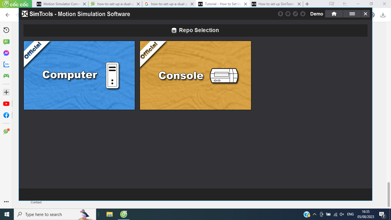

  13. kendy
    kendy New Member
    Jun 19, 2023
    8
    62Coins
    Hey Guy ! how to setup a dual pc installation of simtools ver 3.0 ? Thanks!
  14. yobuddy
    51,704Coins
    +5,204 / 19 / -0
    Dual PC setups are only in V2, computers are so powerful these days, that dual pc setup's were deemed not needed for v3.
