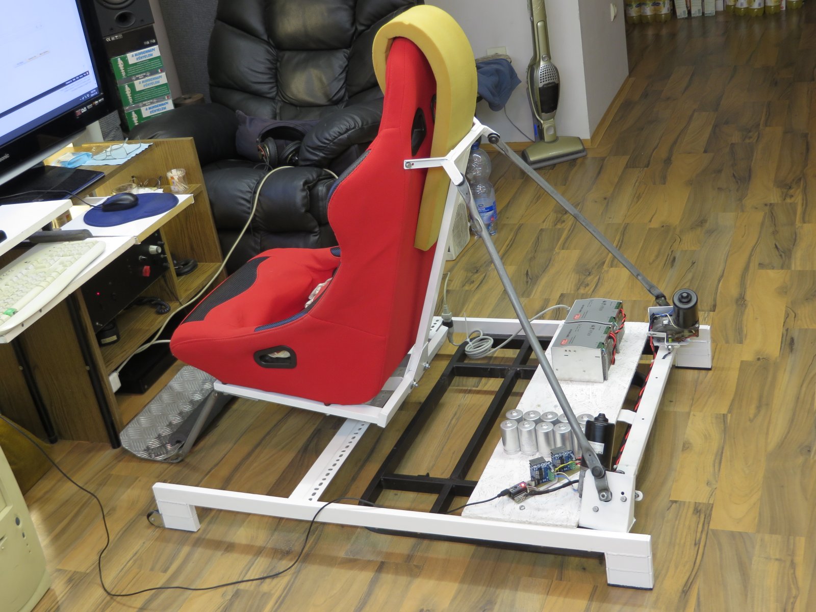

    First it was made that way so i could expand it pedals and wheels,
    then i had to elevate 8 cm-s and make a footstand so that my feet don't touch the ground and my hand don't touch anything :)
    For me, the illusion was half gone in a seatmover so had to make it a sort of full-frame.
    But i use a gamepad so it is allright. 2DOF makes up for FFB [for me at least]
    I tried with a G25 but made my compromissum. Somewhere you have to compromise.

    @Thread , most wipers are 50-60 rpm at the shaft. My dc motor are 160 rpm at the shaft.
    How is your slower wiper better in response than my faster motor?

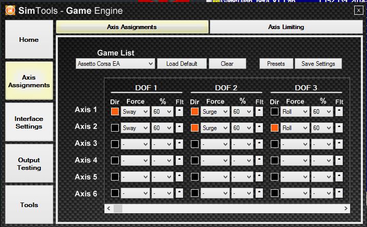

    Try for now "heave" 15%. In the tuning center go down to the best value. If it is too jerky use smoothing (but not more than a value of 3-5).
    Disable meanwhile all other DOFs to be sure.

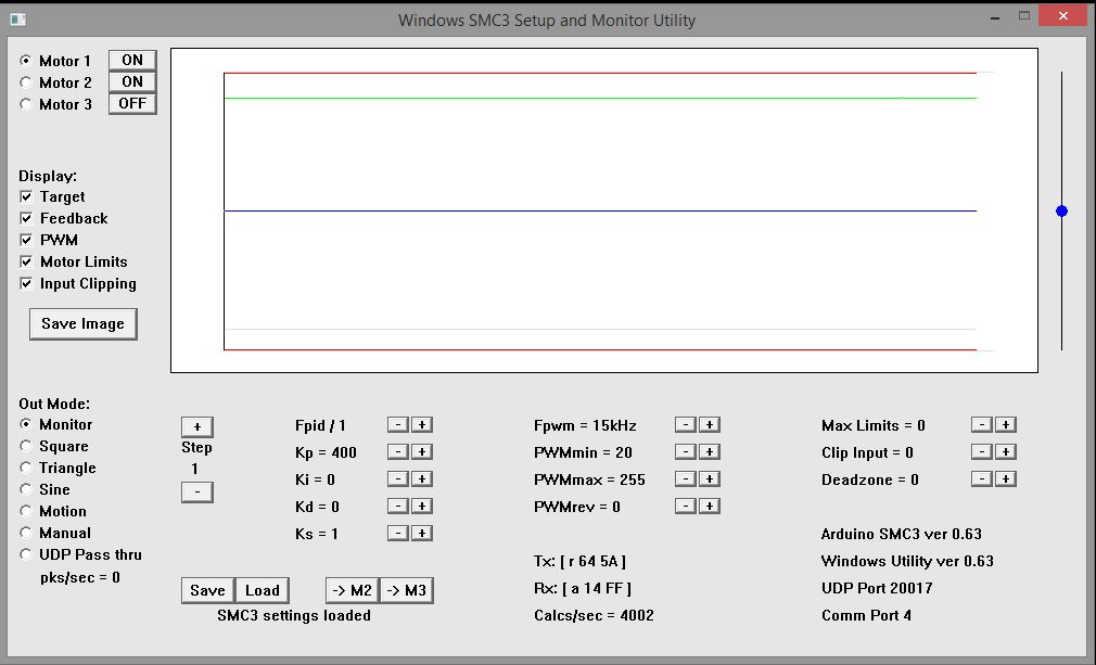

    [​IMG] Packet rate is toooo less, under 10ms is ineffective. [​IMG] Full power and kp, motors should be veeery fast...
    The lever is too high, should be at right angels to the steering rod o whatever this is.

    I tried all of that, seems I don't want heave, anyways, ripple information is mainly in roll.
    maybe heave with a delay could feel good on a bump, like the hind axis going over the bump.
    yes I wrote that not sure it is okay
    but what you mean ineffective?
    you don't feel the difference, or it makes a bottleneck in USB communication because has to send a packet to frequently?
    that is the parking position, foothold on the ground, Mains is unplugged.
    at work, the lever don't go that far, stays on the back, pointing back.

    Nearly all wipers, as far as I know are 50-60 rpm at the shaft as they are moving a wiper arm blade across a windscreen and so too fast is a waste.
    I have been through endless brands of wipers, they all moved at about the same speed. 50-60 rpm
    Since going to larger motors and faster, the response is so much better.
    At this stage, you are comparing slower motors with faster motors as the people whom are replying have faster motors than yours.
    we have told you what to do, but I suspect you may need to get faster motors to get anywhere near the response you are looking for.

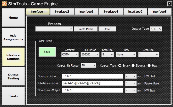

    Set Interface to 10ms or even higher (slower). When you get it working out you can try faster speeds. But do not begin at the lowest settings.

    I do not get problems with 1 ms. Now I tried again 1ms and 10ms.
    Do you know a correct method to measure if there is a bottleneck? I do not feel any drawbacks at 1ms. My ard does not have to process traction loss though.
    And there are different USB solutions, mine is CH340.

    That is exactly, what kerbs do, and if they have a sawtooth profile, then there will be a sawtooth signal in ROLL.
    And some of it in HEAVE as well.

    Today I was checking out SimTools axis output, if I can simulate the ribbing of the curbs using Roll. Actually I got some output (Roll) in SimTools, but no output on the axis. I have to set Roll to 30% and more to get some real output, if if drive very slow over the curbs, but than my seat is in a tilted position which is unacceptable. At least why using Roll if Heave do the job? Same arguments to Pitch, why using Pitch instead of heave?
    At super least I checked my FFB of my wheel, every time when it is clattering over the curbs the motors do same (using heave, of course......). If the wheel do nothing, the motor do same.
    Roll, Pitch and Yaw have to be used for the position of the car, the other 3 for getting the moves. Meanwhile a little ridiculous this discussion...isn't it?
