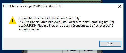

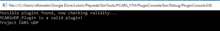

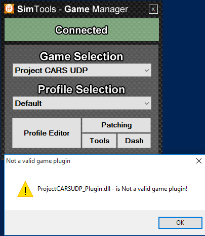

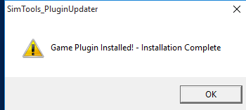

    Starting to get mad :confused:
    When I build and run the plugin in debug , I get the OK window.
    If I add the DLL using game plugin updater (just drag/drop the DLL on the icon), it looks good:
    Now, I start Game Engine and select my plugin, "et là, c'est le drame" :
    unable to load file or assembly blabla.dll or one of its dependencies. Specified file is not found.
    Then gameengine and game manager are crashing.
    When switchinf to "release" build, same error. But whan clicking start, it triggers an error :
    Is there an issue with my environment ?
    What have I missed ?
    Thanks for your help.

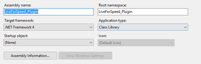

  13. yobuddy
    51,747Coins
    +5,205 / 19 / -0
    It looks like you just have a naming problem.
    In the pic above the name of the DLL is "PCARSUDP_Plugin"
    But the displayed name is Project CARS USP.
    Lets try this,
    If the GameName = "Project CARS USD"
    The DLL should be called "ProjectCARSUSD_Plugin.dll"
    And both the Assembly Name and the Root Namespace should be "ProjectCARSUSD_Plugin" for this plugin.
    check this and compile and re-install the new dll
    let me know how it goes!

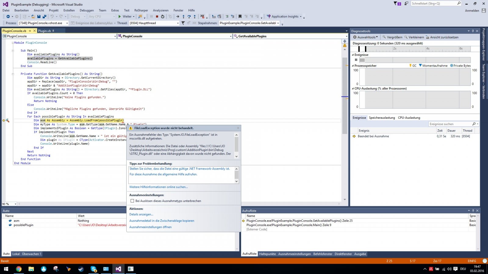

    Having crash issues with my plugin, I took the LFS sample, compiled it (without changing anything) and I get the same crash problem as soon as I send a UDP packet :confused:
    I'm using Visual Studio Community 2015
    The app is as follow:
    Tried debug/release : same problem.
    To install the game plugin, only the DLL needs to be dragged/dropped or should the whole directory be zipped and dragged/dropped onto the game plugin updater ?

    Hallo, very nice Tutorial, it really helped a lot.
    I somehow cant compile it however, I get this:
