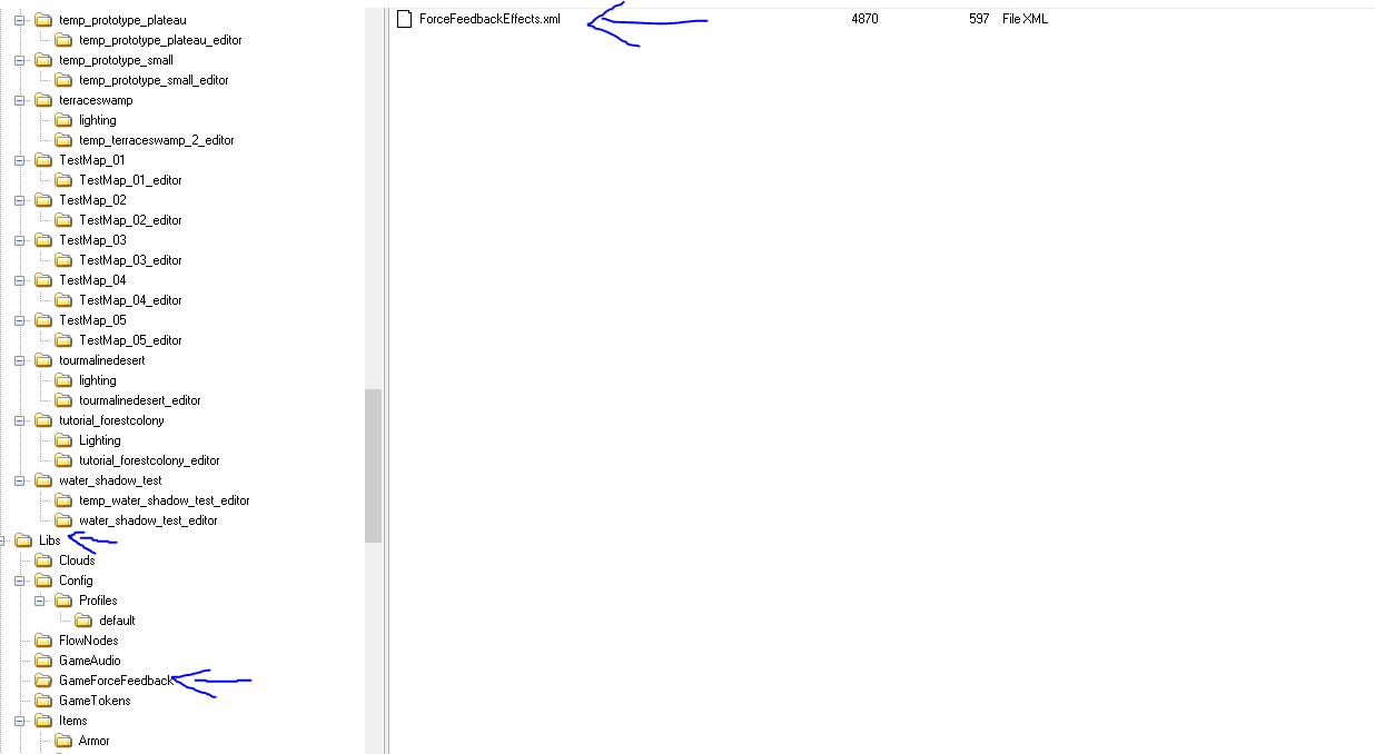

  13. TheLoneRonin
    TheLoneRonin Working at my first 2DOF Simulator...
    Dec 29, 2014
    8
    77Coins
    i want to code a plugin for "Mech Warrior online", but i dont know how to find out were i get the telemetry data cause i am a total noob at programming.
    I opend the Example "Plugin.vb" File with Visual Basic and i saw the following set up.
    Private Const _GameName As String = "Live for Speed" 'The displayed Name for this Game. (DLL_Name ==> "Live for Speed.dll")
    I found the "Life for Speed.dll" in my Life for Speed folder and i found several .dll files in the MechWarriorOnline (MWO) "bin 64" folder like:
    There is a "CryRender D3D9.dll" file, and a "CryRender D3D11.dll". Is this the file compared to the "Live for Speed.dll" file in the plugin example? Does that meand MWO exports Telemetry Data with UDP Packets like LFS? Do i have to set up this Filename in my Plugin? The game is powered by CryEngine by the way. Maybe you know how CryEngine games export Telemetry Date.
    The other .dll folders are from Steam, DirectX or Microsoft, i dont think this are the right ones. In the MWO folder is a Bin34 Folder with .dll files to, but i got a 64 System.
    And i got a another question:
    In the first Example of the Tutorial are "UDP Packets", is this a sort of file like the .dll, cause i didn´t found any of these in LFS and MWO. I only found .pak Packets in MWO.
    Sorry for my bad english by the way :D.
    Greetings:
    TheLoneRonin
    (working on a 2Dof Simulator to setup MWO with Oculus rift DK2 and a Dof Simulator)

  15. TheLoneRonin
    Dec 29, 2014
    8
    77Coins
    Ok, thanks for the answer.
    But where i can find the memory hooks? I got a .pak file with a .xml file contained called "ForceFeedbackEffects.xml":
    Maybe there i can find the memory hooks.
