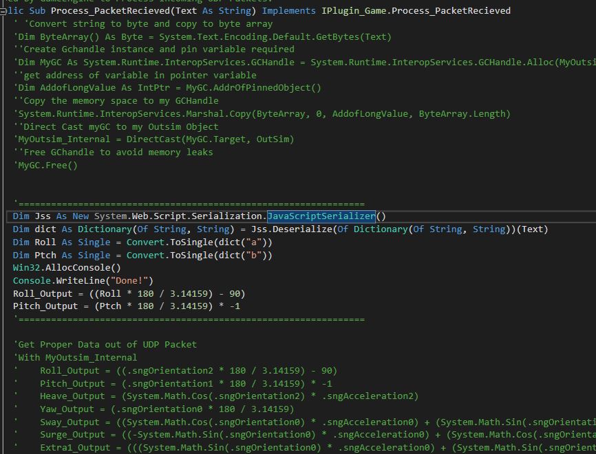

    Hi, I'm trying to use the plugin example that you provided. I want to send the data from Matlab to SimTool. Specifically, my idea is to send JSON string from Matlab and define the plugin so that it can extract values of both pitch and roll angles. I followed the procedure you posted and everything seemed to work fine, I was able to build and select the defined game from the SimTool GUI. The problem is that I've tried to send values of roll and pitch angles from Matlab and visualize them through the virtual axis in SimTool, and I was not able to see any of the values sent. Here is a picture of the modified code. Thank you for your help!

    I would copy the code you pasted there and start a new vb.net app (as a test app).
    Then see if that code grabs the data you need, because the code is not in a dll, it can be easier to see what's going on.
    Once you have the code working, simply paste it into the plugin you built and you should be good to go!
    Hope that helps man,

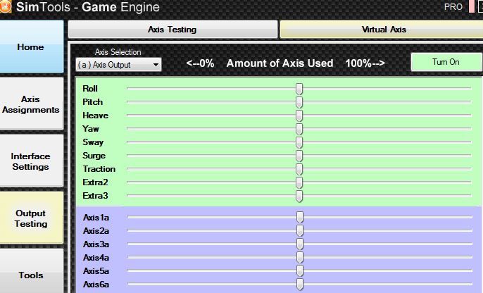

    Hey! I've tried to develop a vb.net app. Everything seems to work correctly! I have been able to see the data sent through the console. However when I copy and paste the code nothing shows up. I am wondering if the plugin has been correctly uploaded into SimTool, and also if using output testing>>virtual axis is the correct way to test if my plugin is working correctly.
    Here is what I've tried lastly: I've just sent the two variables Pitch and Roll equal to a value 45 degree. I was expecting to have the value displayed here. However, nothing shows up again.
    Also, I've realized that after selecting the game from the engine game, this pops up:
    Shouldn't be showing my name instead of yobuddy?
    Thank you in advance again for your help.

    Did you make a max min file for the plugin?
    Can you show me the tuning center buddy?
    Your making a game plugin, not a axis assignment plugin, so my tag name 'yobuddy' will still be present for the axis assignment plugin.
