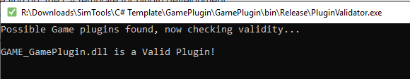

    Hi, I wrote a small test plugin by using C# template.
    When running the PluginValidator.exe it says "Test_GamePlugin.dll NOT valid!"
    What is the validator checking ? Is there a log file with more explanation what went wrong ?
    All the interfaces are implemented (as far as I can see).
    cheers,
    Arazok

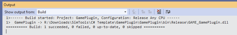

  18. llluis
    Mar 30, 2017
    164
    Quebec
    1,632Coins
    +103 / 1 / -0
    Downloading and installing Visual Studio so I can have a look for you @Arazok
  19. llluis
    Mar 30, 2017
    164
    Quebec
    1,632Coins
    +103 / 1 / -0
    Hello @Arazok, I recompiled the files from zip
    and ran PluginValidator.
    So, something you changed broke the code.
    What did exactly you do?
