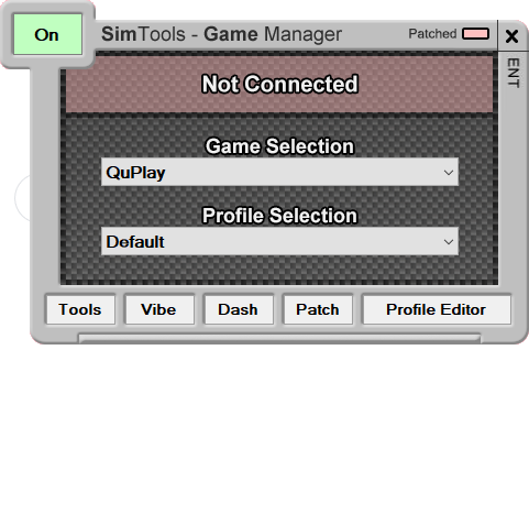

    I think the import code just needed some correcting is all.
    I also turned the file patching off, as the actual patching routine was still for LFS.
    Seems to install ok, pic below.
    Please install this and test it out.
    (BTW, You still have to Patch / activate the plugin, just so you know)
    Once you have it working you can rename your game as you want and make it your own like this.

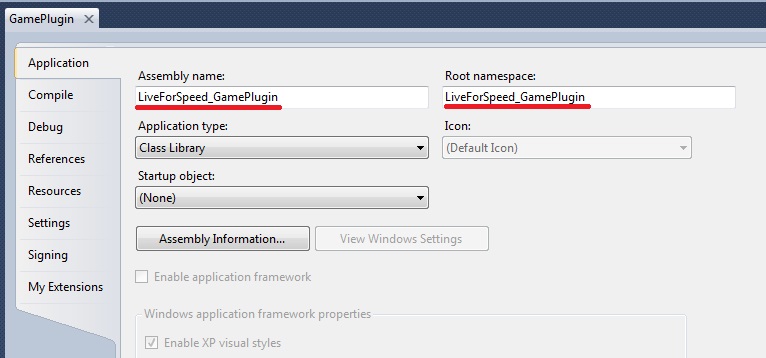

    3) Then be sure to change the _PluginAuthorsName and add you name, game tag whatever.
    4) Now click 'Project' then 'Properties'
    And rename the file like this:
    GameName (without spaces) + _GamePlugin
    So if we were doing Live foe Speed it would be this.
    Now compile it and you should be good to go for you game!

    Thanks so much for that, Yobuddy. And yes, between the tutorial and the plugin, I can see how to configure the code for name change. FWIW, my problem was that I thought I read in the tutorial to zip the entire project and place it in the updater. I tried just placing the .dll plugin into the updater, and that didn't work for some reason, and I'm just used to zipping large folders -- I don't usually zip a single file, and I didn't read the manual closely enough. Fortunately, you left the zipped plugin inside your download, and I was able to see that it was just the .dll that gets zipped. So that fixed that. And I see that you turned off the patchrequired bool.
    Unfortunately, there is no information about patching, and more specifically, what the config file is supposed to look like. The LFS config.txt file appears to have configuration data for Simtools - a port number, ip address, and some other variables, but I don't see where that is read in the GamePlugin.vb file. So I assume that code exists somewhere else in the solution? I'm not quite sure why I need to patch, since I can manually input port and ip addresses. Do I really need to patch or can I leave the patchrequired bool false?
    So far, I'm not getting the game to connect to Simtools (indicators aren't turning blue). I was just trying to get the Quplay Main.Unity project working. The only changes I made were putting in the correct IP -- I'm working with my computer's IPv4 address and port 4123 (in the manager IP). And I also corrected the random function which had been deprecated, but that wouldn't keep the game from connecting to Simtools. I've tried to patch the LFS config.txt file, and it will patch if I put the correct .exe file in the directory, but I didn't expect to see the game connect, and I wasn't wrong. I've been all through the xsimulator archives and can't find anything on writing a config file.
    So I have a supplied plugin for Dirt 2, and a config file for LFS. I really could use a matching pair. Since you wrote the plugins for Dirt 2, would you be able to send me the config.xml file to Dirt2 or the gameplugin.vb file for LFS? Or at least code snippets? Otherwise, I don't know where to go from here.
    Thanks much again!

    Okay, so I misunderstood before when you wrote, "(BTW, You still have to Patch / activate the plugin, just so you know)," I'm thinking now, you just meant I needed to click on the 'patch' field to activate it, even though I'm not actually patching the game. Hopefully I understand that correctly.
    and NEVERMIND -- Just wrote a bunch of stuff, but figured it out going through the manual again. Simtools is looking for an executable named Quplay.exe, but I was working in the Unity editor, so...nothing. And before when I tried a compiled game, I think because the scene was named main.unity, it was just creating an executable named main.exe, but now ... Connected!!! Now hopefully, I can get actual telemetry to pass...

    Yes, exactly!
    It does not patch any files but it does tell SimTools that the plugin is active.
    Yes, you would want this to be your game.
    Cool man, let me know how it goes!
