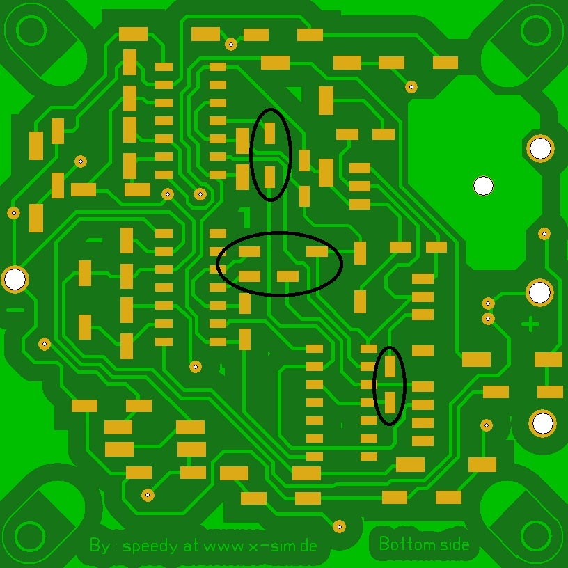

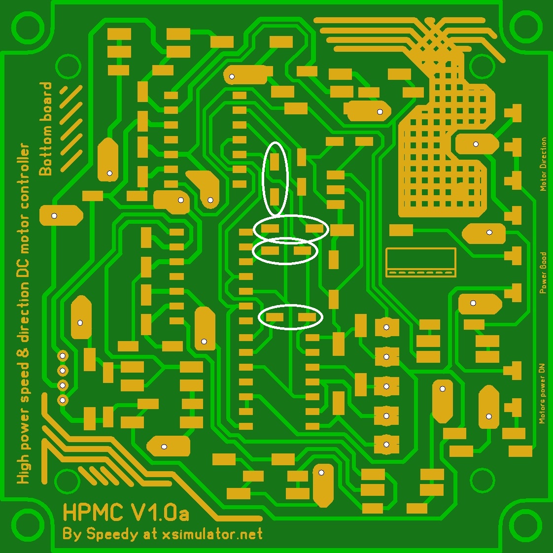

    Guys just to remind you all ... First of all there will be 4 wires to be soldered as surface jumps on the bottom board
    circled in the following picture
    edit : this is the new version surface jumps .

    @abdo_tahan Thanks for making that clear! Can you also also publish the image with the wire solder points at the first post of your project thread, so we have all important information collected there;)

    Ooops ...
    Edit :
    Done and every update will be added in the first post ...

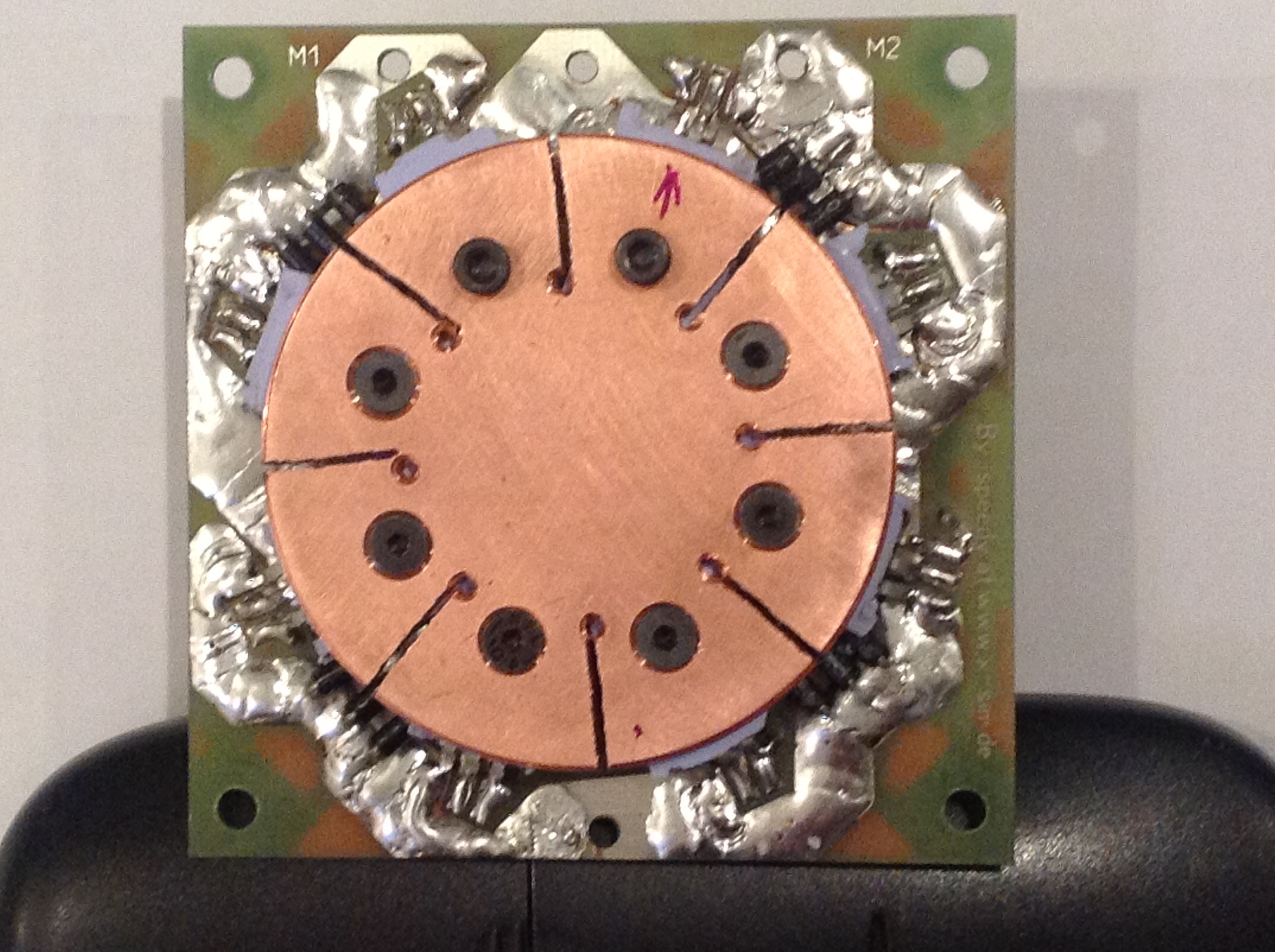

    Is there sufficient interest for pairs of PCB to be etched ? I would be interested in two or more sets depending on cost with post to UK.

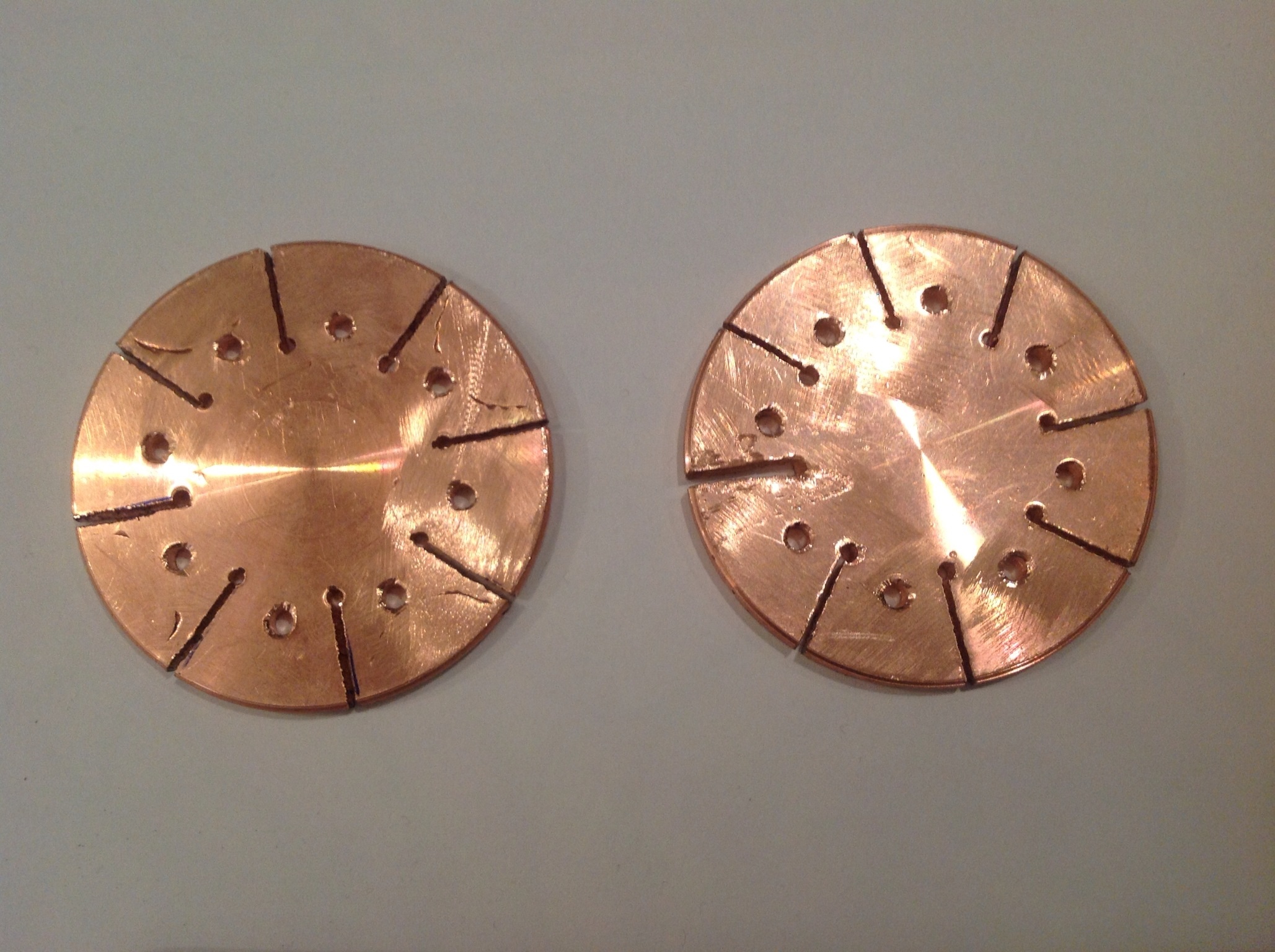

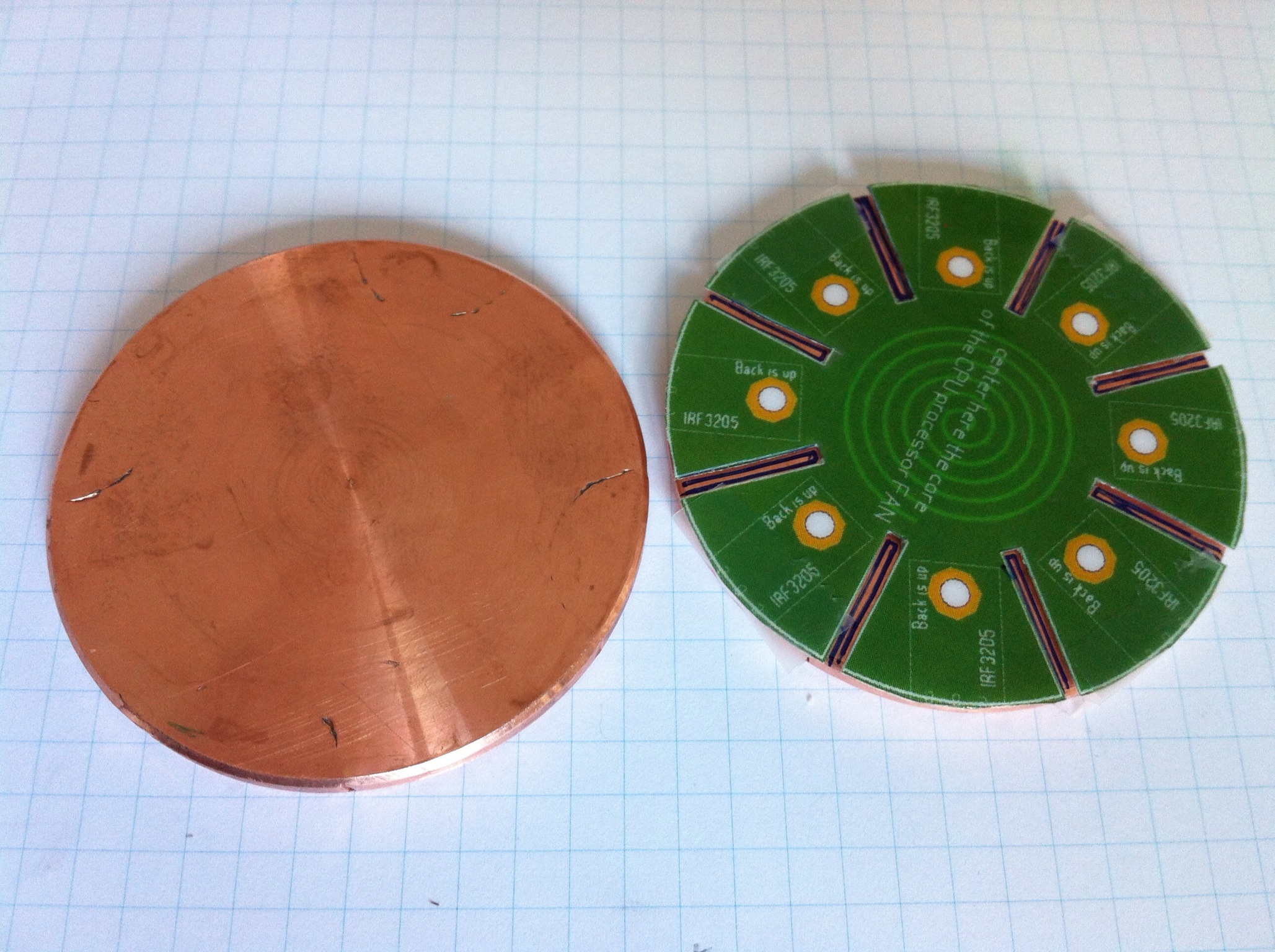

    Regarding copper discs, thin pipe or tank copper is easy but would defeat the object of the thicker discs in transmitting the heat, stacking thin discs is not advisable the air gap will reduce the heat transfer considerably. Machining wastes 100% .
    A local UK supplier, copper price was around 4 euro each as 60mm squares for me to cut from one meter length of 60mm wide flat bar 4mm thick. I am proposing to drill and tap the mosfet fixing screw holes to create a larger flush, bolt head free, seating area for the cooler (seating surface for the mosfets and cooler must be flat)
    I may be able to help others with the copper if it is a difficulty and there is enough interest.

    I have access to a wide range of metal kinds/forms Exporters here in Alexandria ... they are may be sold by length or weight ... let me ask them by tomorrow for there best prices ...

    I see now what @RaceRay and @eaorobbie wanted ... I can also arrange and source a " ready to assemble kit " or something like that to be here in the marketplace ... and put the link here ... also can make it in a box like that idea ...

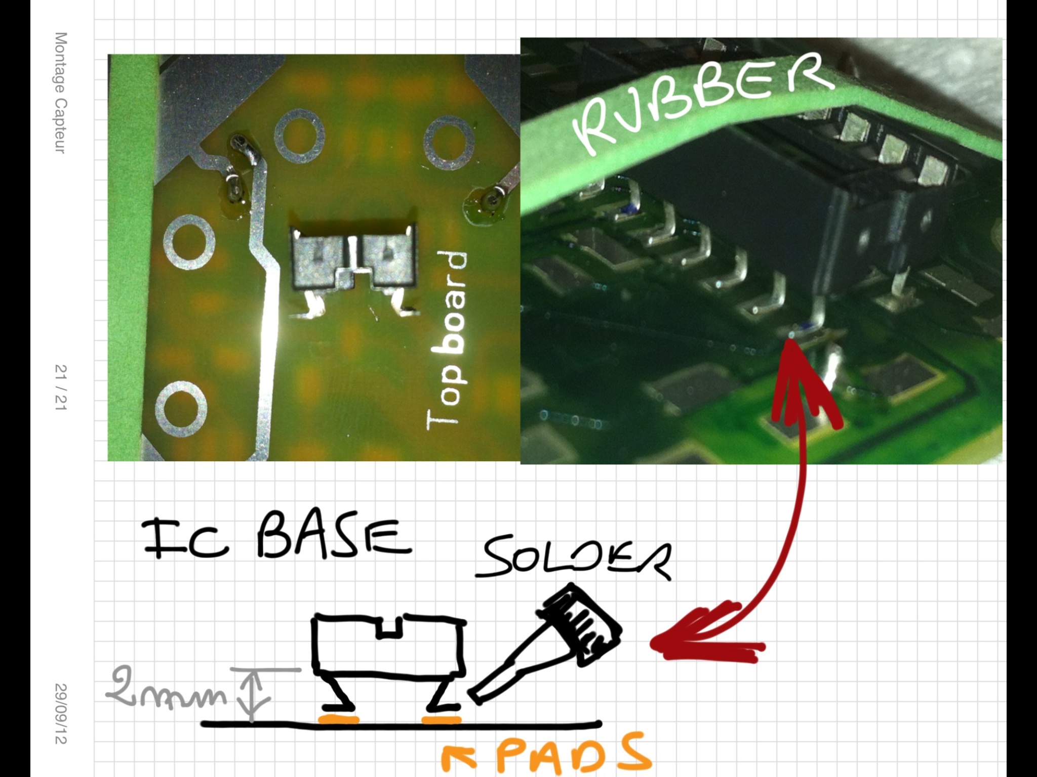

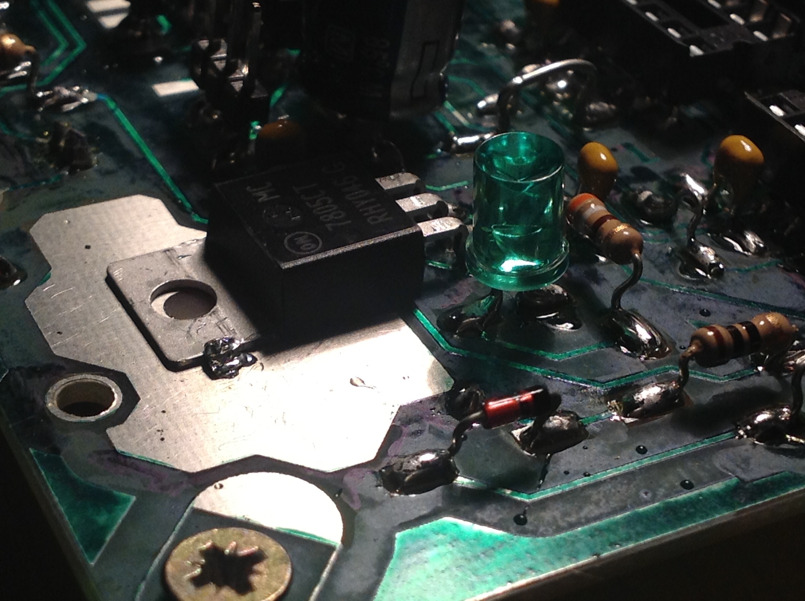

    @abdo_tahan I never did any smd soldering before, so i hesitate to start the project. Can you give me some tips how to mount the parts at the best and easiest way?
    Some pictures of the ready assembled h bridge would be very useful. Is there someone from the "other forum" who already build that beauty?

    Dear Rene ... Actually there is, and I'm glade you permit sharing that " Thanks Admin" ...

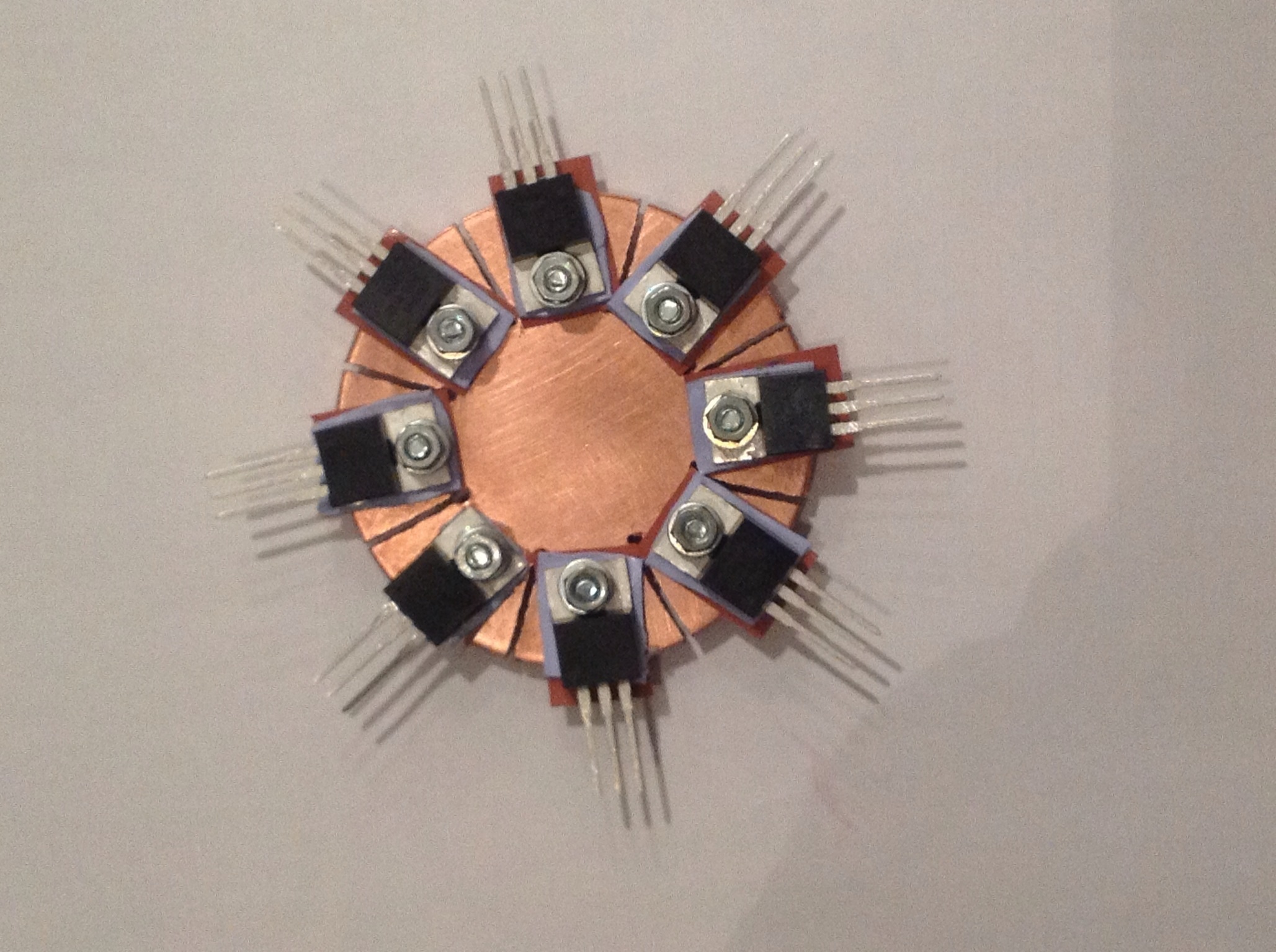

    presenting here some good pictures that are best made ...a video with @prilad FW is provided below .
    please not here in this video the copper disk is alone is not a heat sink " that is an error " ... please use the computer fan all the time ...

    Thanks @abdo_tahan Looks easier to solder than i ve supposed:)

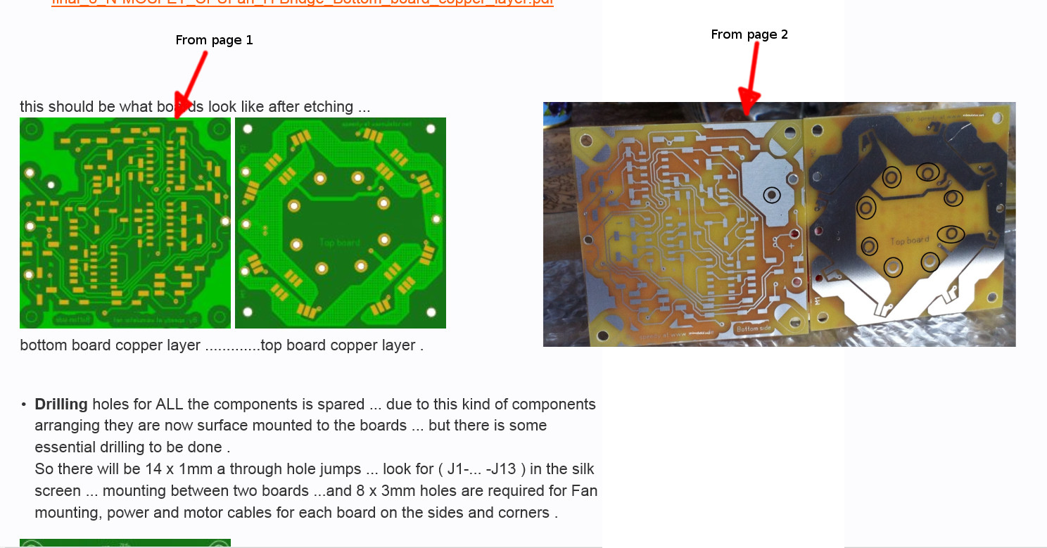

    I think anyone can use the same pdf files and make it not smd. The only difference is that you should drill the square pads on its centers and, of course, etched side down. Or not?
    Only because of the latest posts I noticed that it was smd :D
    Already ordered my 2110's from a farther store. The place near here was asking for double the price and only has one piece available :S

    No No @rafael_design ,My friend ... Etched sides are and will be always on it's own same side for each top and bottom boards ... changing that will disorder the orientation of all components ...
    plus the pins of the components through the boards will cause a space between boards and my short circuit between please don't do these things ...
    Soldering and desoldering components like this ... is way much better and easier than through hole ...

    Ok now its clear to me that the boards are back-to-back... Anyway, look at the pictures below:
    Please notice that the bottom board is mirrored in comparison to the real one on the right. And the top board is not.
    Both pdf files are not mirrored regarding to the right picture. IMHO if you are etching to be SMD (like the right picture) the pdf should be mirrored.
