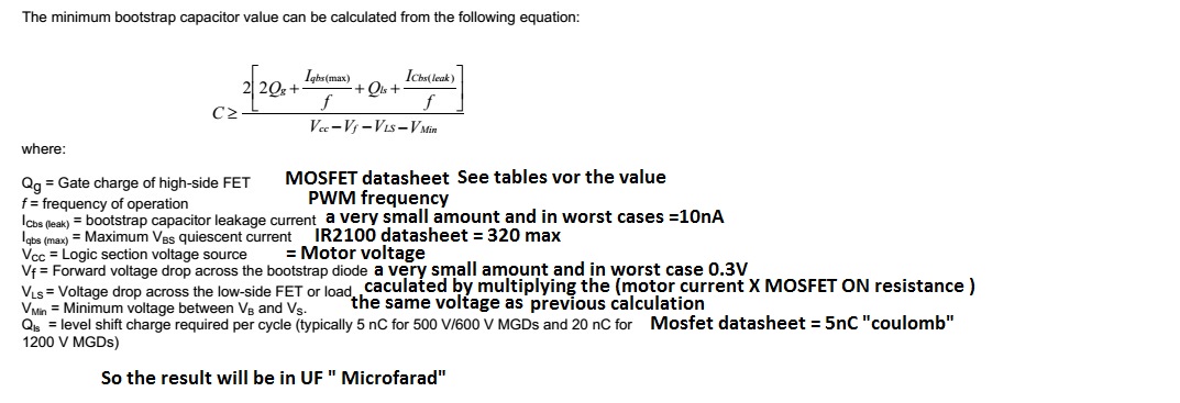

    With my respect too Ivan ... In the first post, I said that you can use whatever you like N-MOSFET ... and then here provided you with how to change, calculate and to be convinced with your choices ...
    If you can read schismatics "which is in the AN file" ... get what you want from the copper layer .

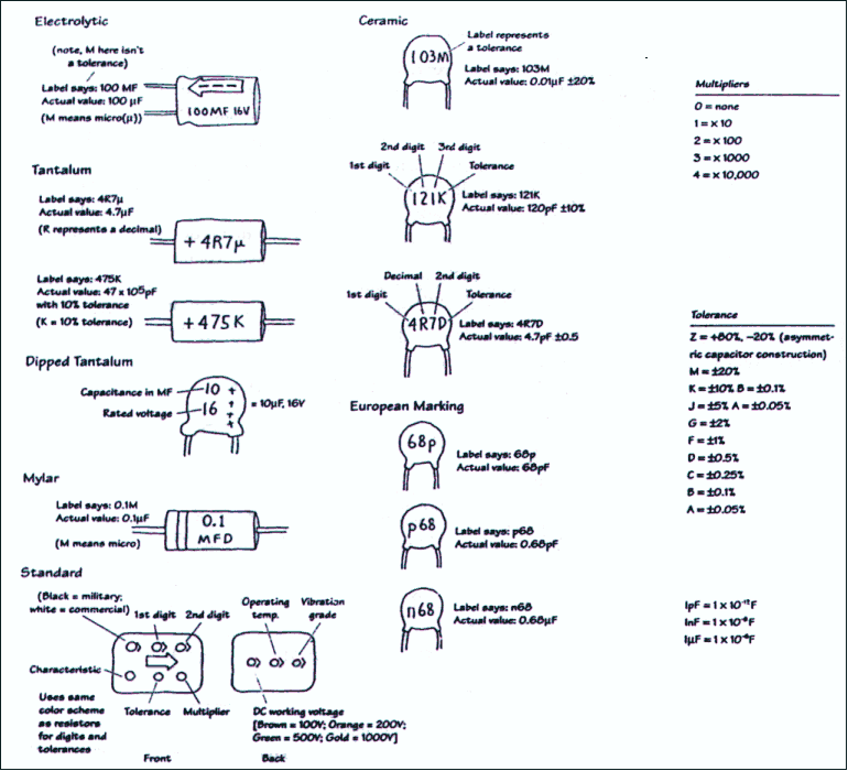

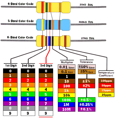

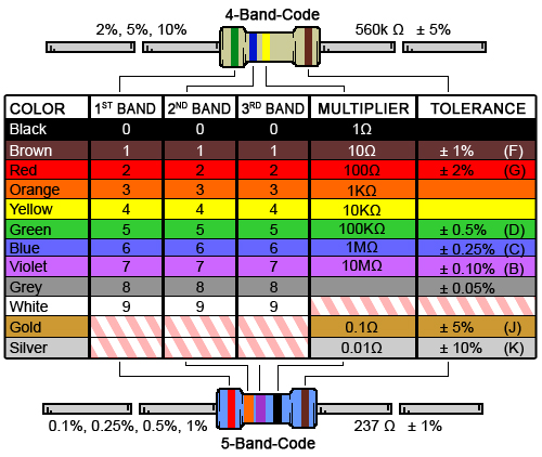

    FYI ... I want to share and put a reference point for resistors and capacitor colors and codes ... for double check choosing purposes .

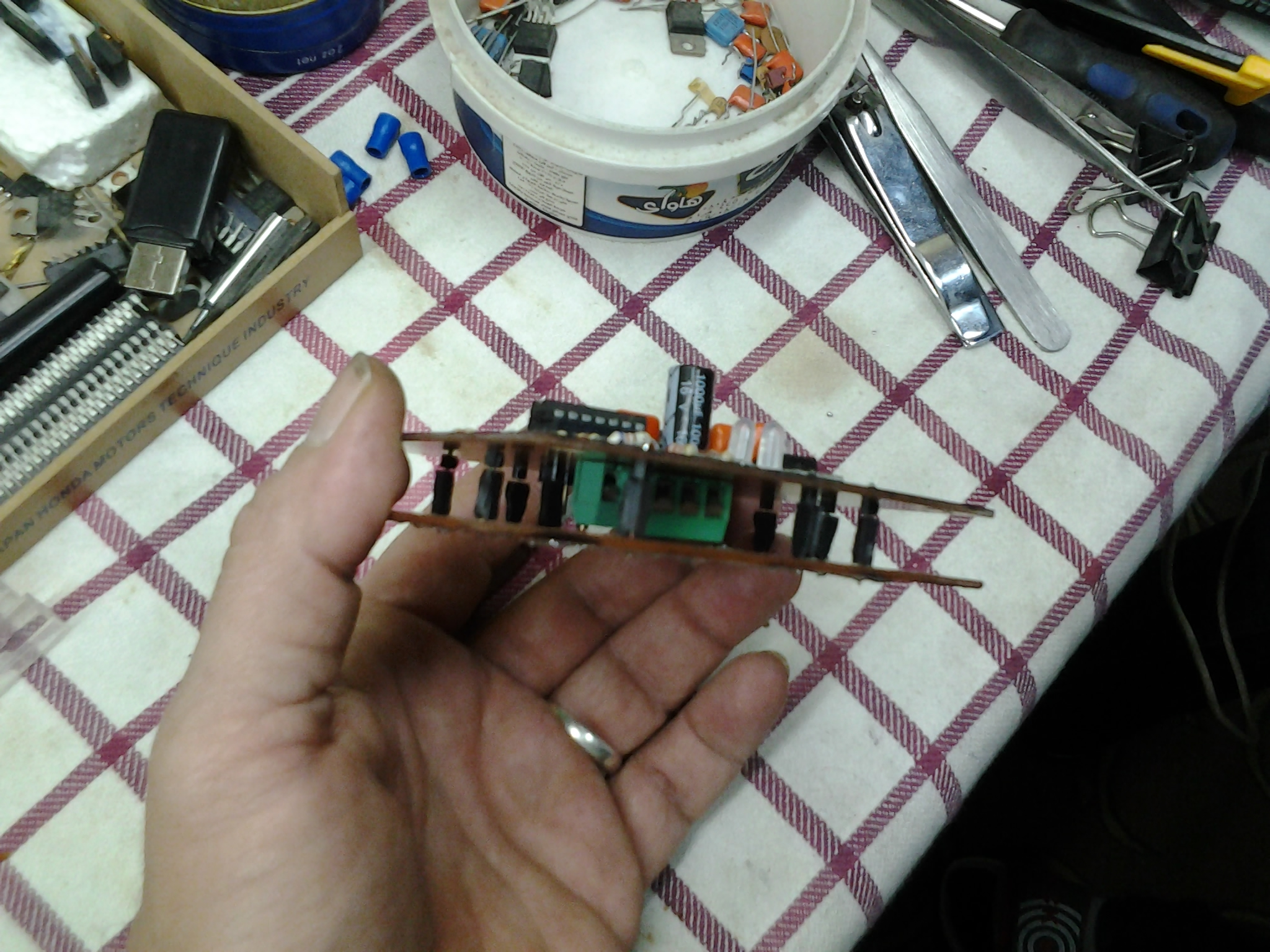

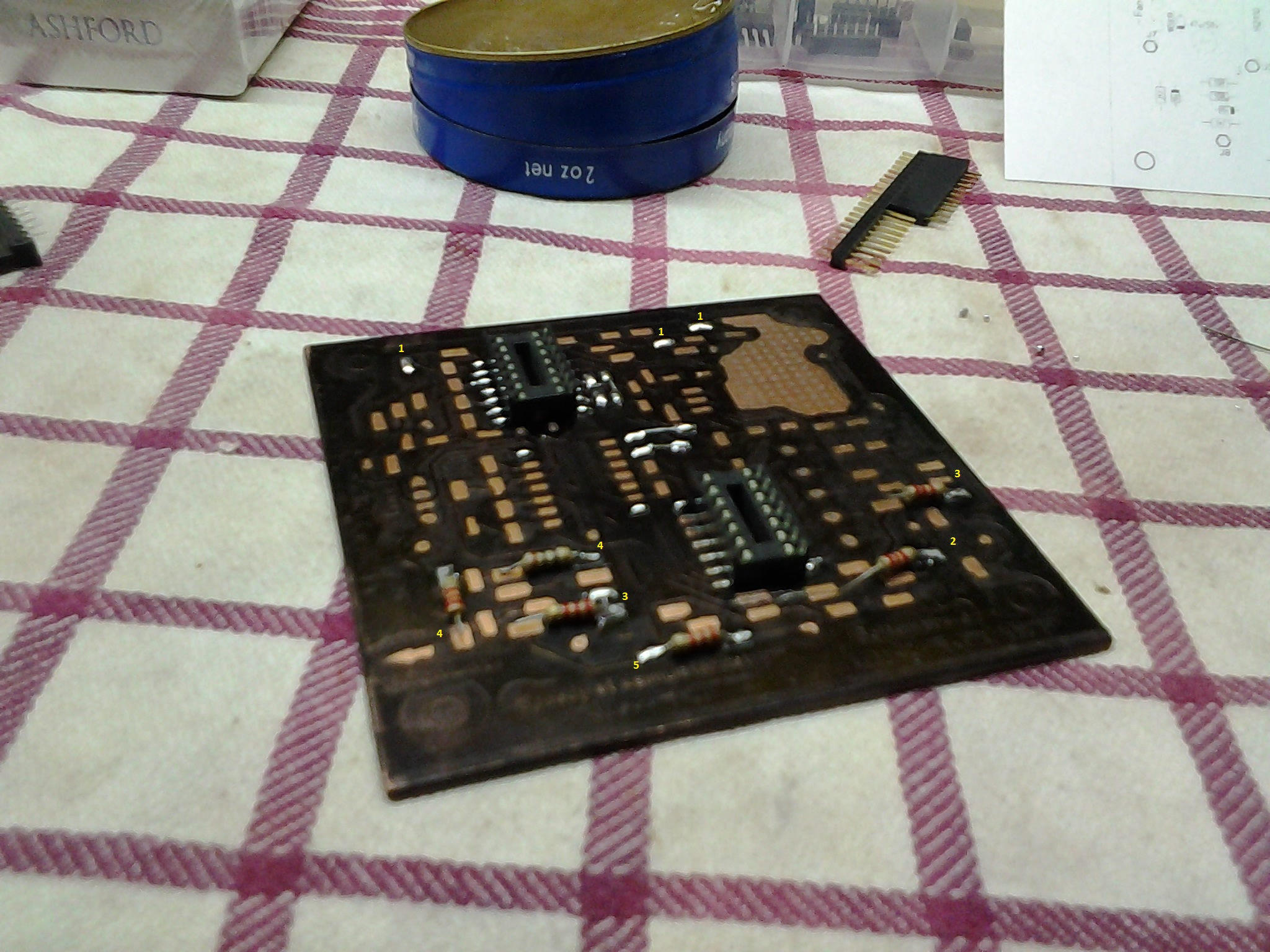

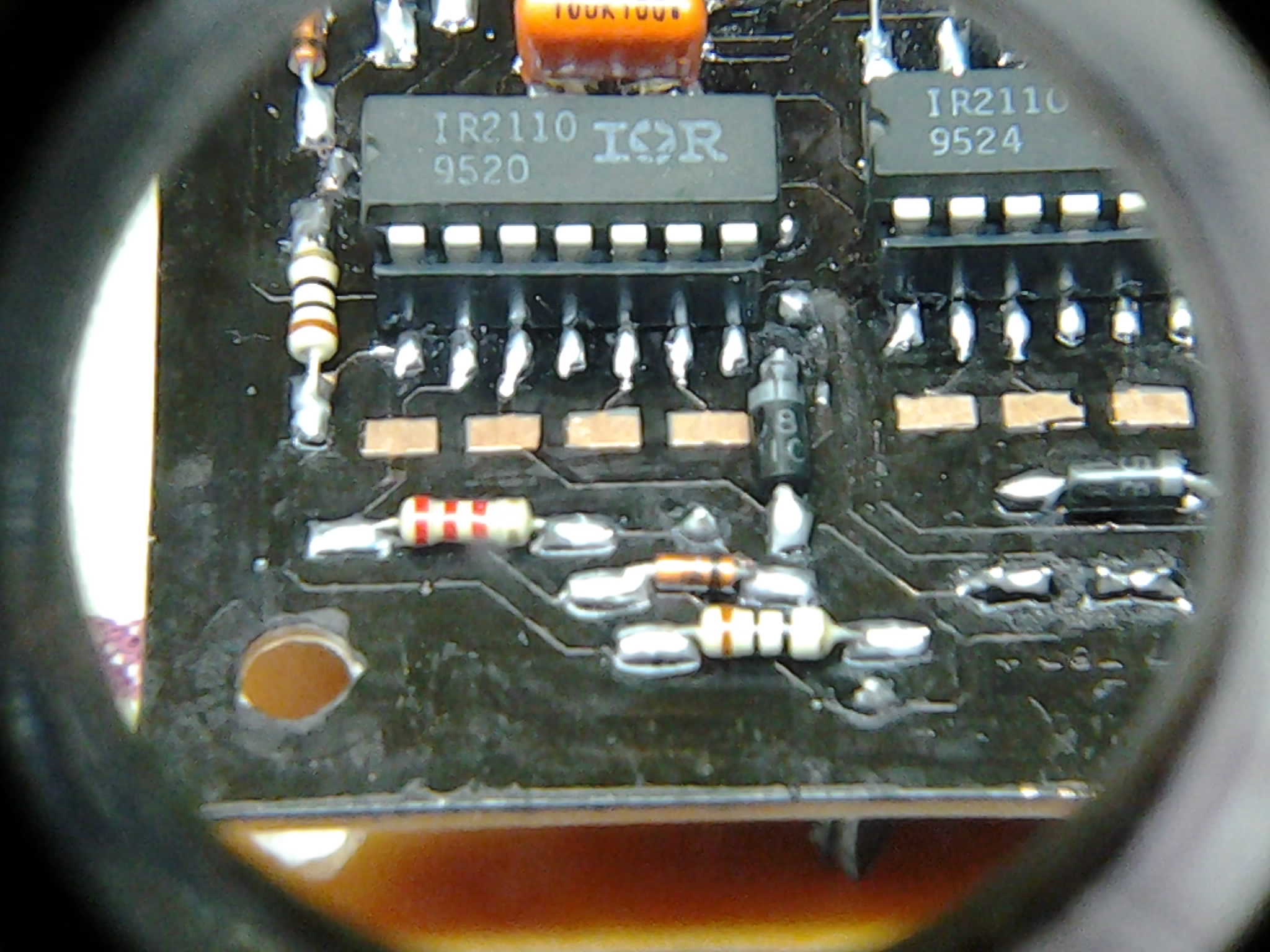

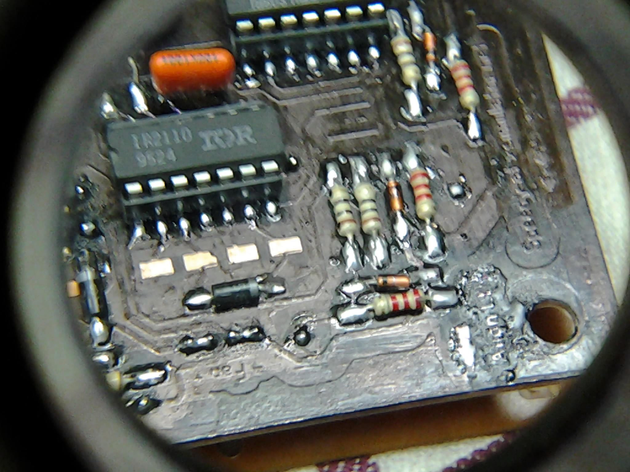

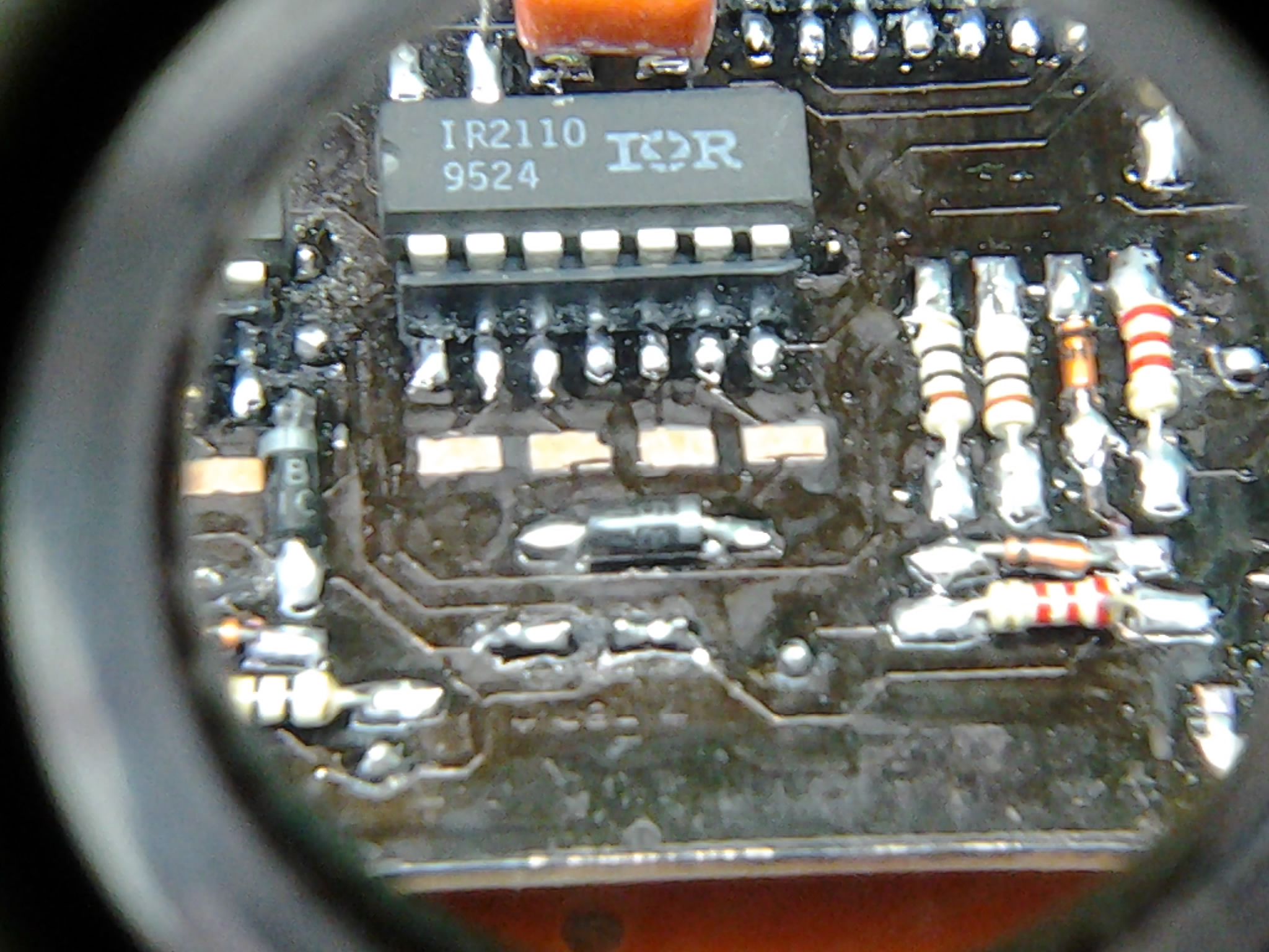

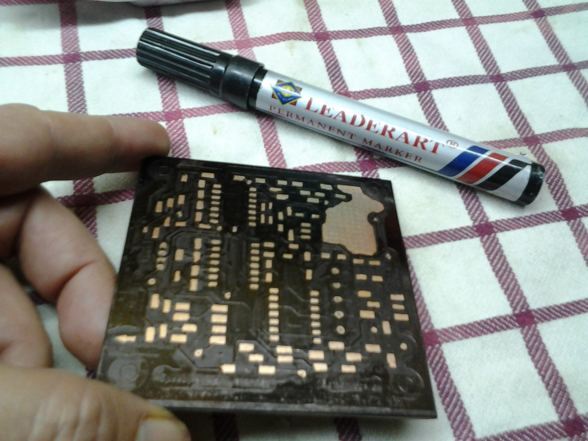

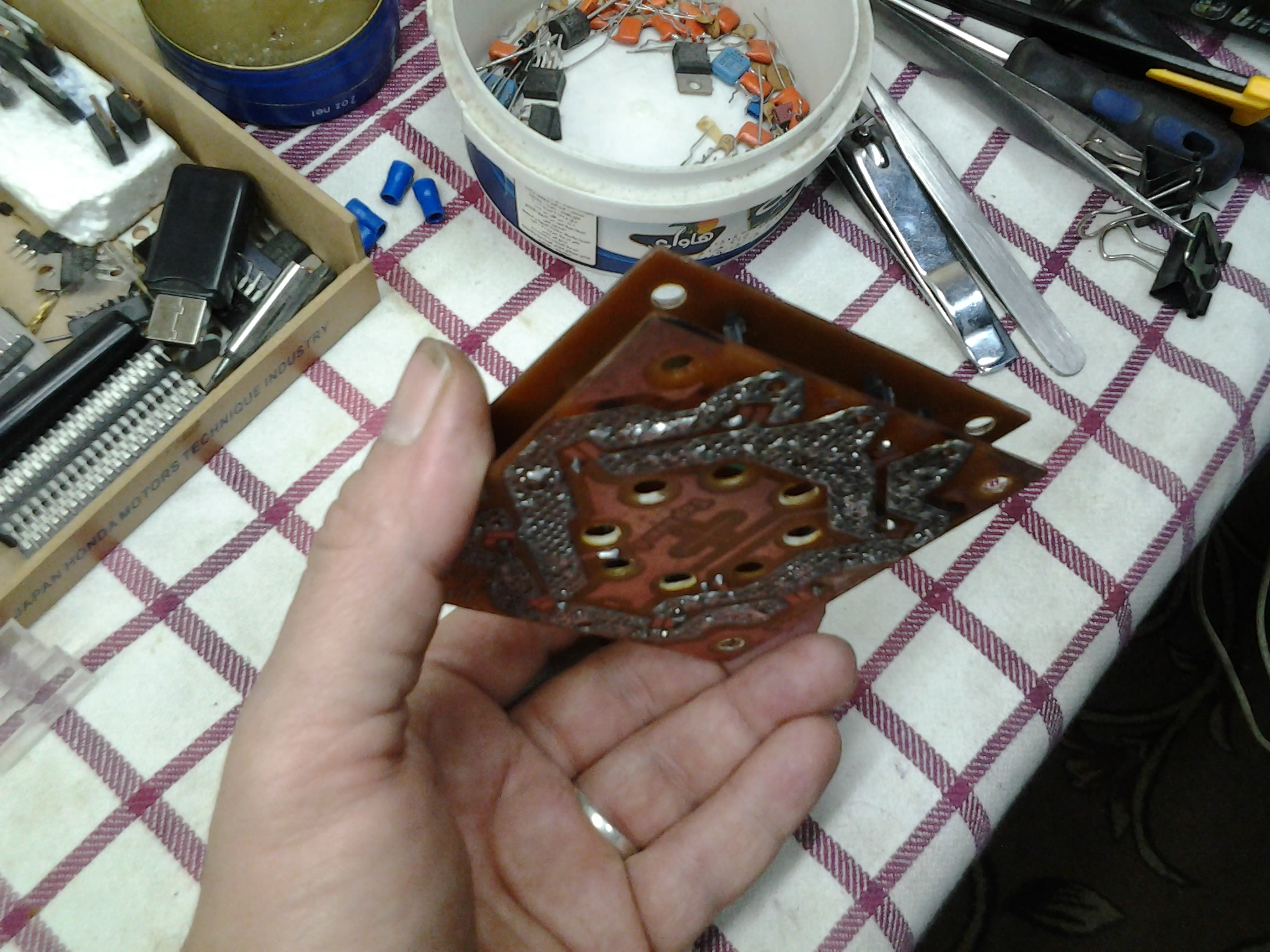

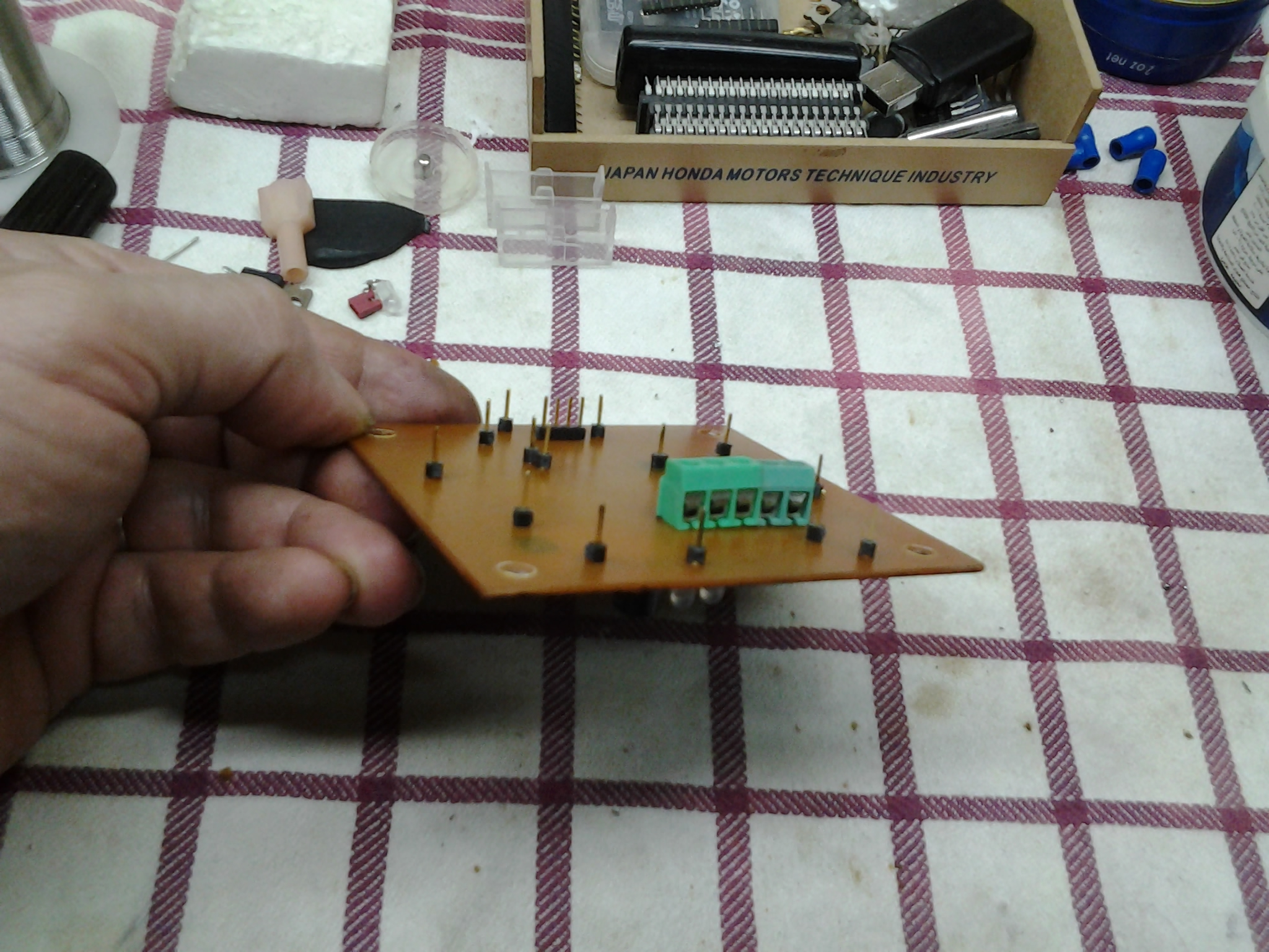

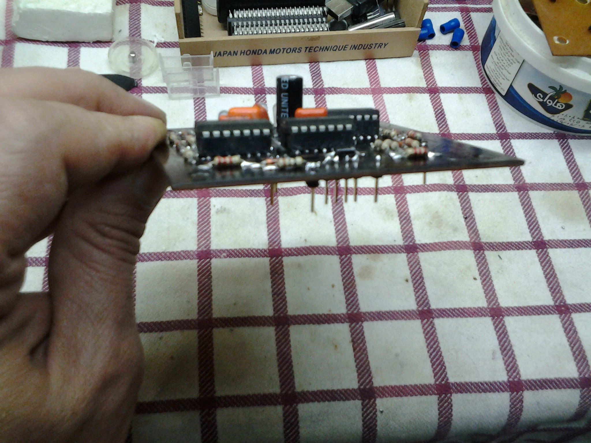

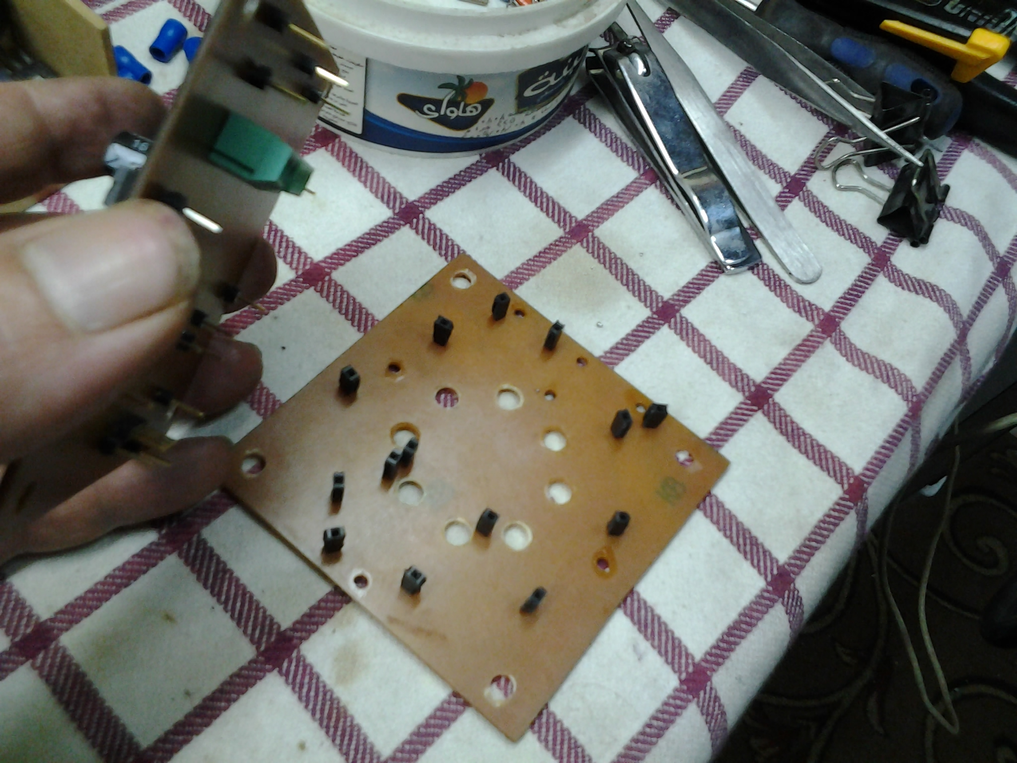

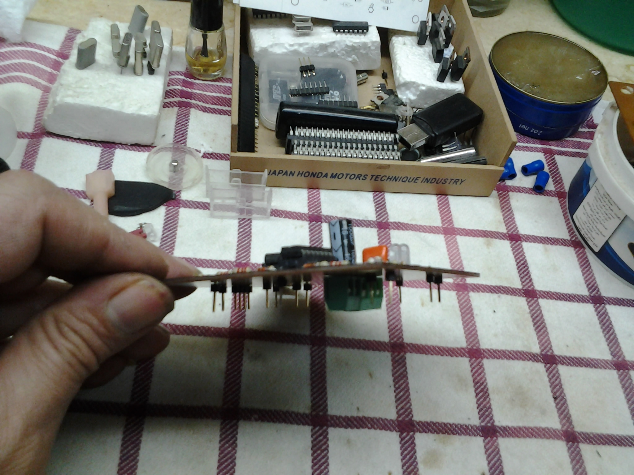

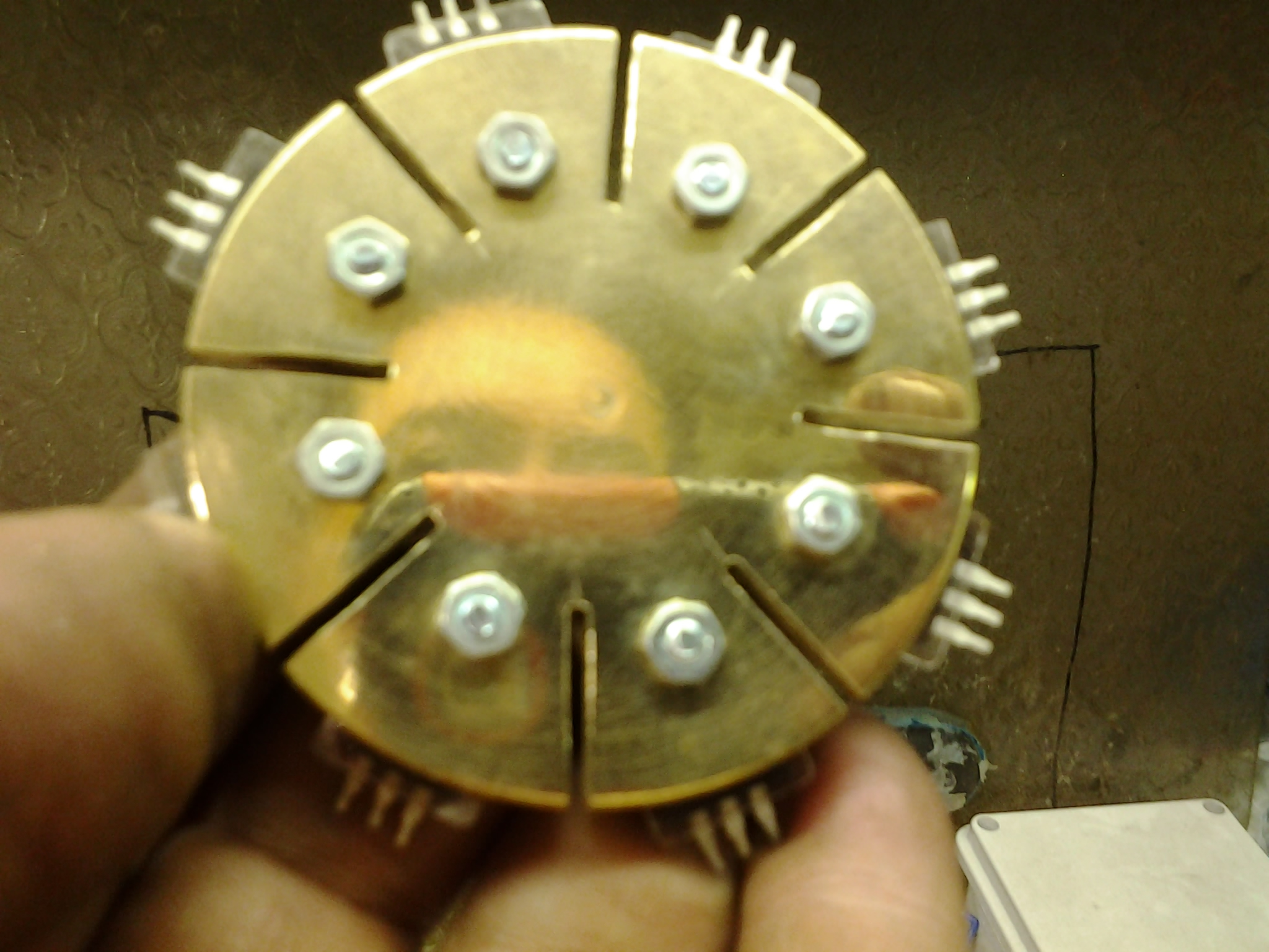

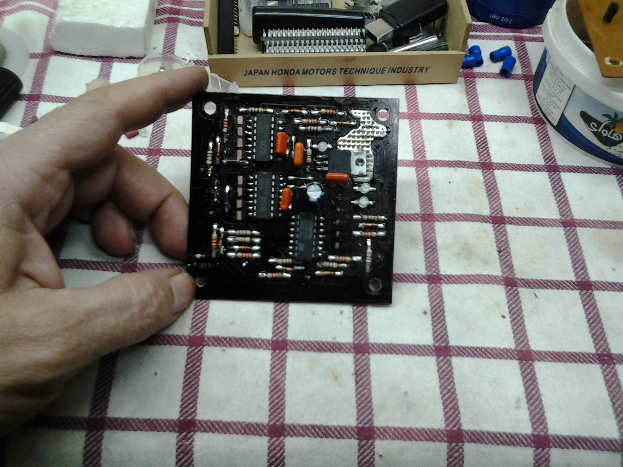

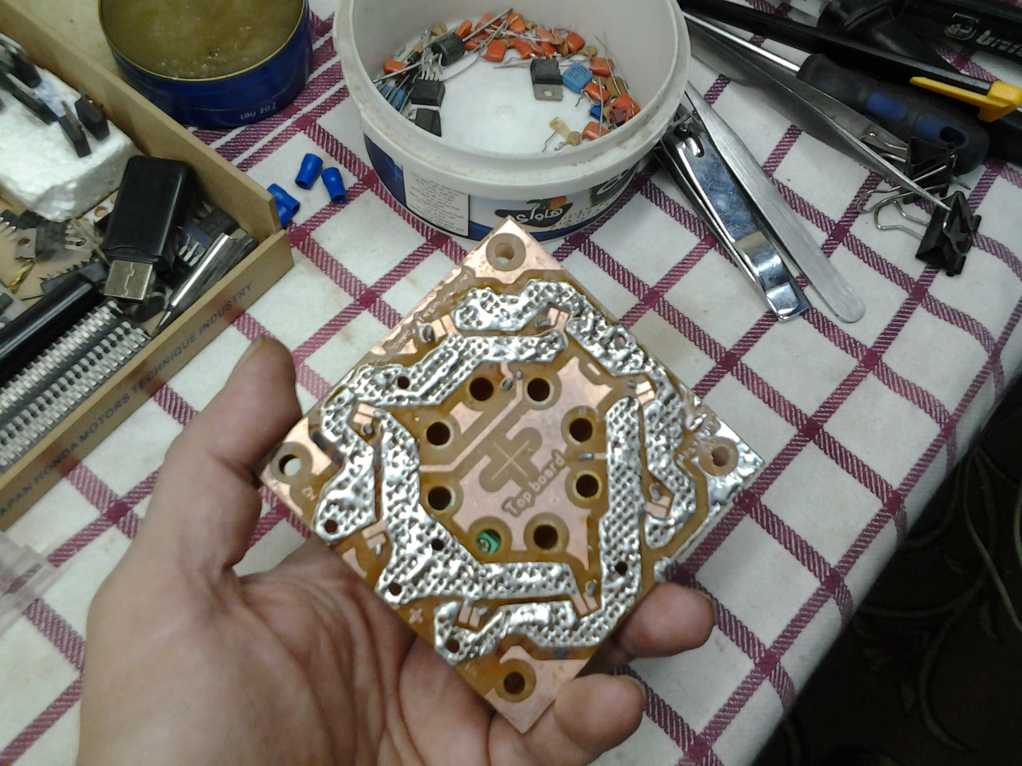

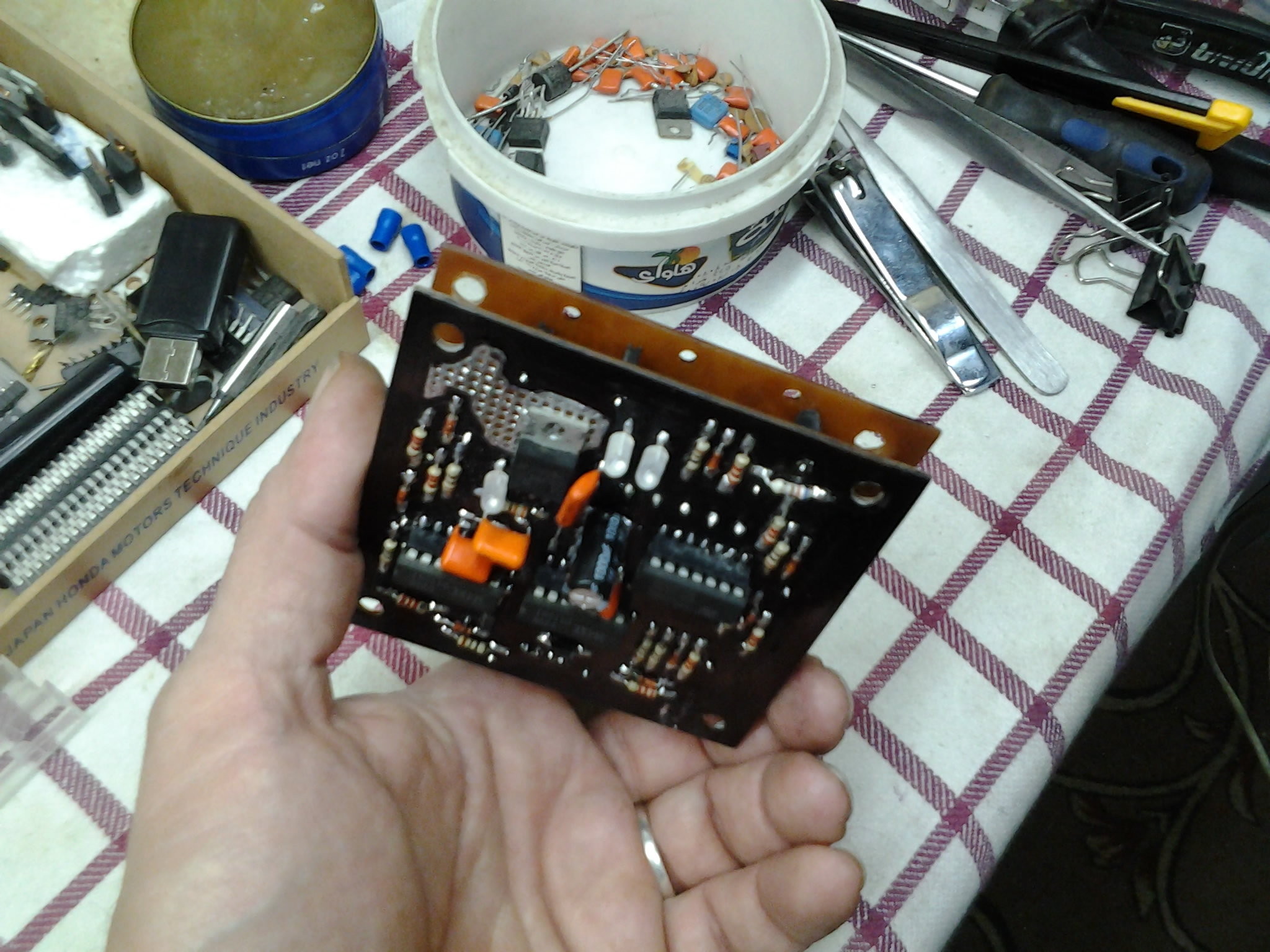

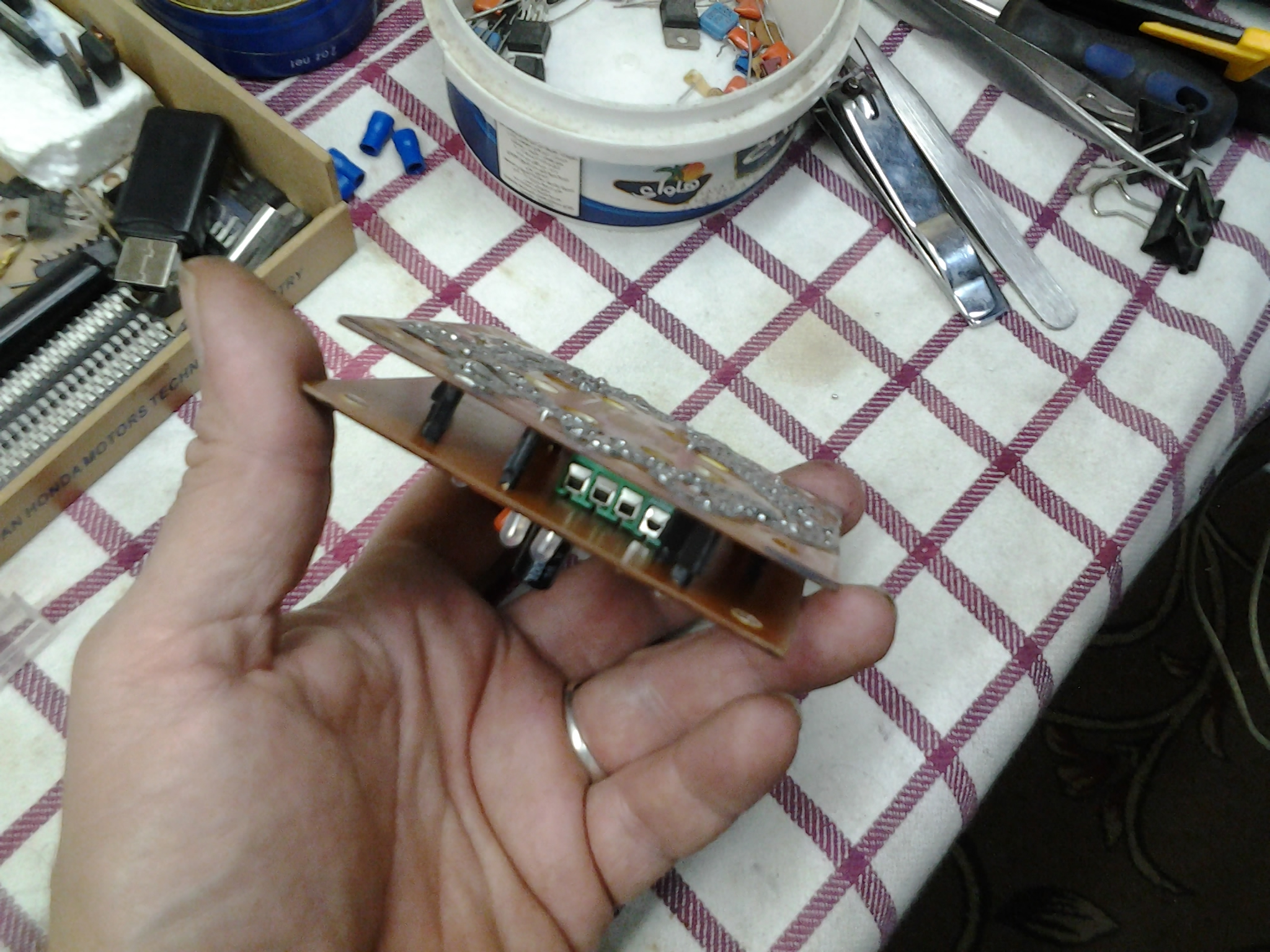

    Hi every one ...I'm sorry for not having much time reserved for fast forward steps in this version update but I guess you'll understand ... So, 5 days or so I've finished the two boards assembling ... here is the latest pictures ...
    2014-01-16 07.08.51.jpg 2014-01-16 08.04.04.jpg 2014-01-16 14.20.30.jpg 2014-01-16 14.21.19.jpg 2014-01-16 14.22.19.jpg 2014-01-16 14.23.24.jpg 2014-01-16 14.25.24.jpg 2014-01-16 14.25.43.jpg 2014-01-16 14.26.08.jpg 2014-01-16 14.26.25.jpg 2014-01-16 14.26.50.jpg 2014-01-16 14.27.21.jpg images.jpg PCBA-Euro-Type-Screw-Terminal-Block-Connector.jpg Terminal-Block-Flat-Base-Type-PA8H-PA12H-.jpg

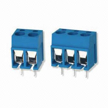

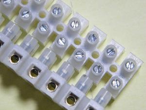

    I'm going to use this kind of white terminals to firmly tight the thick cables that is intended to be used for the motor and battery power supply ... the 5pin TC will be for attaching the 5wire cable coming from the SimAxe or the Arduino board ...
    cables will go in and out through the space between boards ...
    I used an old scanner lens to give me a good picture but I guess it has a small view angle:grin
    I'll try to get one of these sku_244994_1.jpg for my mobile phone .

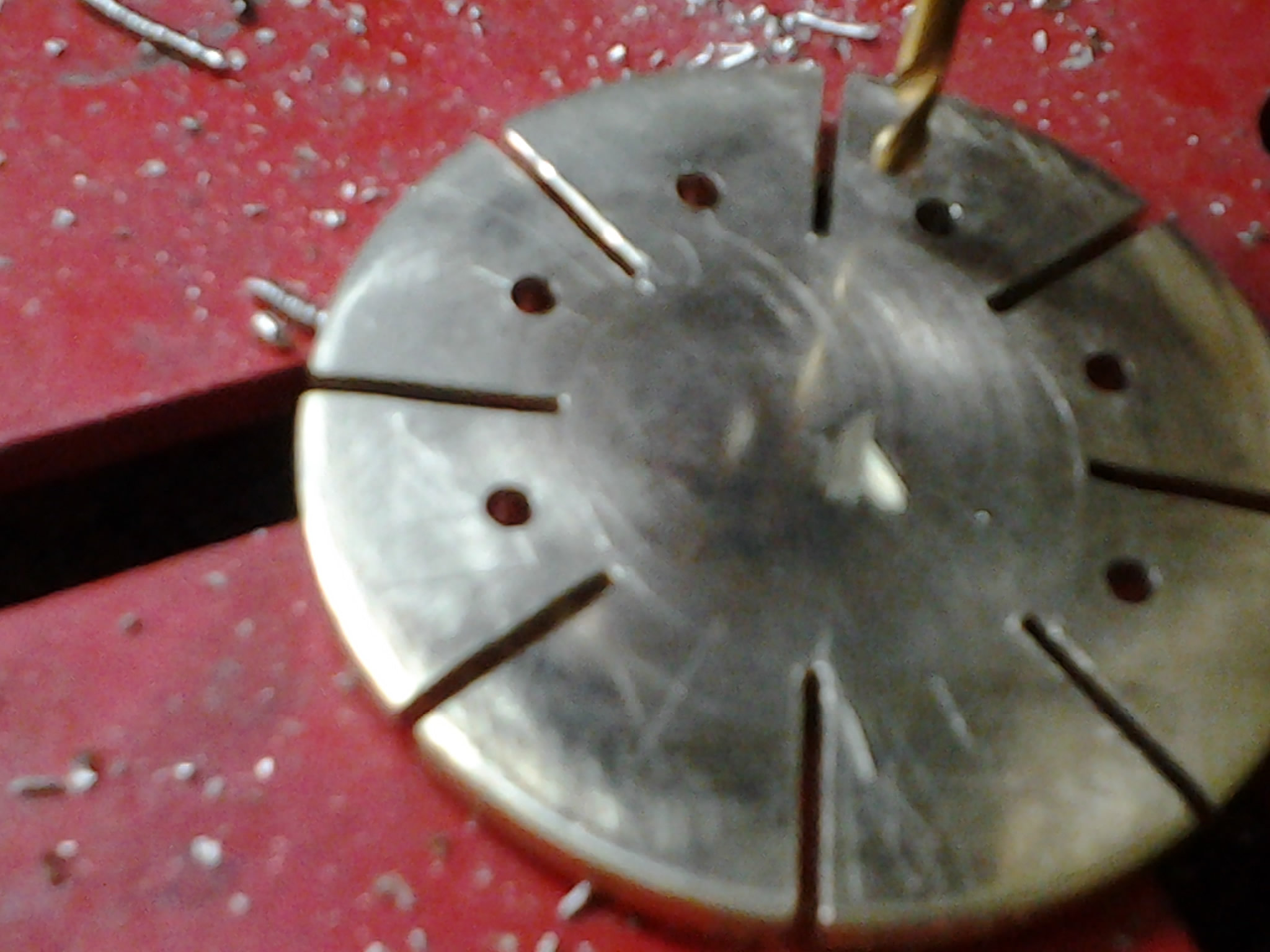

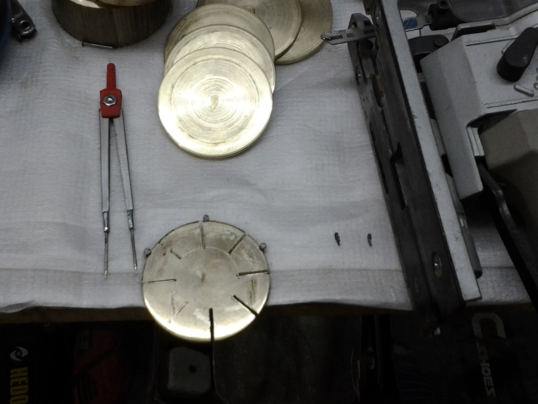

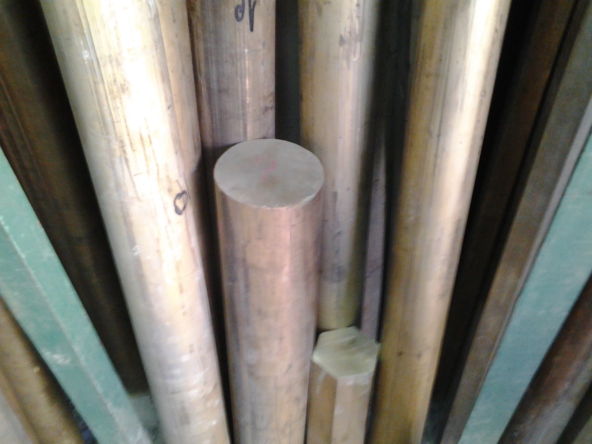

    Yesterday I finished making the copper disk and I want to share how it's made ? ...
    first I found a supplier that can sell copper by kilograms ... I bought 15cm of a 6.5cm solid yellow copper rod ... that weighed 4.3Kg
    went to a lathe to cut the rod into 4mm slices ... gave me a total of 15 disks ... with a 3cm rod left over due to the lathe hub inside holding distance.
    total cost till no for 15 disks are 450LE /7 " Dollar exchange rate " /15 =4.28 USD for each disk ...:p
    used a sharp tool to mark where to cut and drill ... I can see the + marks scratches so you can too .:)
    2014-01-22 17.30.07.jpg 2014-01-22 18.11.03.jpg 2014-01-22 20.13.25.jpg 2014-01-22 20.16.20.jpg

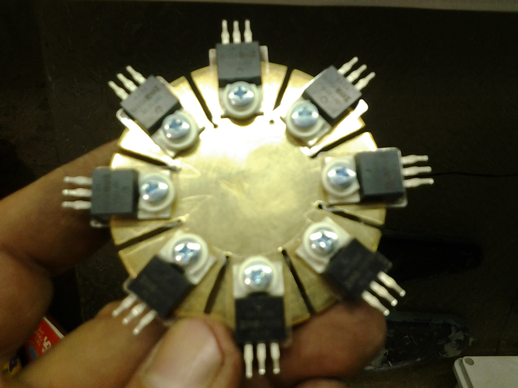

    And gave it a good sanding and some polishing buff to a mirror shine ... I like that so I have to wipe out my fingerprints every time I touch it ... to be like I didn't do it :D

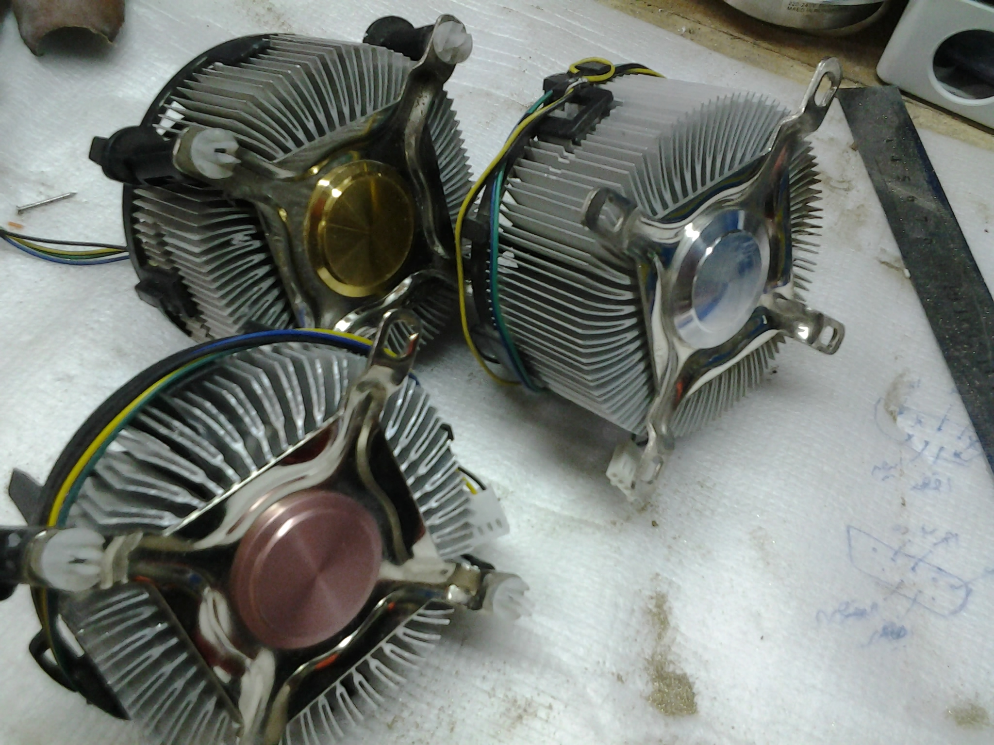

    And will continue soldering the MOSFET's as soon as I get some of the white stuff " heat compound " ...
    also found these types of cooling fans ... See how the aluminum core fan gets the biggest heat sink and is considered a bad cooling fan in computer world ...

    I guess when machining copper the brawn or reddish material it starts to accumulate and becomes like a sticky gum on the machining tool ... when machining Brass [ copper alloy with zinc ] the yellow material it is way much easier to machine and with the same performance of copper row material .
    tip : Bronze is a copper and tin alloy ... much harder
  19. frenchfly
    frenchfly Member
    Nov 23, 2010
    54
    Mold Maker
    Winnipeg, Canada
    - 338Coins
    +30 / 0 / -0
    2DOF, JRK
    I mill copper with coolant and a sharp carbide 4 fluted endmill. you need to fiddle with your feeds and speeds to get it cutting properly, it's a pain to mill.
