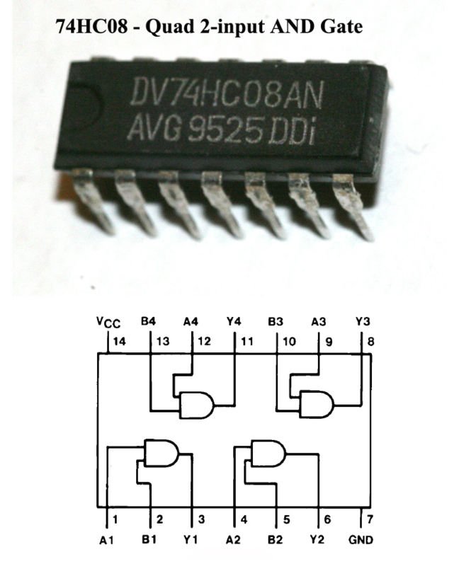

    Hi Igor ...
    The 74hc08 as you may know is a Quad 2-input AND gate IC ... It's inputs are the right, left, and PWM signals from the uC ... I used it to give me these outputs so far :
    1- PWM modulated right side signal .
    2- PWM modulated left side signal .
    I saw many different concepts in making a full H-bridge from the IRF2110 and I guess that using only two lines will take you to the risky side of operation ...
    I've tried many schismatics programs but fail to export images or find even the required components ... any suggestions ?
    Regards

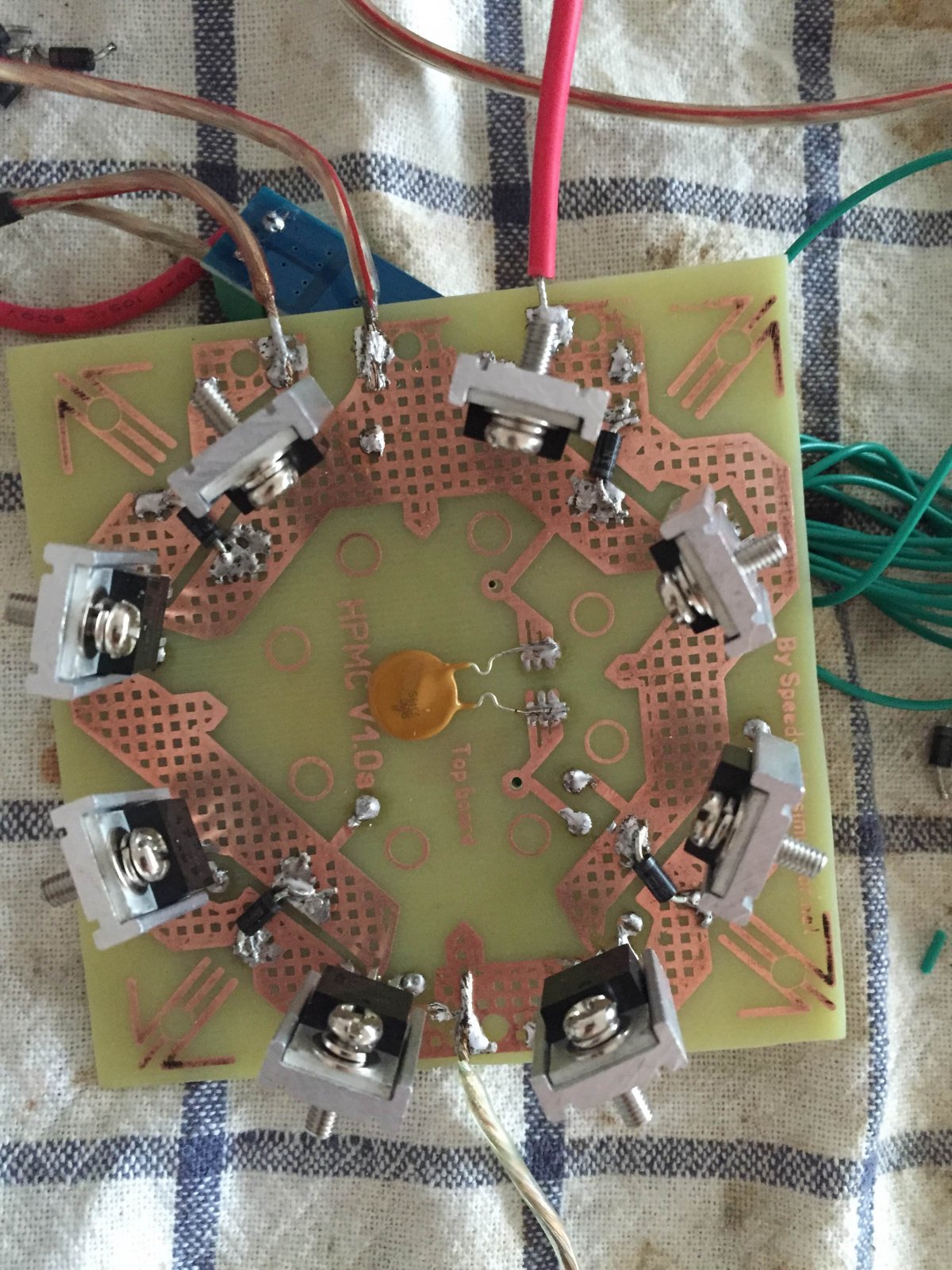

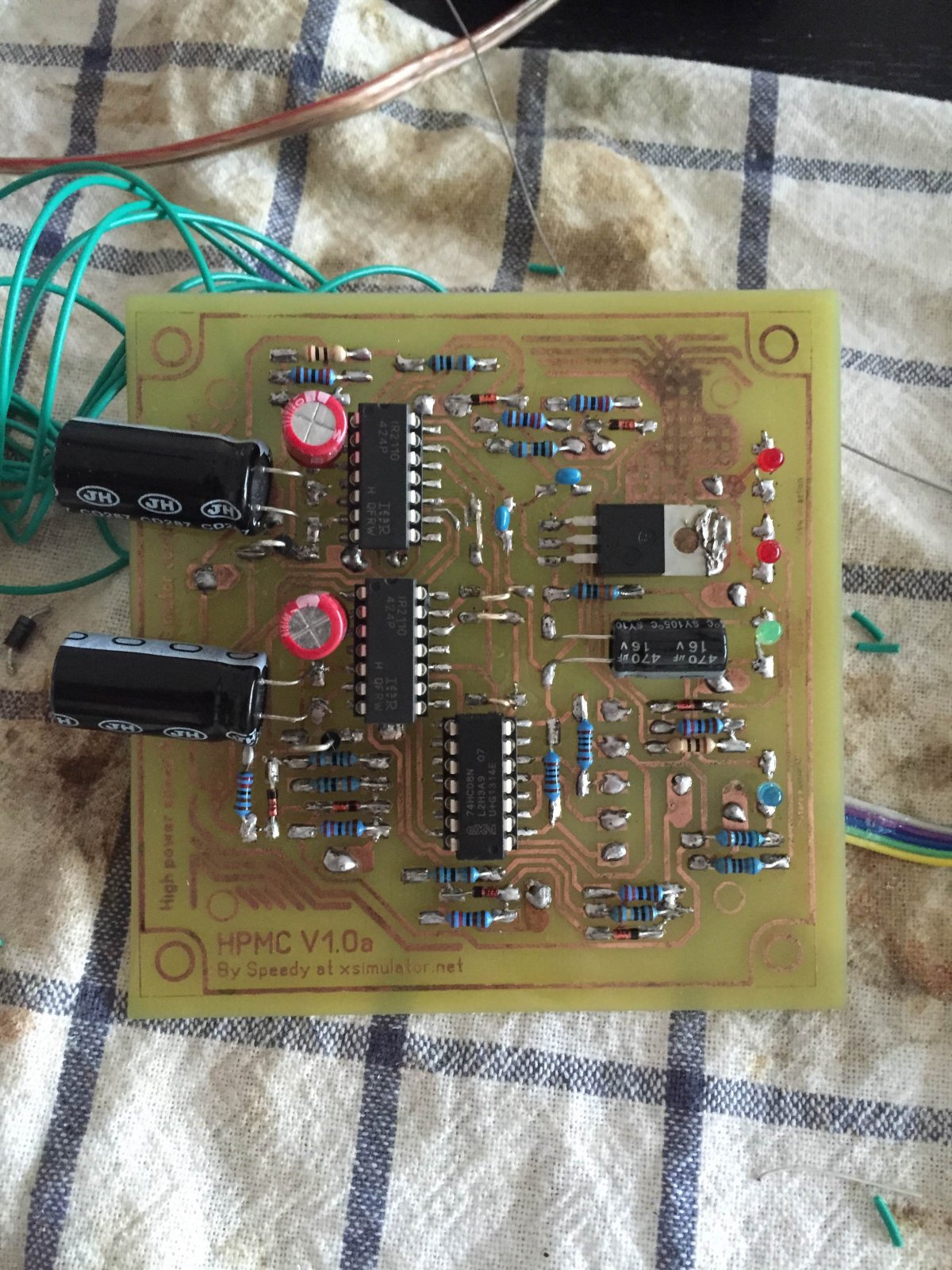

  16. carsten
    carsten New Member
    Dec 26, 2014
    9
    510Coins
    +10 / 0 / -0
    Speedy, sorry I was busy with other things... Only now back. Short question. Can you use this board to run a motor constantly? (as of now, I have only managed to keep it on for a couple of seconds). what changes are needed to run the motor constantly. (I am thinking to use it in a different application where I control motor speed and direction via PCM that comes from an arduino board. What PWM signal should I use?
    Thanks for your help.
    Greetings Carsten
  17. speedy
    speedy Well-Known Member
    Feb 1, 2012
    1,193
    Alexandria , Egypt
    7,951Coins
    +1,288 / 10 / -0
    Maybe you have a defective IR2110 [check that first ] ,Or use a single side boards for top and bottom layers as suggested before making some air gap to prevent the little interference between layers ...
  18. carsten
    carsten New Member
    Dec 26, 2014
    9
    510Coins
    +10 / 0 / -0
    Hi Speedy,
    I have rebuilt the whole circuit.... This time I have:
    - separated the boards
    - replaced all my IR2110 and other components
    ... and it is still not working.
    (Pls see the top board only as a demo as the IR 3205 sit in a water cooled setup as this whole thing is for driving ROV motors underwater...(hence I need 4 of these)
    I connect the to board to a clean 12V source and the motor outlets to a normal 12V DC motor.
    I have VCC to +5 Volt (clean, not from Arduino)
    GND to GND
    PWM to GND
    both DIR to GND
    when I now connect either of the DIR to +5V and take out the PWM from GND, the motor starts and the LED goes on. If I connect it to +5V (as you show in your Youtube Video, it goes off again). The motor does not run constantly, it pulsates at about 1Hz. Same when changing the DIR's. Both directions show the same result.
    Somehow I have the feeling that it is related to the bootstrap capacitors... but I have no clue on that issue. I have tried to read up on it for the last couple of days, but without any luck. The capacitors I am using are electrolyte. (As you have suggested in an earlier post, I should use 47uF and 470uF when posting this at an earlier stage with a similar problem. The problem stays even if I use 47uF for both...)
    As I need 4 of these controllers for a very reliable operation, I am interested to fix the issue. You can see that this is dragging along quite a bit as I have no clue of electronics.
    At the end of the day I want to control the whole board via an Arduino. What frequency for the PWM should I use.
    I am very thankful for any suggestions I can get on this...Any idea??

  20. speedy
    Feb 1, 2012
    1,193
    Alexandria , Egypt
    7,951Coins
    +1,288 / 10 / -0
    Hi @carsten Good job First of all ...
    Interesting weird project you have there ;)
    So Please Note :
    • You have to handle the New IR2110 with very good care and accuracy because they have a very sensitive MOSFETs inside and any missing up with it can severely damage the IC causing it to heat up .
    • These 1K Ohm resistors added between the input signal connector and the 7408 IC are for pulling down the direction signals to ground to prevent the described shoot through case in the video ... so don't worry any more just connect the PWM to +5/Arduino directly first then apply +5 v to direction wires second to move the motor .
    • Since this is the first time I see the top board ... this PTC may limit the current provided to the IR2110 for fast charging the Bootstrap ... use a 1A fuse/resistor instead .
    • Formula is Fine :thumbs as it determines ONLY the minimum capacitor to be used IF you have any power consumption restrictions ... So you may use bigger capacitors C> for both frequencies ... go for the 220uF/25v or bigger as long as the IR2110 is properly powered " Third point " .
    • I remember suggesting you separating the boards to avoid interference ... But these long green wires may cause a decay in the GATE driving signals going to MOSFETs ... PLUS ... I don't know what will happen operating MOSFETs under water :confused: .
    I hope you succeed into this ...
