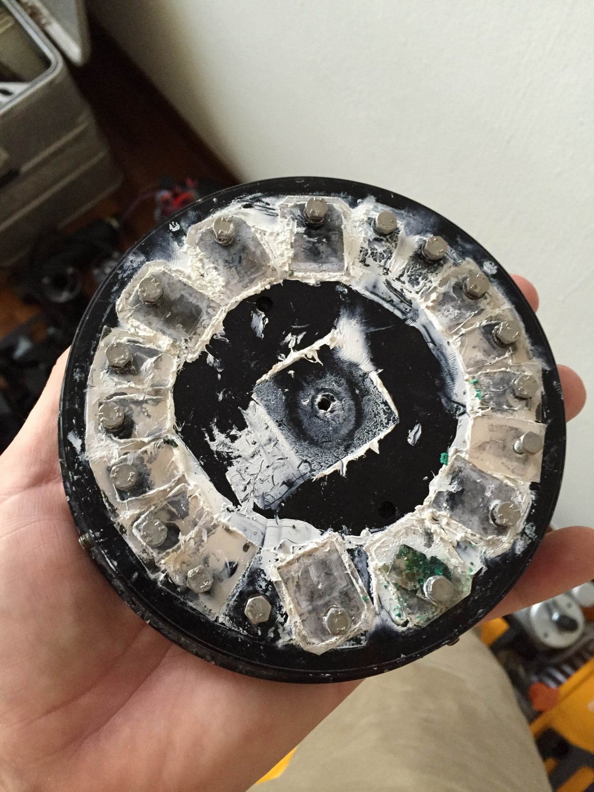

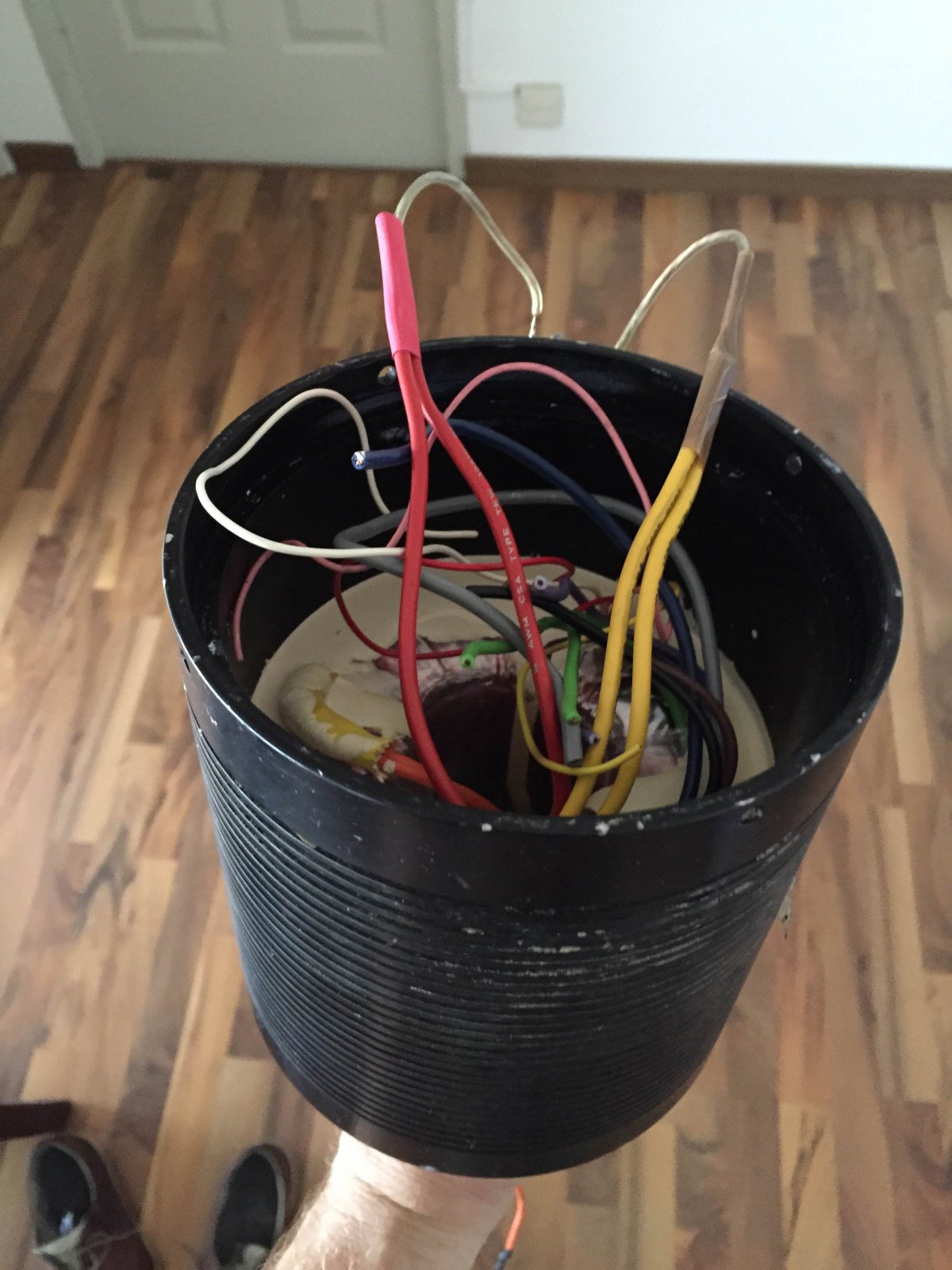

    I am using (or at this stage trying to use) your HPMC to control my 4 ROV thruster motors. They are 450 W, 24 DC geared motors. On each side of the underwater ROV I have Power pods that house in each a transformer (440V to 24V / 5 V and rectifier) and I am planning to put two of your motor controller bottom board there. The beauty of the pods is that they have the bottom lid where you can fit all the Mosfets so they get nicely water cooled from the outside. These pods have a pressure rating of 300m, but I'm not planning to go down that deep. I need to have the whole thing running by mid next year so not much time left. :) IMG_0569.JPG
    Picture of the pressure Pod inside:

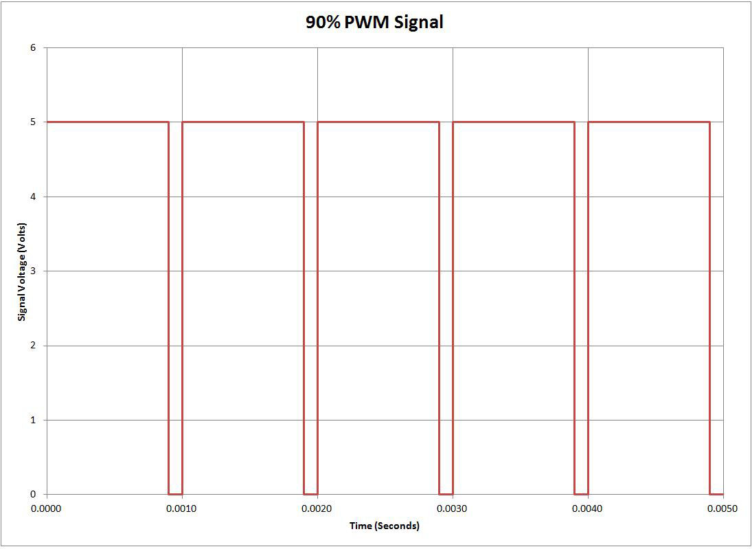

    you mean like this
    30 Amp. is a small wiper that should run flawlessly with this design ...
    Can you attach some photos ?

    Yes like this but negative spike is little bit longer. at he moment i dont have pics. Wiper motor is ok. I mean servomotor from car power steering its about 500 watt.
  15. Cvetan Cvetanov
    Cvetan Cvetanov Member
    May 30, 2015
    41
    Teteven Bulgaria
    1,462Coins
    2DOF, 3DOF, DC motor, Arduino, 4DOF
    I forgot to mention that pwm is 31 khz.

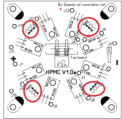

    Until you upload some photos of your build ... I guess you need to use the full 9 diodes 1N5819 beside the MOSFETs ...
    so they are able to absorb all the fast repeated Spikes and EMF falling current coming from the motor at the 90% and higher PWM duty cycle ...

    There is all of them but fried only 2. 1 from 3 upside and 1 from 3 in downside or other maybe in upside dont give attention because of circular design(i like it).

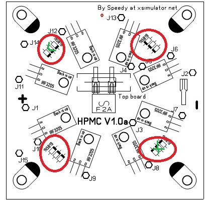

    there are 6 diodes in upper side +ve supply /3 for each MOSFET side "motor direction " ... the same on the lower side -ve supply ... they work together in a cross section for each motor direction ... So , which diodes do you mean ?
    @Cvetan Cvetanov ... Please provide at least the lowest bit of information as this is really hard to predict so far ...

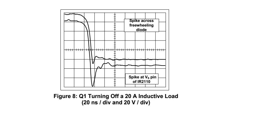

    You also need to download and read the above application note pdf file ...
    P.S. I've sent you some coins .

    1 from group of 3 diodes

    @Cvetan Cvetanov ... I guess you have a big sparks in the motor brush in this motor direction ...
    - try replace the brushes if worn out or flatten their top with a strong spring behind .
    - increase No of diodes in this cross section motor direction .
    - Lower the PWM frequency by 1/3 if you can .
