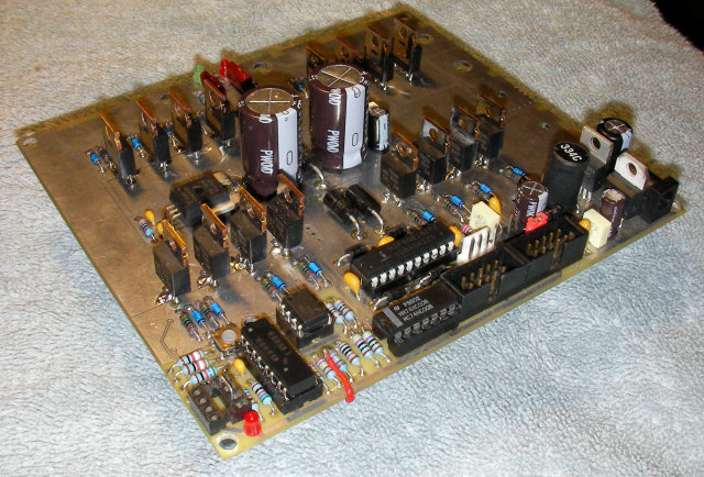

    Some issues have been resolved and the full 16 MOSFET are soldered in. Testing without and with heatsinks tomorrow, hopefully no smoke and fumes!

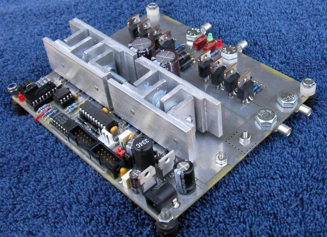

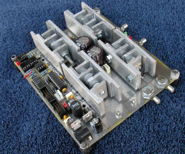

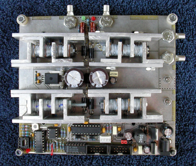

    Just did a test of the HPMhb-150A running several minutes in rapid back-forth switching of the wiper motor, which unloaded can draw up to 7A under those conditions. The ambient temperature was 30'C, and the max I measured was 32'C at the primary MOSFETs and the heatsink sides. This with no fan attached.
    Compared to what was occurring previously to this stage, the is the much hoped for success. :rofl: Now for some extended tests with various voltages, and then running the motors on my sim.

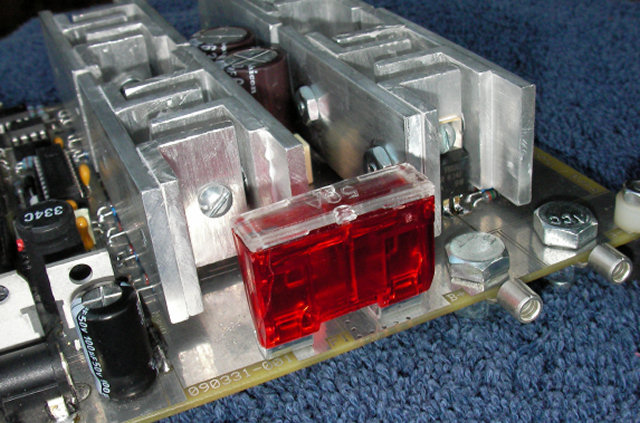

    Another extended test at 18.5V, this for 7 minutes duration applying very rapid motor direction reversals. The temps once again stabilized at 3-4'C above ambient. Then 2 minutes at 12.4V, and finally 4 minutes at 24.8V (125Ahr batteries).
    The last test at 24V had an interesting, and at first disturbing result. At the 4 minute mark all of a sudden, the motor stopped, and I quickly disengaged power. The temps on the MOSFET/heatsinks/HIP driver were all at a few degrees above ambient...WTF! Check the 10A fuse...good. Reconnect and still the motor would not turn, but the LEDs on the output were functioning, so the HIP could not be damaged. Then after a couple of minutes elapsed I touched the motor and it was quite hot. I checked the temp and it was at 38'C. What could have been the peak temp when the motor shut down? These wiper motors have electronics internally doing I don't know what. Perhaps including thermal shutdown, which obviously occurred since they are 12V being driven at nearly 25V...not what they were designed for. I hooked up the second (same model) motor, and voila! it worked normally.
    Well, this tells me that even though there was a malfunction at the motor, this did not damage any part of the HPMhb-150A. I still do not have the thermal and current protections active, so this I can consider a very positive result, even if it caused a temporary concern.
    After the motor cooled sufficiently, it still would not run, so obviously the internal circuits it has, are damaged in some way. Good excuse to tear them out and see if the motor itself is still good...should be.
    I think it is time to activate the thermal and current features from here on out.
