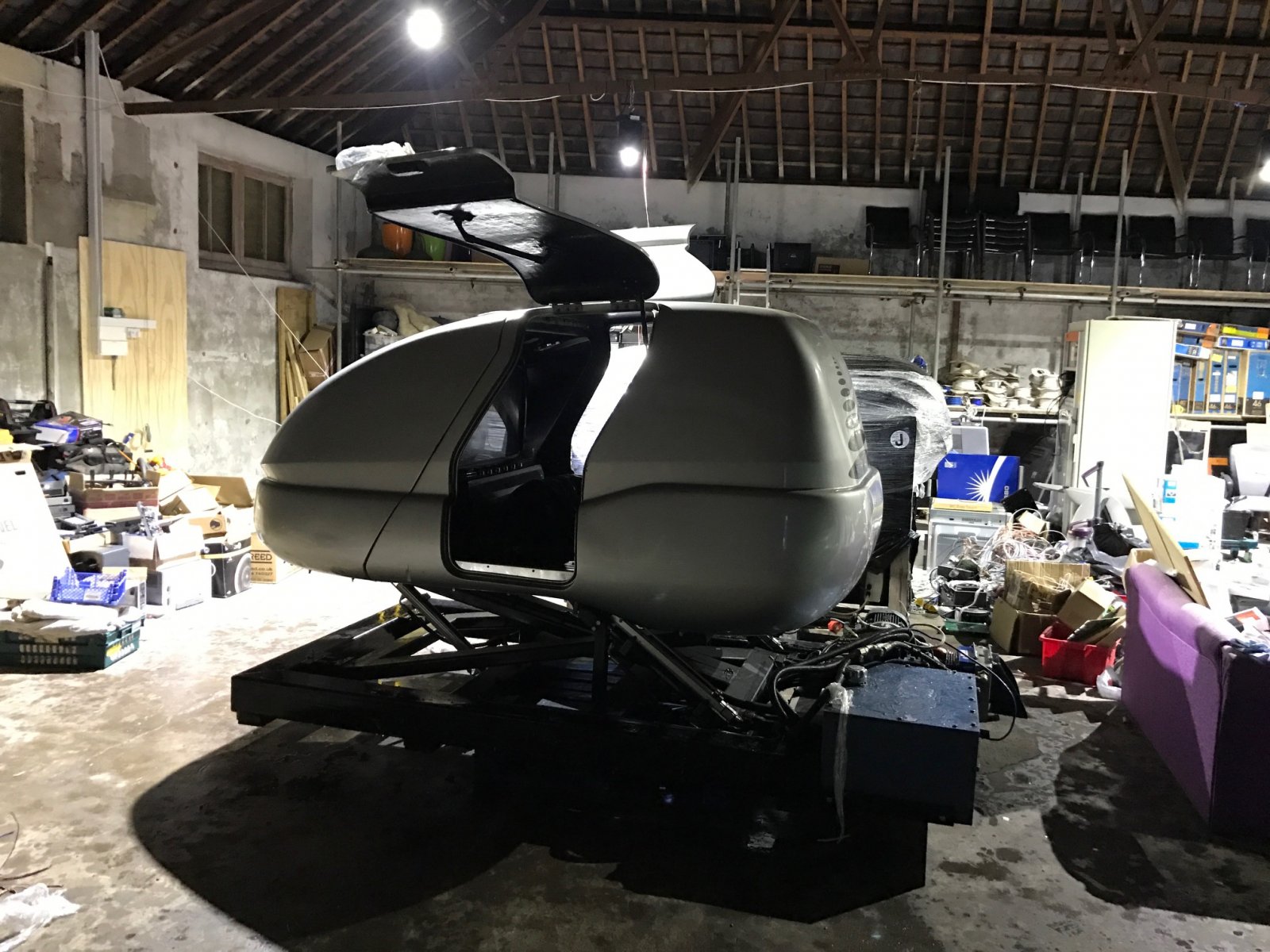

    Hi @Marco Dias ... that Giant beast is going to kill you for sure my friend :grin:grin ...
    This specific model you bought is what tempted me long time ago with the simulation world ... Congratulation :thumbs .
    I have not much experience in hydraulic accessories knowledge ... But I saw these hydraulic electric valves earlier in the market and as I can remember they are single pipeline each and supplied with 48V operated with a PWM signal as they give a " BUZZ " sound when they work ...
    There are different grades and speeds of those valves as per the operating pressure ...
    So for a single DOF you'll need two of these synchronised for forward and reverse piston operation and hold ... and they are not cheap as all other pipes
    For feedback signal I presume that an accumulative encoder is used for such long piston distance ... that would be a complex combination between mechanical and the encoder circuit ... such long distance must be covered with a high resolution feedback signal so not to waste the oil pressure tracking the poor motion feedback .
    The 5.5HP 3 Phase motor oil compressor can work directly with 7HP VFD where this size is so popular as used with some elevators ...
    I thought I could build one ended up with AC motors with gearbox ... take a look here for my first attempt .
    IMHO getting this thing back to it's original condition is a dream ...

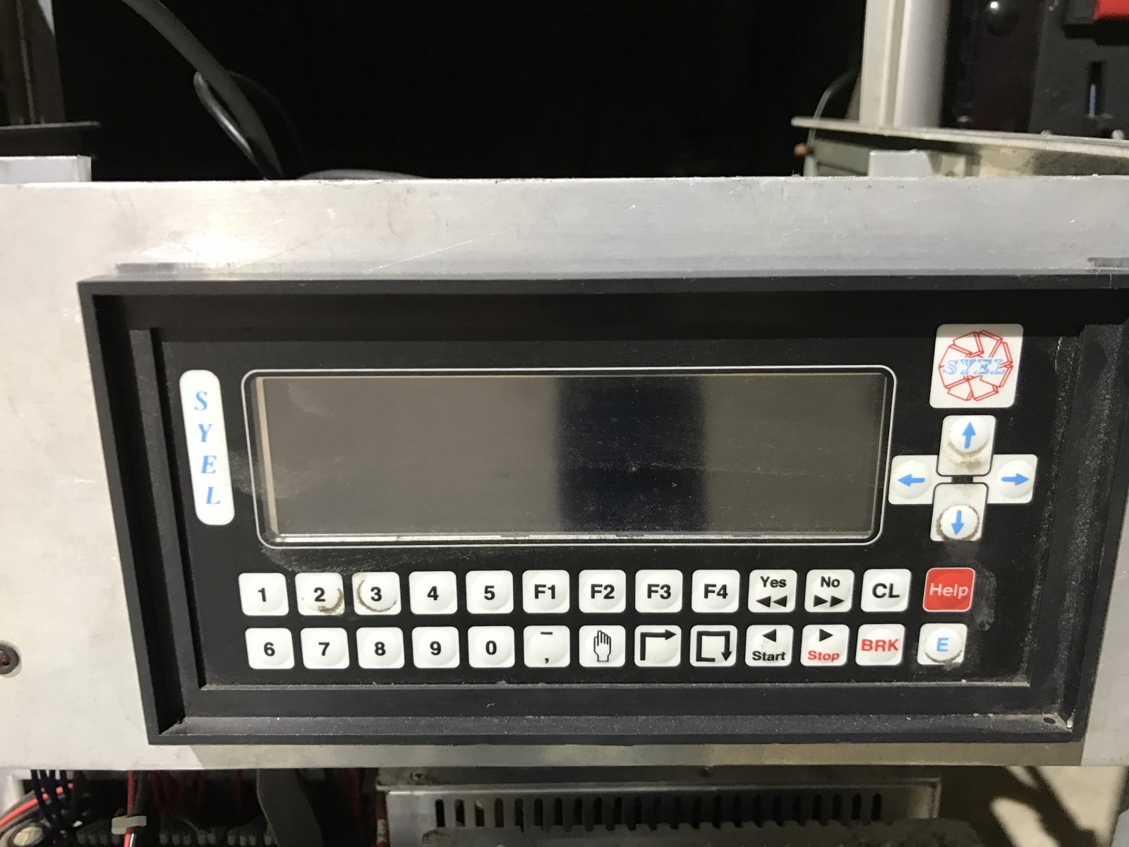

    The PDF I was sent for the controller is attached...
    Cheers
  3. Marco Dias
    Marco Dias Member
    Jun 10, 2016
    90
    Jersey, Channel Islands
    1,087Coins
    +21 / 1 / -0
    Btw, the controller isn't working.
    I saw a broken transistor on it so just ordered a replacement to see if that's the problem

    Wasn't a transistor,
    Is a MC34167TG Buck, Boost Switching Regulator IC TO-220-5
    The controller unit itself picture attached

    BTW ... Why is it hanging high like this ? Did you do that manually ?
    I see it half way up ...
  16. Marco Dias
    Marco Dias Member
    Jun 10, 2016
    90
    1,087Coins
    +21 / 1 / -0
    Got delivered like that...
    Not switched on yet there as 3phase converter not in yet ;-)
    Is that a problem?

    Isn't going to move without the hydraulic pressure I guess ... maybe a bit of cleaning and reading all labels + photos would be a nice first step ...
  18. Marco Dias
    Marco Dias Member
    Jun 10, 2016
    90
    1,087Coins
    +21 / 1 / -0
    Yes, going to do that as soon as I. An test the operation.
    Gonna take the car off and do a proper clean/oiled on all the mechanical parts
