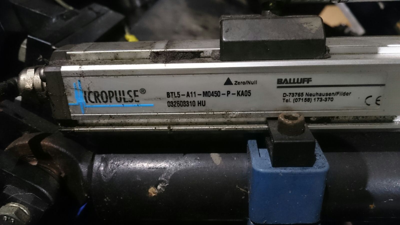

    the hydraulic positioners/encoders/transducers are BTL5-A11-M0450-P-KA05 by micropulse.
    from what i can gather they output 0-10 depending on the position they are... is this accurate?
    If so, how do that information gets fed into the Arduino board so SimTools can work with this info?
    Finally, is the Arduino the absolute best interface to use, or is there other alternatives that are better?
    Thanks for your help...

    The transducers have according to the data sheet a measure length of only 150mm. If the range of the actuators is more than 150mm(that's what i believe), you can monitor only a part of the actuators movement.
    The analog output (0-10V) from the transducers can be connected to the arduino via a voltage divider.

    Attached is a picture of the encoders on the sim
    Your English is amazing... ;-)

    Apologies as I induced you in error
    The encoders on the machine are

    Yes, i have just seen the picture.
    That's good, one worry less. :)

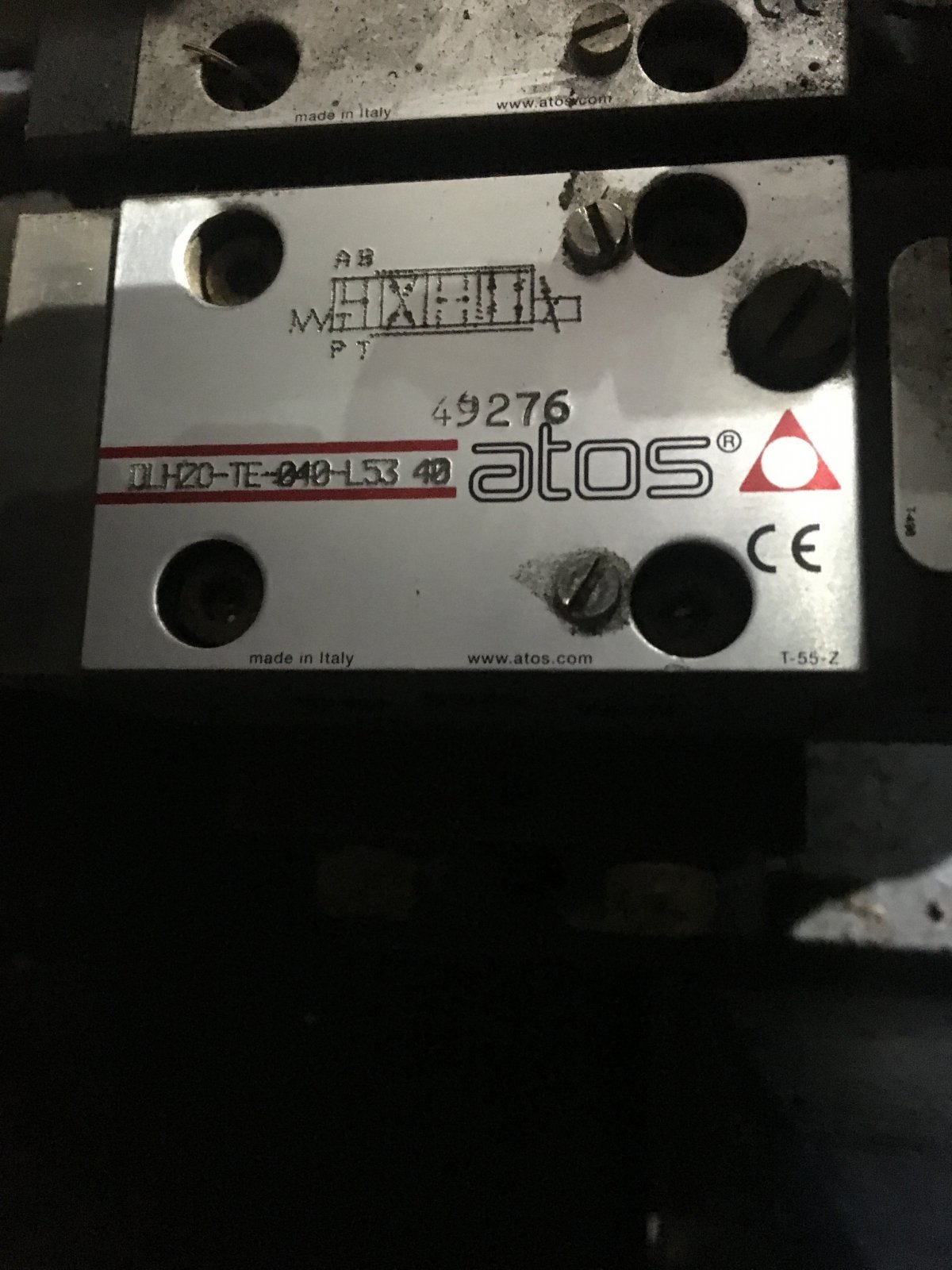

    Looks as I am lucky and i have solenoid servo controlled valves...
    DLHZO-TE-040-L53 40

    I would say you've got the jackpot ! :cool:

    Now that we know what valves are these and that they the really good ones, it comes the question...
    How on earth can I control them haha..
    is it with a variable voltage like 0-10v??
    I see some for sale on ebay almost the same as mine at 1500 each...
    kinda expensive I have to say.... glad I already own them hahaha

    Yes 24V power supply and +- 10V input signal.
