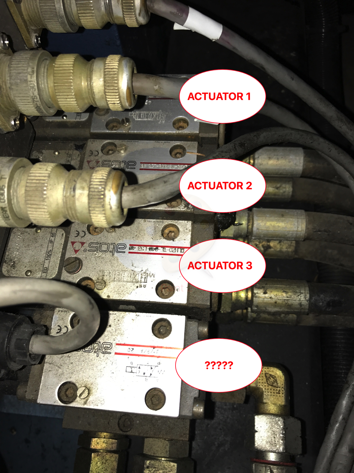

    Help Please..
    Got the Three phase system working and dumped the old sim controller cabinet... was too old and rubbish.
    so now time to get my hands dirty.
    Only a bit scared to break something for not knowing what I am doing with the valves.
    Worst even hurt myself and burst pipes so here it goes the questions.
    Attached pictures shows most of the components on the hydraulic system/
    There are 4 Valves which confuse me.
    From what I can gather 3 are for each of the actuators, but what's the fourth one for??
    Activate the flow into all the valves??
    When I apply 24v to the 4th valve the pressure goes mental..
    which takes me to my second question...

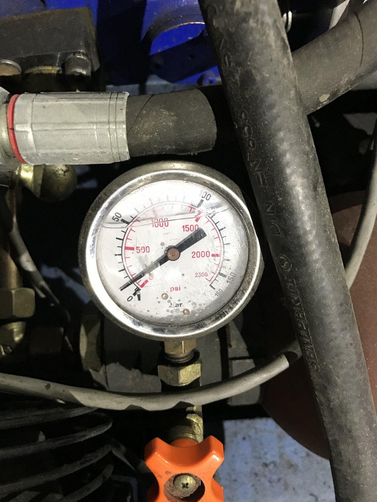

    What should be the safe working pressure on one of these systems?
    when the motor running and nothing else happening to the system, the pressure meter barely moves but applying voltage to the 4th valve it goes 3 quarters of the way.. I only tapped it momentarily...

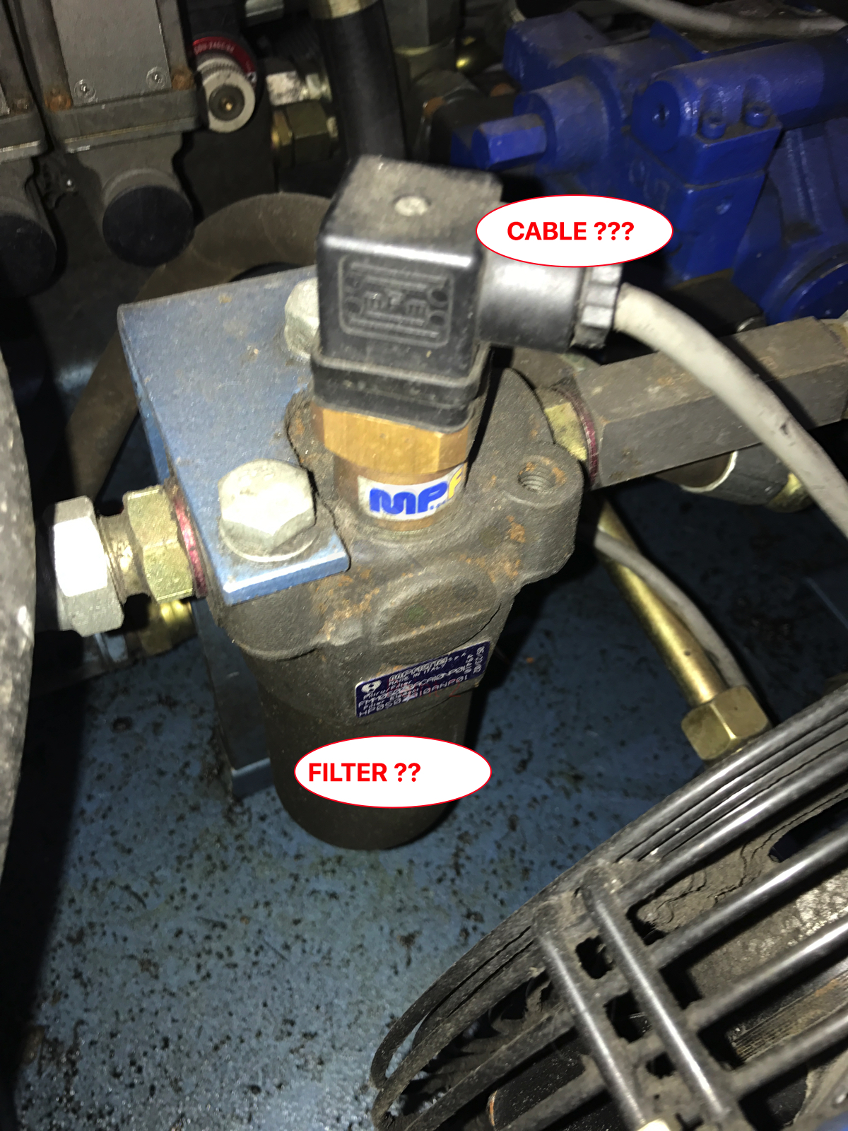

    Also, there is a picture showing some sort of filter and there is also cable there... What's that cable for?..
    I want to build a small control panel before starting to work on the electronics to manually operate the sim.
    Basically a bunch of push buttons that will allow me to expand/retract each of the hydraulics and somehow adjust the speed that they move.. maybe with a pot for a rotary switch or something..
    How can I go about this please?..
    thank you so much guys for your support so far...
    Marco
  8. Bernd Manger
    Bernd Manger Active Member
    Oct 6, 2015
    156
    1,055Coins
    +263 / 12 / -0
    Sorry, but that's too tedious to find out from afar.
    My advice for you:
    Make a drawing with all components (motor, valves, filters etc.) and with all hoses inbetween. (Similar to an electric diagram).
    Then try to find out which function each part could have (www.atos.com and others).
    Try to find out in which direction the oil could flow.
    Then everything will become clearer. I would do the same if i were there.
    Much success and please do not be impatient. Everything needs it's time.:thumbs

    Right...
    Good news and bad news..
    I sussed it all out and I now understand fully how my sim works.
    basically there is a closed loop, with a valve that once triggered builds up the pressure and when one of the three valves gets triggered it moves the actuator.
    I have a physical protection cylinder to stop over pressure from happening installed.
    Also the filter I was on about on the previous post, it's a pressure filter..
    Basically it triggers when it detects pressure from the motor working..
    The speed and direction that the actuator moves is made in a simple -10 <> 0 <> +10 voltage between two contacts of the valve
    The bad news...
    Two of the valves on the damn thing are gone..
    One is on it's way out as it moves very slowly the actuator and the other one doesn't respond at all so the actuator only moves in one direction at full speed.
    So, these cost used about £1500 on ebay, so i am thinking this is the end of my project until i can source two units on the cheap...
    Then I started thinking...
    What is wrong with them is the electronic side only, as the mechanical works well.. i used the one that works well on all three positions and all the actuators move nicely..
    so looking under the hood of the servo valve, there is two cables
    one two core and one small ribbon.
    I am assuming that the two core is for a coil voltage as it's a thicker cable, and the ribbon is for the servo functions ( feedback, coil position, etc)
    so, what Would happen if I bypass the electronics side of things all together on the valves and apply a controlled voltage into the the coil direct??
    With the working one i can monitor what sort of voltages go onto it on normal operation, so could I not do this myself??
    I don't care about the feedback coming from the valve itself as I have an external Encoder attached to the actuator which is going to report back where the actuator is physically..
    Any thoughts throw it in the interested ones..

    Maybe you do not know, but hydraulic systems work with pressures up to 300 bar. That will not work.
  16. Marco Dias
    Marco Dias Member
    Jun 10, 2016
    90
    Jersey, Channel Islands
    1,087Coins
    +21 / 1 / -0
    Hi
    You are very correct.
    My system has a mechanical pressure control system that stabilises max pressure at 150 bar...
    I really hope that thing never bursts a pipe as it won't be pretty.
