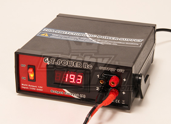

    its for charging, probably no good
    you need to look at a proper power supply like a converted server PSU, proper PSU and or a car battery in parallel with a PSU.
    20 amps is not really enough, look at 40 amps at least for extra power if you ever need it.

    well i grab a few old psu from some old laptops i had. they were a 19v 3.7a and a 12v 3.7a. I hooked them both up and the 19v really makes those little motors fly. i don't know about stall force though. (how stronge they are)
  4. bsft
    easy way to find out @james wheeler , thrash the motors till they break.
    As for the power supplies, dunno, try them out.

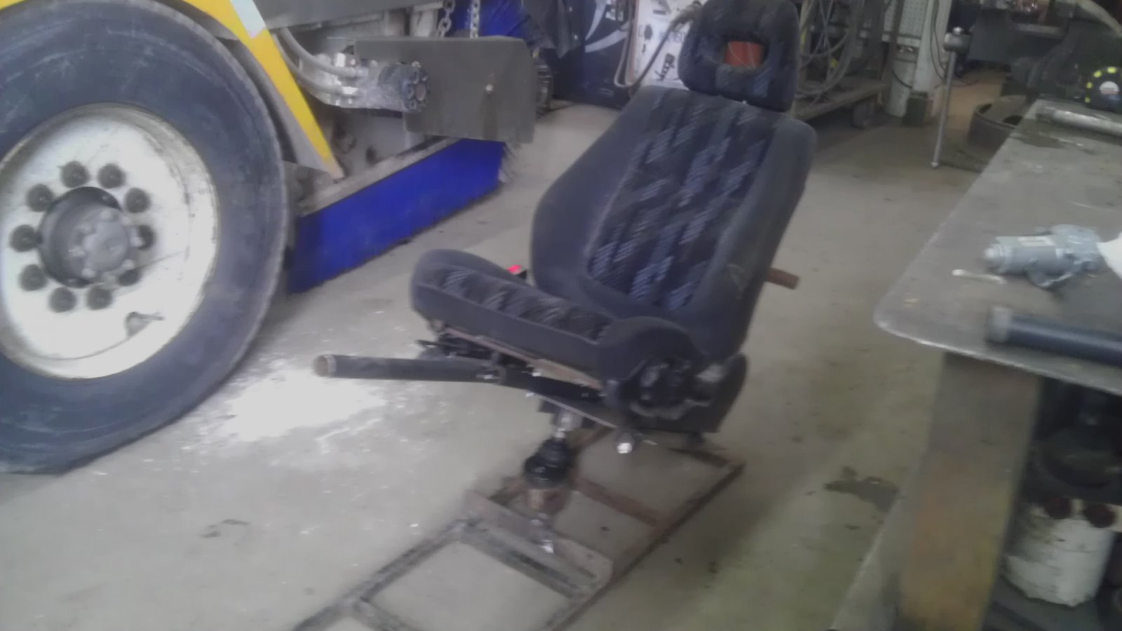

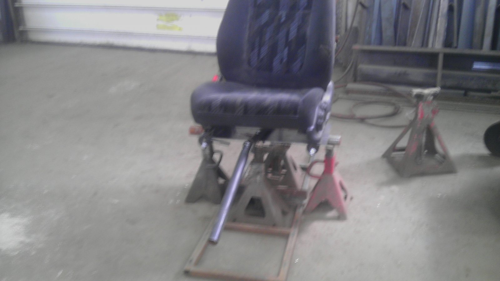

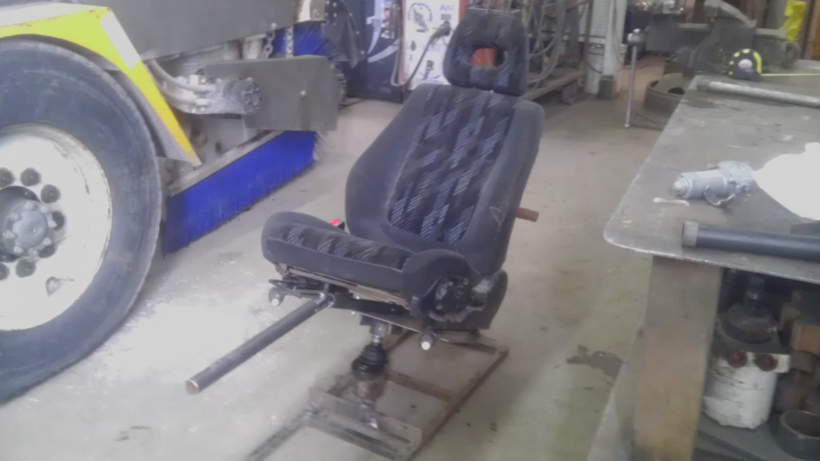

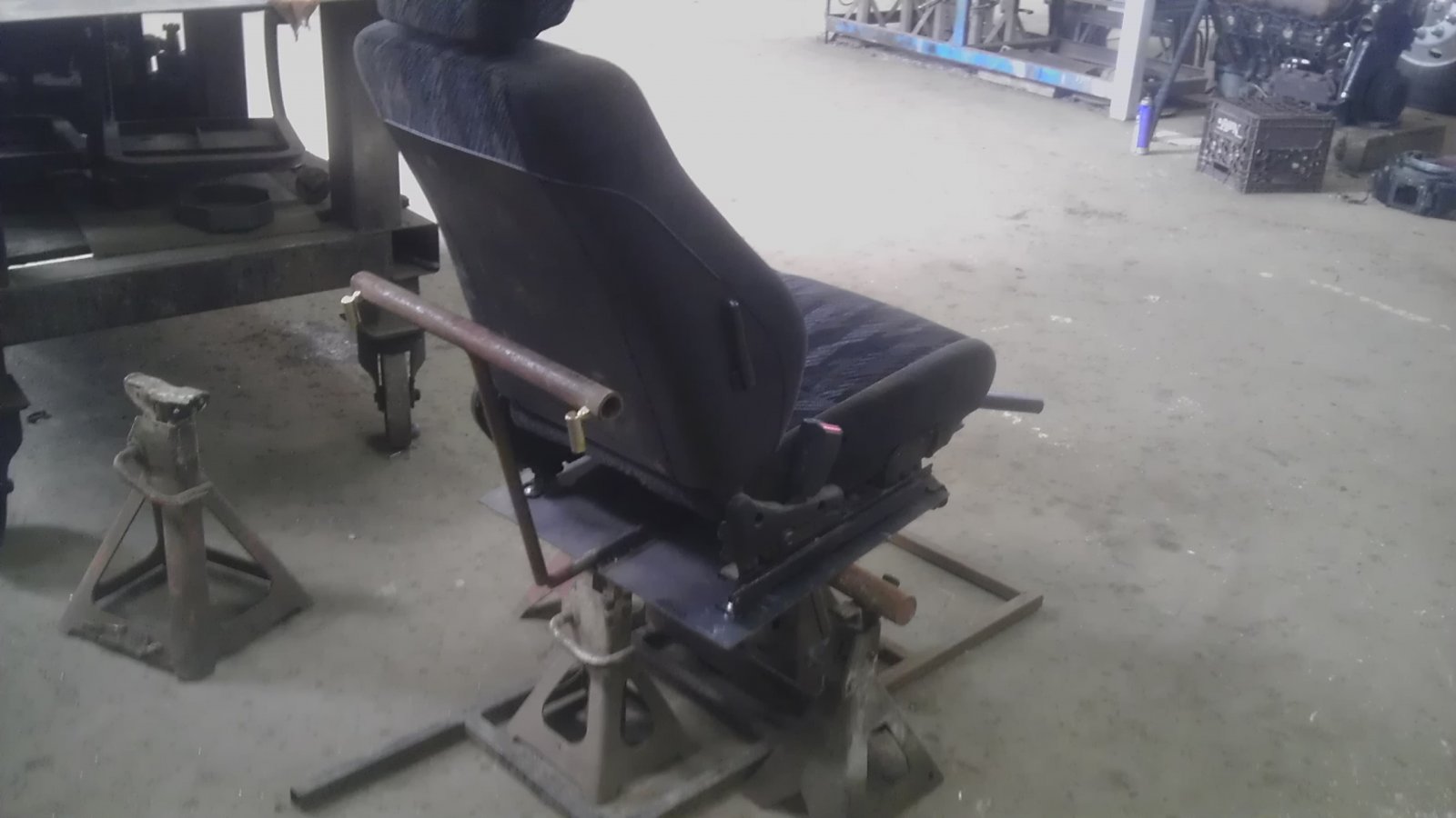

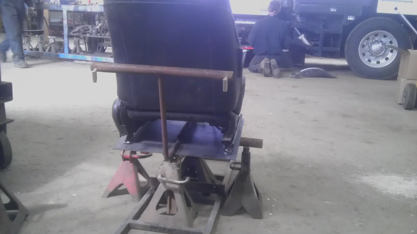

    I took some pictures of the seats hardware after I slaped it together, and yes that is a old patio umbrella shaft sticking out the front. lol I found everything so far for free. I did "f" up on the placement of my ball joints but I will fix it. Just got ahead of myself IMAG0881.jpg IMAG0882.jpg IMAG0883.jpg IMAG0884.jpg IMAG0885.jpg IMAG0886.jpg

  16. bsft
    looks good on the frame, love a good "slap" together build. Most of mine are like that.

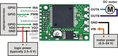

    Yes. Two of these motor controllers should work with any micro-controller where you have 4 available logic level output pins, two pwm pins to output a duty cycle, and of course, the proper coding to operate them.
  19. eaorobbie
    20,491Coins
    +1,687 / 23 / -2
    These can be wired in like a std H bridge using a PWM and 2 dir pins.
    Beware they are a bugger to run at 24v, better used at 12-16v. Warning contained on pololu site.
    " While the overvoltage protection typically kicks in at 27 V, it can trigger at voltages as low as 24 V, so we do not recommend using this motor driver with 24 V batteries, which significantly exceed 24 V when fully charged."
    Lots of info here, http://www.pololu.com/product/1451
    Hook up would be like this and doubled for two units but one micro controller.
    **Picture came from - http://www.pololu.com/picture/view/0J3706

    I'm curious what part of my analysis you disagreed with @eaorobbie ? I think we said the exact same thing! You said hook up like a standard 2 pin direction controlled h-bridge with a PWM pin. He wants to hook up two of them. Would this not equal 4 direction pins and 2 PWM pins if it is done on one micro controller?
