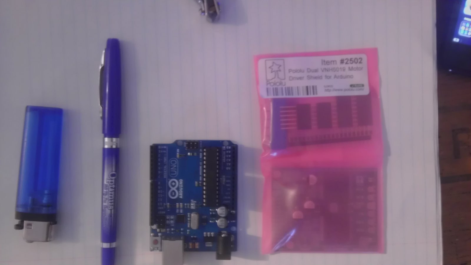

    the boards are here.:) IMAG0903.jpg

    BlazinH I took your advice and bought a uno and the pololu vnh5019 sheild. now lets get them working. they just got here so now the code. i did check the link you provided but was it ment for a shield or my origional idea?

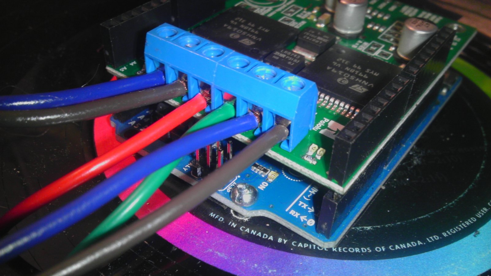

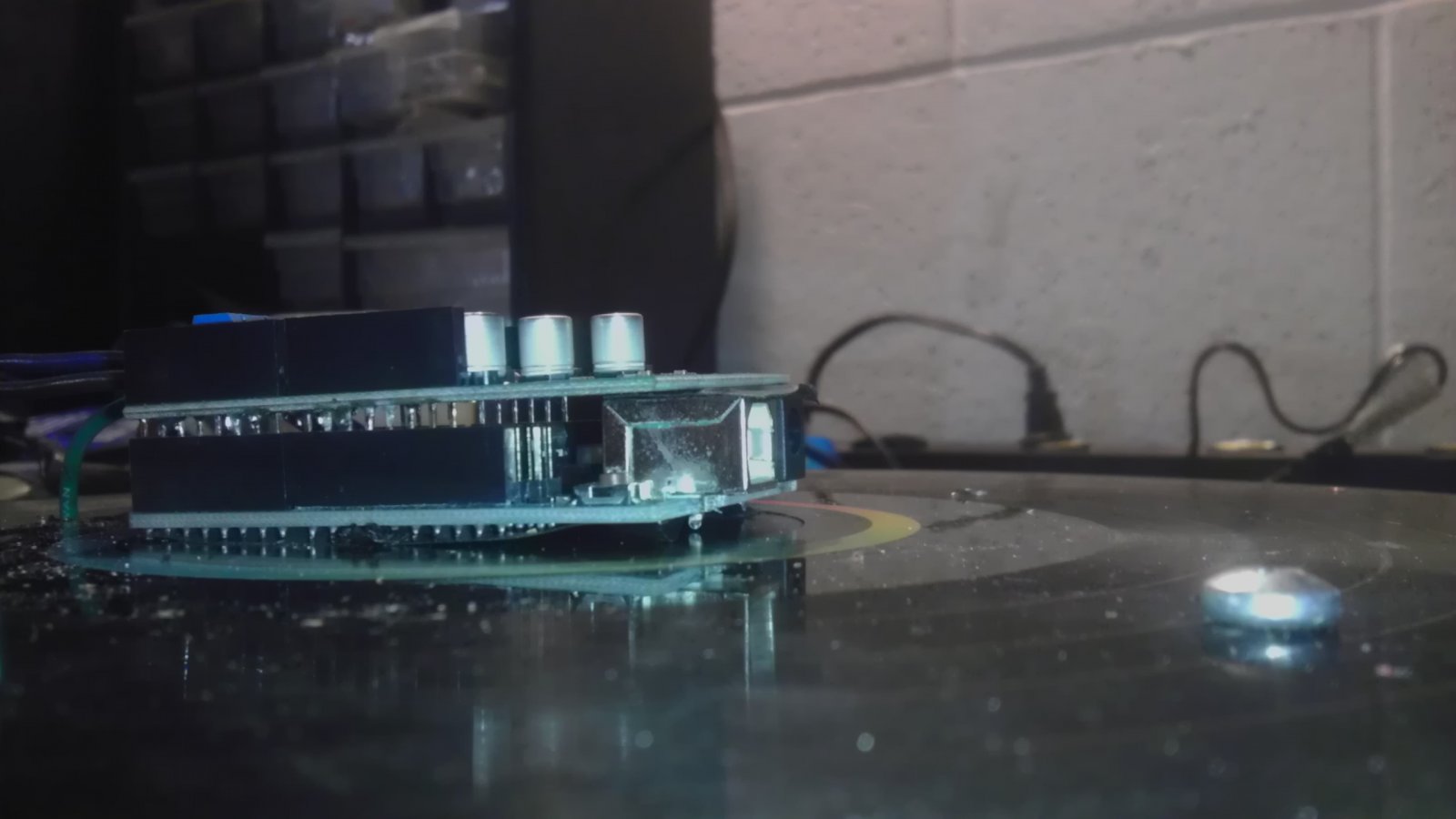

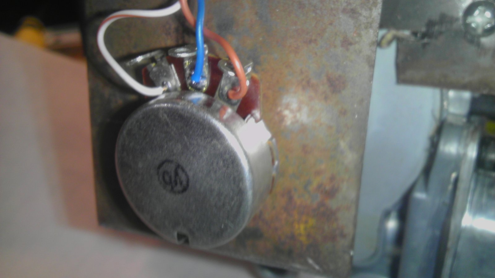

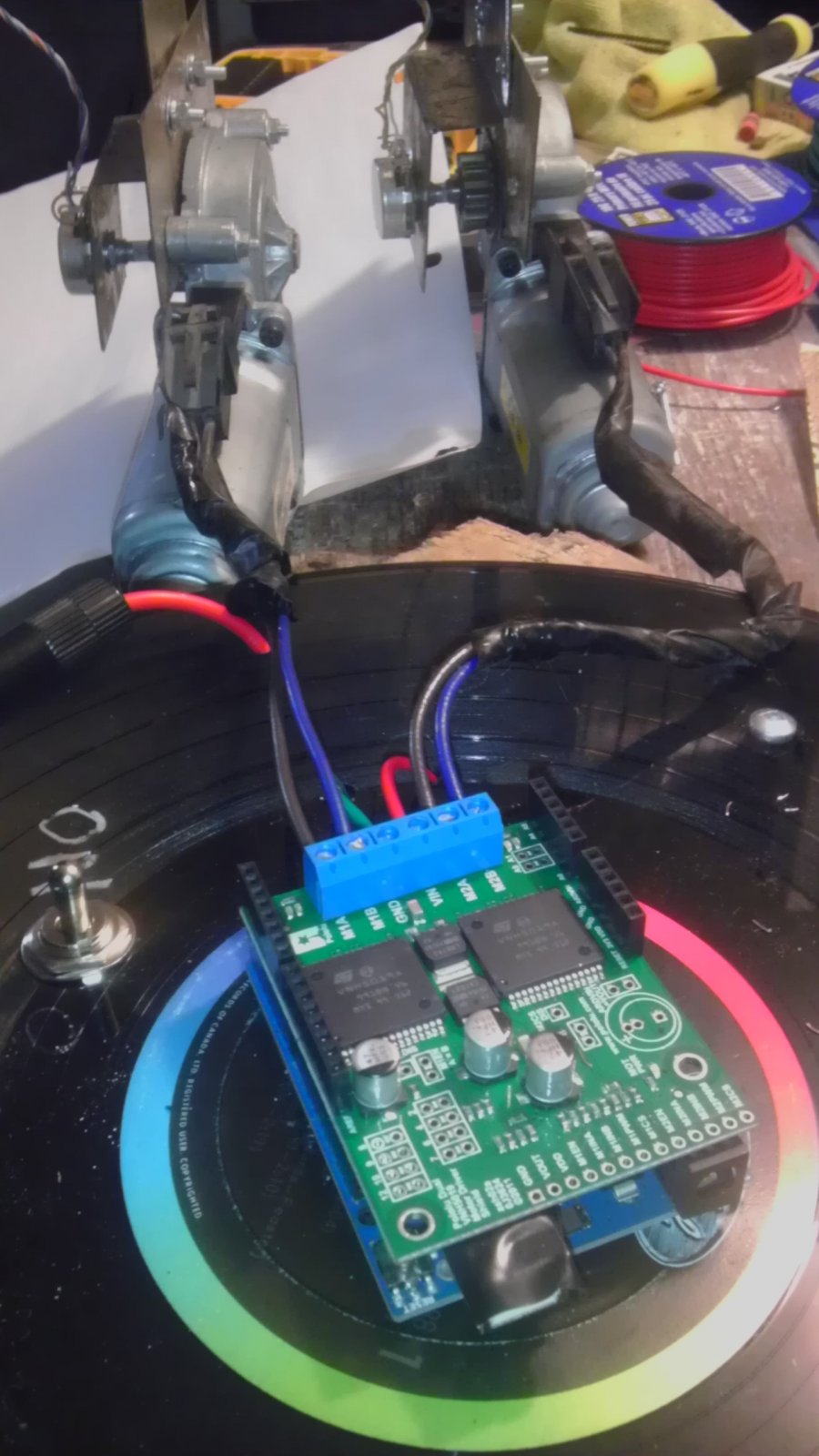

    OK i have gotten this far building all the hardware and wiring. The only thing I am not sure of is the pots wires.
    this is just a test bench (although its a old record screwed onto a couple of 2x4s) in a sence. I will rewire everything when i bolt it to the frame. Once I learn how to wire the pots I can move onto code.
    My power supply at the momment is still my old 19v 5 amp laptop power. will this effect the code at all?
  9. eaorobbie
    20,491Coins
    +1,687 / 23 / -2
    Ah none of the Ard code is setup for stacking like you have, unless changed recently.
    Pots signal wire goes to the Analog pins on Ard and +ve and -ve go to 5v and gnd respectively.

    is pololu motorboard not a threw way for the signals from the pots? you are saying i need to connect the pots directly to the ard. i assumed the siglals would relay through the pololu to the ard. they can bedissasembled and wired sepertaly but i wanted to avoid as much solderimg as possible.

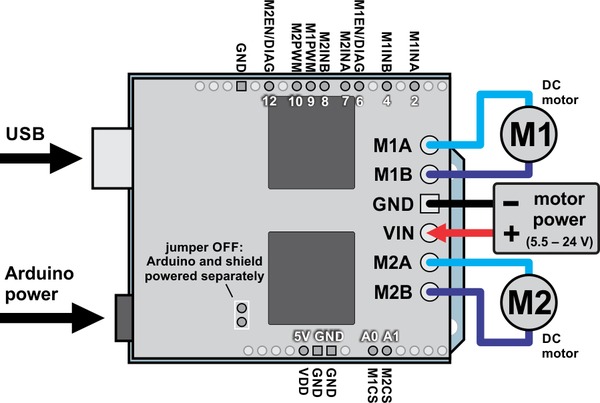

    If the vnh5019 motor driver has the same pin mappings as the Motomonster then it should work stacked with the code used as is. If the ards pot input pins used in the code are available on the sheild, then I think you could solder them to the sheild instead of to the ard. However, if the pin mappings are different than above, you will either have to separate the shield from the ard and wire unstacked, or change the code in the ard so it will use the correct pin mappings for the vnh5019.

    using this image
    from pololu and blazinh pin lay out I hooked them up seperate but I think somehow the conntroller is dead. B4 I was getting a green and red light on either side of the hook ups for the motors but now there is only a blue light meaning that the power is on sheild connection.jpg

    @eaorobbie can you please just confirm that I am starting to figure this out.
    using the written pin diagram and the vnh5019 picture above I am assuming that this is how the modified wire hook up should be laid out.
    arduino => pololu vnh5019
    pin 4 => pin 2 m1inA
    pin 5 => pin 9 m1 pwm
    pin 6 => pin 10 m2 pwm
    pin 7 => pin 7 m2inA
    pin 8 => pin 4 m1inB
    pin 9 => pin 8 m2inB
    5v => 5v
    GND => GND
    POTm1 => A4
    POTm2 => A5
    I have been reading the link you sent me and if this is correct I will start putting the power to it.

    The pin mapping modifications you made appear to be correct if you want to use it as a shield. However, if you are not going to stack it (as recommended by eaorobbie) then you can use the general purpose pins [1 in pic] on the vnh5019 to wire to instead.
