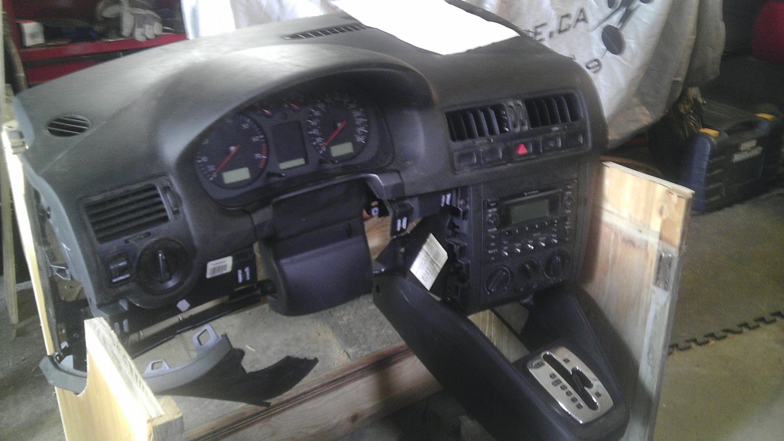

    The next stages of evolution begin
    • Creative Creative x 2
  2. eaorobbie
    20,503Coins
    +1,687 / 23 / -2
    Nice idea to use a console from a car.
    What type (model) did it come from ?
    When comes time to rig the dashboard together I can assist in using steppers. if you need help.
    Do like the idea , never had the time to do it myself.
  3. james wheeler
    james wheeler Active Member Gold Contributor
    Mar 17, 2014
    204
    - 143Coins
    +48 / 1 / -0
    Its from a2001 vw jetta. Nice simple design.
    I do want to set up the tack and speedo, will I need a seperate arduino for it?

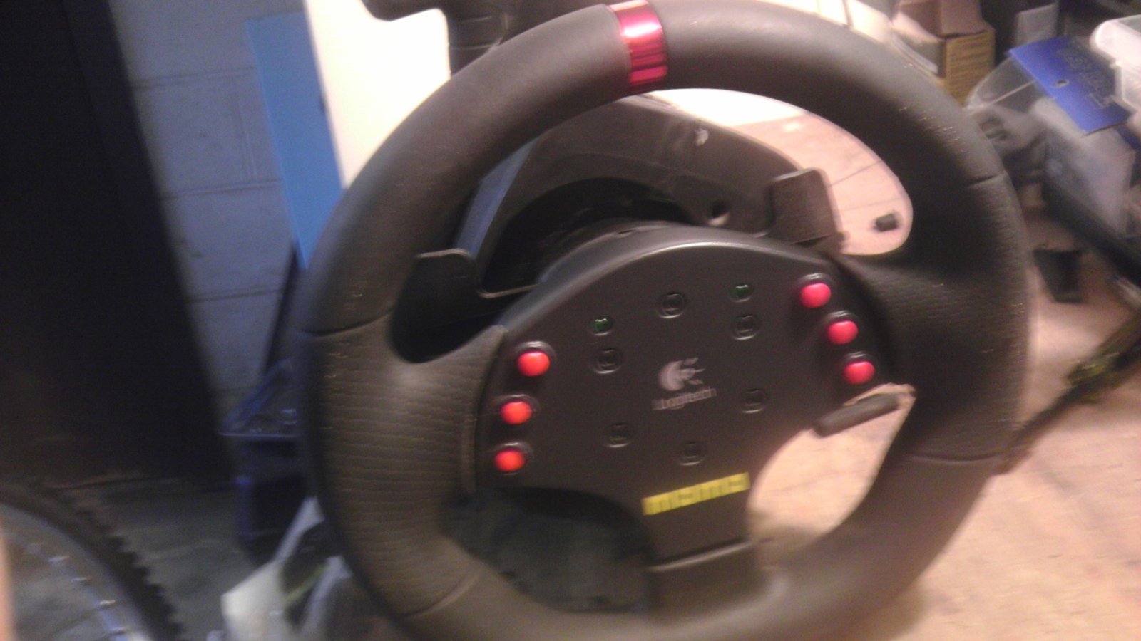

    my momo wheel will be installed into the old steering colum and the shifter will be moved to the center console.
    The light and dimmer will work and the hazards will be the on off switch.
  4. eaorobbie
    20,503Coins
    +1,687 / 23 / -2
    Thought I recognized it , cool yes nice and simple but effective.
    Ok to control a dash I use an ard and stepper driver and replace the original motors and bits , basically just use the front of it and clean skin the back and then use the GameDash to talk to that one, not the Game Engine.
    All sounds cool, should turn out rather neat.

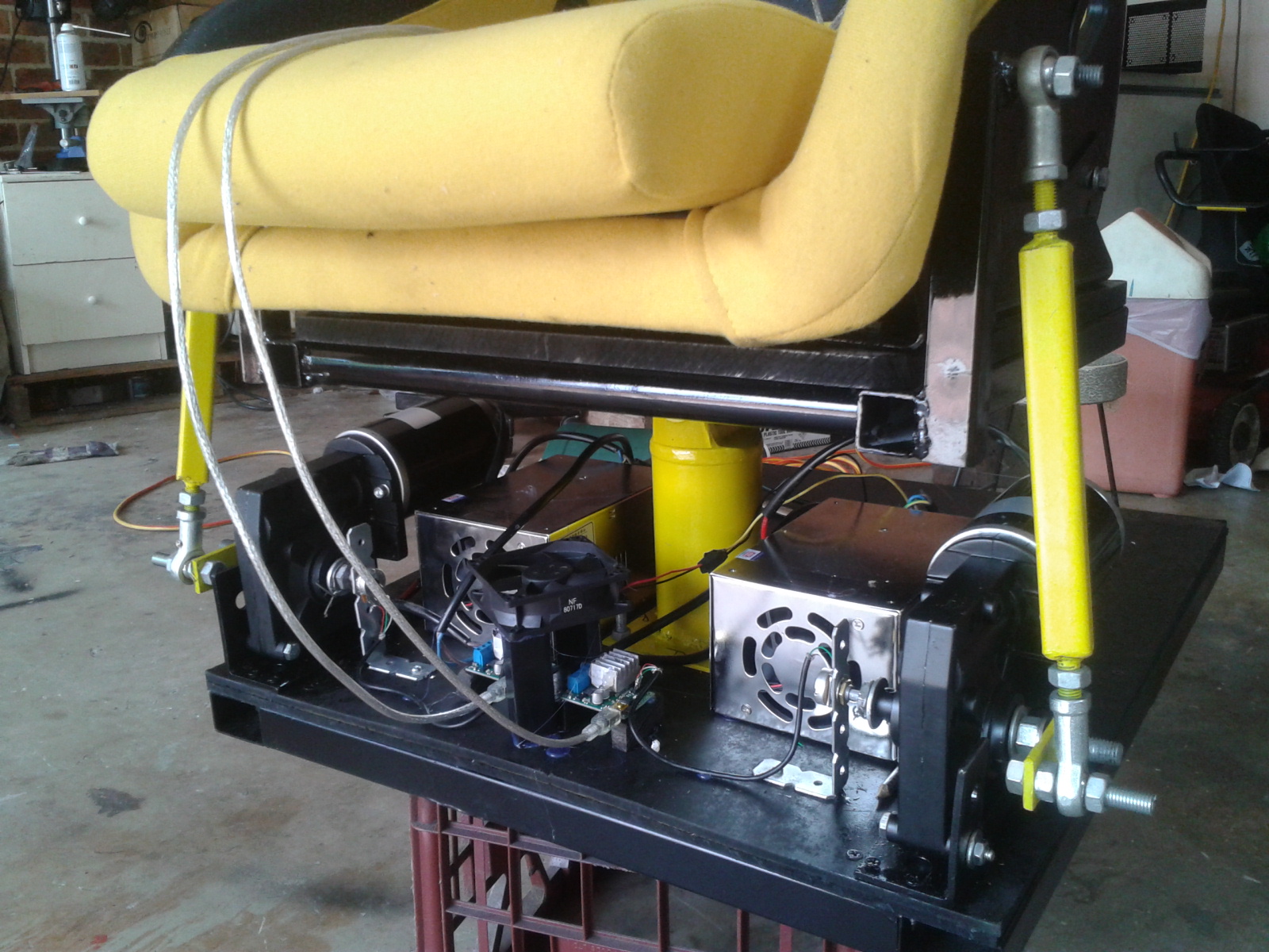

  6. bsft
    do you mean like this?
    or connected to the steering frame, dont have a pic but done that as well
  7. james wheeler
    Mar 17, 2014
    204
    - 143Coins
    +48 / 1 / -0
    Some what but further forward. My idea is to have a base platform about 2 feet wide and 5 feet long. The seat and pedals with mount firmly to the platform and the whole assembly will pitch and roll. I also want it to swivel from side to side for traction loss. Not much mabey 10 degrees. I was thinking that to reduce the amount of torsion at the ball ends i would move them closer to the pivot point.
    My next question is about distance vrs travel vrs power.
    Does a srat move more the closer you connect the actuators to the base of the set? And do they need more energy to work?
  8. bsft
    generally, the higher above centre of gravity, shoulders, or the further away from the pivot and mounting as you can, my foot motor mount sim, is the way to go.
    Both those options give maximum effect for a full frame.
    Its not so much energy for them to work, but less stress for them to work,
    In the beginning of sorting the big worm gear motors, I tried different placements to try to reduce current absorption with no success, but I did find the motors worked better in places where it was above the centre of gravity and or simply further away from the pivot and mounted as high as feasable.
    Design is important, DO NOT use springs to overcome bad design or balance, take your time to get it right.
    I know what works.

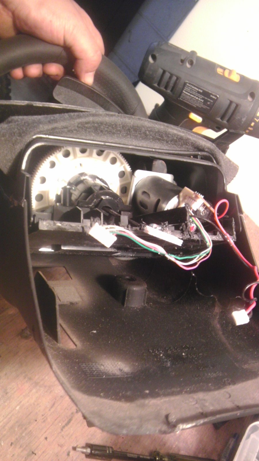

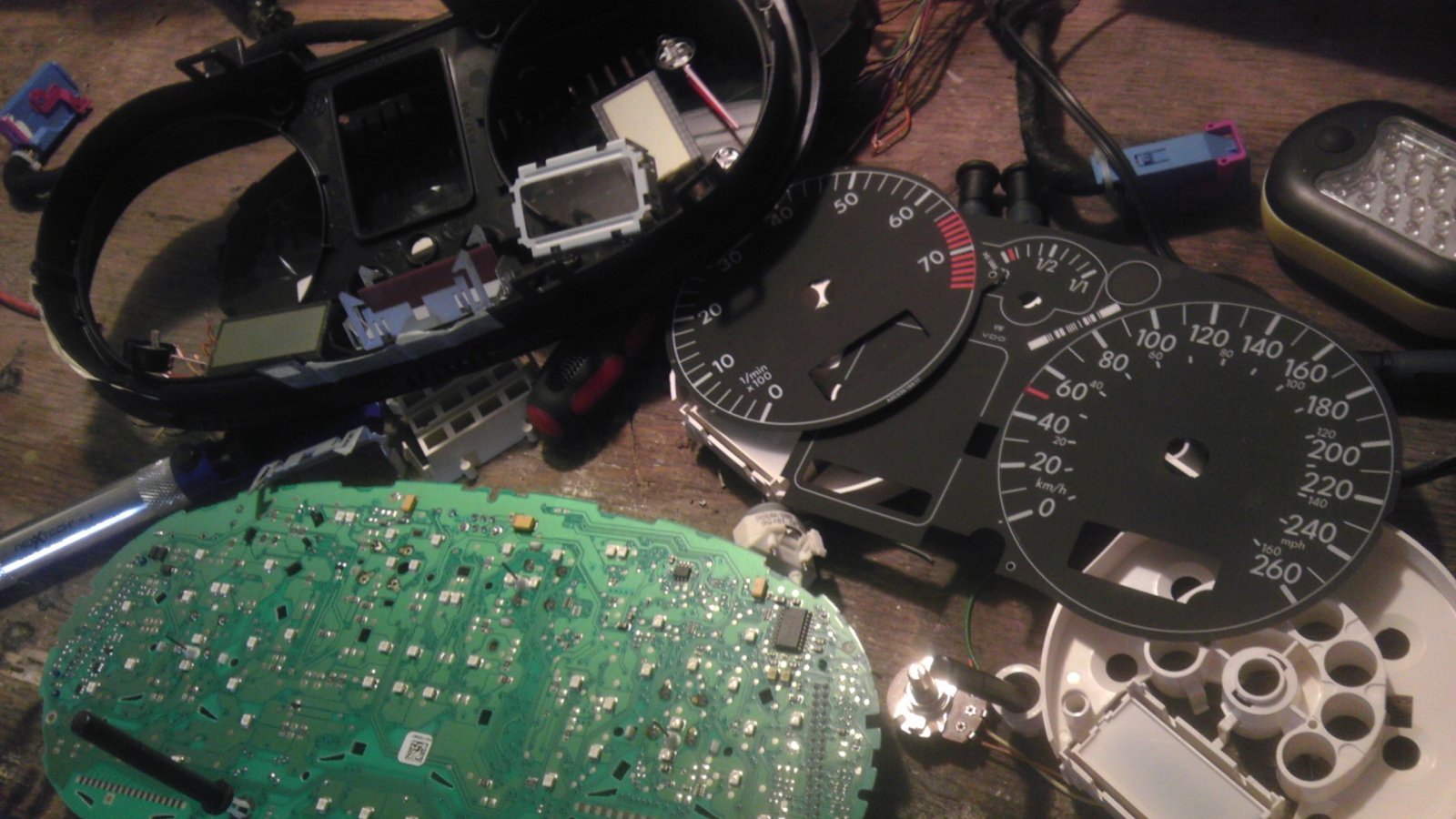

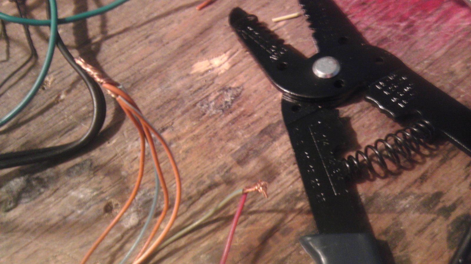

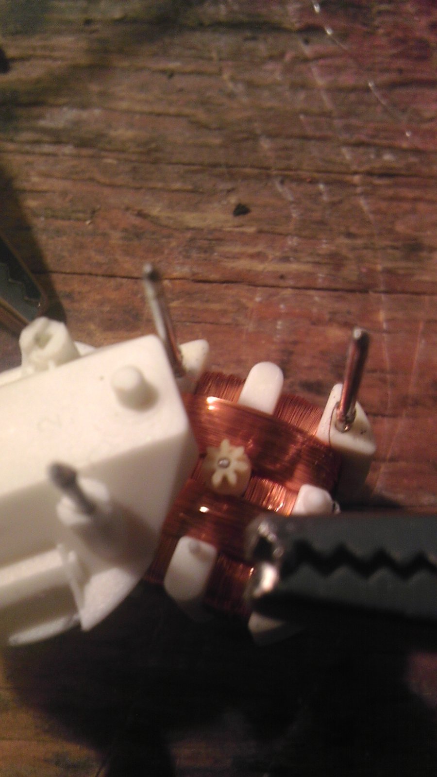

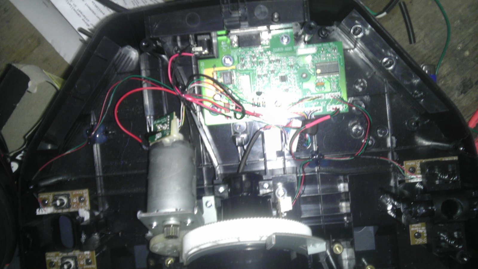

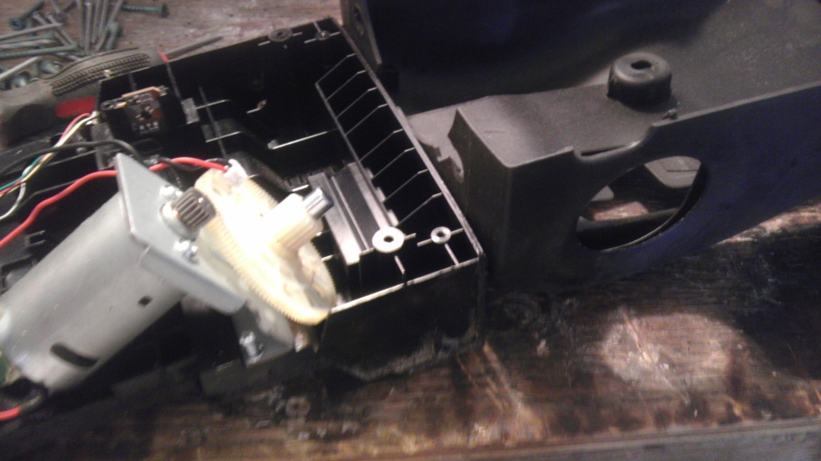

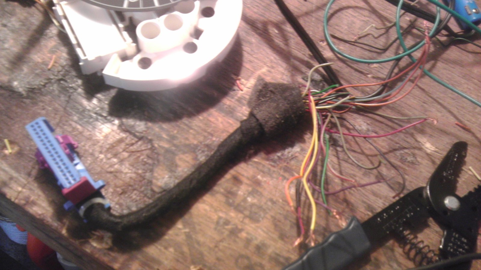

    Well today was Dash day.
    I first wanted to find the clock and lights wires and out of 32 wires it took some time.
    But by connecting the grey/blue wire with the red/black wire and hooking up the +12v then the 3 tan wires to the - 12v I was able to bypass all the dummy lights and in board computer.
    Next will be the speedometer and tachometer.
    No clue.
    I figure the best bet is to use new servo motors. But first I had to take apart the entire dashboard to unsoilder the old ones.
    Now to rebuild.

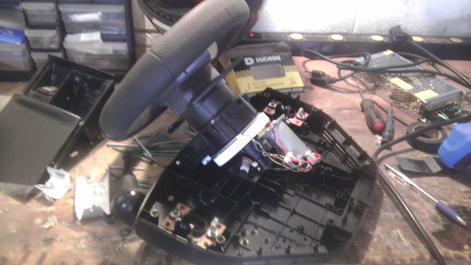

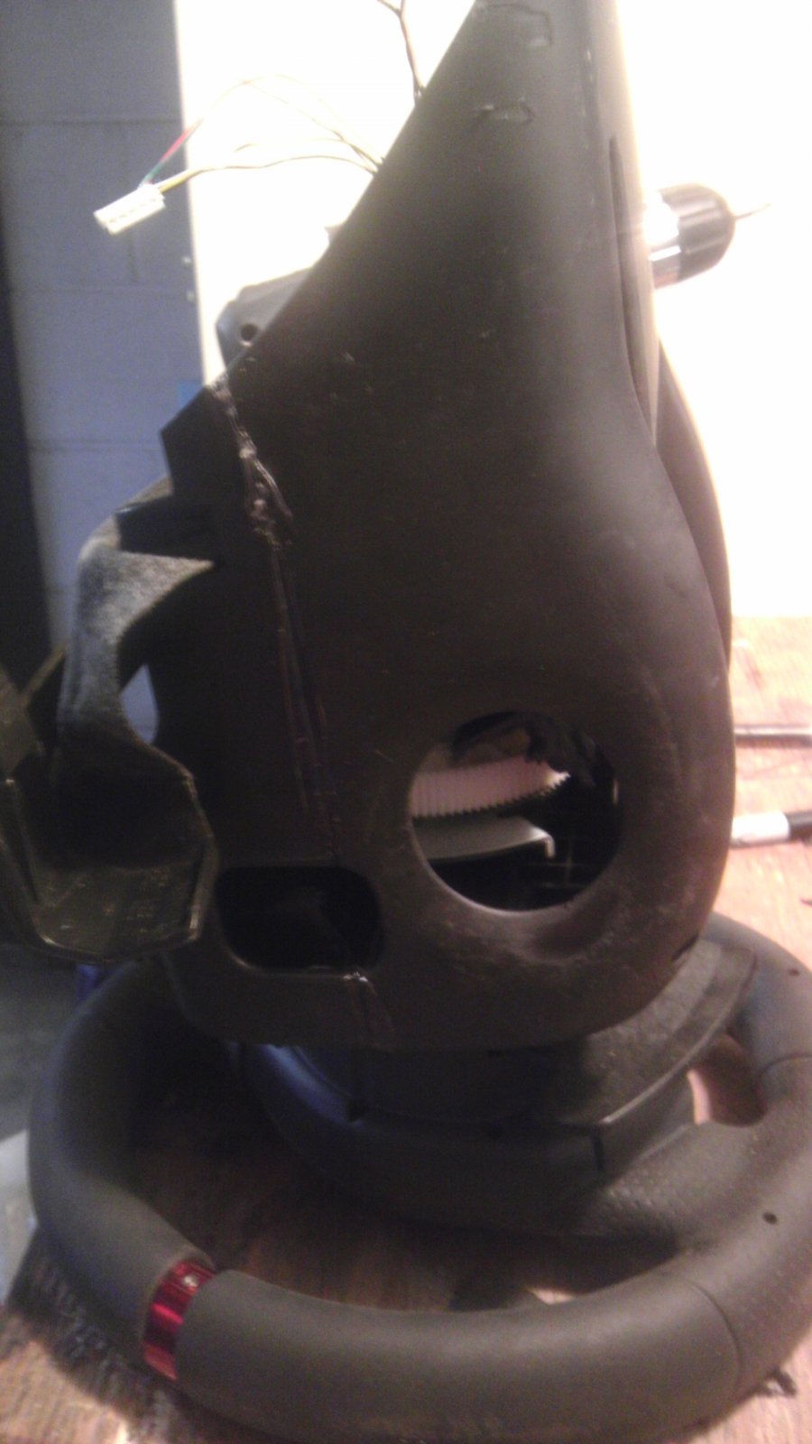

    The new momo wheel chopped up to fit into the old steering column plastics of the old jetta IMAG1065.jpg IMAG1066.jpg IMAG1067.jpg

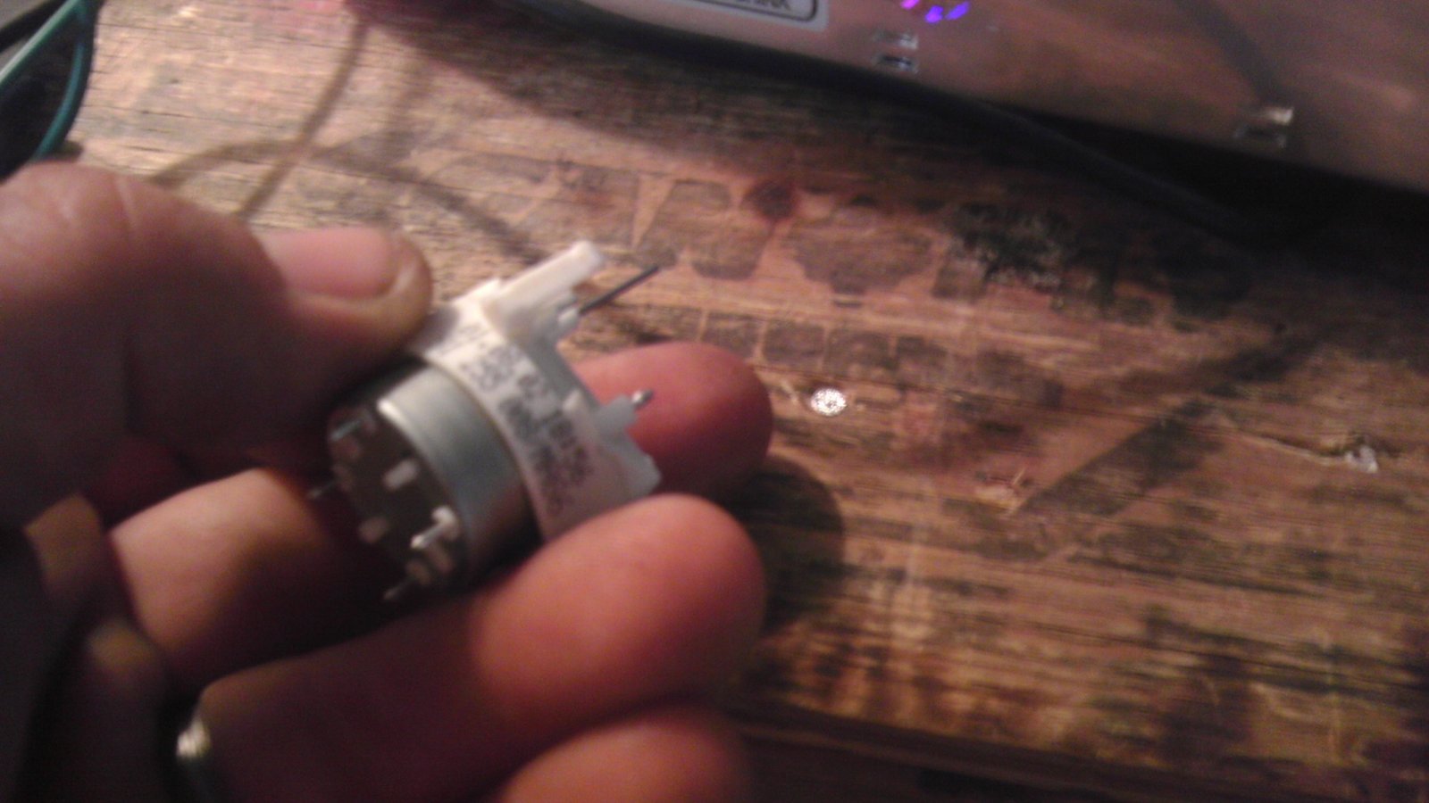

    Ok those gauges look like air-cores , quiet hard to drive. Have you carefully opened one up, take care not to break the internals, if they contain two separate coils inside them then we can drive the standard motors with a stepper driver.
    If not and the simplest method is to replace them with a stepper motor - bipolar are the best to drive, only require a direction and step pin so that's 2 pins for each gauge, unipolar use 4 pins and driving commands cause blocking in the code no good when trying to run multiply steppers in one command and each stepper waits till the other has finished moving.

    I work with these MK4 VW clusters on a regular basis. If you need any wiring diagrams or pin outs for them let me know.
    What's also cool is that the other side of the cluster (the green connector) also can control things like a trip computer and obviously the wipers if you really wanted to make it uber realistic for some games which could handle that.

    @eaorobbie I think the motors are 4 pin. If you look closely at the cluster circuit board you can see at the top 2 small brown squares. Under the left one you can see the 4 heat marks caused from unsoildering the motor. I am guessing from your response earlier that these are no good for a ard. control. What motors would you suggest and if you could help walk me through it please do.
    @Barry I wish I had your input earlier. It would have saved me about 3 hours of wire testing. Which only by fluke I figured out that I needed to connect 2 power wires at the same time. I only want to have the lights and clock to keep track of the time played.

    Ok So I have taken apart the servo I removed from the dashboard and here is a video of what I found IMAG1073.jpg
    I am not sure if this answers your question @eaorobbie on 2 or 4 pin.
    Mabey @Barry can help explain whats happening to this to me.
  16. eaorobbie
    20,503Coins
    +1,687 / 23 / -2
    @Barry they look like aircore drives but debating in my head I could possibly drive them with a stepper driver, not 100% sure , leaning more towards an air core.
    What I have replaced them with in the past couple of builds,
    - http://www.pololu.com/product/1207
    At about 12 bucks and only have a foot print of 35mm square, so 4 easily fit back into a dash without changing clock locations etc.
    They deliver 200 steps per rev on 1 step scale but with the right driver can be micro stepped down to 16x which gives us plenty of resolution to use as a gauge.
    The driver I use
    - http://www.pololu.com/product/1182
    this only requires us to use 2 pins from the Ard meaning we can drive up to 6 analogue gauges leaving plenty of pins to drive lights, specially if we use a 595
    - https://www.sparkfun.com/products/10680
    - in the wiring giving use 8 led pins from 3 Ard pin, need more pins, daisy chain another 595 and we get another 8 and so on, plus a 7 seg display can also run off one of them too.
    • Informative Informative x 3
