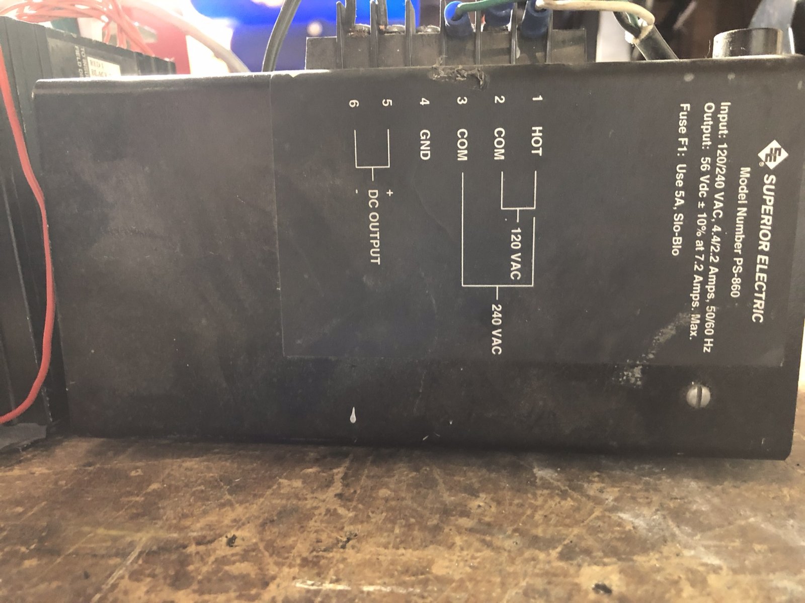

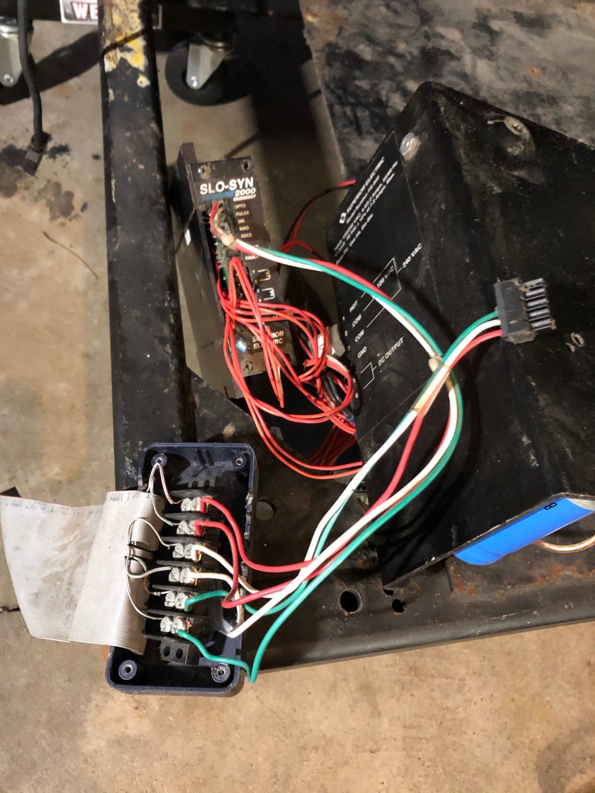

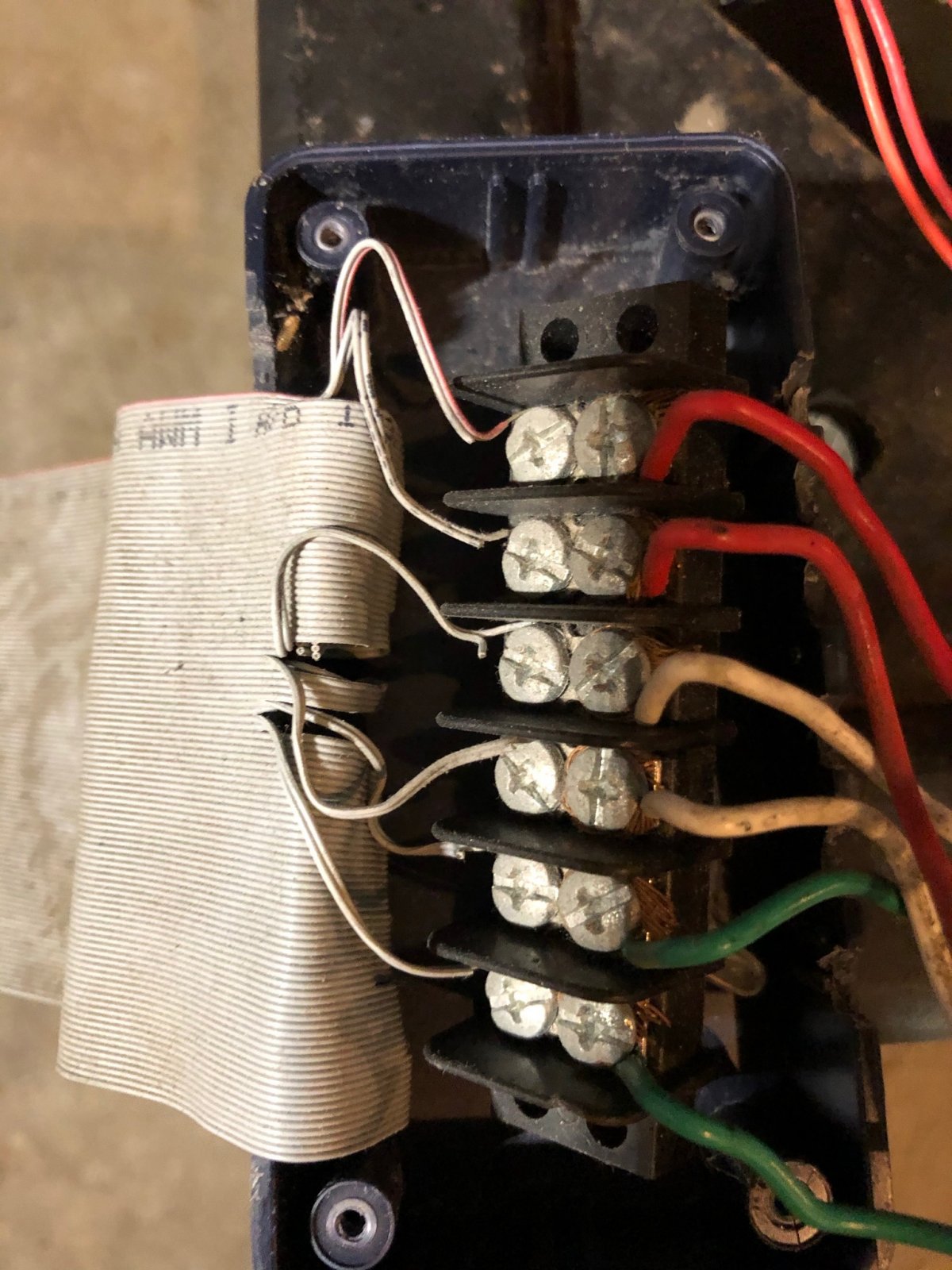

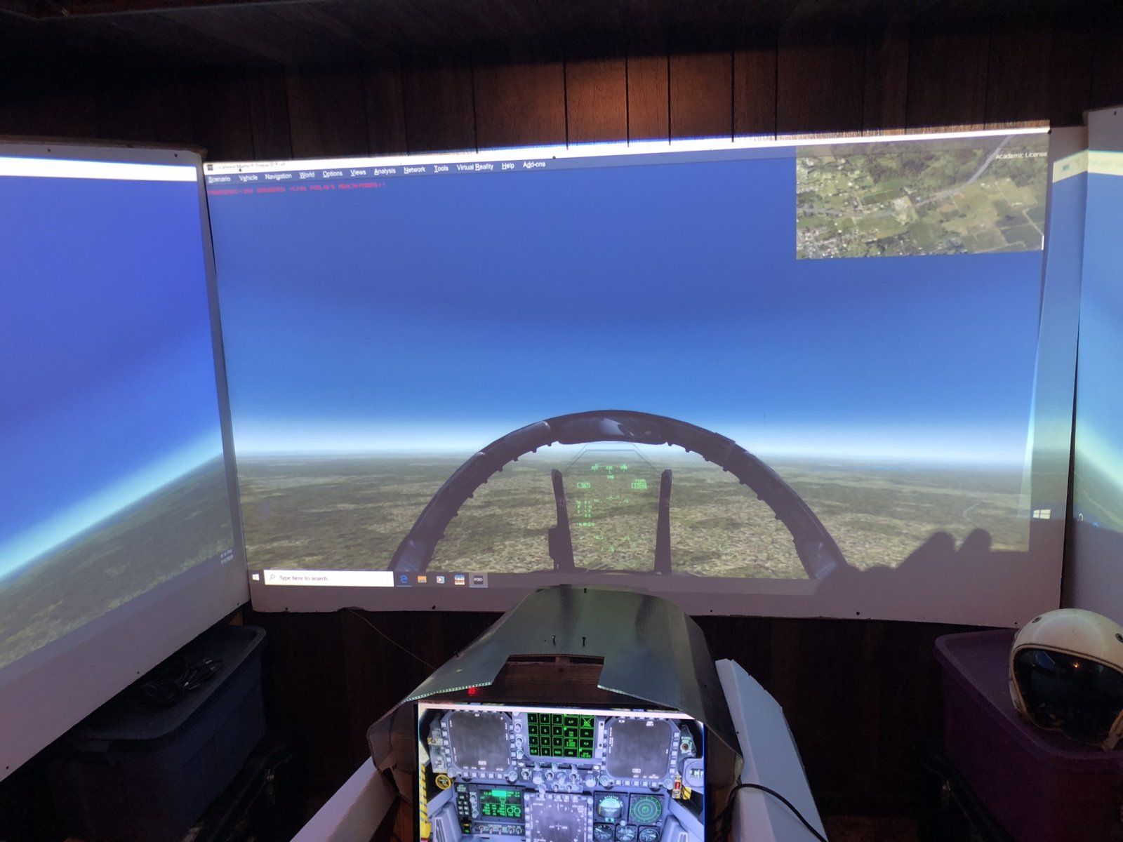

    The photos show how the motors were previously control through a ribbon cable that has been cut. I have no idea what software used to run the system but clearly this was the interface between the Motor controllers, the motors, and the computer. Presumably software sent signals to the motor controllers. For now I just want to get this thing hooked back up. I need to figure out how to reconnect the simulator to the computer interface and that is why I tested the Arduino. The test worked so I was going to initially set it up as a car with live for speed because there is already available set-ups and plug-ins for this configuration and from there Once I learn, I can migrate it to flight simulation software. A car will just need a usb wheel and pedal set-up without all of the instrumentation the aircraft need. I eventually may mount my full cockpit on top of the platform

    It looks to me that you have 2 controller boxes and they have 3 wires each
    My guess is
    +v
    -v
    Signal voltage
    See if you can find the make and model and if there is a manual.
    Right now I would try and apply a variable voltage and see if you can get them to move
    But you need to find out what pins does what and how many volts it is rated at !

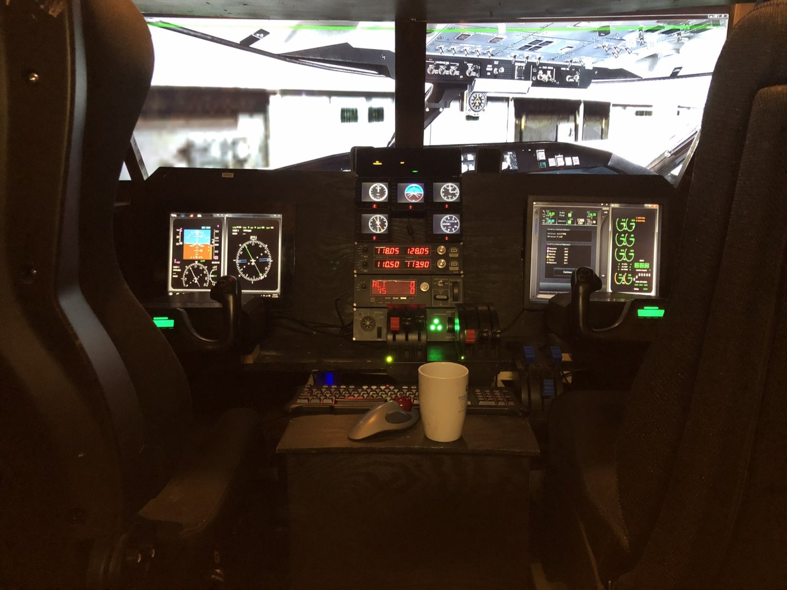

    Any system I finally end up with I want to keep the fuselage because of the accurate dimensions that can use to make all of the switches operation in the correct positions. 3058C367-11CA-46B4-AB24-448F22398A20.jpeg

    It appears to be scratchbuilt, do you mean like a simple circuit with a potentiometer?

    The wires may be pwm and direction
    Is this is the case you maybe able to use an arduino and the smc3 code

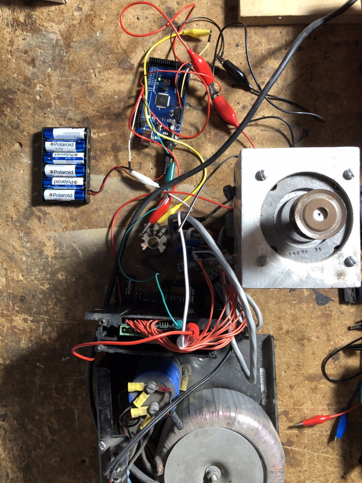

    325A109F-A583-47D5-A417-C39031983204.jpeg D97FAF62-C4A0-4116-B90E-95B42368460C.jpeg I am learning the Arduino and have run a test with a potentiometer. I can vary the speed of the stepper motor through the potentiometer connected to the Arduino. Now I know the Arduino will accept input and convert it to output and the power supply, motor drivers, and stepper motors all operate correctly in response to the input. Logically this seems like progress! Simultaneously I am building a small model and circuit with small stepper motors so I can connect my model to simtools can learn how the software and the arduino work together to create output the Arduino can send to the motors. It seems like the motor has a lot of torque with the stock set-up. It appears to e a matched set all by the same manufacturer, but it has not been tested under any load. I am just happy that I seem to be closing in the last few steps link the software to the arduino.
