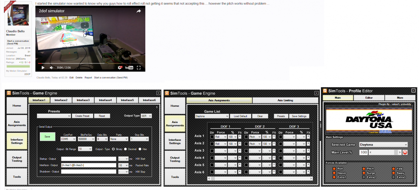

    I started the simulator now wanted to know why you guys how to roll effect roll not getting it seems that not accepting this ... however the pitch works without problem ...
    22,150
    154,526Coins
    +11,185 / 57 / -2
    You need to post pictures your Axis Assignment interface settings.
    As an aside that pot does not appear to be securely mounted.

    on the pot it was just to test my cnfiguraçoes ....

    You should have one DIR box checked orange for roll, as the DIR boxes determine which way an axis moves, and movement should follow this proforma: https://www.xsimulator.net/community/faq/which-way-to-set-simtool-axis-movements.230/
    In SimTools 1.3 you should aim to keep the total of all axis allocations at around 100%: https://www.xsimulator.net/community/faq/axis-assignment-percentage-totals.120/
    Once you get the basic configured properly it still takes some time to develop and refine motion profiles for each game: https://www.xsimulator.net/community/faq/steps-to-create-a-motion-profile.228/

    Good night ... Someone could help me ... My simulator when I connect 2 motors is giving a few strides, when I turn off 1 normal operation will be that it can be arduino programming, I am using linear potentiometer of 10k a source of 24v 500w the motors consume Each 46w 24v

    I am not sure what you mean by this, can you explain a bit more what the issue is?

    When I am using the two motors they are ocilando ... when I turn off 1 motor it works norm without ocilar

    I'm reading here in the forum about a pid command what's this?

    I have to configure the engines in this program Windows SMC3 Setup

    A proportional–integral–derivative controller (PID controller) is a control loop feedback mechanism (controller): https://en.wikipedia.org/wiki/PID_controller
    Here is an analogous explanation of PID: http://www.xsimulator.net/community/threads/a-laymans-analogy-guide-to-pids.7649/
    And yes you use the SMC3 app to configure your settings.
