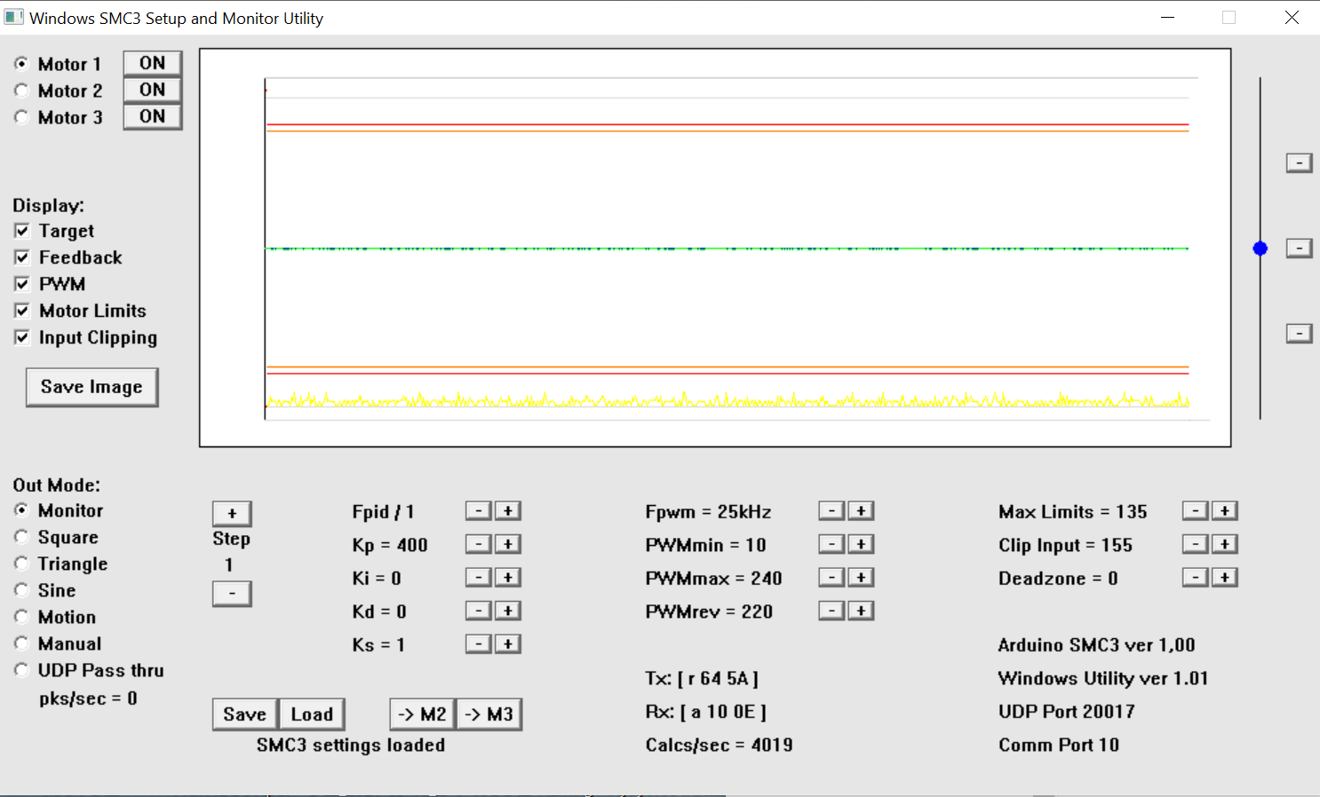

    If you manually turn the hall sensor one way then the motor will only spin one way, turning the sensor the other way will change the direction of the motor.
    Generally mount everything together, run SMC3Utils click Sine and see what happens.

    That's my point, with the hall sensor connected it will only turn one way, nothing happens the other way, also it should gradually speed up as the hall sensor applies more voltage, it does not, it just goes at one speed

    The question is does the green line look like the attached picture ? prawidłowe wykresy w smc3utils styczen 2024.png

    The line moves as the hall sensor is turned so that's functioning, the motor is not behaving as it should as previously mentioned

    The sensor seems to run 0-100% over about 45degree turn, after that no change in speed, when its turned 180% it immediately switches direction.
    I'm assuming Mode1 is correct

    Mode 1 is correct.
    I use the P3022-V1-CW360 Rotary Hall Angle Sensor 0-360 seems to be the same as yours.
    Correct they are sensitive , but this does not affect the operation of the whole.
    If you can, measure the voltage that comes out of the sensor when it is in the zero position ( the green line in the middle of the SMC3Utils screen) it should be around 2.5V at my place it is 2.3V
    You must have SMC3Utils running and you measure the voltage between the OUT and GND pins
    With the setting as shown in the screen above, I have 2.3V with the supply voltage from the arduino at 4.7V or half which means that the sensor is set perfectly in the middle of the measurement range.

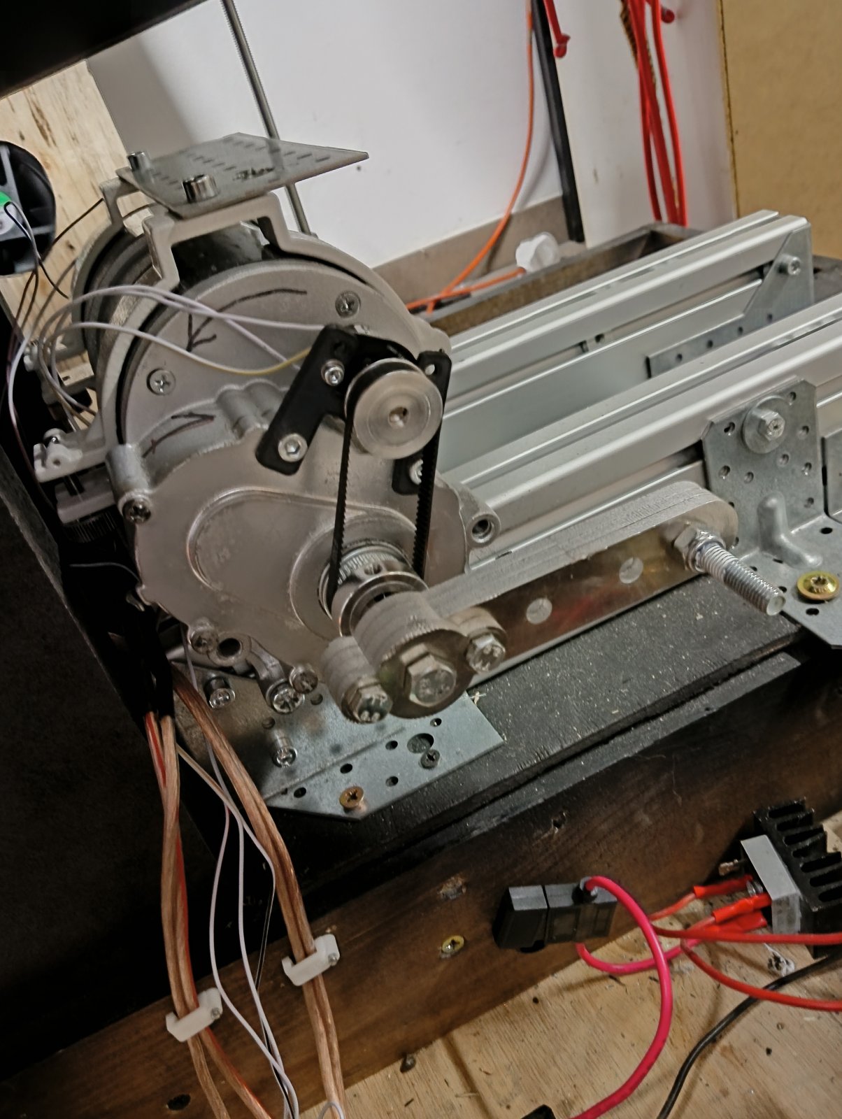

    Hi, thanks for your support with this, what is your gear ratio from the motor to the hall sensor, is it 1:1?

    Yes 1:1

    Hi, was going to mention that..... However my previous setup has a 4:1 ratio using the IBT-2, so can only assume the bridge has some sort of control over that. I have just setup a 1:1 ratio using the the new 100Amp bridge and swapped round the motor input wires and it is working like a dream, just configuring Motor2, hopefully I'll be up and running soon....I'll let you know
