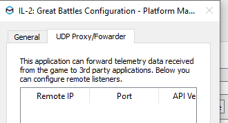

    Hi all,
    Got a similar query to others here and haven't found an answer. I have 3DOF PT Actuator rig (QTY 3 actuators) which has a NLR V3 seat mover on it. Ideally I'd like to use V3 for roll, nad #DOF rig for pitch, using forward and aft actuators. Problem is IL-2 outputs to port 4321, which V3 picks up, thus knocking Simtools offline. If I'm flying and turn off NLR V3 software, Simtools immediately picks up and comes on line.
    It appears that the NLR V3 software can flickpass readings onto Simtools, but I need to know which port # and API # to use (if this is even possible). I'm totally open to ideas. I'm using Thanos AMC as interface, would I use a second interface within Simtools to pick up signals?
    Thanks, John
  9. Michael Jeffries
    Michael Jeffries Member Gold Contributor
    Jul 22, 2019
    105
    485Coins
    +17 / 0 / -0
    Motion platform, 4DOF
    Thats a similar issue I had. SRS and SimTools can't work at the same time because IL-2 uses UDP Telemetry, which means only 1 application can get the telemetry from it.
    Unless SimTools or NLR has port forwarding built in their software, it won't work. I know SimTools doesnt have an option to port forward, nor does SRS (sim racing studio software)
    Not Sure about NLR software though.
    SimHub has this option as well.
  10. Zippo246
    Zippo246 Member
    Nov 12, 2017
    38
    Sydney, Australia
    158Coins
    +21 / 0 / -0
    3DOF, Motion platform
    Hi Michael,
    I think NLR does have port forwarding (as per third pic in my post, unless I've misinterpreted what I see, really new to this), just need to know which port to forward to so Simtools can pick up, and do I need to change a setting in Simtools to pick up what is being forwarded. Thanks for your answer, was recently reading all your EMC discussions on Thanos discord - small world...

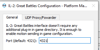

    Hi Guys. Iam also a bit late to the party. We finished our DIY rig und now we try to get it moving with IL2 BoS. The rig itself works. We use value1´s plugin for simtools, which i prefer over x-sim which seems outdated. The rig itself reacts on testing signals by simtools as well as by x-sim, so no problem here.
    Simtools connects from manager to engine on the same gaming rig as well as over the lan, so thats ok as well. BUT IL2 seem not to send data (netstat doesnt show port 4321, changed it to 6666 in startup.cfg for testing, not shown in netstat as well), so simtools doesnt receive any signals. Using latest IL2 on steam, no firewall, no antivir, latest win10-64 and drivers, no probs.
    Does have someone a clue? Next thing i will test is some older racing sim, but IL2 is the thing we want to do.
    Thanks for any support!
