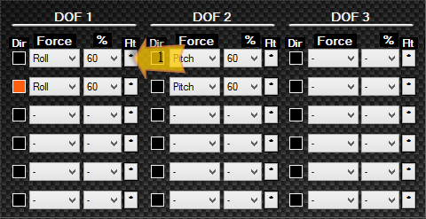

  16. eaorobbie
    20,506Coins
    +1,687 / 23 / -2
    Each force can now have its own filter attached per axis.

    20,506Coins
    +1,687 / 23 / -2
    Smoothing – Will smooth the value, if a value seems jerky or not flowing this can be increased to add a smoothing effect by creating a mean value of the values coming in.
    Washout – Is handy when we require a value to wash back to 0. Ie like for a yaw axis that doesn’t actually turn a full 360 degrees. So to give the feeling to the rider that he/she is still actually turning.
    Deadzone – Is for setting a deadzone in the middle of the movements ie around 0, so if our Min Max in the tuning centre is set to Max 10 Min 10 and we don’t want to feel 3-0-3 we can set a percent to represent this and take these values away from the equation, resulting in a deadzone.
    Boundary – Is used to clip the Max and Min , sometime on a separate axis setup we want a different Min Max but if we change this in the Tuning centre it will affect all axis, so in turn we can set a Boundary (Max Min Limits) to lessen the Min Max for that particular DOF.
