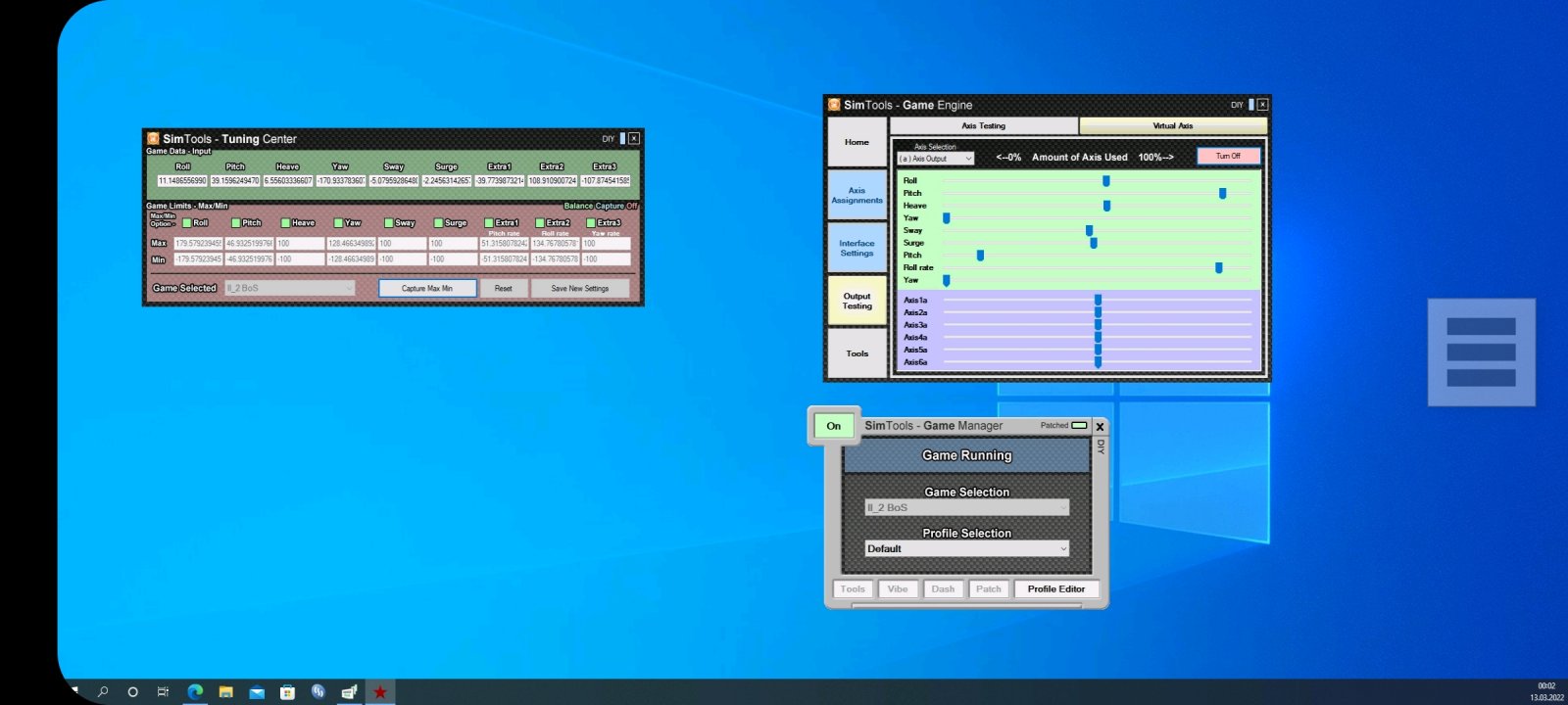

    @yobuddy Unfortunately it didn't work even with the antivirus turned off
    I soon don't know what else I can do
    and why does it work with LFS what does the test program have that the others don't have.
  2. yobuddy
    51,651Coins
    +5,204 / 19 / -0
    LFS is a udp output plugin and this seems to be a memory mapped plugin.
    Next I would try a different plugin and see what happens.
    22,121
    154,352Coins
    +11,179 / 57 / -2
    Did you un-patch, uninstall the plugin then re-install, re-patch with the antivirus turned off, to ensure AV had not messed with the plugin files?

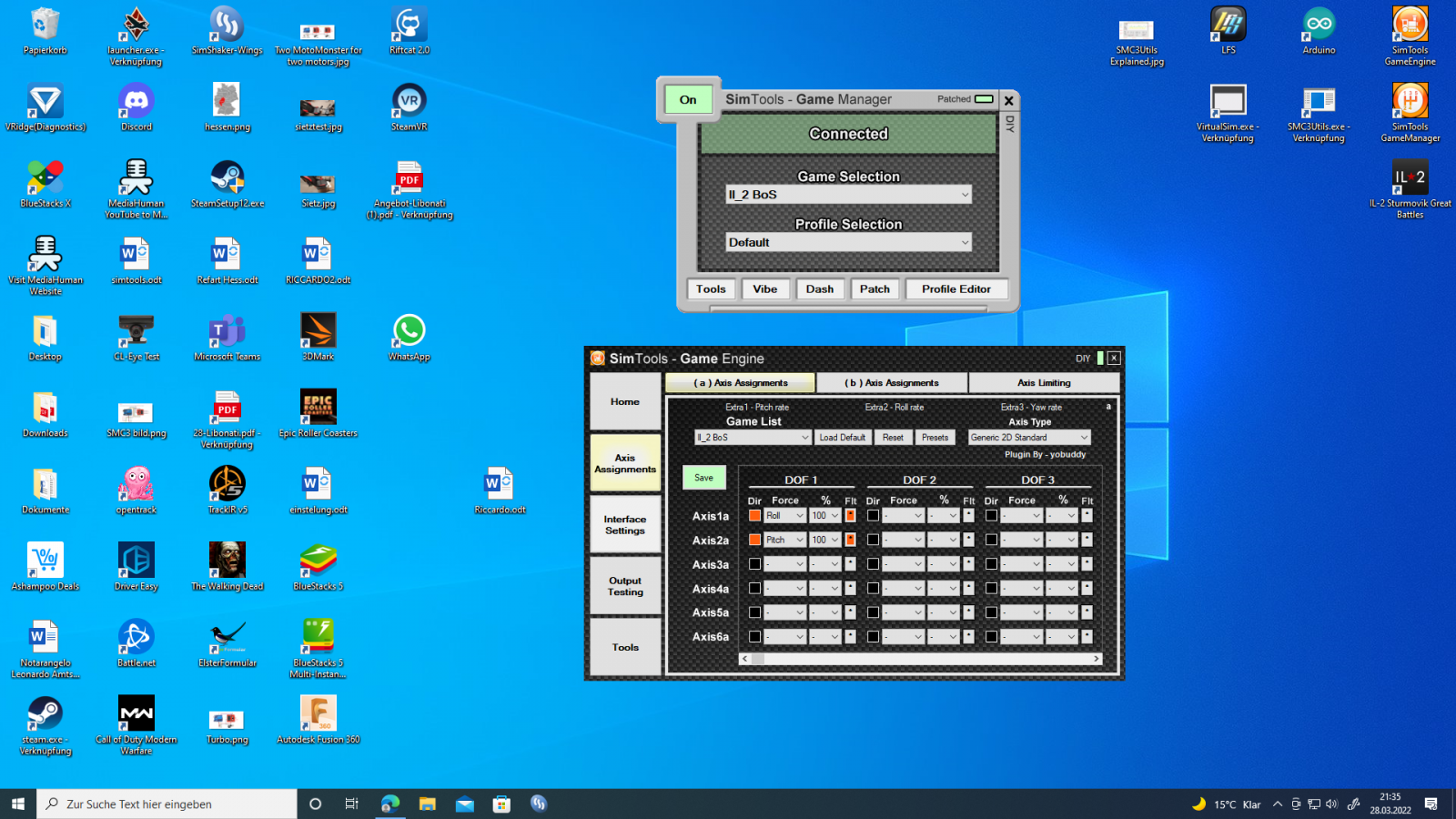

    hollo
    have now signals after i have deleted game and simtoos and reinstalled my chair moves but very slow why

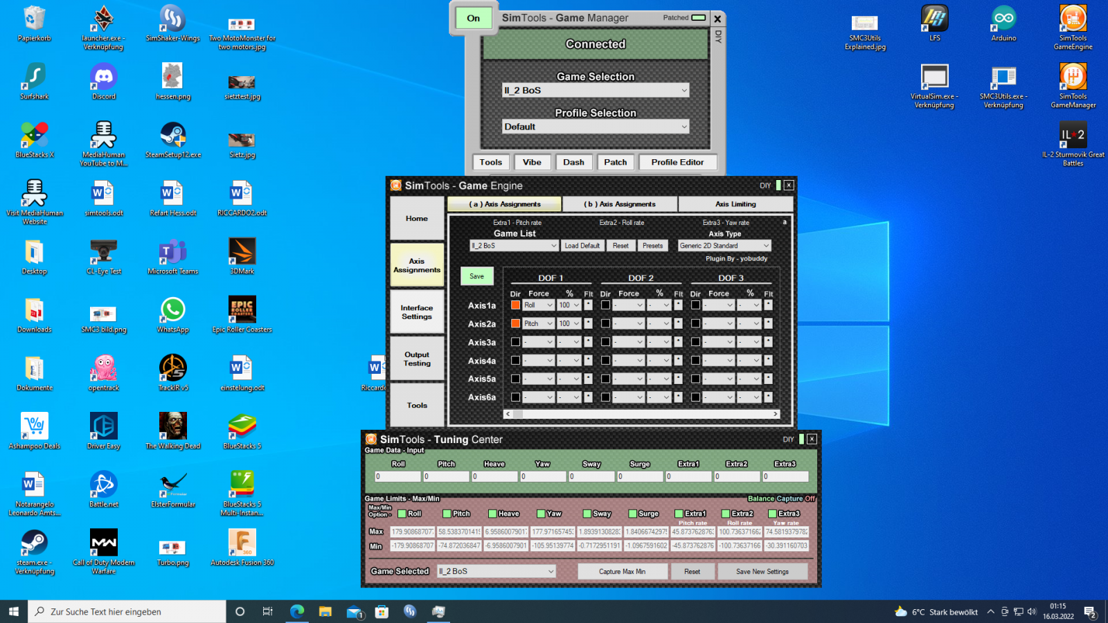

    these are the setting

    But when I test the exits of my chair, the movements are so strong that I have to hold on tightly.
    22,121
    154,352Coins
    +11,179 / 57 / -2
    First grab a copy of the SimTools manual and keep it handy for reference: https://www.xsimulator.net/community/faq/rtfm-start-with-the-official-simtools-documentation.117/
    Then check out the motion tuning tips in the FAQs: https://www.xsimulator.net/community/faq/steps-to-create-a-motion-profile.228/
    In particular you likely need to capture the Max/Min values in the Tuning Center, then manually tweak them from there, the larger the value the more gentle the motion, over a longer axis range, which suits flight sims, the smaller the value the more violent the motion, over a shorter axis range, which suits race sims: https://www.xsimulator.net/community/faq/steps-to-create-a-motion-profile.228/

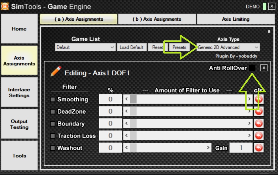

    For 2DOF you need to have DOF1 and DOF2 configured in Axis Assignments.
    Please see my previous comments and links for configuration tips: https://www.xsimulator.net/community/threads/il2-sim-on-2-dof.16710/page-7#post-226572
    In particular:
    Total axis allocation for general aviation flight profiles can be closer to 80-90% of both the available roll and pitch axis, as it is unlikely both will be at their extreme range at the same time. But be a bit more conservative in axis allocation for acrobatic and combat profiles that do use extreme maneuvers.
    For flight profiles start with roll and pitch, or where supported by the plugin you can use Extra 1 and 2 in place of pitch and roll, as the later invert from one axis extreme to the other at 180 degree in-game inversion. You will also likely need to use the washout, gain and return filters for best flight effect.
    If you do use Pitch and Roll in Axis Assignments make sure Axis Type is Advanced and in the FLT box of Roll and Pitch use the Anti-Rollover checkbox. Anti RollOver is designed to eliminate the 180 degree in-game inversion in rolls and loops. This setting returns the output value to zero when the input is at its max or min setting. For Instance, if we had a Max and a Min of 180°/-180° for an input and this setting was on, any values after 90° start counting back to zero. Making an input of 100° = 80°, 120° = 60°, and 180° = 0°. The same thing happens for the negative values also meaning that a -180° = 0°. (Note: This setting is only intended for the Roll and Pitch inputs from a game.): https://www.xsimulator.net/community/threads/simtools-v2-3-is-out.12483/#post-163409

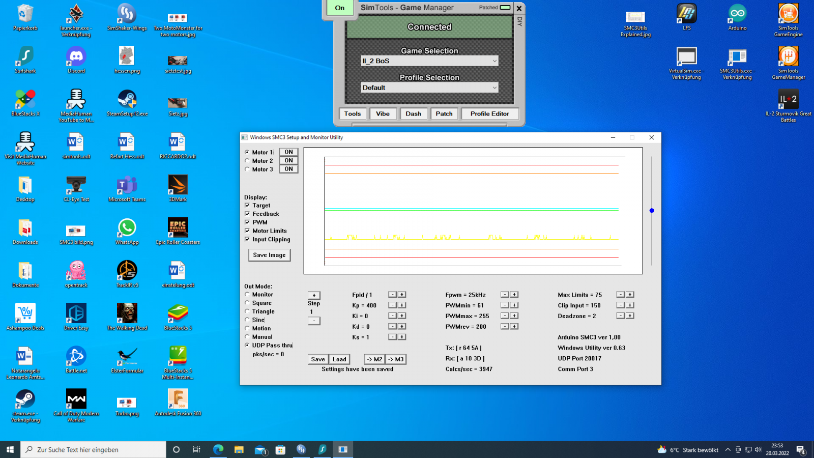

    hi i have disturbing noise in my engines could it be my podi not going exactly to zero
    22,121
    154,352Coins
    +11,179 / 57 / -2
    Hard to guess what the noise may be, but the pot should be centered when the rig is in its level position.
    Normally you would likely feel small adjustments with a pot slightly off, rather than hear a noise.
    Does the noise sound electrical or mechanical?

    Thanks to the new settings, the engines have become quieter,
    I still have to fine-tune the movements as they are still too abrubt.
