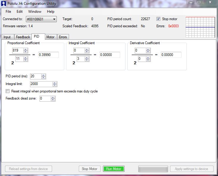

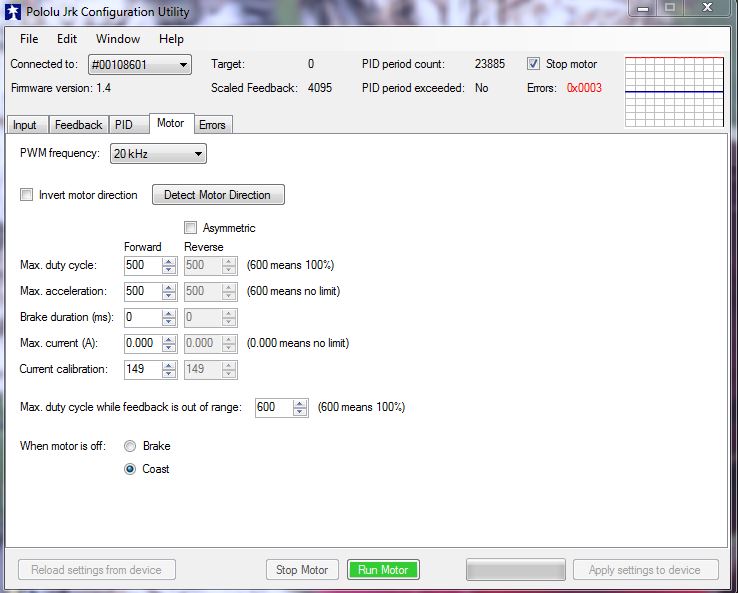

    Thanks @noorbeast I have the max duty at 500. The PID settings I have set to 0 each, but had P on .1, then 2. I got the fault on both. PID period at 20, integral limit at 2000
    Cheers

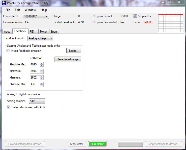

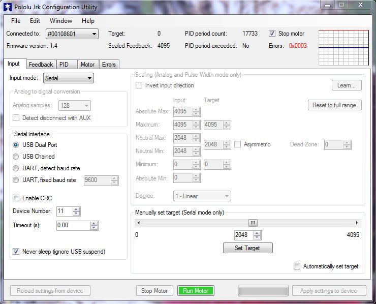

    Best post a picture of your JRK settings for each tab.
    @noorbeast These are my settings thus far.
    Thanks as always
      File size:
      59.7 KB
      Views:
      667

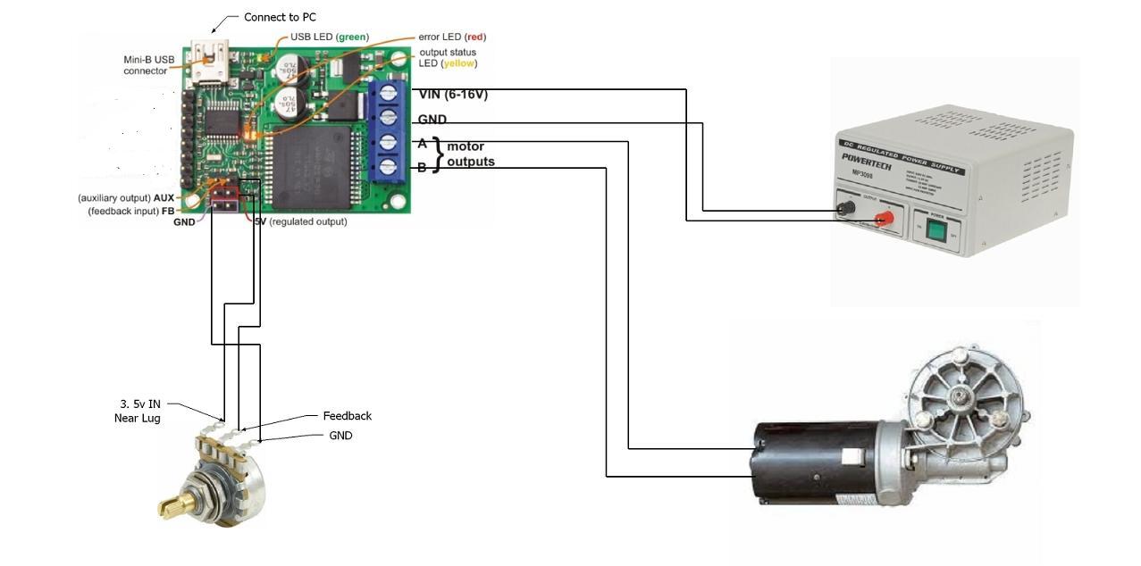

  4. bsft
    Are they wired up like this?
    You may need to invert motor direction and or feedback direction to get them moving right.

  6. bsft
    Drop current calibration down to 130.
    raise intergral limit from 2000 to 10000
  7. bsft
    oh yes, no D number, try what @noorbeast suggests
  8. Nicko321
    Nicko321 Member
    May 11, 2014
    34
    salisbury South Australia
    288Coins
    +7 / 0 / -0
    Thanks @noorbeast & @bsft . I will try what you have suggested.
    @bsft, that is exactly as they are wired up.
    Just to explain the D, I was working through what @bsft had suggected an the first page here and hadn't got to D yet.
    I will go try now.
