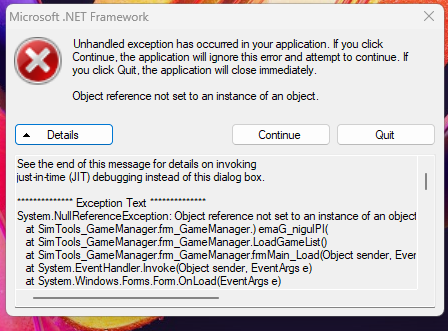

    Can you please use the Details button on the error message to expose the full error message, then copy and past it here so @yobuddy can take a look.

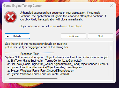

    This is when I open the game engine:
    This is when I open the game manager:

    Please copy and paste the full error message.

    System.NullReferenceException: Object reference not set to an instance of an object.
    at SimTools_GameEngine.frm_TuningCenter.LoadGameList()
    at SimTools_GameEngine.frm_GameEngine.frmMain_Load(Object sender, EventArgs e)
    at System.EventHandler.Invoke(Object sender, EventArgs e)
    at System.Windows.Forms.Form.OnLoad(EventArgs e)
    at System.Windows.Forms.Form.OnCreateControl()
    at System.Windows.Forms.Control.CreateControl(Boolean fIgnoreVisible)
    at System.Windows.Forms.Control.CreateControl()
    at System.Windows.Forms.Control.WmShowWindow(Message& m)
    at System.Windows.Forms.Control.WndProc(Message& m)
    at System.Windows.Forms.ScrollableControl.WndProc(Message& m)
    at System.Windows.Forms.Form.WmShowWindow(Message& m)
    at System.Windows.Forms.Form.WndProc(Message& m)
    at System.Windows.Forms.Control.ControlNativeWindow.OnMessage(Message& m)
    at System.Windows.Forms.Control.ControlNativeWindow.WndProc(Message& m)

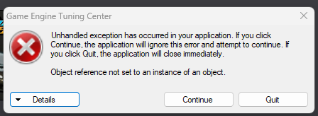

    I think there is a v3 plugin installed in v2, I believe that is what is going on here.
    Please open "C:/Users/r4c/AppData/Local/SimTools/GamePlugins/" and delete '24_GamePlugin.dll'.
    Then try to re-launch and see how it goes.
    (For SimTools v2, the plugins need to come from this website, and with SimTools v3, they need to come from simtools.us)

    Hi yobuddy! It works after I've deleted the '24_GamePlugin.dll' ! Thank you so much! Sorry for taking so long to reply on this topic. I assumed I need to do this if I want to switch back and fort from V3 to V2, right?...

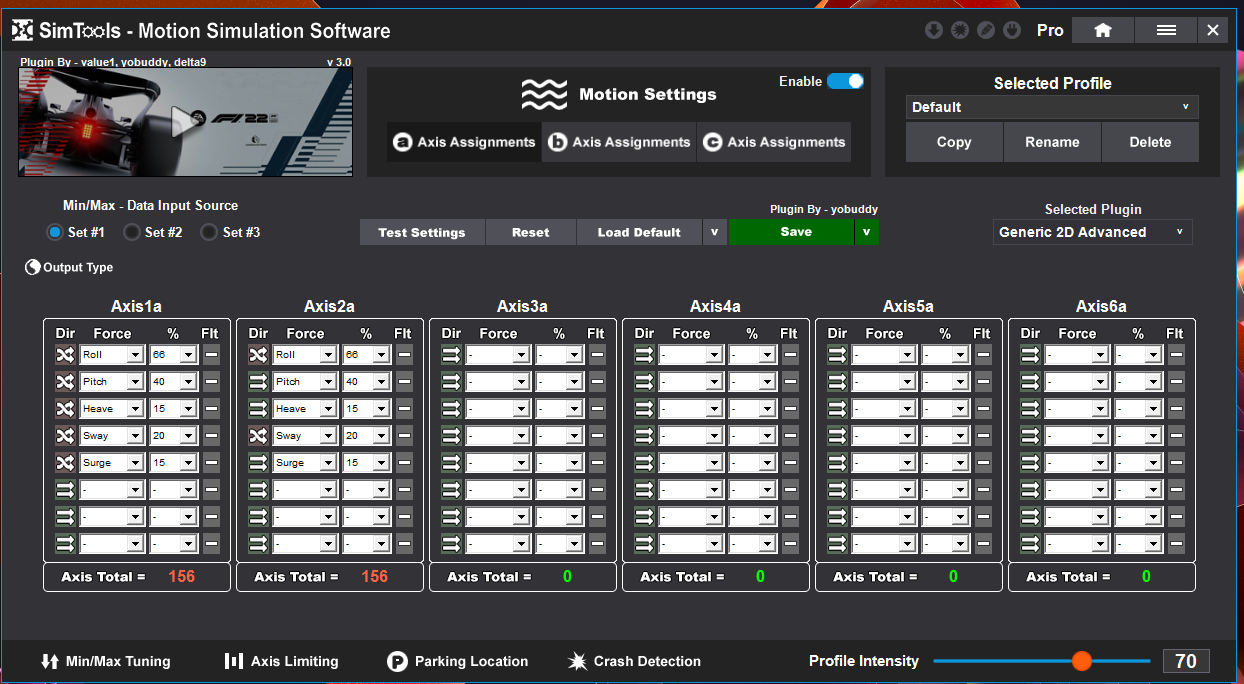

    I suggest configuring one DOF at a time, make sure the DOF is right, then turn all the DOF's back on.
    Got a pic of your axis assignments?

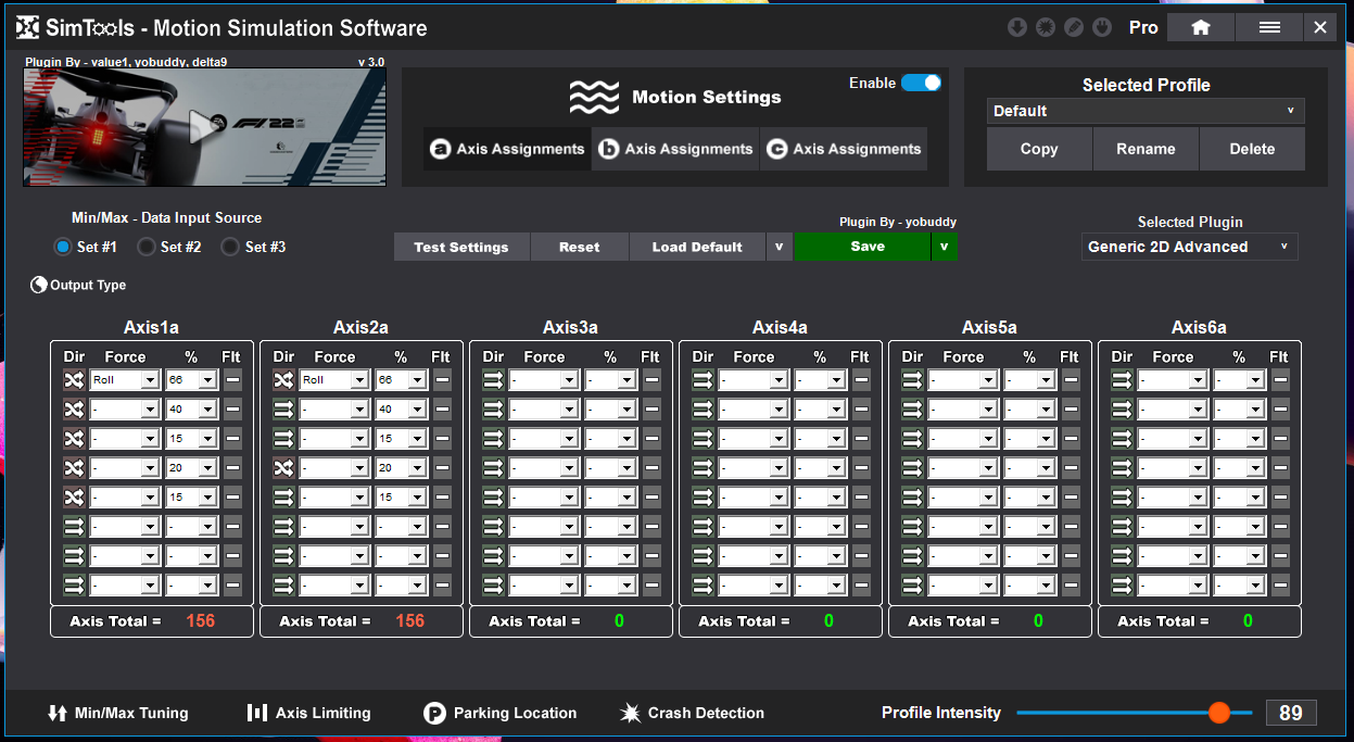

    I set the DOF one force at a time. I have correct the motor direction too. All the directions are correct, including the Roll for turning is correct, except when the car is sitting on the side hills.
    This the setting on just the Roll:
    I will post the You Tube video tomorrow. It's about the action of my rig during turning on the curves. Also, the position of my rig while the car in the game is sitting on the side of the hills.

    Hi ChuckyP, This is the rest of the setting when I play the F122:
    I set the heave only and it was only going up and down. Hmmm, Wait... I think you're right. Maybe it's backward... I guest I have not try the other direction. I'll try it again tomorrow. It's getting late now.

    If pitch is set up correctly the settings should be the opposite for heave. So according to the photo of your settings I would change to the following.
    If roll is correct I would set Sway to the opposite as you have now. So click 1a and 2a back to normal
    If Pitch is correct I would change Heave so both 1a and 2a are the opposite of pitch.
