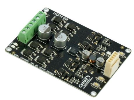

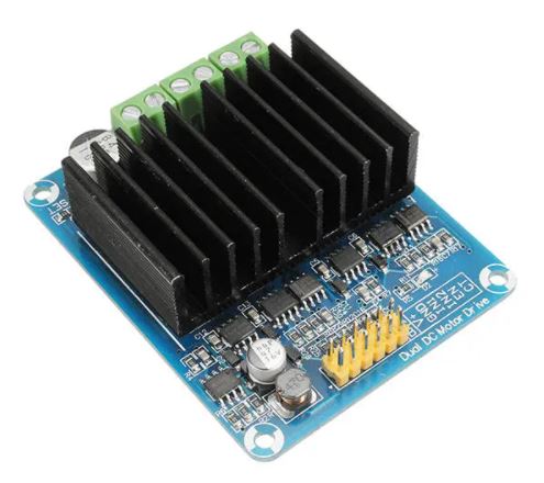

    The motor drivers I am considering are:
    1) Cytron 10A 5-30 V Dual Channel DC Motor Driver - https://www.robotshop.com/nl/nl/cytron-10a-5-30-v-dual-channel-dc-motor-driver.html
    30A peak (10 sec)
    2) 50A Dual-Channel H Bridge Motor Driver Module Robot Chassis Servo Geekcreit - https://banggood.app.link/2qVY6NLoC9
    I am leaning towards the Cytron, because of the many good reviews on it. However I will probably need to attach an heatsink on top of it no? If so, how do I go about this, do you use special glue (thermal paste) and just glue it on top?
    EDIT: To answer my own question, I read this from the Cytron manual: "Fully NMOS H-Bridge for better efficiency and no heat sink is required." so that's great :)

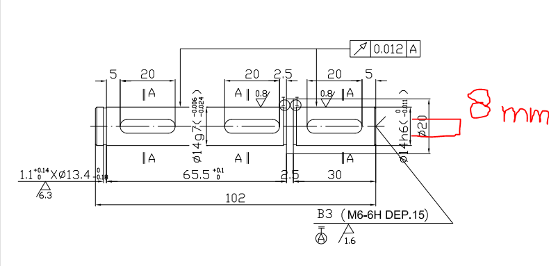

    Regarding the connection of the sensor, I wanted to mount it on the back side of the shaft. So I requested if it's possible for them to add a 8mm diameter and 20mm length extension to the shaft, so it's easy to connect it with the use of a 6.35mm and 8mm coupler. :thumbs

    Did you request that shaft change?
    I didn't request anything...but probably should have :p
    Yes I did ask them for that change, I thought it would be easier to connect the sensor through a coupler that way :)
    The avatar is indeed from a Transtecno motor, and I did look it up but couldn't really find much. That picture is from a YouTube video from someone that either had a H3 or H6 from DOFReality. I think those are the motors they used in the early days? (I don't know).

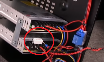

    connected to a mushroom-type button as an emergency stop button if things begin to shake out of control :)

    Where do you put that relay in your circuit? Is 10A relay enough? I am not an expert in electricity really...
    I thought I needed 6 relays, each for 1 motor so I can cut the power to the motor driver.
    I also want to use a single PSU for 6 motors, to keep things compact/clean. (not sure if this is possible either).

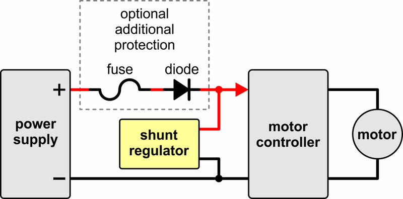

    I did not know of that shunt regulator. Will I need only just one or one for each motor?
    Yes I believe so, I ordered 6, 1 for each motor. You can see circuit below. The "Optional additional protection" (fuse/diode) is not required btw.

    I really don't know if 10A is enough. I again copied the function of the DOF Reality systems:
    (minute 13:45)
