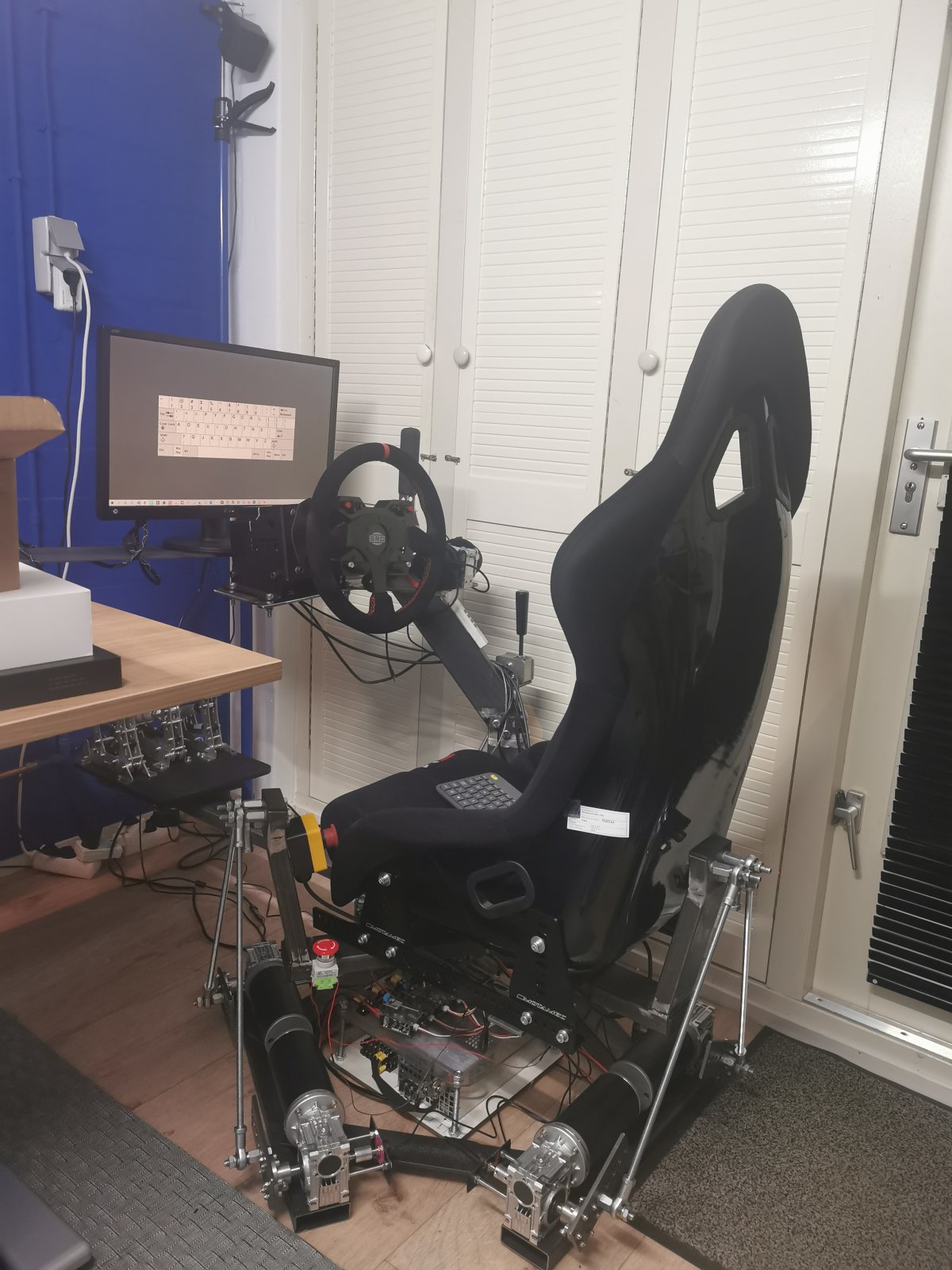

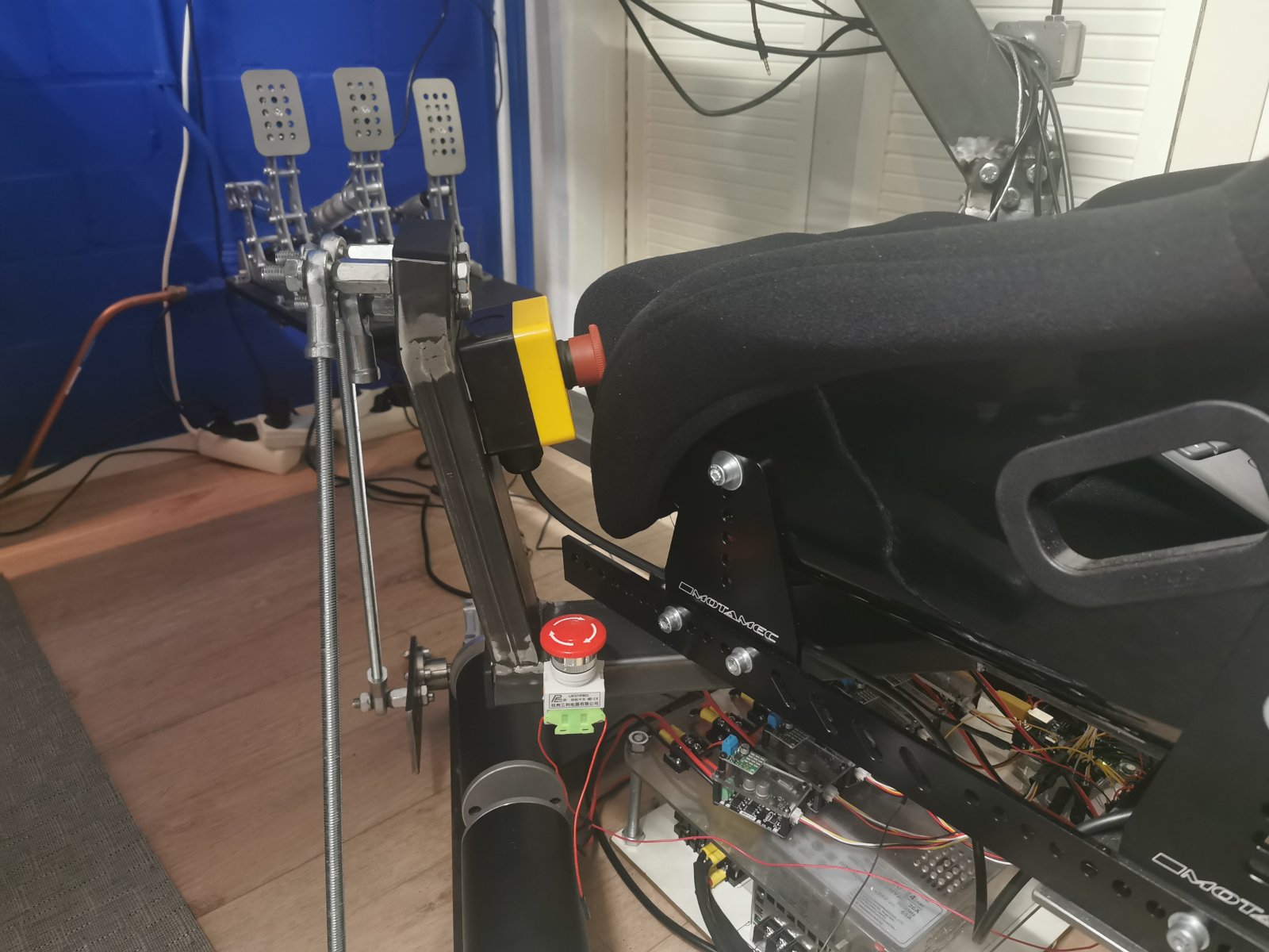

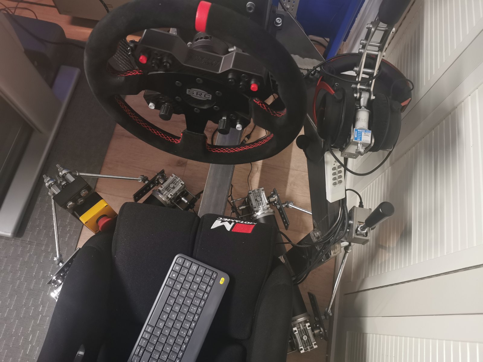

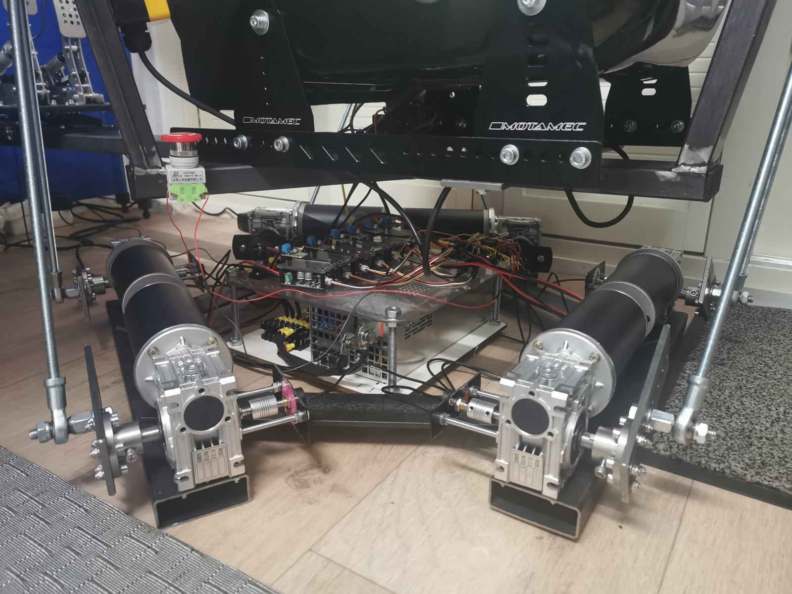

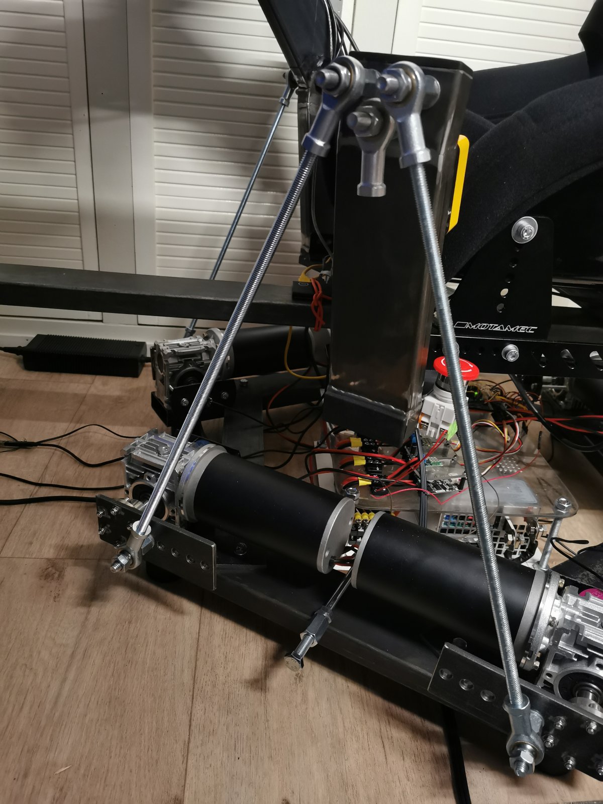

    Below you can find a couple of photos of how the rig looks with motors attached :grin
    Below some information on what problems I encountered:
    Last weekend I put the top frame on the lower frame (motors).
    I did some tests and I noticed a couple of things.
    I had these dampers/rubbery feet. And they were totally not a good idea.
    The reason being that on movements it would kind of move the whole motors. It would roll the metal plate with the motors on top left/right (just a little bit, but it translate to quite some movement on the rig itself). Especially on down movements it would be quite Jerky. :p
    There are a couple of things I can do to improve the lower part to make it more stable.
    Which is first of all remove those rubbery feet, which I did already and it improved quite a lot.
    However there is still some jerkiness with down movements, and it's not acceptable.
    The other thing to do is add gas springs to help with smoothing things out.
    I already was in contact with gas spring company and I should receive a quote for 3x 500N gas springs, which have a vent to make the pressure less if needed. But I think ~50kg times 3 (150kg) force would be perfect starting point. Will see how this helps with the jerkiness.
    The gas springs will probably solve another problem that I am having right now, which is motor noise.
    I added some code which stops providing any power to the motor (individually per motor) when the Setpoint didn't change over a given period of time. However this code doesn't seem to work when being in game. The reason being is that the game feedback simply always changes. I could maybe improve this code to do a check over a period of time and see if the Setpoint of the motor changed significantly during this period, and if not then simply do not provide power, but this is quite a tricky thing I guess. And probably also highly depends on the game. I am not sure if the Simtools game manager > Record max/min values would also help with this type of issue. Haven't tried this yet.
    That the game gives feedback that is different each time isn't such a big problem, because if the values differ just slightly it wouldn't give to much power to the motor so you shouldn't hear anything. But as of now (without gas springs) the load is just to much, so I have to ramp up the Kp value to get some movement. This results in the motors becoming a little noisy. Even while you are driving on the straight so to speak.
    The motors can handle the load fine, and the current isn't that high either, the motor drivers aren't becoming hot at all, they are just slightly warm to the touch, so I am quite happy with the motors so far. I am not doing any more testing because I don't want to stress the gearbox to much with the jerky down movements. I am afraid to make the backlash worse (I might have increased it a little bit already, not sure because I didn't really test how much there was on all motors when I received them).
    Regarding the code, I solved a couple of other mistakes that I made, which was that at first I was just reading out the feedback from the game as provided, and constrained the "Setpoints" to the min/max values for my sensors. This would mean that when the min/max was reached any feedback outside this range wouldn't do anything (obviously). So for instance if Simtools provides me A1000 as feedback, then my Setpoint would be changed to 612 (this was my max for motor A for instance). So a quite stupid mistake, but didn't notice this until I was actually driving in LFS. At first I thought I configured something wrong in Simtools, or loaded some old profile or something... lol. Anyway, that thing is fixed now :D
    During analyzing the motion of the platform with my own eyes/visually I could see clearly how much jerkiness there is in the platform just by looking at the end of where the pedals are mounted (this is obvious because it's the longest part, any small movements in the motion platform translate to relatively significant movement at the pedals end). Now my idea was to maybe extend the lower frame so that I could maybe attach another gas spring to the bar of the pedals and then to the lower frame (one that only helps with smoothening things out, no need to help with load here). I think it could work great because here here is the most movement, so it would smooth things out quite a lot I believe, but this is something I keep in mind, and add if the 3 gas springs are not enough to cancel out any jerkiness. If needed I will have to dismount everything get back to the drawing table (I hope not haha).
    Obviously this is my first build, so there is a ton of improvements I could do :) But honestly so far I am quite happy with the result so far. I have played a little bit with the Roll and Pitch settings just to test things out a little in LFS. Even though I am using Simtools in between right now the responsiveness seems quite good.
    I am planning on writing custom code that reads the raw data directly from specific games (haven't done research on this, but I guess it wouldn't be to complicated, at least not for me as a programmer I hope!). But I am sure that the latency could even be much better when I do this.
    I haven't recorded the movement as of right now yet, also didn't record when I had the rubbery feet under it, but you can trust me that it was just too jerky. I did some code improvements that reduced the jerkiness a little bit, due to the fact that some motors require a little higher Kp value to move, otherwise they would be lacking behind just so slightly. This has to do with the balance obviously, but my top frame currently has a little bit more load to the right side, which is due to the shifter, handbrake being there, and some metal framing. The left side doesn't have this and that's also the side where you step into the rig. :)

    You have fast and slow gas springs but neither are made for dynamic movement.
    They will not last long and certainly the slow works against.

    Ok, they are fast gas springs, I had extensive phone contact and shared all of my platform. They provide me with custom high quality gas springs. They are not cheap. But they will work nicely with dynamic motions like this. We will see how it goes.
    ps. I guess you have some experience with gas springs? If yes can you share your experience? Thanks! :)

    I worked often with them for doors from airport crashcars and pump demping

    I have tried the gas springs... long story short, I didn't like them. It was helping with the load, but for motion it's just not a good fit. The motion wasn't that great anymore. They also make some noise which isn't a plus either.
    I decided to dismantle the whole rig. Now I am going to replace my current metal frame, with aluminum profile (maybe 20x20 or something light weight).
    At least I now already know that my code works. So I can just focus on the rig itself and improve that.
    By choosing aluminum I hope to make it more light weight, and also to make it more modular.
    Currently trying to figure out what the possibilities are with this. To be continued I guess.

    One nasty thing with aluminium is it flex a lot . Its difficult to get it rigid
    You can also drill a lot of holes with a (trapgatboor)drill in youre steel frame to lose wight and keep it stiff

    6061t6 is easy to weld not stiff you need oversized tubes to get it stiff
    bad steel is still stiffer than the best alu
    7075 comes close to metal but you cant weld it
