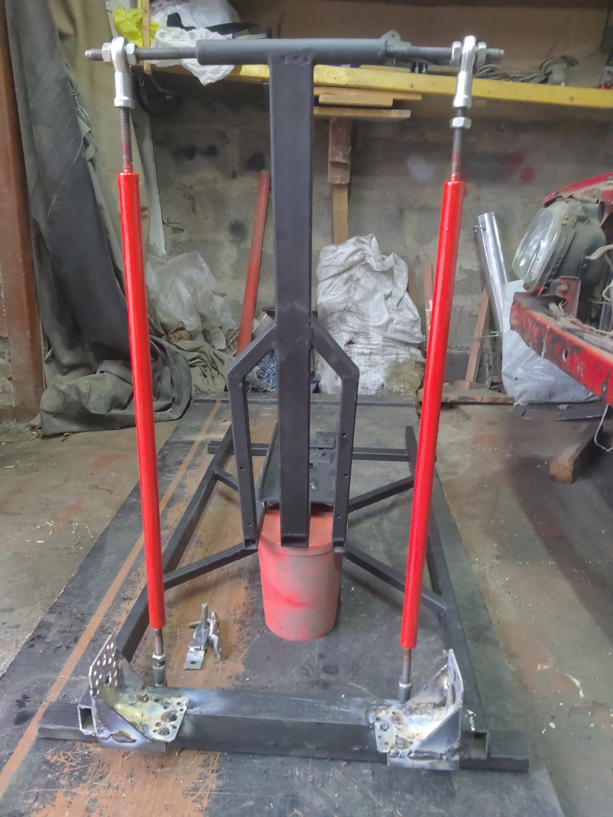

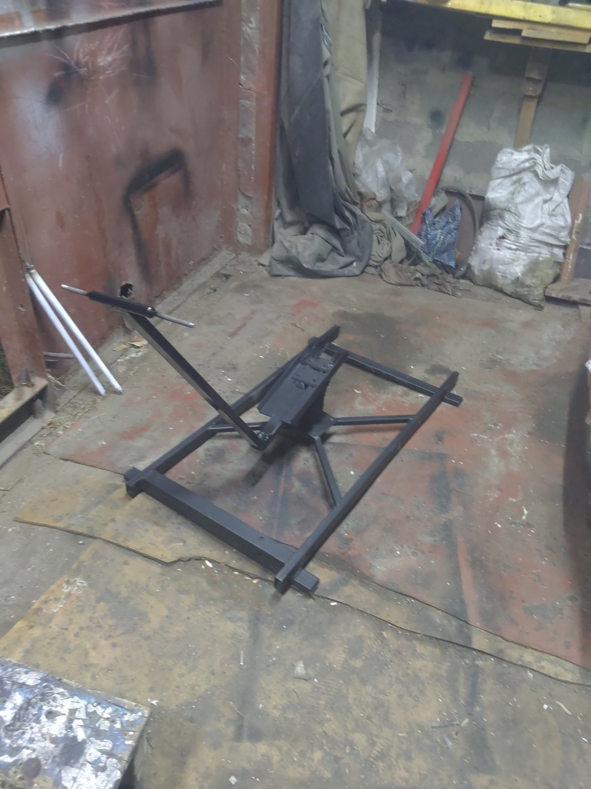

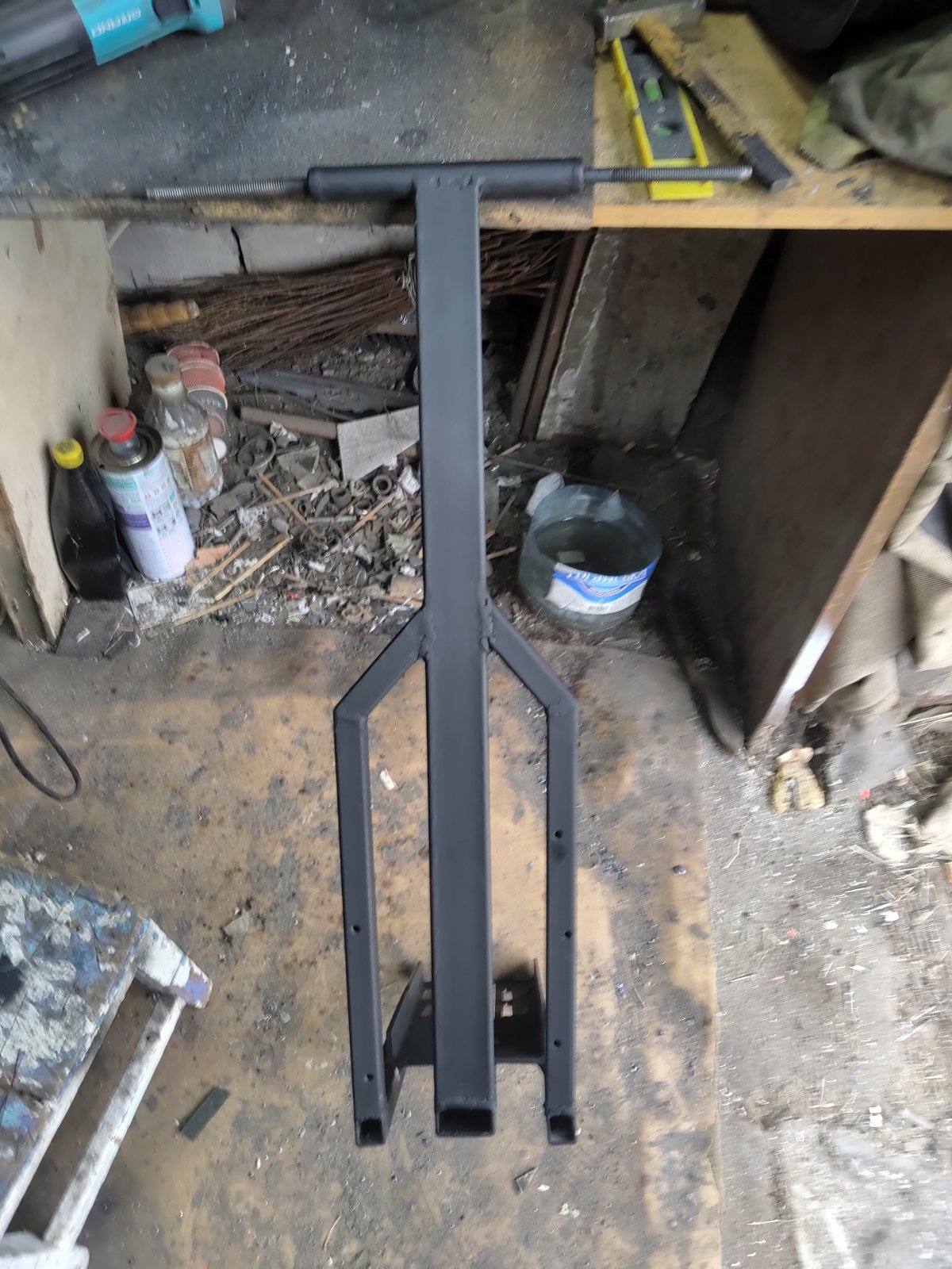

    I painted the lower part of the platform today and started making the levers of the motors ...
  7. redford 77
    redford 77 Member
    Sep 13, 2020
    47
    Technologyst of fiberglass
    Ukraine Kharkov
    - 141Coins
    +21 / 0 / -0

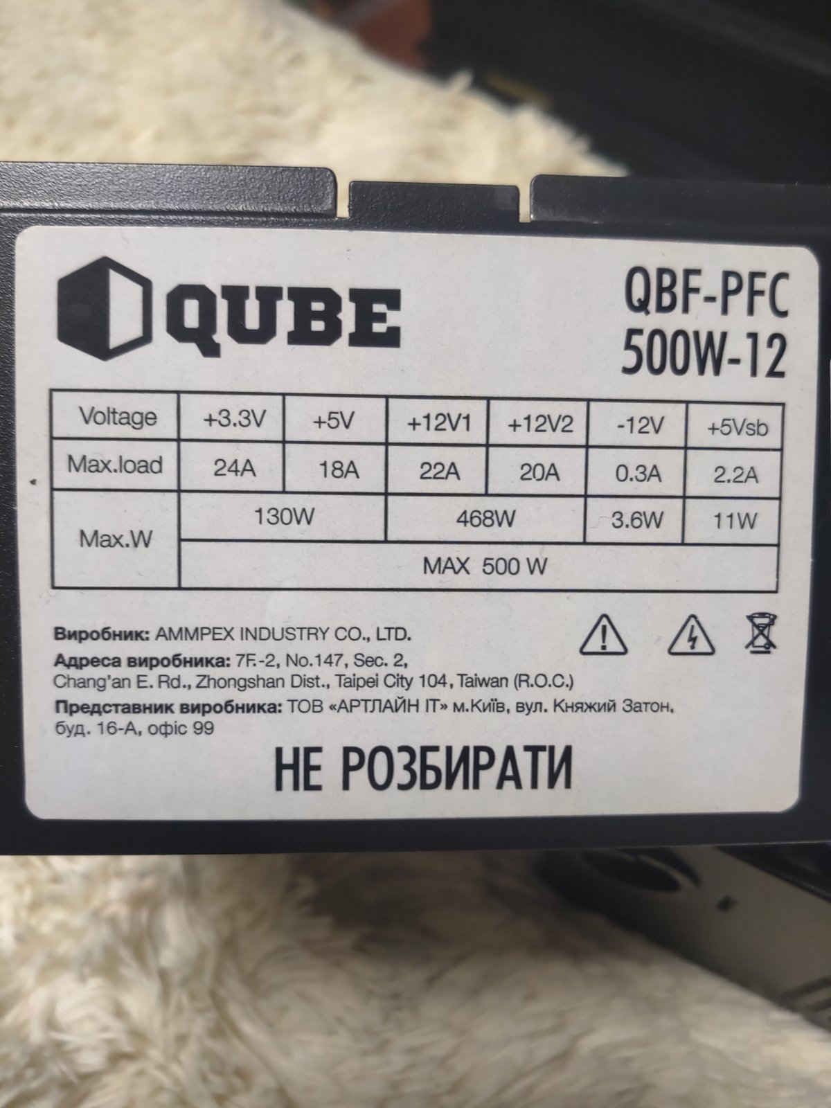

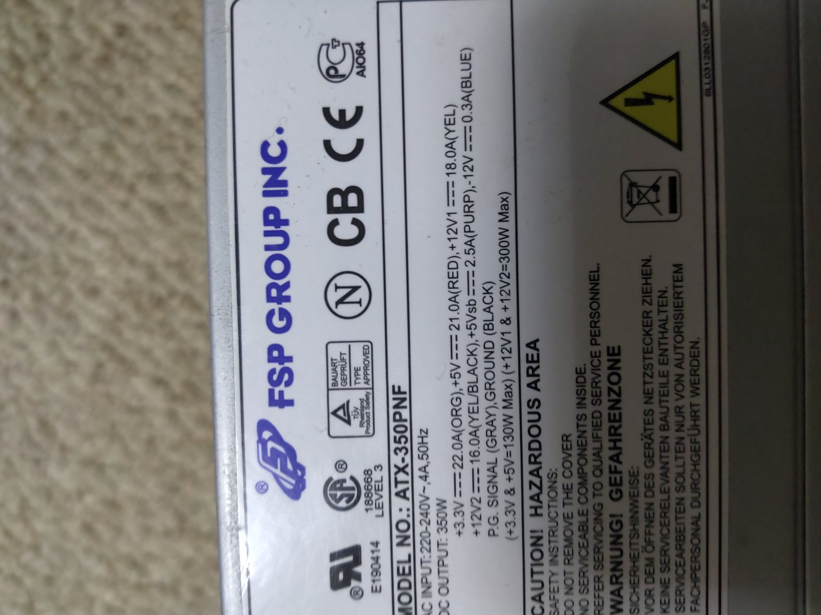

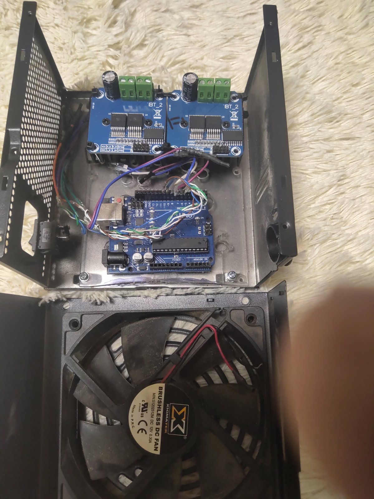

    Today I tested the power supply for my 2dof, the manufacturer indicated that 2 lines of 12 volts can withstand a load of 20a, it turned out that at 6-7a the power supply goes into protection and does not even withstand 50% of the power of the wiper motors.
    never buy this china shit from this manufacturer ....
    this power supply is only suitable as a box for my arduino ..)))

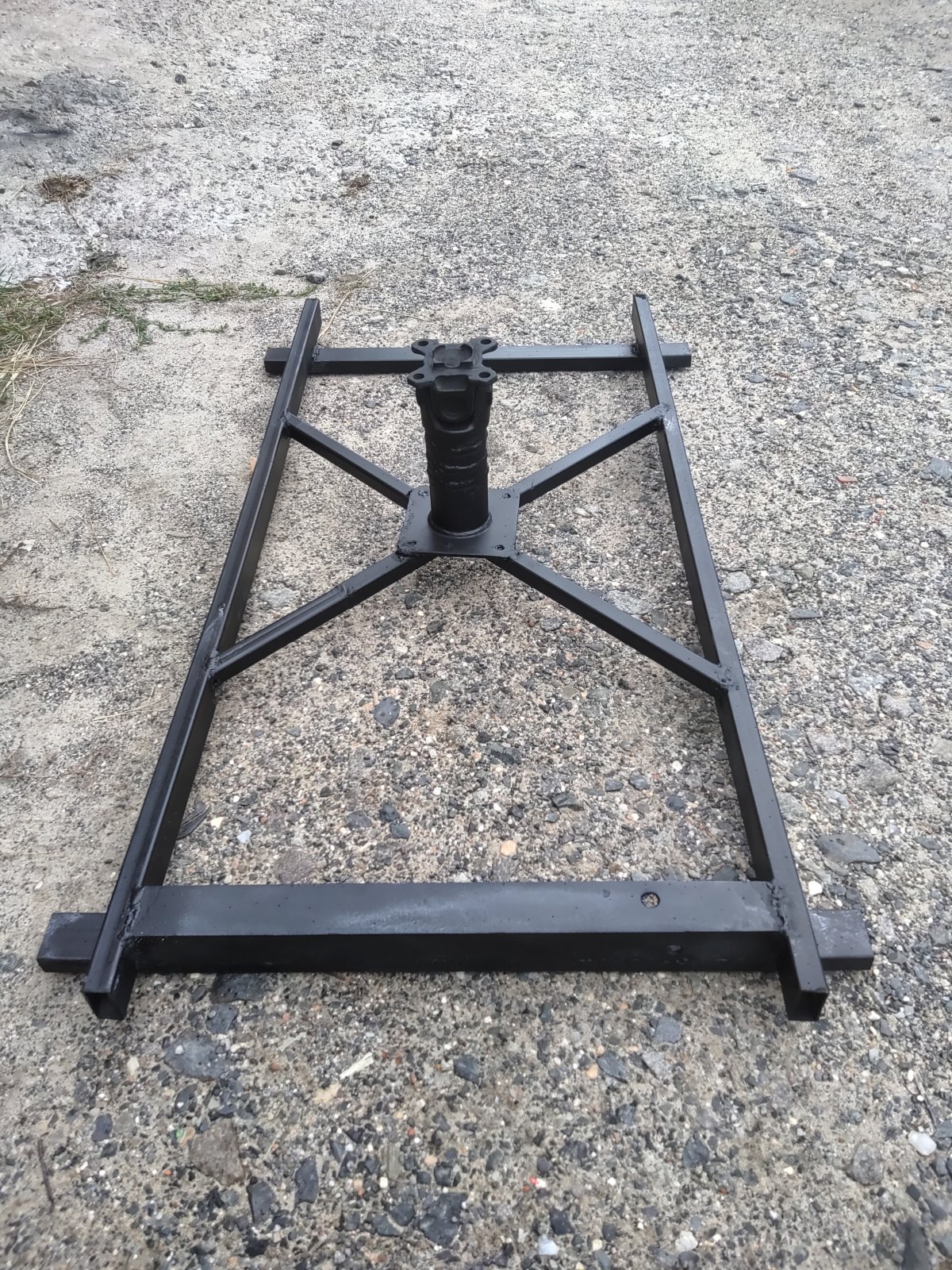

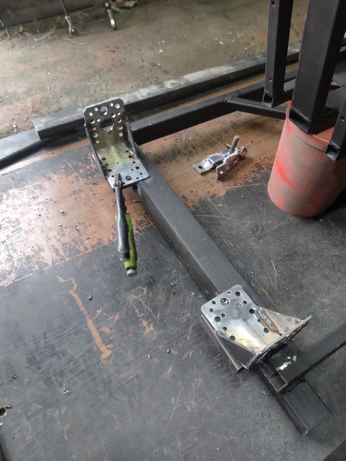

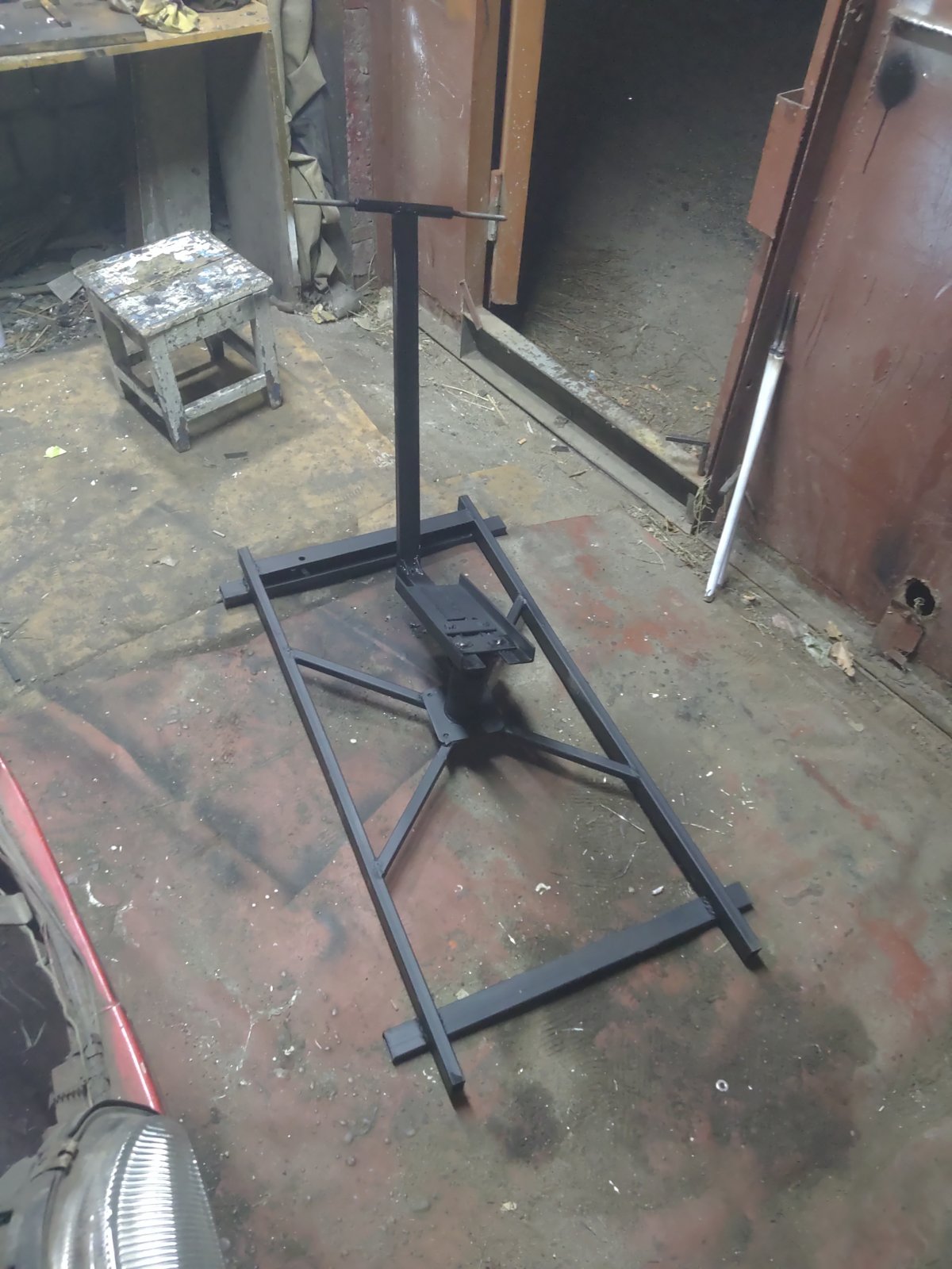

    I finished welding the lower part, it remains only to weld my simrig to this platform and connect the motors..
    21,714
    151,991Coins
    +11,061 / 56 / -2
    It is frustrating when specs are fudged by manufacturers.
    LED PSUs or modifying server PSUs are generally the two cheapest options: https://www.xsimulator.net/communit...ver-power-supplies-as-cheap-powerful-psus.54/
    As our rigs tend to have significant power load spikes I personally prefer a PSU per motor.

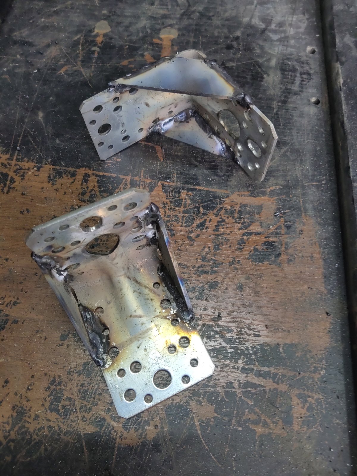

    I began to assemble the structure, but I had to rebuild
    some parts because there was not enough strength,
    I had to add additional fasteners to the lever behind the back, and I added extensions to the motor fasteners

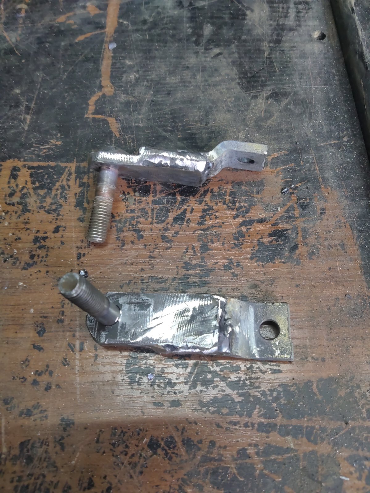

    made the levers of the motors like the racingmat 65mm between the centers

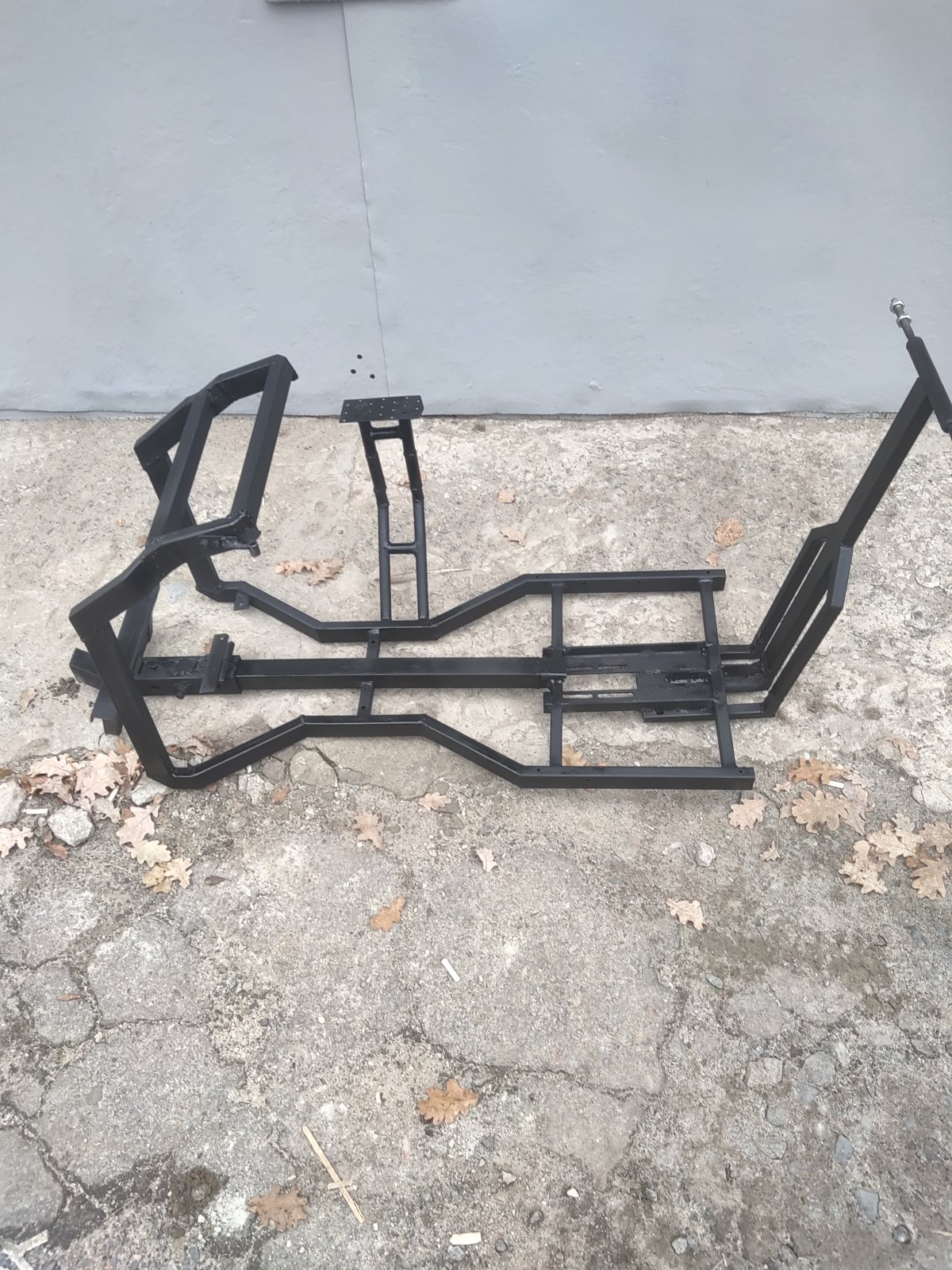

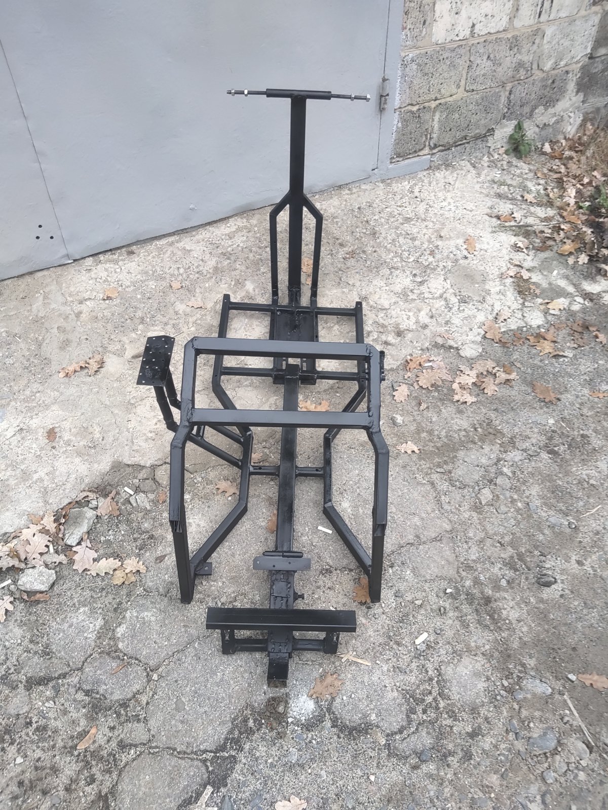

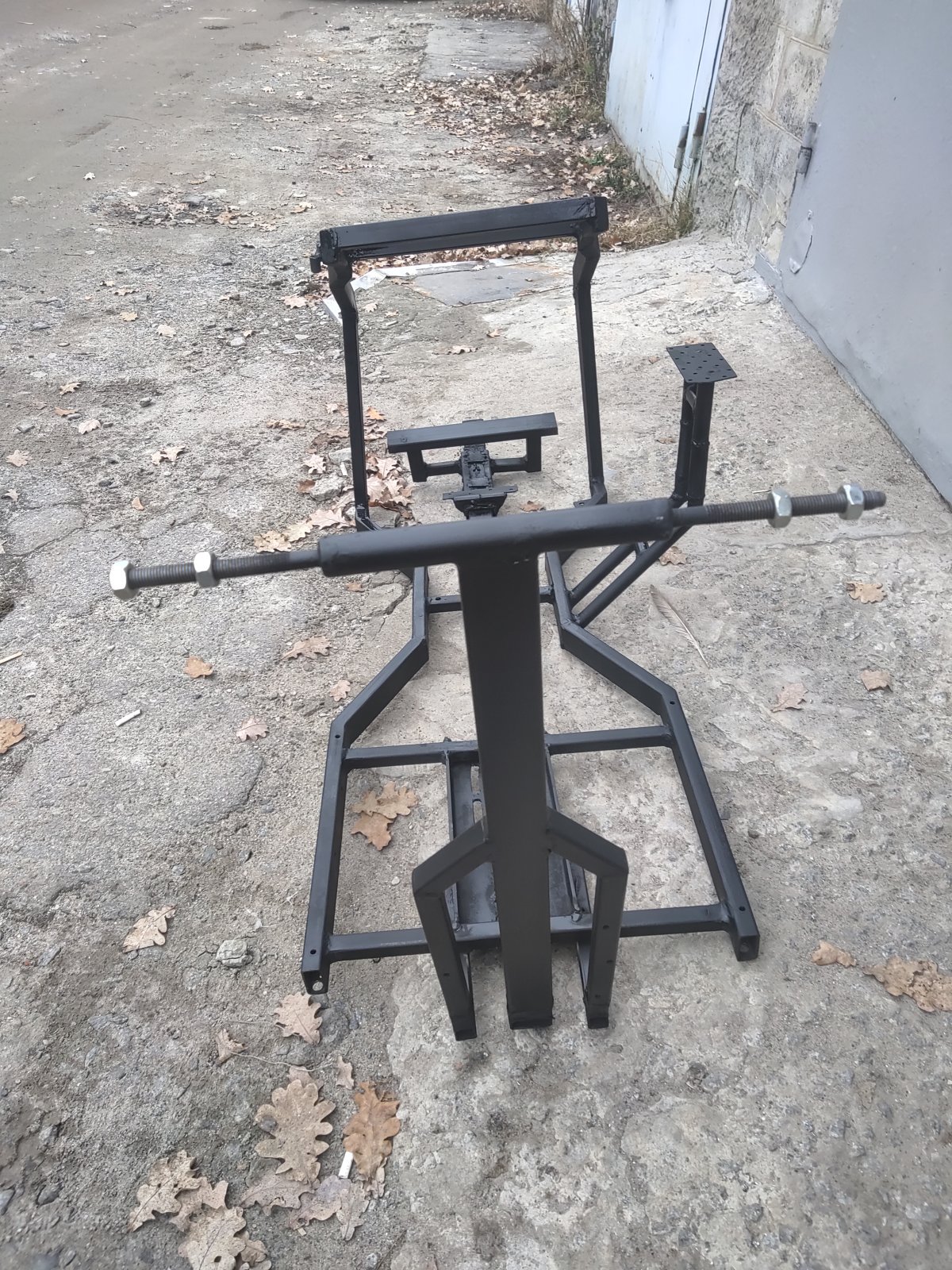

    Finally I finished welding the entire frame, was busy at work and had very little free time.
    I had to rebuild a lot in the upper frame, removed the excess metal from the front of almost 5 kilograms and added the ability to accurately adjust the pedals and seat to find the weight balance for the driver with different weights
    This weekend I'll finally start assembling

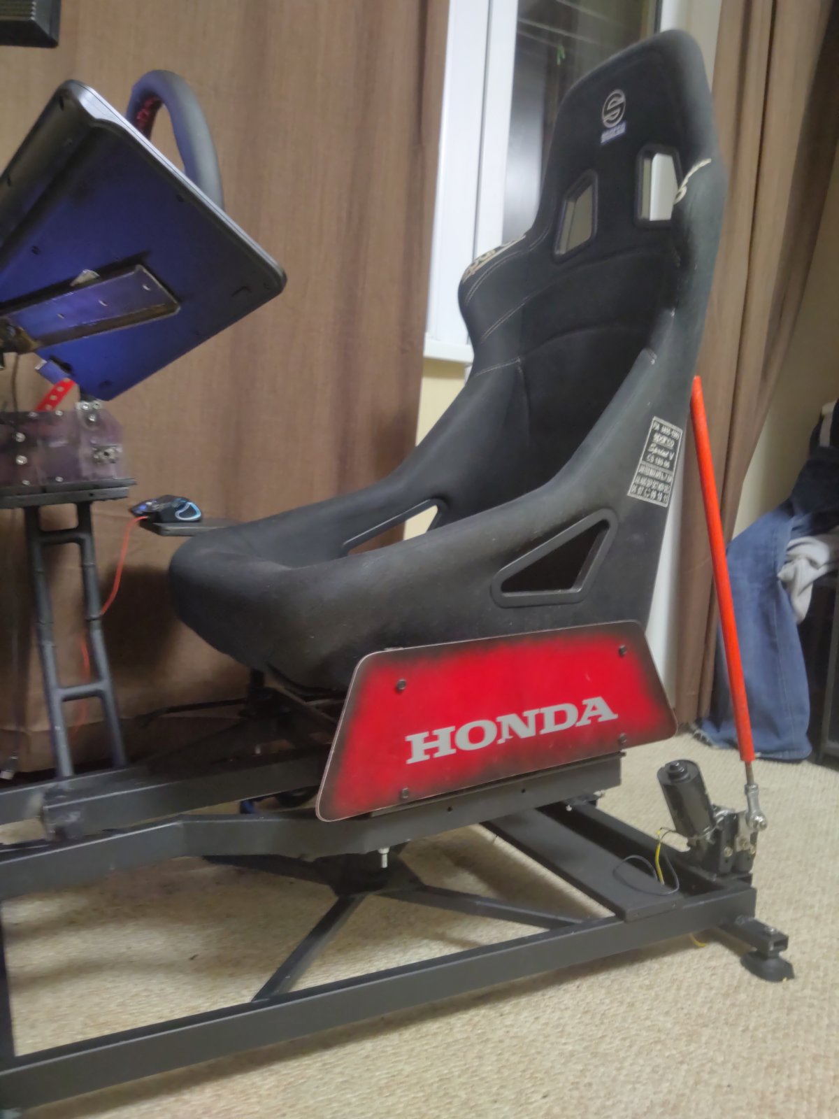

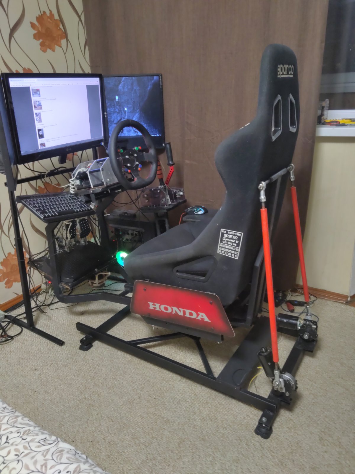

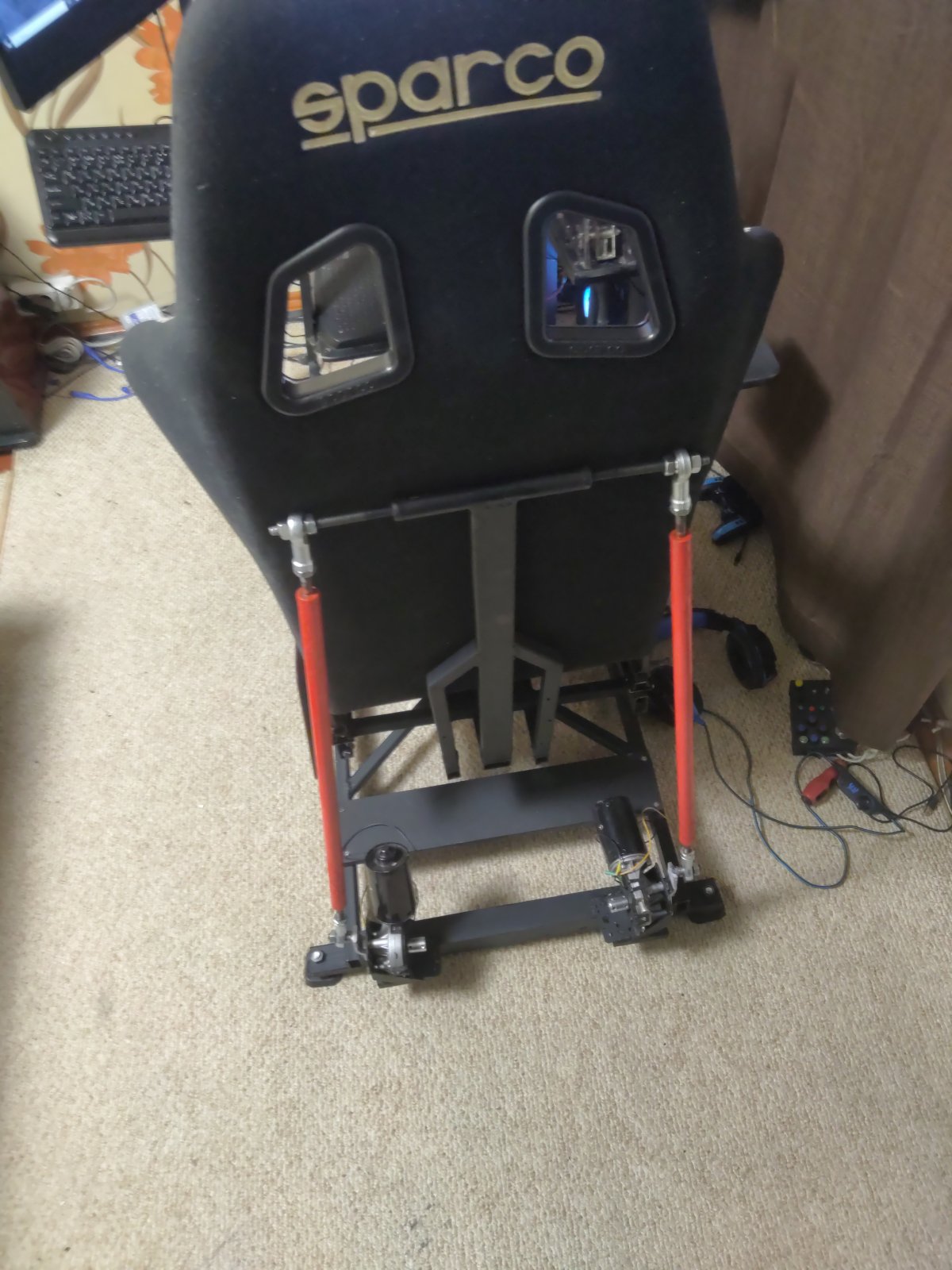

    Finally, I put everything together, but as always, there were some difficulties, because of the heavy weight, the platform could not even hold its weight, I had to change the CTC lenght from 65mm to 45mm, now everything is fine.

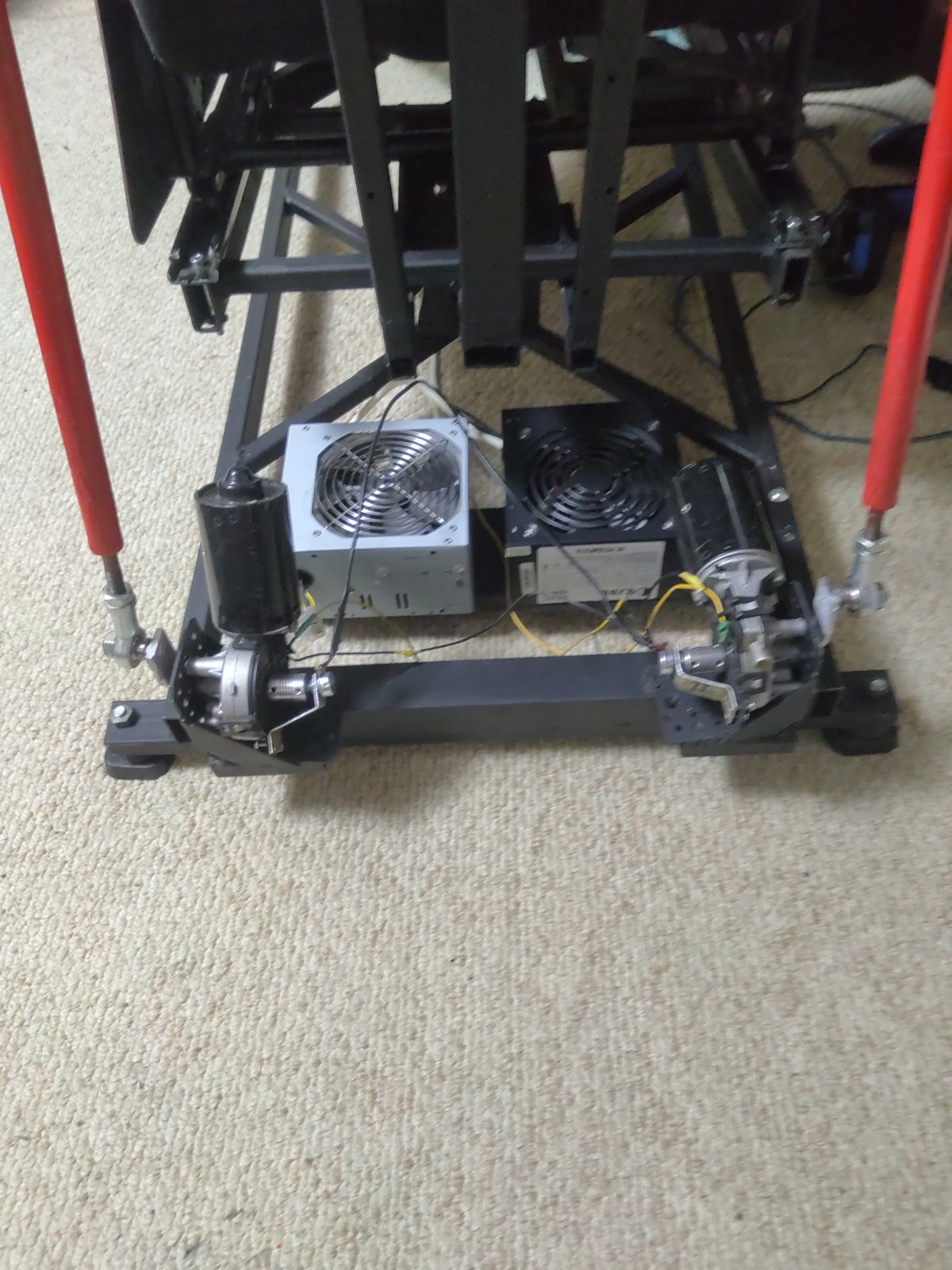

    Finally, we received a power supply, 2 lines of 16a each, I hope this will be enough.
    Conducted tests on 18a, the protection is triggered, which means the unit is truly delivering its power.
    I can't wait to test the platform in the game ..))
