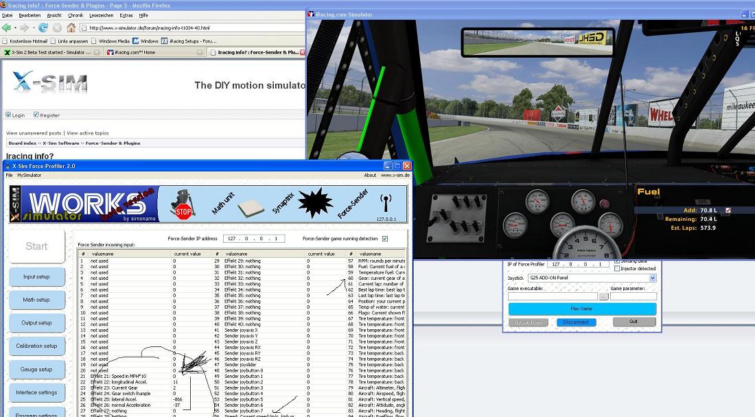

    2Coins
    ok i got the new plugin and profile in and am running iracing and there are more numbers moving now.
    #22 try to connect sender for plugin info
    #23 try to connect sender for plugin info
    #25 try to connect sender for plugin info
    #26 try to connect sender for plugin info
    #41 sender joyaxis x
    #42 sender joyaxis y
    #48-53 depending on what gear i'm in
    #60 gear: current gear of car or bike
  17. Ringorumble
    Ringorumble Active Member
    Jan 20, 2008
    178
    190Coins
    +48 / 1 / -0
    Hi, did it with the new one, heres the data moving like on the pic shown, sorry for the bad arrows

  18. njracer
    njracer Member
    Dec 31, 2007
    125
    2Coins
    yeah i just got the values too, looks like it works good :D
  19. njracer
    njracer Member
    Dec 31, 2007
    125
    2Coins
    my mistake, the check in the force profiler goes unchecked when in the menu and checked when in sim driving
  20. Ringorumble
    Jan 20, 2008
    178
    190Coins
    +48 / 1 / -0
    when i go back to menu it disappears, enter session it appears ...
    btw, 21 to 26 still moving but shows now try to connect sender for plugin info
