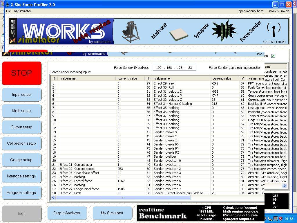

    my 21-26 still show all the effekt's, try closing the sender and start it up again

    Speed is already in ! Tried around with a gauge, worked but was my first so it startet at 220 kmh when i drove 10 but it moved

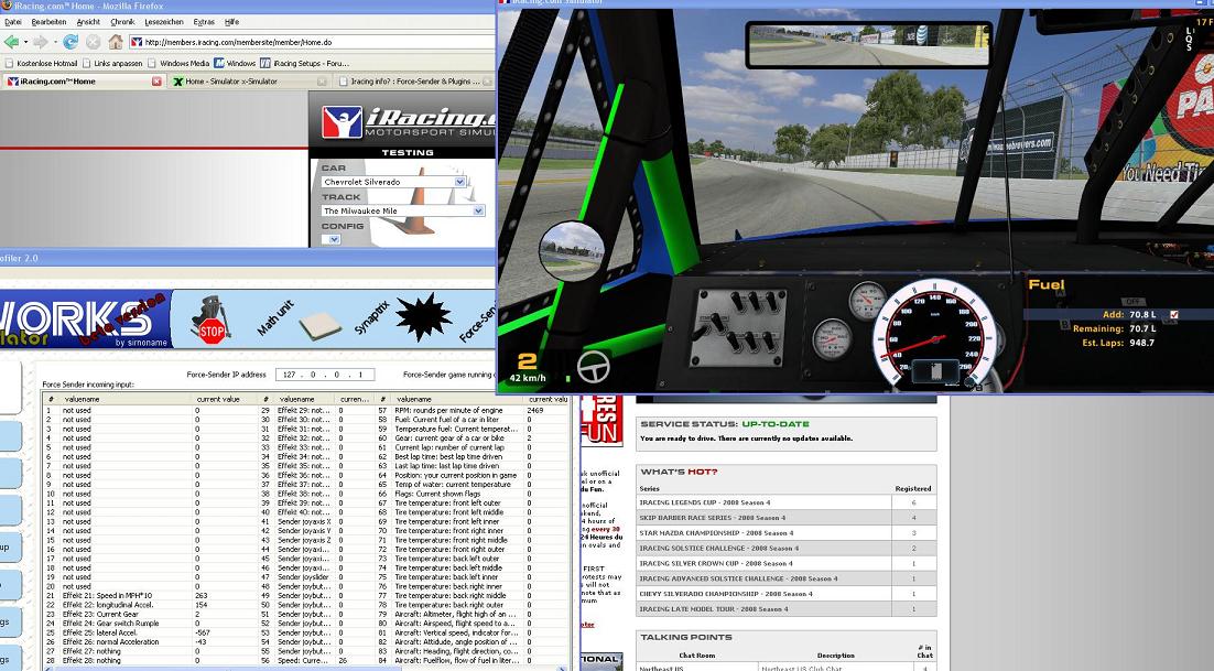

    Does not work, crashes as soon i go on track
    AppName: force-sender.exe AppVer: 2.0.0.0 ModName: iracingplugin.dll
    ModVer: 1.0.0.0 Offset: 000023d1
    Tried several times, back v1 ->works, again V2 -> force sender crashers

    Works, RPM you can see on the pic, speed on the gauge

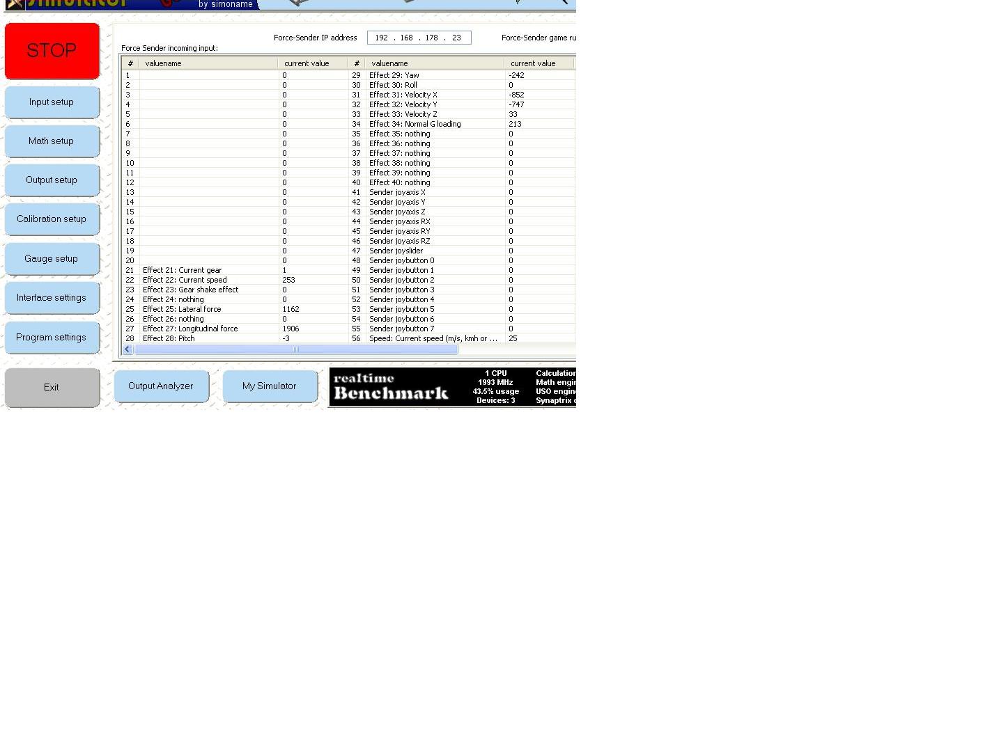

    Longti. is now 27, rest is new and is moving (28-34)

    changed my math from 22 to 27 , everthing ok
    repaired the screenshot

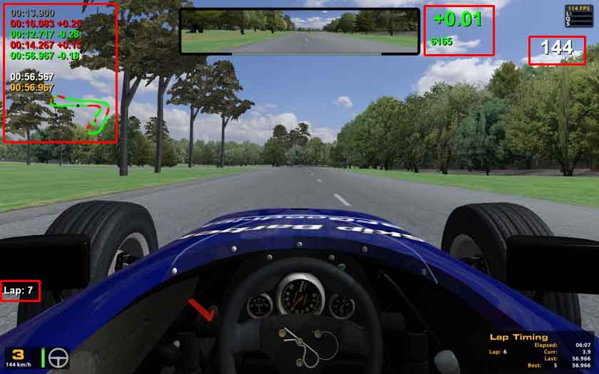

    Steph is really busy right not and taking a few months off to take care of other things, so I thought I would answer for him.
    His DLL uses the C++ library iRacing provides to read telemetry and then output the data using a DirectX9 proxy. The telemetry is specific to iRacing, so would require a recode to work with other sims/games.
    I put red squares around what the DLL adds to the screen. The only data iRacing currently outputs is in the 3 black boxes in the corners.
    I'm not sure, but I think his intent was to add an X-Sim interface (output) to the DLL, since only one program can access iRacing telemetry at a time. If he created a separate plugin for X-Sim/iRacing, then people would have to choose either that or the HUD. Since he is already accessing the telemetry with his DLL, adding X-Sim communication would not cause this problem. Programming his DLL to read telemetry from other games/X-Sim would be nice, but would require even more work, and may not be compatible.
