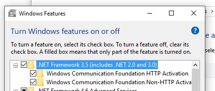

    Did you do like I said and install 3.0 and 3.5?

    Your issue is a .net issue.

    well, it seems that once install 4.6.1..i cant revert back to 3 series family....and also by default .net 4.6 is comes together with windows 10 pro

    windows 10 also have the backward compatibility version for .net 2.0 - 3.5 which need to be enable manually...i already done that and still the crash happen
    and also tried the windows 7 compatibility mode too..still same

    The error that you are receiving ..System.NullReferenceException: Object reference not set to an instance of an object.....basically says that it cant find an object that the software is needing to perform the function. This is why I keep pointing to .net as your issue. This is not a plugin issue as it works for others. This is system specific.
    Are you able to run any other sims/games? Do you get this error?

    This also could be related to the profile you have for iracing. When you installed 2.0 do you clear out all of simtools 1.3? in the apps folder as well as the simtools folder?
    I would try that as you could have residuals.

    Here is the secondary folder...you will need to use your user...C:\Users\Shannon\AppData\Local\SimTools
    I believe that your iracing profile in this folder could be corrupt...C:\Users\Shannon\AppData\Local\SimTools\GameManager\GameProfiles

    yes..i able to run all program without problem..asserto corsa..pcars..iracing..R3e..adobe creative suites..call of duty...
    i will try on other computer see how it goes..windows 7 mybe?.....
    FYI, i just format my pc with win 10 after all the software above install..i test simtool 2.0 with iracing plugin only then came the problem

    yes..formated...install all the above said games and app..install simtool 2.0...put in the necessary plugin..install latest update .net..enable the backward .net compatibilty...
    i did run the plugin for asserto corsa and dirt3 i receive motion data without problem

    just reinstall simtool 2.0 and iracing plugin only...same thing happen

    Did you check after the uninstalled to see that all things pointing to iracing in the folders that I shared were removed? IN the instance of a corruption, these wouldnt necessarily go away with just an install and would require a manual delete.
